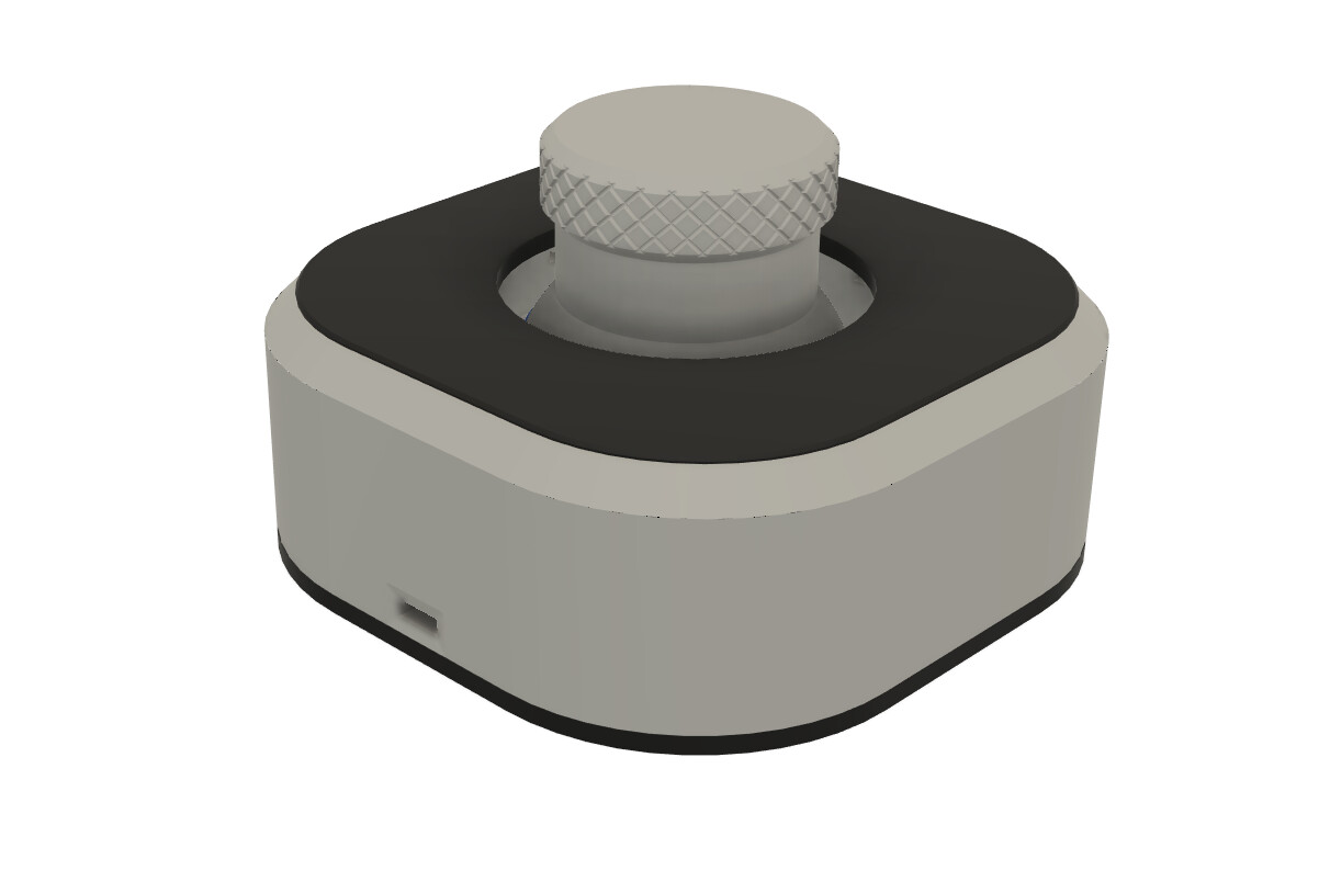

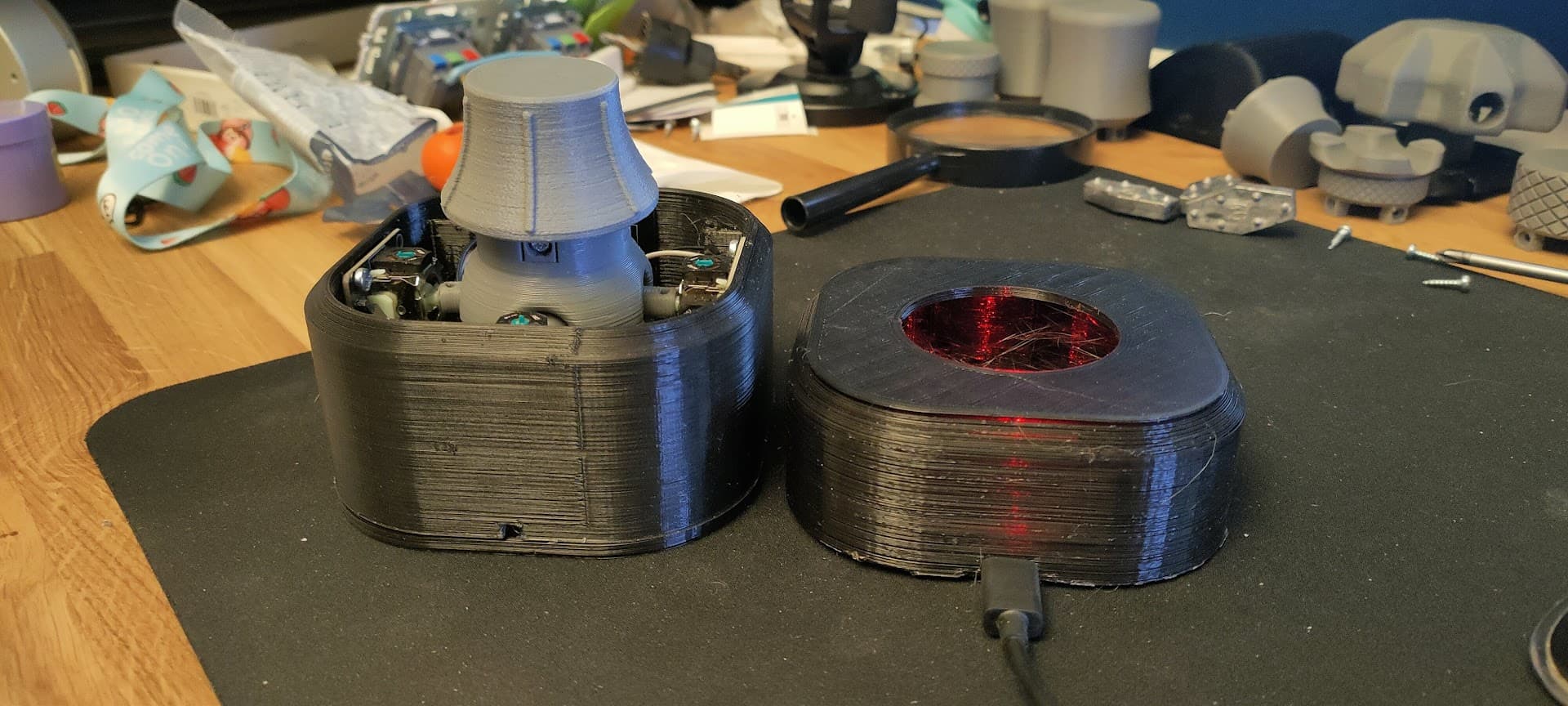

Slim version incoming…

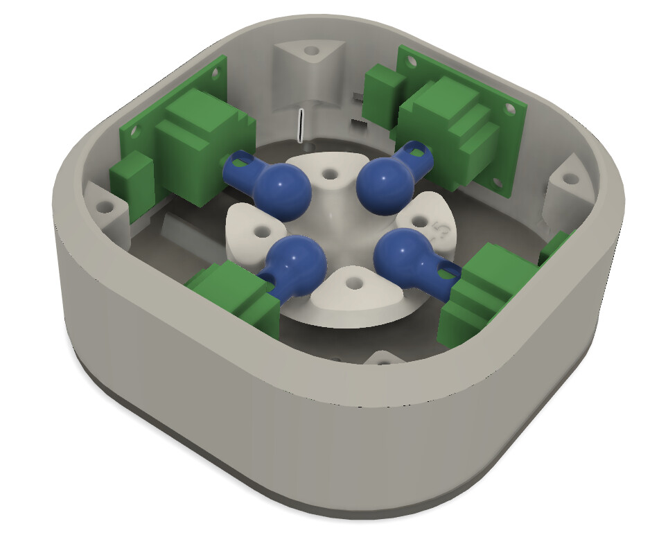

I haven’t gotten a feel for this yet but maybe it’s to high (no need for the extensions) and maybe it should be shaped like the left palm of your hand on the bottom left and top left parts.
As much as I’d love to, you still need some space to fit the joysticks :smiley:
Getting slimer than this might require smaller joysticks (but probably costly and not as easy to integrate), or a totally different system (eg: the one with magnets and an IMU)

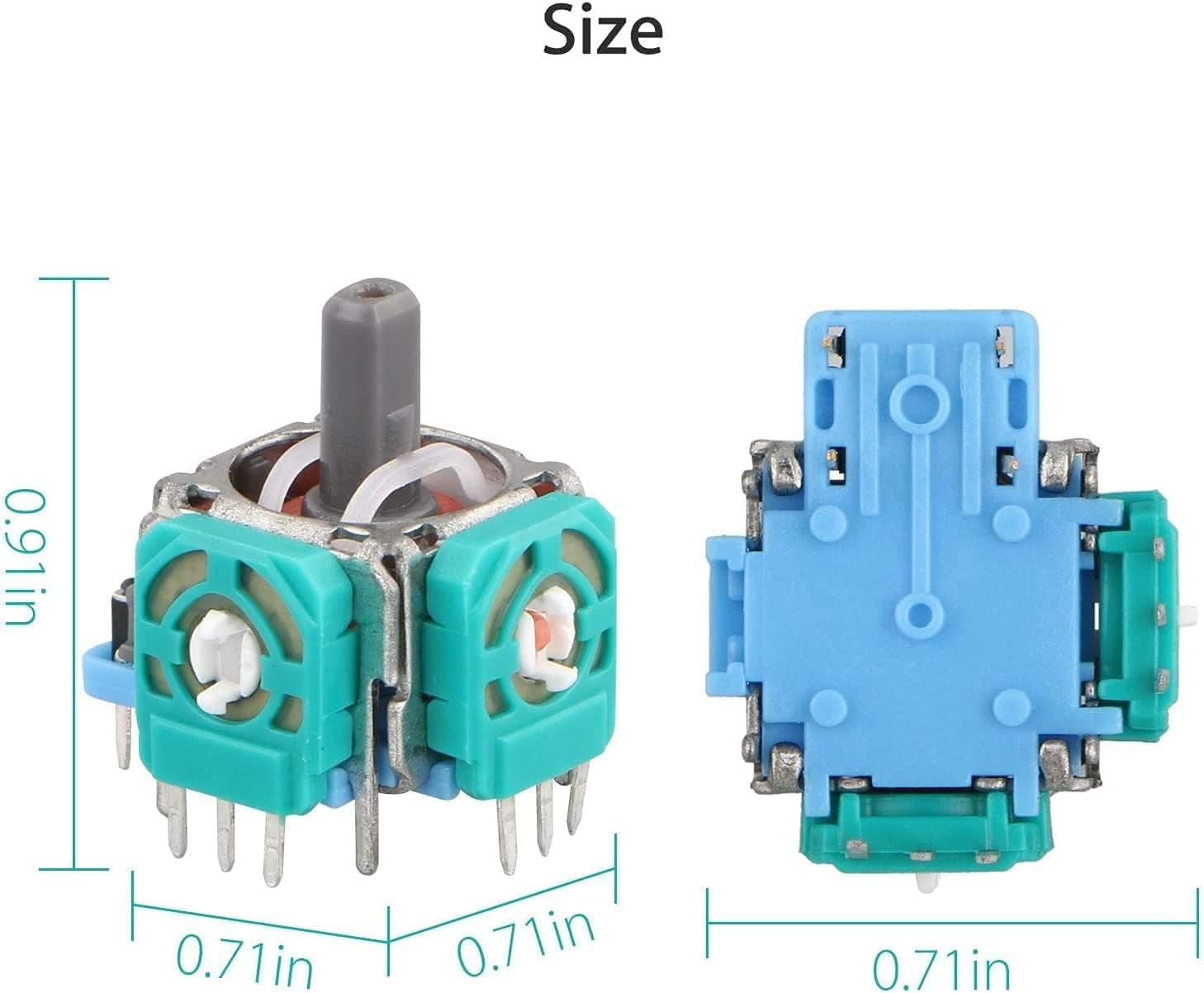

The joysticks here seems to be PS2, I see that there are PS4/5 joysticks as well as Switch joysticks that seem to utilze the “hall effect”. The price isn’t that much higher.
PS4:
Once you add a support or breakout PCB I’m not sure it’s much smaller

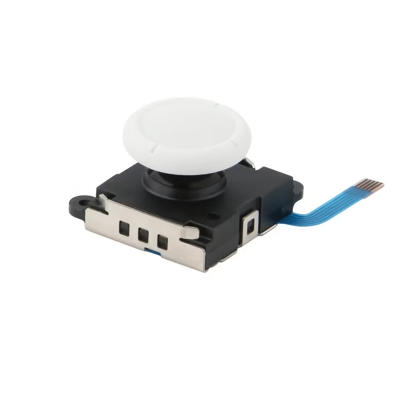

Switch:
It’s a lot smaller alright… But I can’t even begin to imagine how on earth you’d attach a ball joint to this :smiley:
Plus the ribbon-style connection doesn’t make it too tinker-friendly

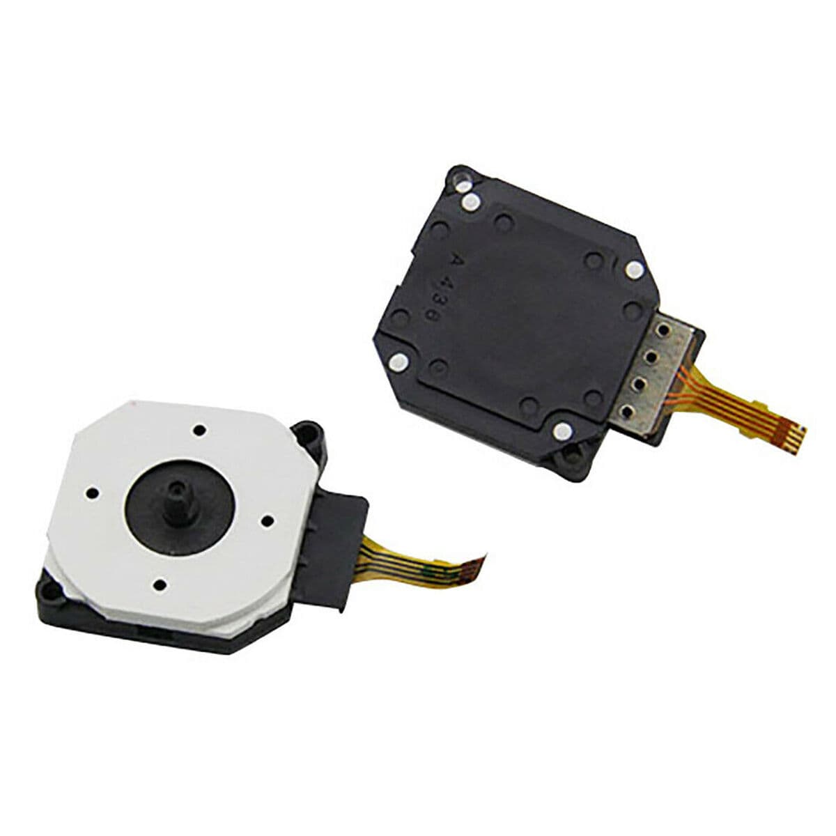

Maybe there’s something that can be done with PSP/DS-style joysticks that just “slide” rather than tilt
Place one of these underneath the knob for translation movement + 2 more classical joysticks on the sides for tilt and twist
The range of motion could be problematic though…

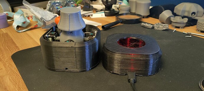

It’s not “a lot” slimmer, but I think the difference in look and feel will be noticeable
It will be slightly taller with the base, but I think I’ll make a thinner one too…
Note: printing this with 0% infill was a bad idea… re-printing right now…
