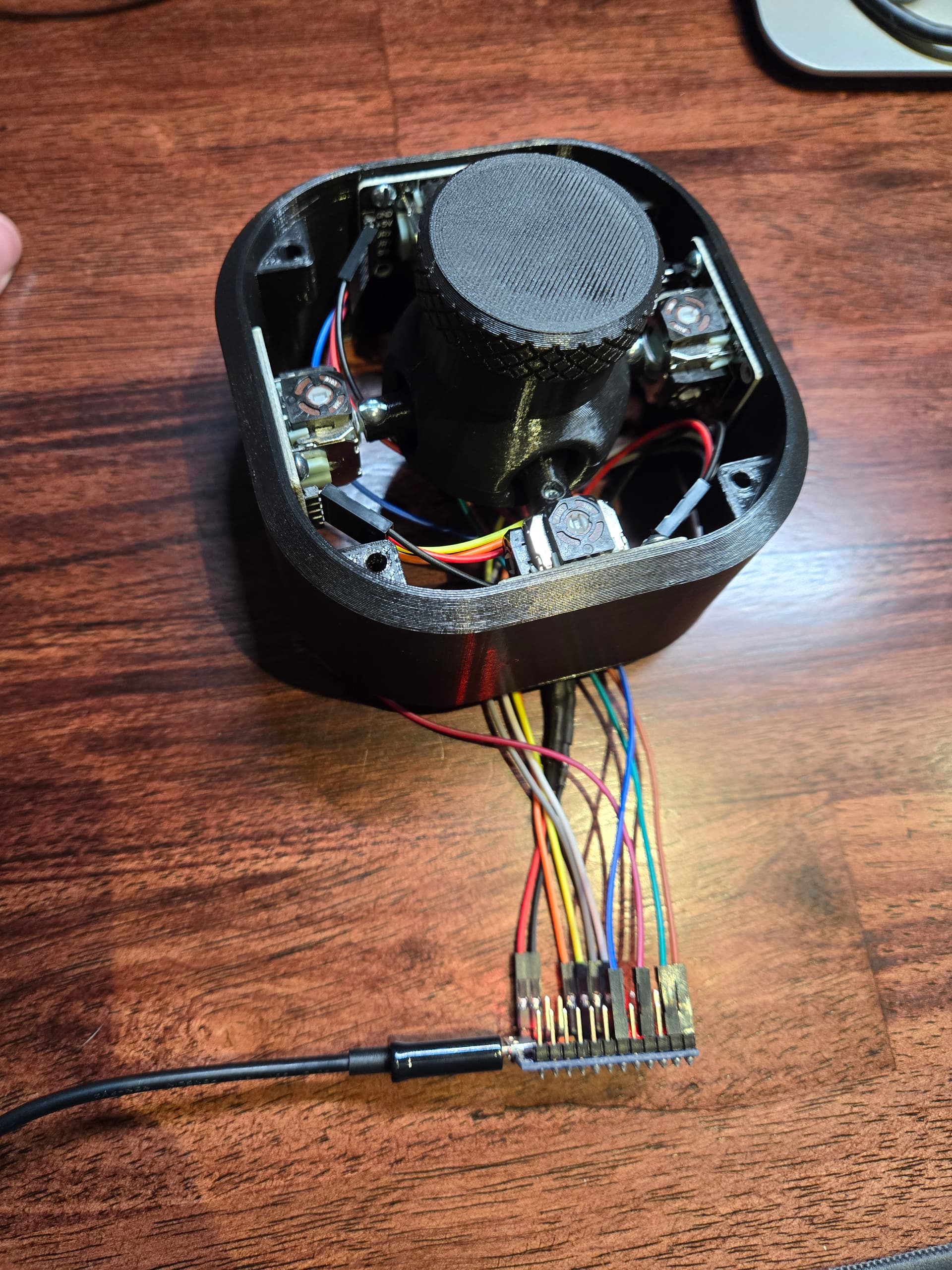

Need to finish assembly but it works! There’s a learning curve but this is very cool. Being able to adjust settings in the real software is helpful.

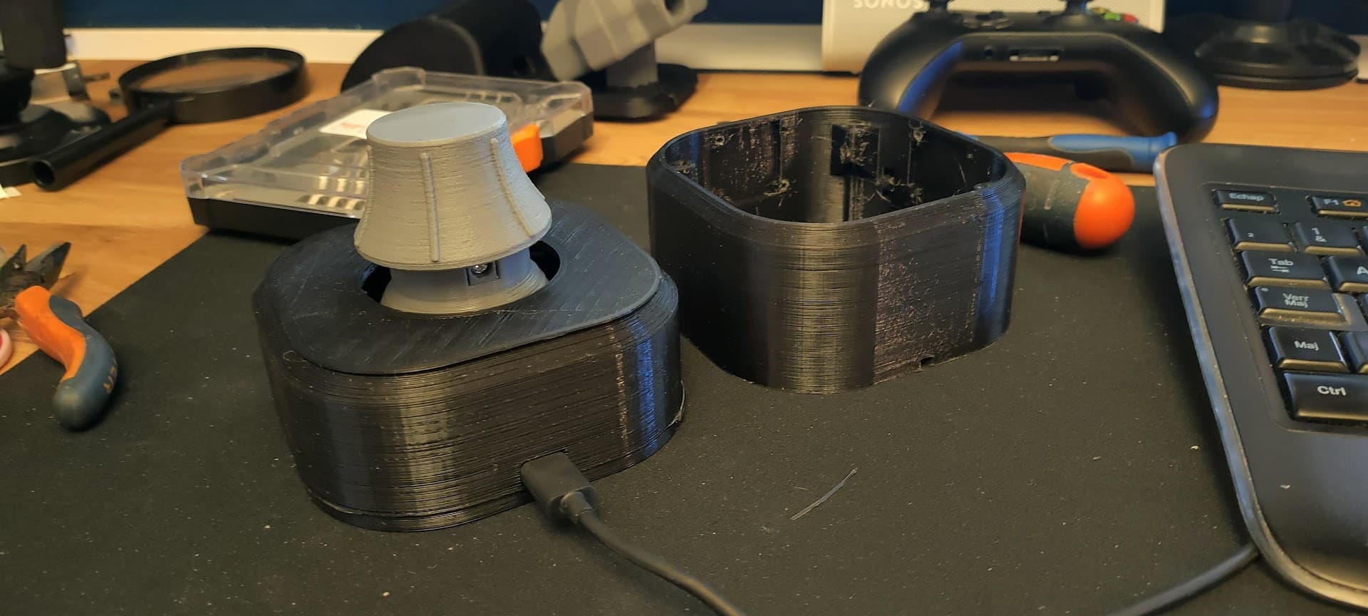

I noticed in the Fusion 360 file there is about 25 mm between the bottom of the inside of the case and the lower edge of the joystick PCBs. How much of that did you take out to make your slimmer version?
I cut the base 6mm beneath the joysticks pcb so that I can squeeze the Arduino in there
I’m assembling this tonight and will post the remix if the fit is good

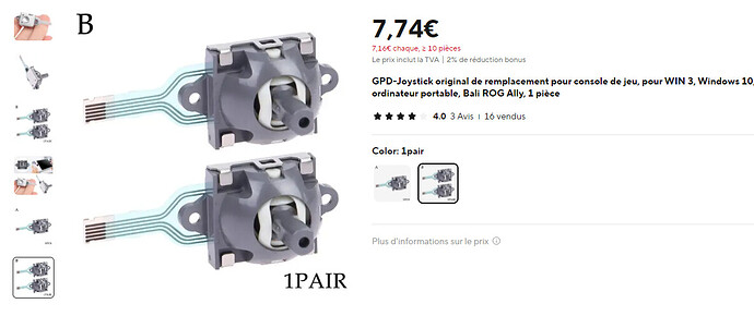

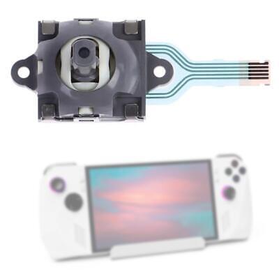

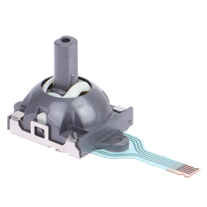

I think I found the perfect joysticks for this application, if anyone feels like trying
ASUS Rog Ally joysticks

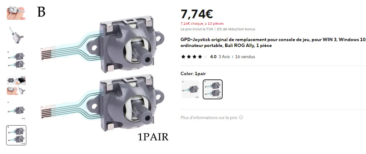

UPDATE NOTE: See even cheaper option at the bottom.
I found these same ones just now on Aliexpress, for $3.52 each (US), so x 4 = $15.06 (US) — and has free shipping. I ordered them too, just to try them out and see how they work. Link here.
UPDATE: just after ordering from Aliexpress, I found an even more affordable listing on eBay: a pair of them for only $6.76 (US), so total $13.52 — again with free shipping.

The slim version does look and feel pretty good though :slight_smile:
I need to make a small iteration though, because the knob hits the Arduino just a bit, and the usb port doesn’t quite line up…

So how do you plan on using them Doug, solder to the terminals, or something else?
