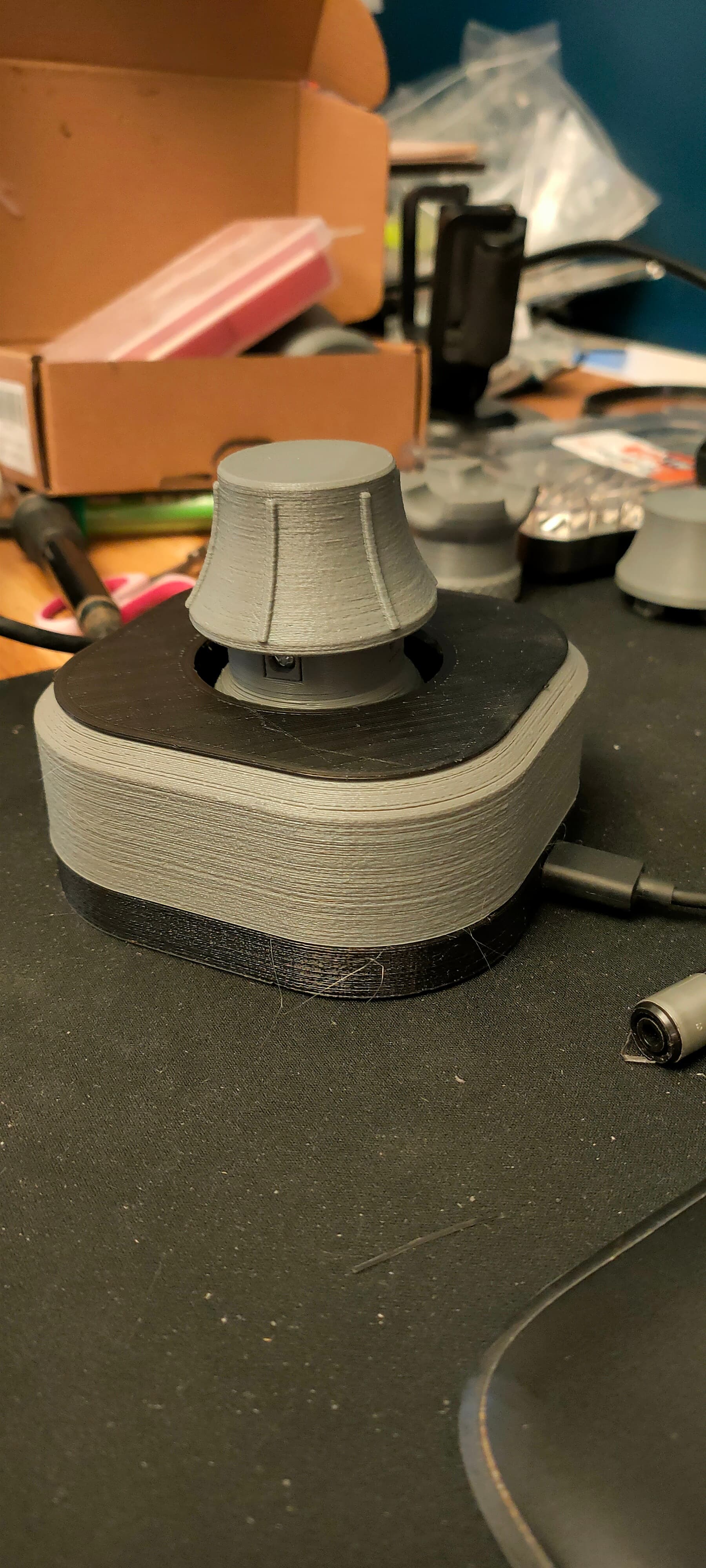

Space mouse v2 DIY

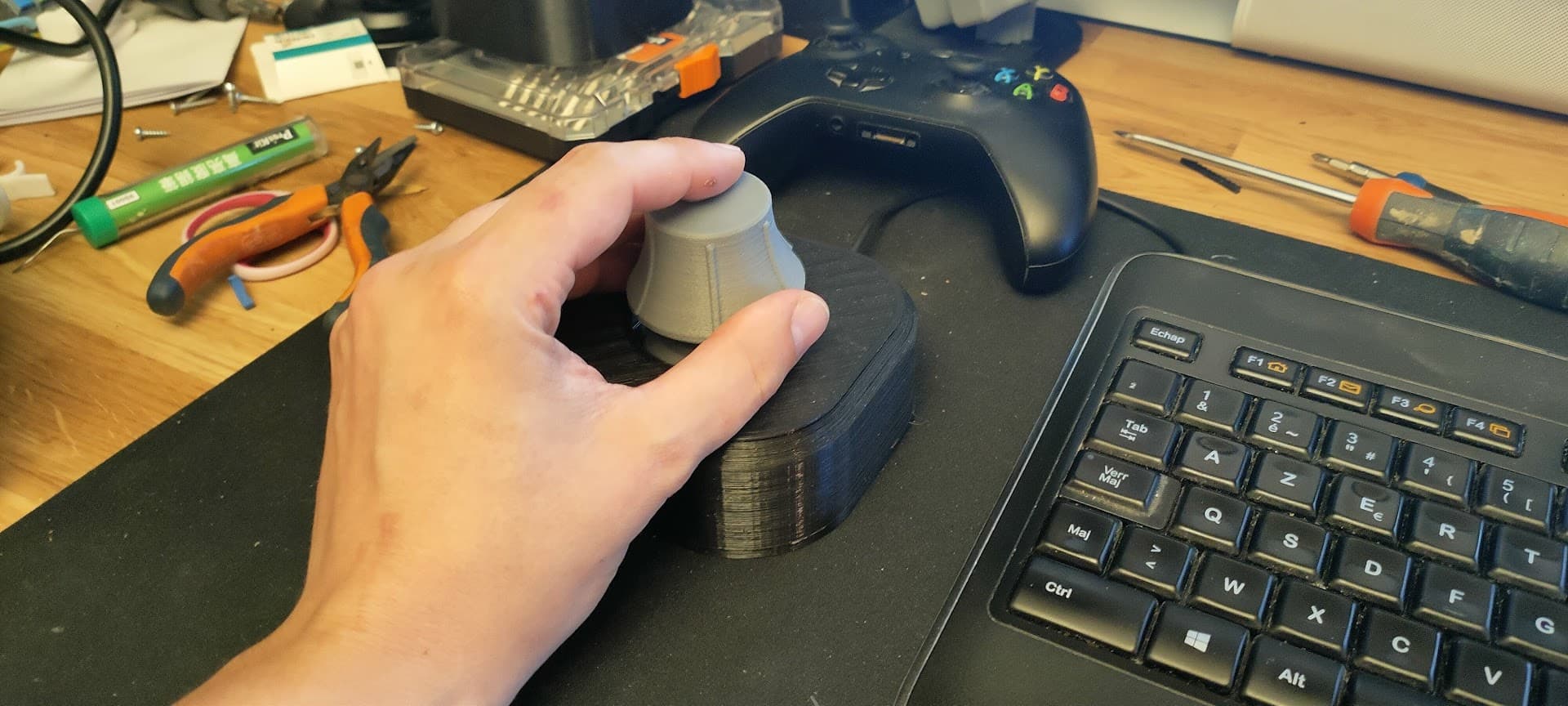

Can you post a pic with your hand on it using it for a good size reference?

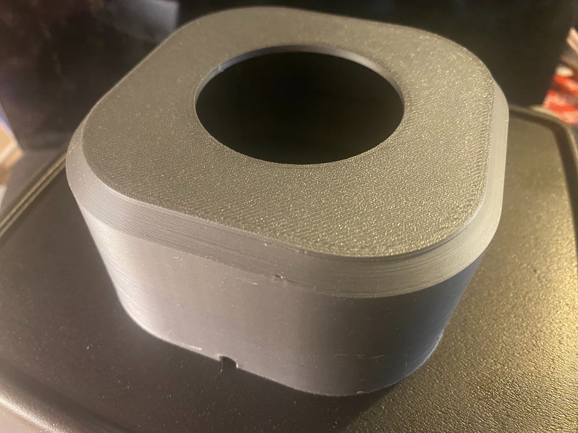

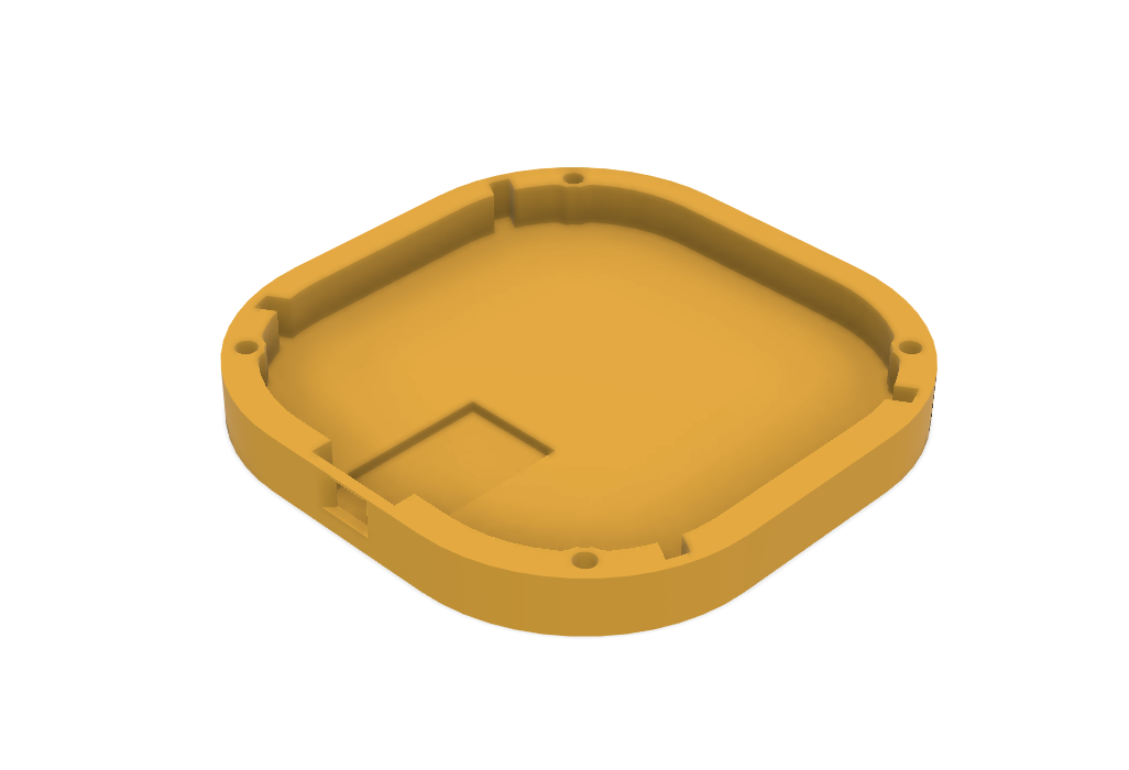

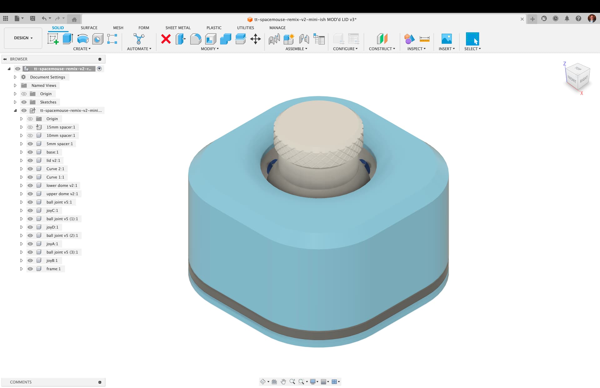

I made a remix. Surprise surprise. LOL. But it was only a 2 minute job.
Mini-ish lid v2 - nestles flush instead of standing proud
https://www.printables.com/model/888693-mini-ish-lid-v2-nestles-flush-instead-of-standing
I thought the very same thing. Especially the second part about moving it to the back.
Looks awesome. Now just to pair that with my new flush mounting lid. See above.
Kudos here. Nice. Looking forward to it.

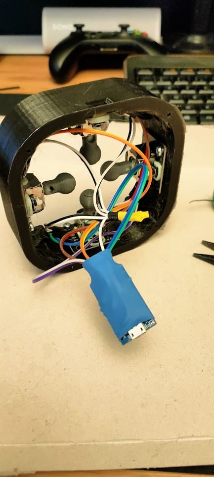

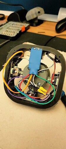

I was leaning toward just soldering to the leads.
For reference, I have “medium” size hands, not too tiny but I’m not a carpenter by trade either :wink:

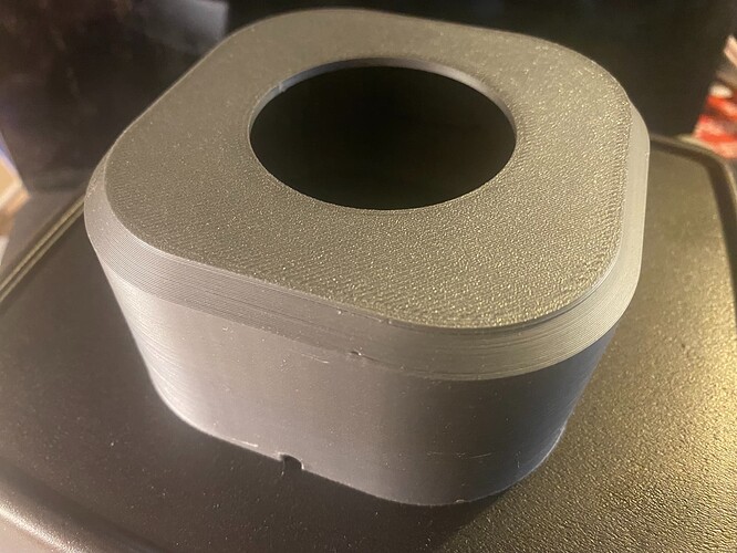

First one done, need to print and test it (re-re-re-printing the shorter base now)
Now I need to make the two other ones
I love the idea of having those different independent modules, this adds a lot of flexibility…

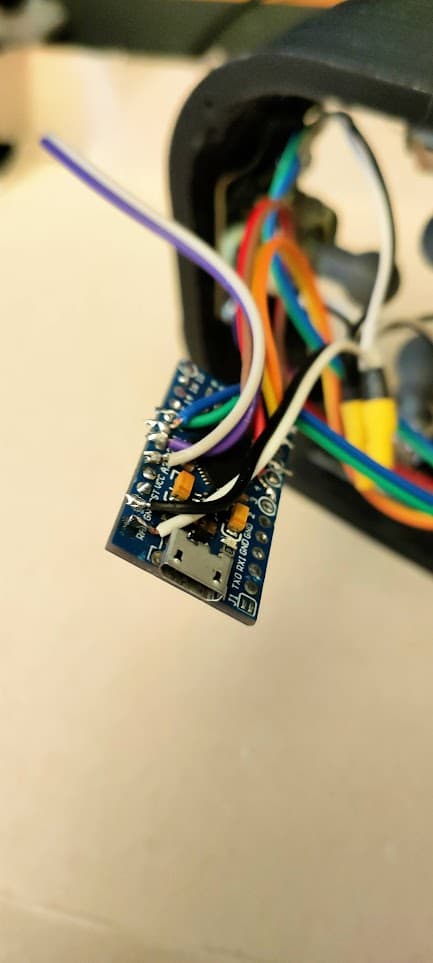

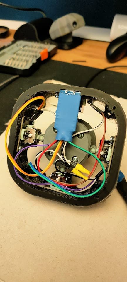

As a side note, this slimmer version requires soldering the wires directly yo the Arduino
Nothing too complex, but you have to be mindful of how you sort out those wires

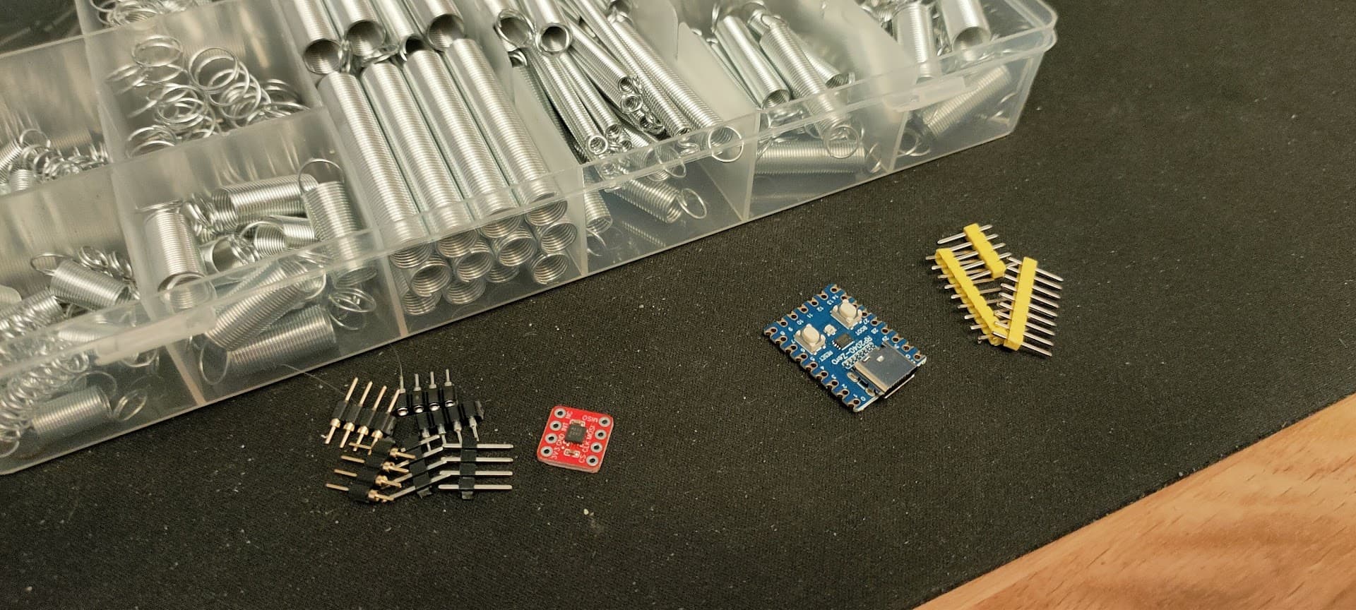

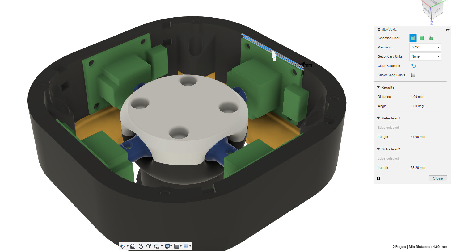

If the ROG Ally sticks work out, that’d be pretty sweet. It could easily turn into a custom board that’s effectively the base plate for the design and has the flex PCB connectors on it ready to go. That’d be a remarkably simple design, actually…
Edit: Could also add some tact switches around the base pretty easily, similar to the existing space mouse. The housing could either have holes and separate printed buttons or use a flexure type thing, perhaps.

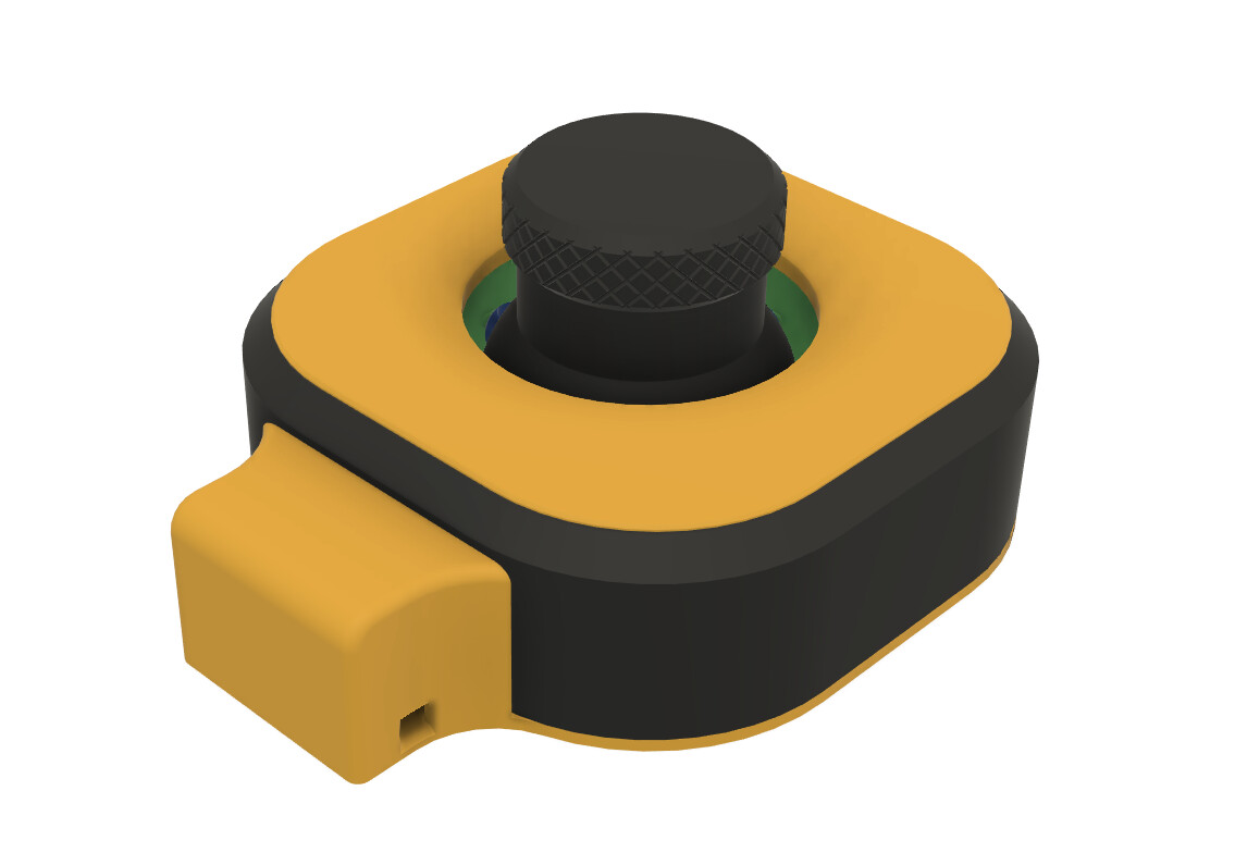

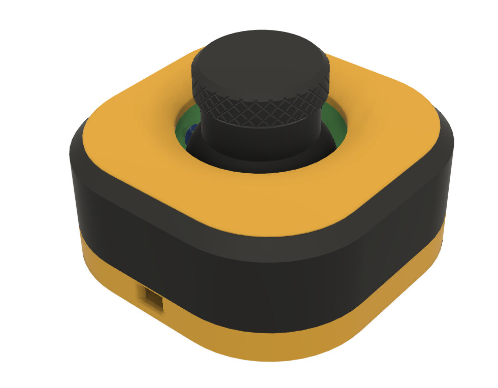

Wow, thank you! Looks great. Those renderings from Fusion 360 look like photos!

For mounting the joysticks I imagine an approach that captures one side in a slot, and then once the other side is swiveled into position, a small retaining clip slides into place. No screws. Easy access.
Backpack style - first prototype
Still unsure about how the usb plug will be sorted out…
This one can have a few switches added on top of the “backpack”

While you are at it, one idea I had, was to have the bottom part serve as a tray that can hold something for ballast / weight, such as pouring sand in, and then perhaps either covering the sand with an inner lid, or some other way of keeping it in.
On mine I just hot-glued a few fishing lead weights on the bottom :slight_smile:
I’ve also seen people pausing the print and pouring lead balls or sand into the infill before resuming

Having them in separate parts adds a lot of flexibility, ease of assembly, and is far easier for prototypingAlosi, I think it looks better with a two-tone scheme :slight_smile:
This one needs one more iteration and it’s good to go…

I may, or may not build the magnet version at some point :stuck_out_tongue:
