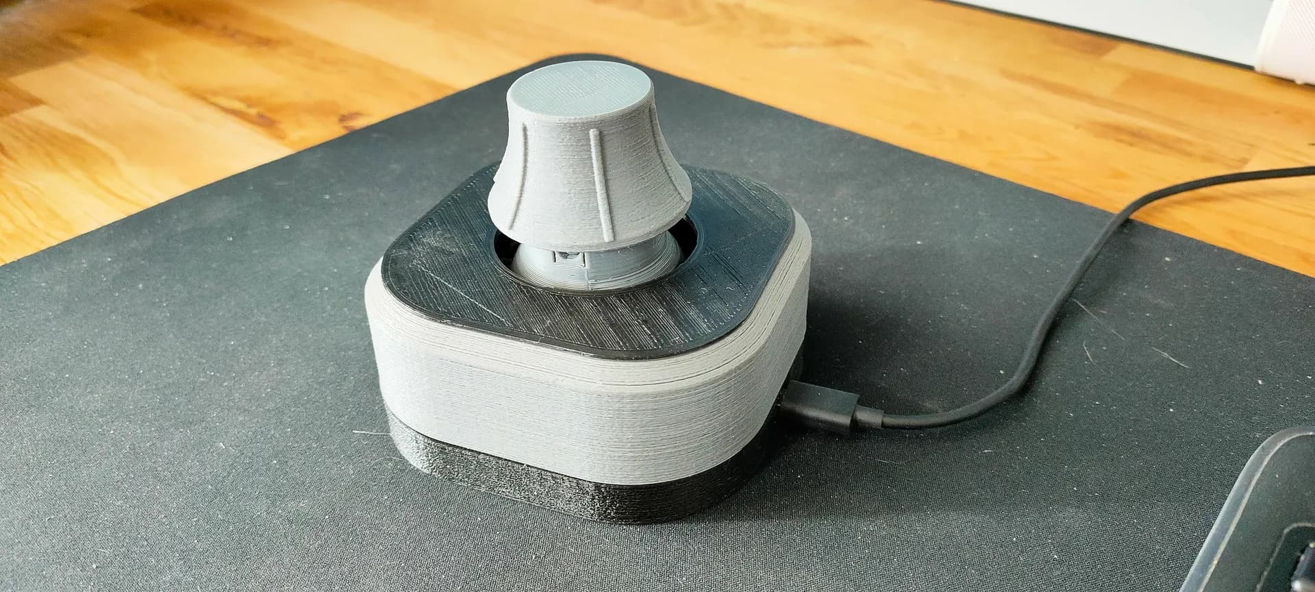

Slim version published
@DougJoseph you can be my guinea pig :wink:
https://www.printables.com/fr/model/890178-spacemouse-mini-slim-profile

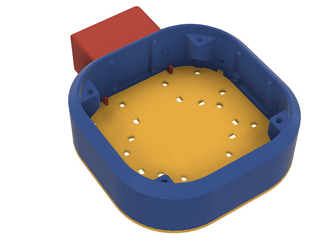

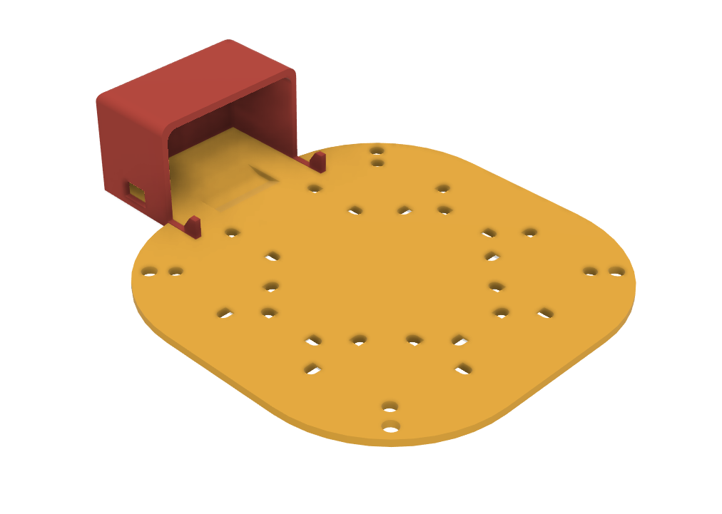

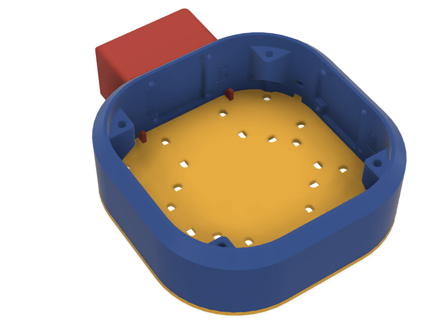

Moving forward on the second version with a “backpack”

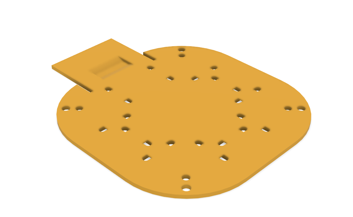

I made the electronics box cover a separate part, but was stumped about how I could fix it to the base…
Adding screws would make it very wide and not really sexy… But I think I found a pretty clever solution…
Here’s the base (it has an appendice for the box and a small dimple for cable passthrough):
Then I add the box
And when you slide in and secure the frame, it should all lock in place
Printing the first prototype right now…

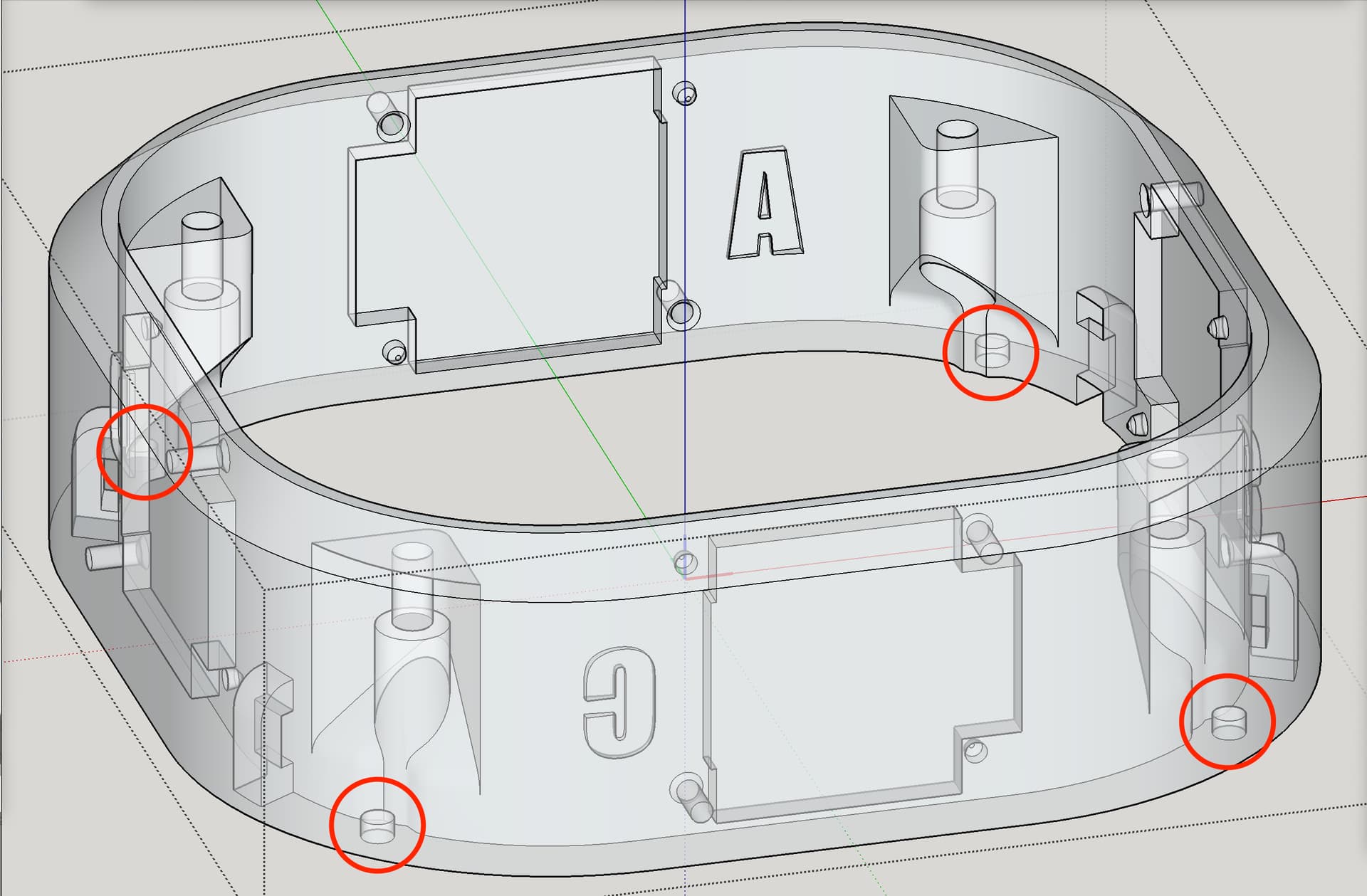

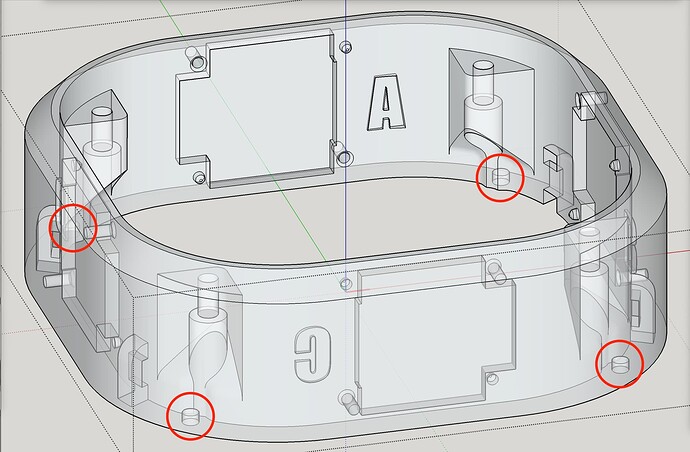

Thanks for the excellent remix! It seems nearly flawless. I see only one tiny issue. The screw holes highlighted here, look awfully shallow, like maybe they did not get adjusted after having the 10 mm sliced off.
Good catch!
I did see on mine that I had a layer separation when I tightened those
I’ll modify this thanks
EDIT: new version uploaded on printables
