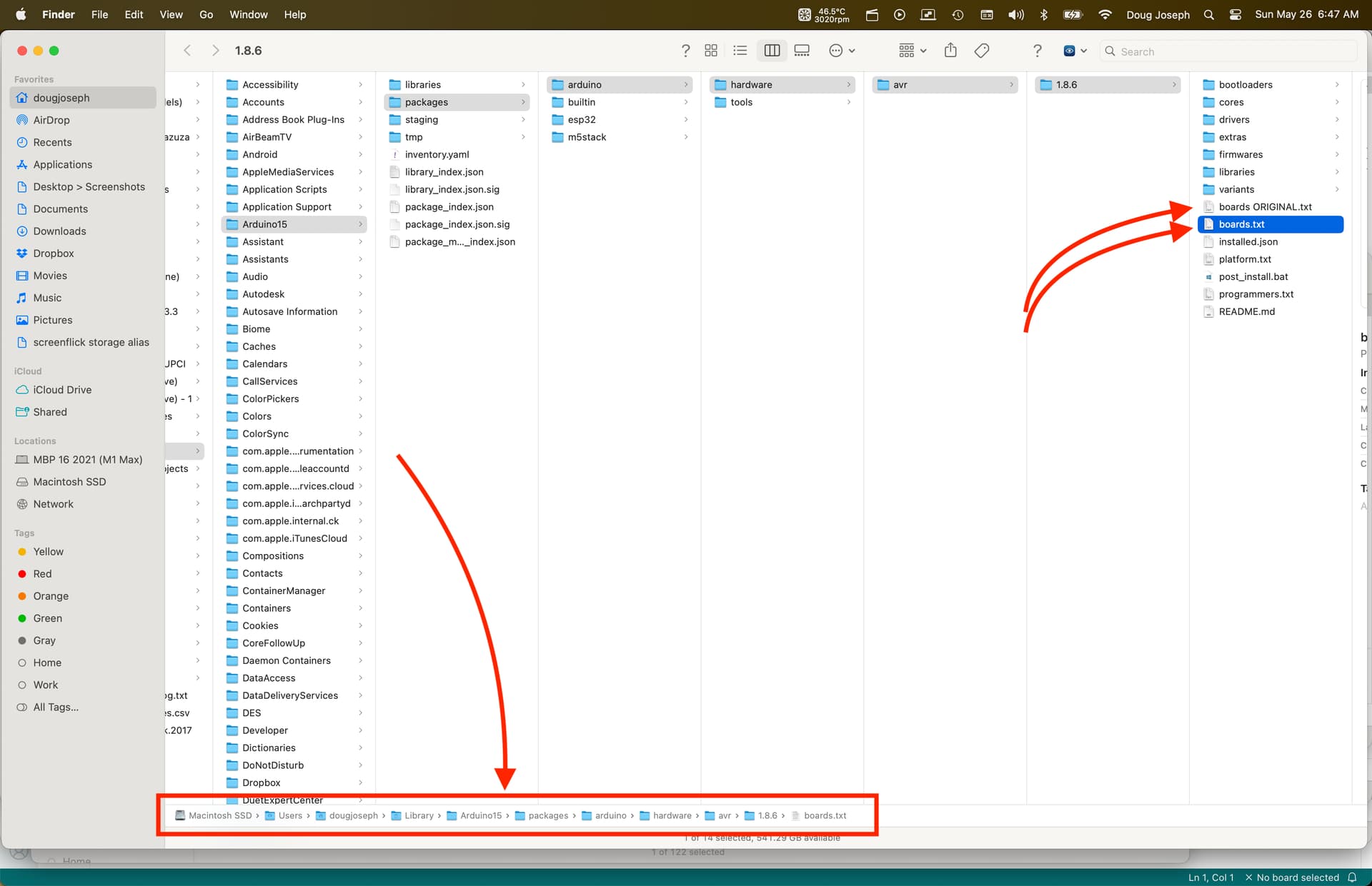

OK… well, I built mine, and it seems all good except I cannot get the 3Dconnexion software to recognize the new device.
All my soldering seems good, and all my wiring seems good. All debug modes show it working fine in the Arduino IDE. I renamed the device to “Spacemouse” in the boards.txt, and edited the vid= value and pid= value as shown.
The device seems to be perceived by my MacOS as simply being a mouse. I can move the mouse cursor on my MacBook Pro screen… up, down, left, right, etc.
Pushing down on the stem, or pulling up on it, gets “transform” type values as expected in the debug modes.
At this point a most important step, getting it recognized by the 3Dconnexion software, is holding me up.
Some other tips for MacOS users:
The instruction in the video for Windows users … to copy an “AVR” folder into the sketch folder, and then go into it, and replace the contents of “boards.txt” is not the same on a Mac.

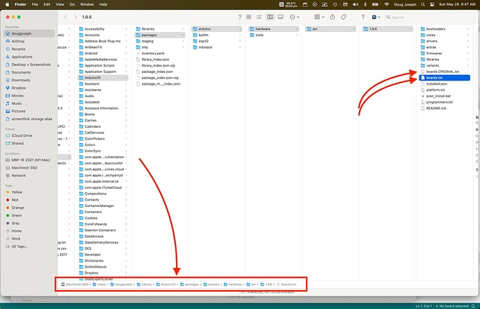

For boards.txt — on MacOS — how to edit Boards.txt was explained here (note the parts bolded by me): 'boards.txt' equivalent on mac? - #6 by bigrobintx - IDE 1.x - Arduino Forum
“resurrecting an ancient post, this is all i could find, and I have a bit different case. I’m using Sandeep Mistry’s Arduino Core for the Nordic nRF52xxx boards and as it is a downloaded package through the boards manager, and it uses a different processor core, compiler, and debugger (fun times!) there’s a bit more. After some digging I found the packages folder in the Library folder (open finder, click go, hold down option key and Library appears…) then in the Arduino15 folder you’ll see packages and staging… staging is like the downloads from libraries and board managers, tools, etc, packages is the live stuff… dig through there and in my case I found the boards.txt and variants folders as well as the json definitions of the package itself. Pretty slick. I’m using Kris Winer’s dev board and his board isn’t part of Sandeep’s package though I intend to submit it to him for inclusion. Hope this helps someone in the future.”

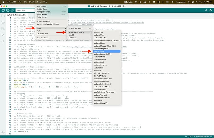

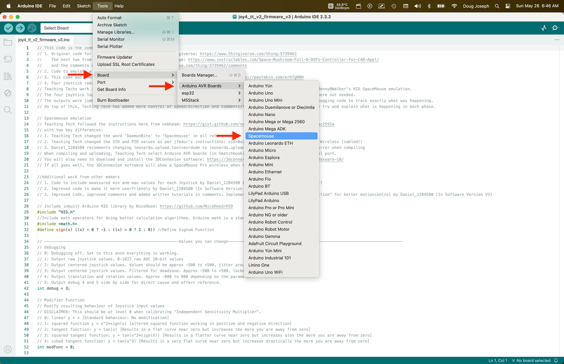

So, because I was editing the main boards.txt instead of a secondary one in a distinct sketch folder, instead replacing all the contents, I chose to merely add the new board details to the file, formatted like the others. This means that in the Arduino IDE app, I got a board choice of “Spacemouse” in my regular list of boards, not in a distinctly “in my sketch” location.
Here are some screenshots and my modified “boards.txt” in case it helps any other MacOS users attempting this build. In fact I’m including both the original boards.txt and the modified one. Their file names tell them apart. Use actual final filename of boards.txt.
Boards.txt, both Original and Modified versions.zip:
Boards.txt, both Original and Modified versions.zip (12.2 KB)
Screen shot of editing the file in its normal location:
Screen shot of choosing the new “Spacemouse” board in Arduino IDE:

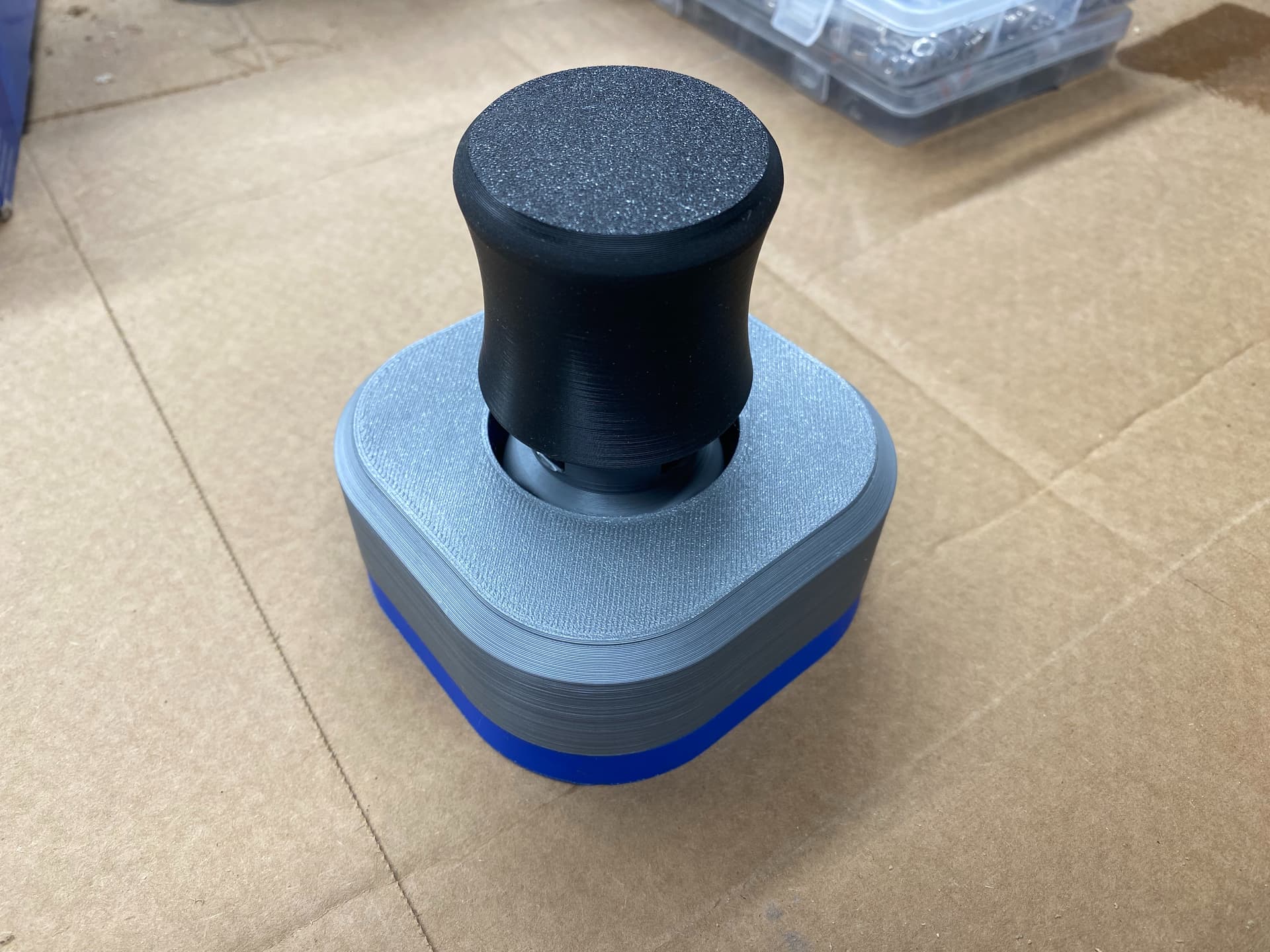

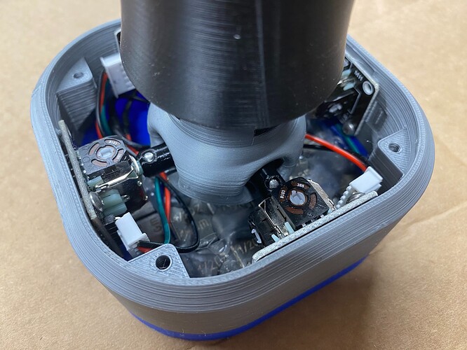

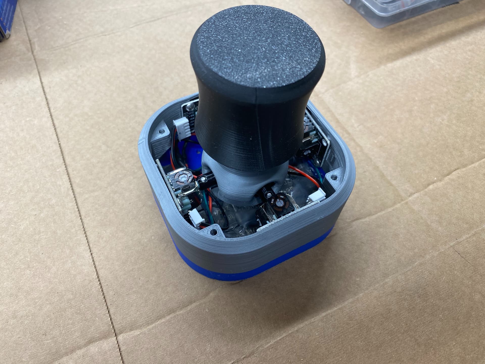

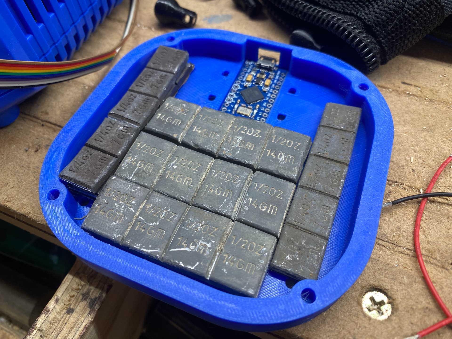

Pics of my build! This is based on @Fabien’s thin profile remix, plus my flush mount remix of the lid. I did @Fabien’s idea of hot-gluing lead strips for ballast.
I have posted this make over on Printables, including some additional details.
Looks like all your neighbors need to get the tires balanced :joy:
I looked for affordable sources for lead to use as ballast, and I eventually landed on recycled tire weights being sold as scrap, typically on eBay. I got 11 pounds of scrap lead for less than $2 a pound. There may be a better, more affordable source than that, but it was not to be found when I looked. That was the best I could do.

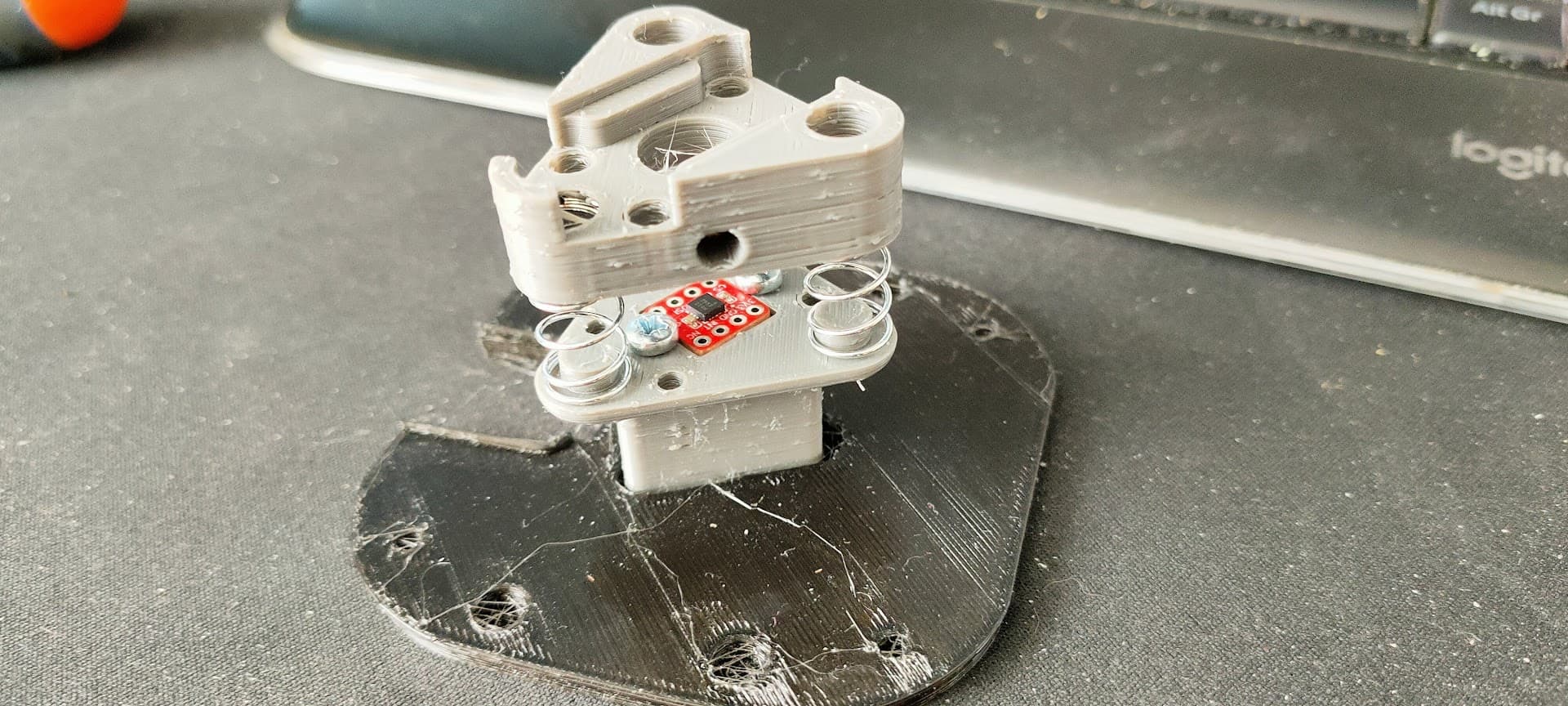

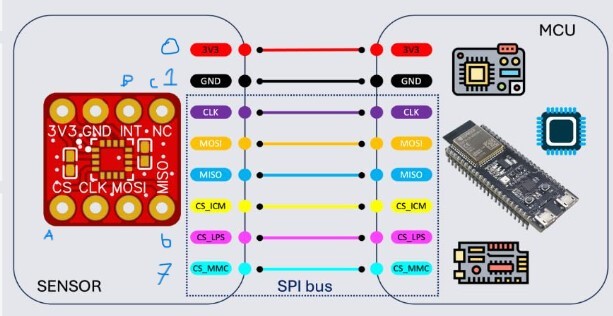

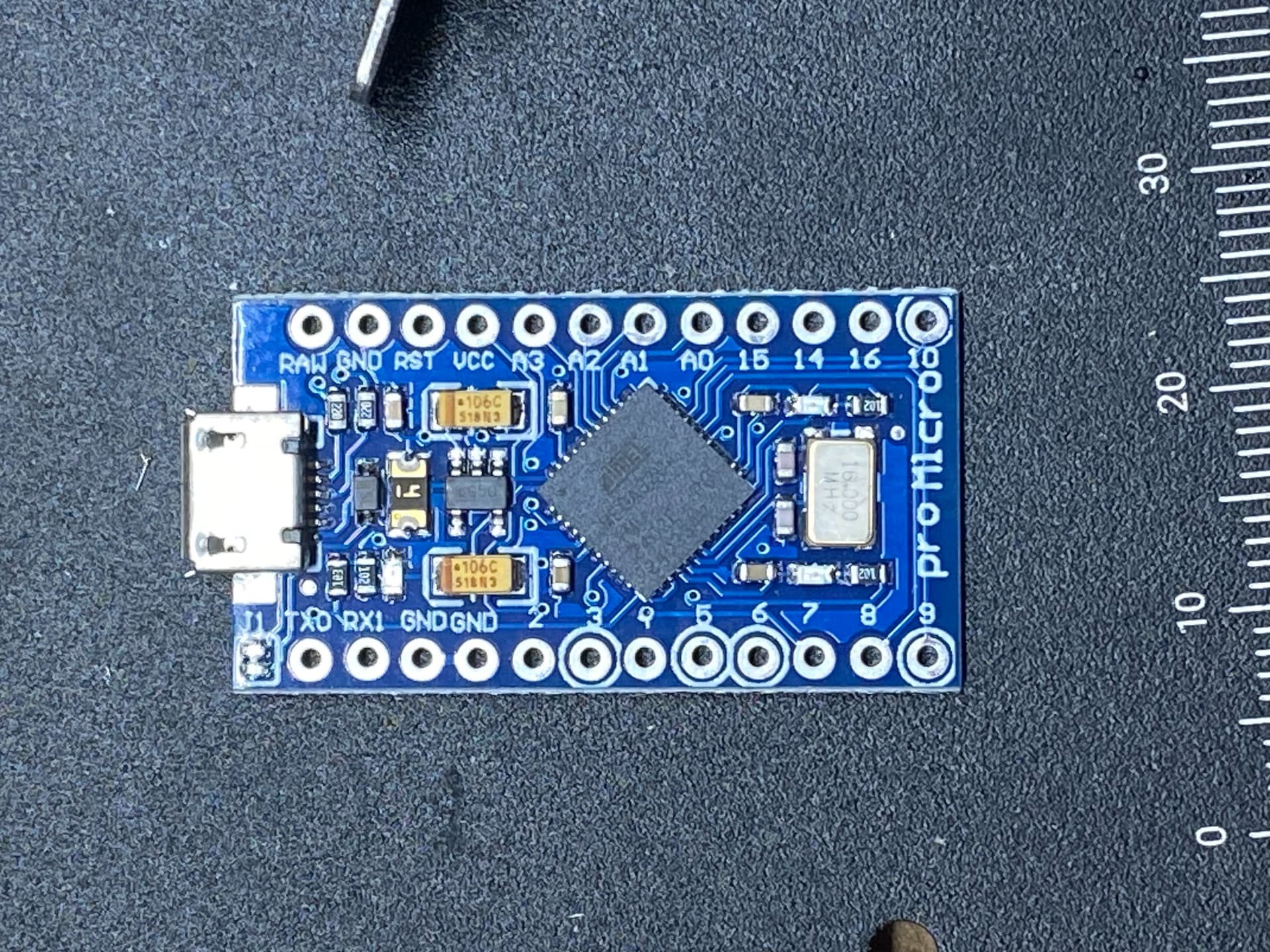

So… I couldn’t find the exact same models as the BOM for RPI2040 and magnetometer
I thought “hey, this one should be close enough right?”
And now, here I am, looking at pinouts that just don’t match >_<
If anyone clever-er than me in this field can chime in and take a look, that would be greatly appreciated (I ordered the BOM specific hardware on ali via the slow boat in the meantime so…)

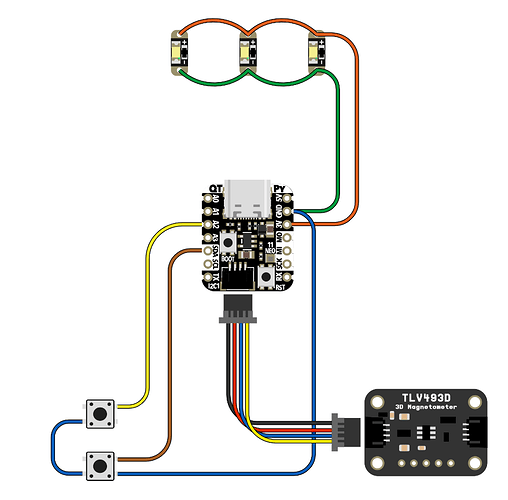

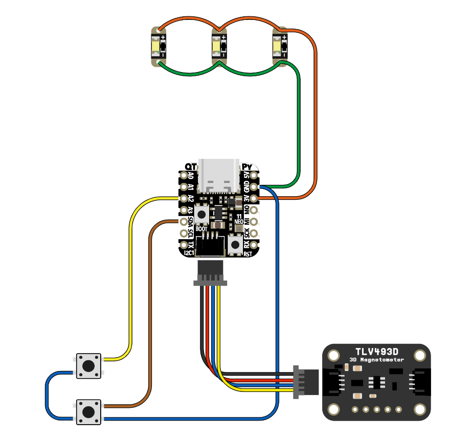

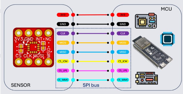

Here’s what the BOM calls for:
Of course, being an Adafruit “plug and play” type of kit/component, the wiring diagram is pretty much useless:

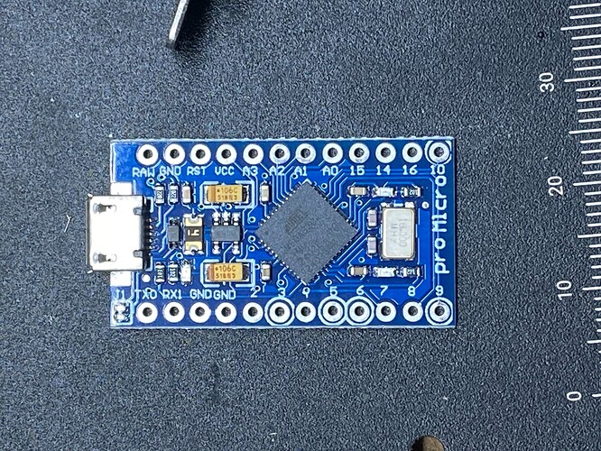

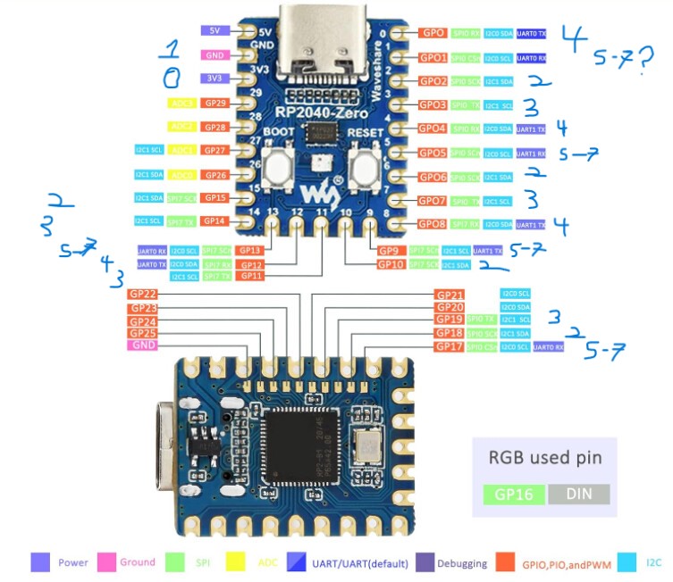

And here’s what I got:
The magnetometer calls for this wiring diagram, but I can’t figure out where those CLK/MOSI/… pins are on my rpi2040

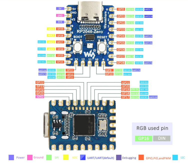

Pinout of the RPI2040 board:
If we can figure out the pins, I’ll probably continue with those, otherwise I’ll just have to wait for the next delivery
I got it working, with the V3 software, thanks for (re)sharing! Now for some finetuning
Can you link the source for the RP2040 pinout? AFAICT it’s identical to this pinout from waveshare… but it’s rather hard to read. Waveshare’s copy seems to duplicate a lot of labels; half of SPI is for SPI 0 and the other half SPI 1.
If identical, my guesses about SPI are numbered (poorly) in the pictures. SPI only defines a few signals, so I’m not sure what ‘INT’ and ‘NC’ are, but I’d assume ‘CS’ is chip select.
On the PR2040 pic, nothing links CS (labeled ‘A’), INT (‘B’), and NC (‘C’) to the ICM LPS and MMC pins. I’d probably link A, B, and C to one of the many CSn pins and see how it responds.
Magnetometer is labeled serially from 0 to 7:
magnetometer
RP2040 labeled all the copies based on Waveshare’s enhanced pixel count:
I hope that’s useful – I’d like to build a space mouse as well.
I will try this.
I think I’ll need t declare the matching pins in the arduino sketch too? that’s a lot of unknown variables to deal with :confused:
In the meantime; I’ve been thinking about another contraption for a spacemouse… I kinda like this idea…

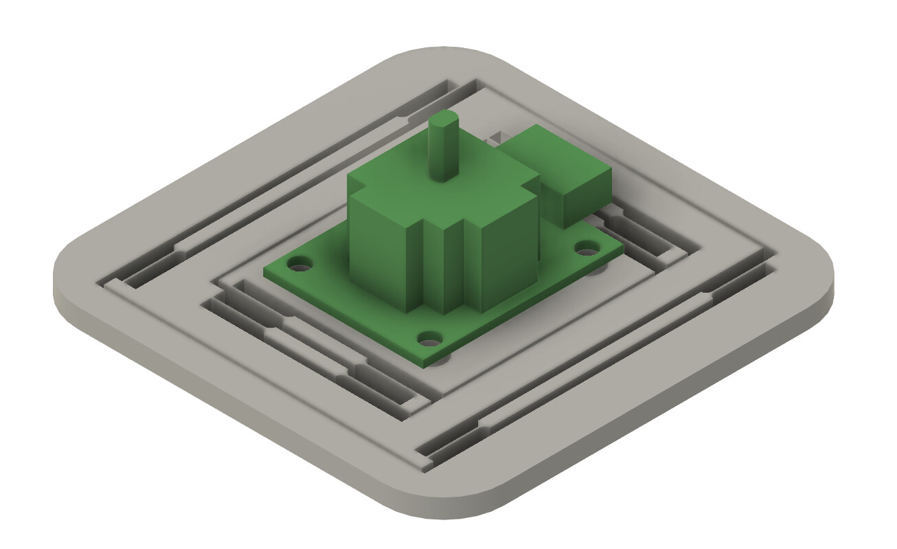

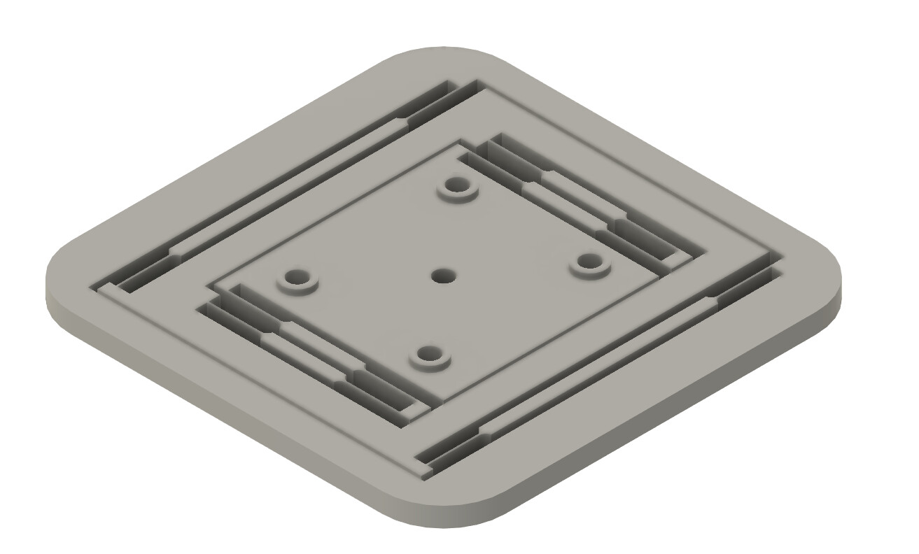

I found this model of a XY Flexure plate…
What if we stick a joysick on this… ?

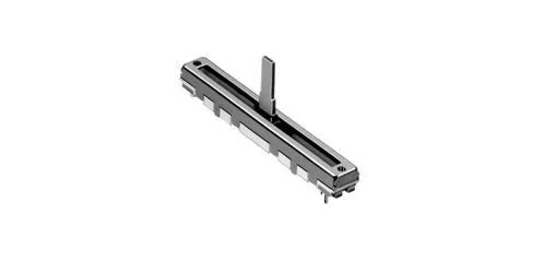

And add some slide potentiometers on the sides?
This would still lack the twist and up/down motion…
I think a custom flexure design could take care of the twist aspect though

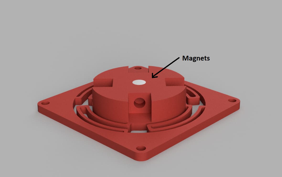

The more I look at it, the more I see potential in those flexure designs for this kind of application…
eg. what about this one?
Looks exiting!

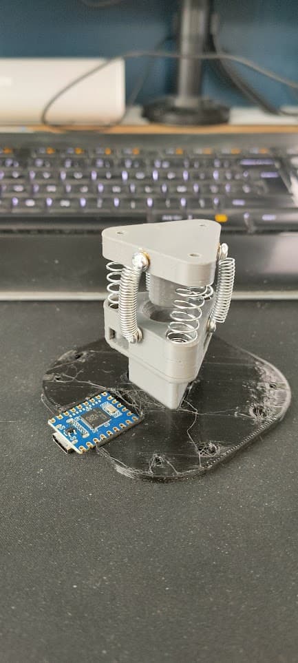

Might be worth nothing, but I’m having fun mocking some ideas… Printing a few prototypes to see if this would work…

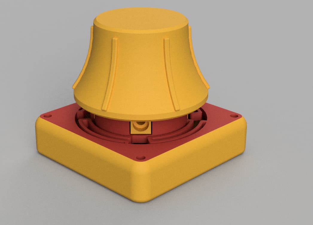

Combining this “flexure” approach with a magnetometer could yield a great potential
I was thinking the magnet could be in the sides and in the bottom and the chip in the middle?
