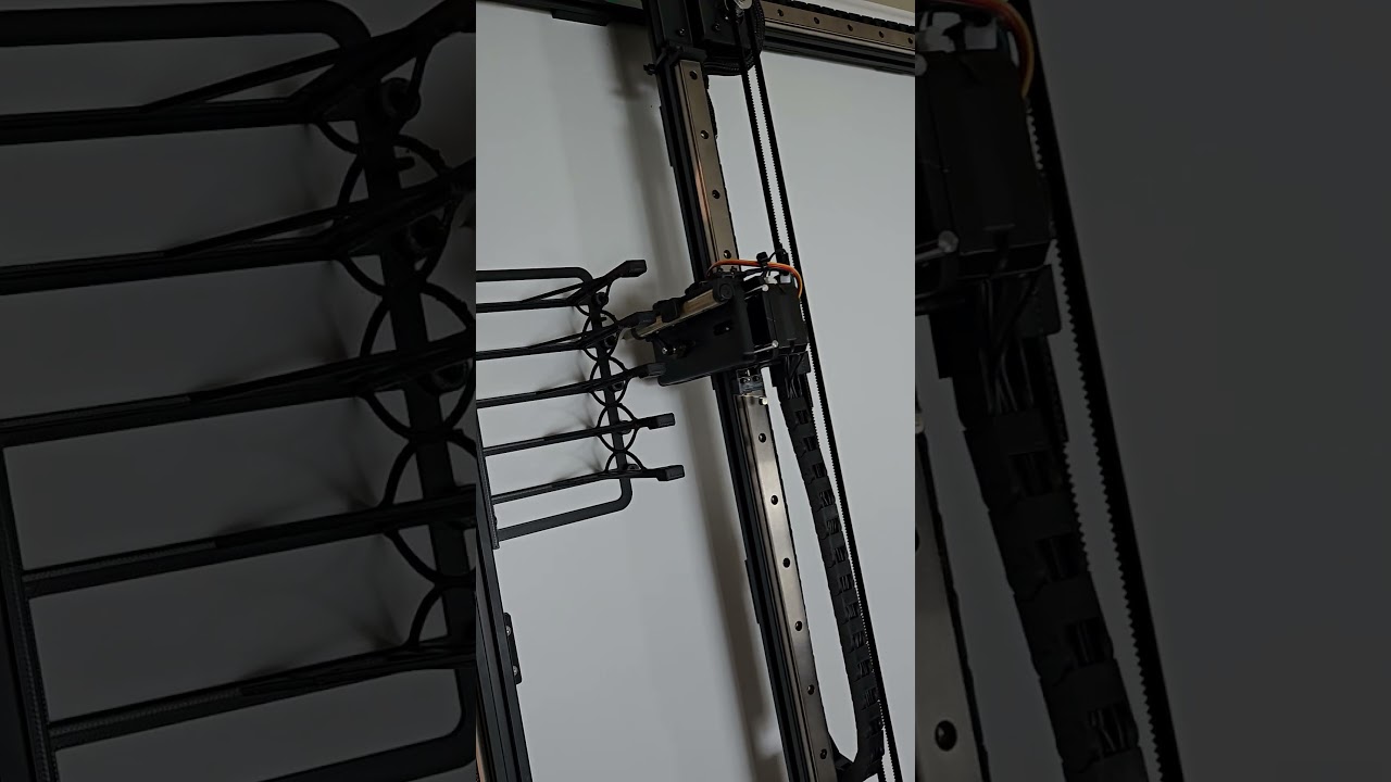

Here is a typical tool change macro that retrieves a pen:
G90 G53 X67 Y710 (Go to Absolute, Machine coords, Toolbin entry/exit point)
Z1.0 (Move Z to pen retrieval height)
G91 (Switch to Relative moves)
Y0 (Line up with the pen#. Pen#1=0, Pen#2=-30, Pen#3=-60 …)
M3S100 (Open servo)
Y4 (Move 4mm up so pen ‘claw’ clears the pen bracket)
X-66 (Position claw over pen horizontally)
Y-4 (Move claw down around pen bracket)
M3S0 (Close servo)
Z10 (Lift pen to Z removal height)
X66 (Move back to Toolbin Entry X)
Y0 (Move back to Toolbin Entry Y, Pen#1=0, Pen#2=30, Pen#3=60 … )
Z-5.5 (Position Z to safe travel height)
G90 (Switch back to Absolute mode)
G54 (Ensure we are back in Work Coords)
Here is the macro that replaces a pen:
G90 G53 X67 Y710
Z10.5 (Move Z to pen replacement height)
G91
Y0 (Pen#1=0, Pen#2=-30, Pen#3=-60 …)
X-66
Z-9.5
M3S100
Y4
X66
Y-4
Z4.5
Y0 (0=Pen#1, 30=Pen#2, 60=Pen#3 …)
G90
G54
Notes
  • I recently added the G54 at the end to hopefully prevent the glitch from happening again
  • In the first line, Y710 represents the Y position of the 1st (uppermost) slot in the pen holder (toolbin). That can be wherever makes sense on your plotter.
  • If you use my 3d Printed holder, pen spacing is 30mm
  • Note that the variables are on lines 4 and 12 of each macro.
  • Y distance = (pen# - 1) * 30 and either positive or negative depending on the situation
  • Consider making the X offset (where you see X66 and X-66 above) a variable. That way, if the homed X position needs to be tweaked a tenth of a millimeter or two in order to smooth out the pen replacement and retrieval, you can do it in the post processing instead of adjusting the X homing screw on the machine. Same goes for the Z heights.
So, the logic I use in my post processor is:
  • When it hits T00 or M30 in the gcode, it replaces the current pen if needed (2nd macro above) after moving Z to a safe travel height.
  • When it hits T?? in the code (where ?? is 01, 02 …) if it has a pen already, it replaces it (if the number is different from the pen it has) and then retrieves the new one (1st macro above).
  • Safe travel height (Z) is up to you. Technically 2.0 is safe as long as the paper is laying flat on the back board, but that is not always the case. I currently use around 5.0.
!!! When creating macros or doing post processing, always consider the Z height before moving in the X and/or Y.

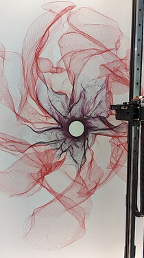

I’m a bit mesmerized by this…
Talk about mesmerizing. Wait until you start drawing generative art.
Never gets old. AI is definitely in it’s future. That way even I won’t know what it will do next.
And when you’ve plotted something already, you go back and mess with the colors, do an overlap or offset and come up with something even more interesting…
There are so many fun things to do with this that I don’t even know where to start!

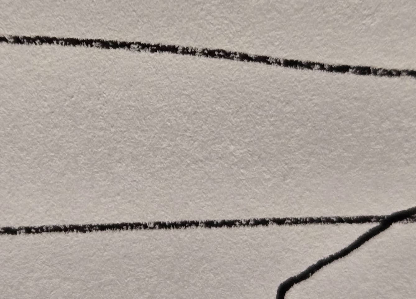

Went with your recommendation. Pigma Micron 05
I’m not sure yet if I’m using a good Z height for drawing. I’m at -8. It touches around -1 and bottoms out at -11. That doesn’t mean mm so I just picked something. The spring will let it move up from there about 3 mm.
I’m not sure it was necessary but I added 3 extra washers to the spring. That was a couple weeks ago so it wasn’t anything I changed based on actual usage. My thought at the time was to give the spring slightly more resistance when fully extended.
I’ve found that when using a Micron, you want the least amount of pressure that keeps the tip of the pen in contact with the paper. The Microns will last about 5 hours that way. With 3 washers, I think you would reduce that time. And after 30 mins, the line will start getting wider as the tip wears down. Actually, you notice the increased line width with just one washer. But for speed drawing, I think you might need the extra pressure so the pen keeps up. For ball points, the extra pressure is probably better.

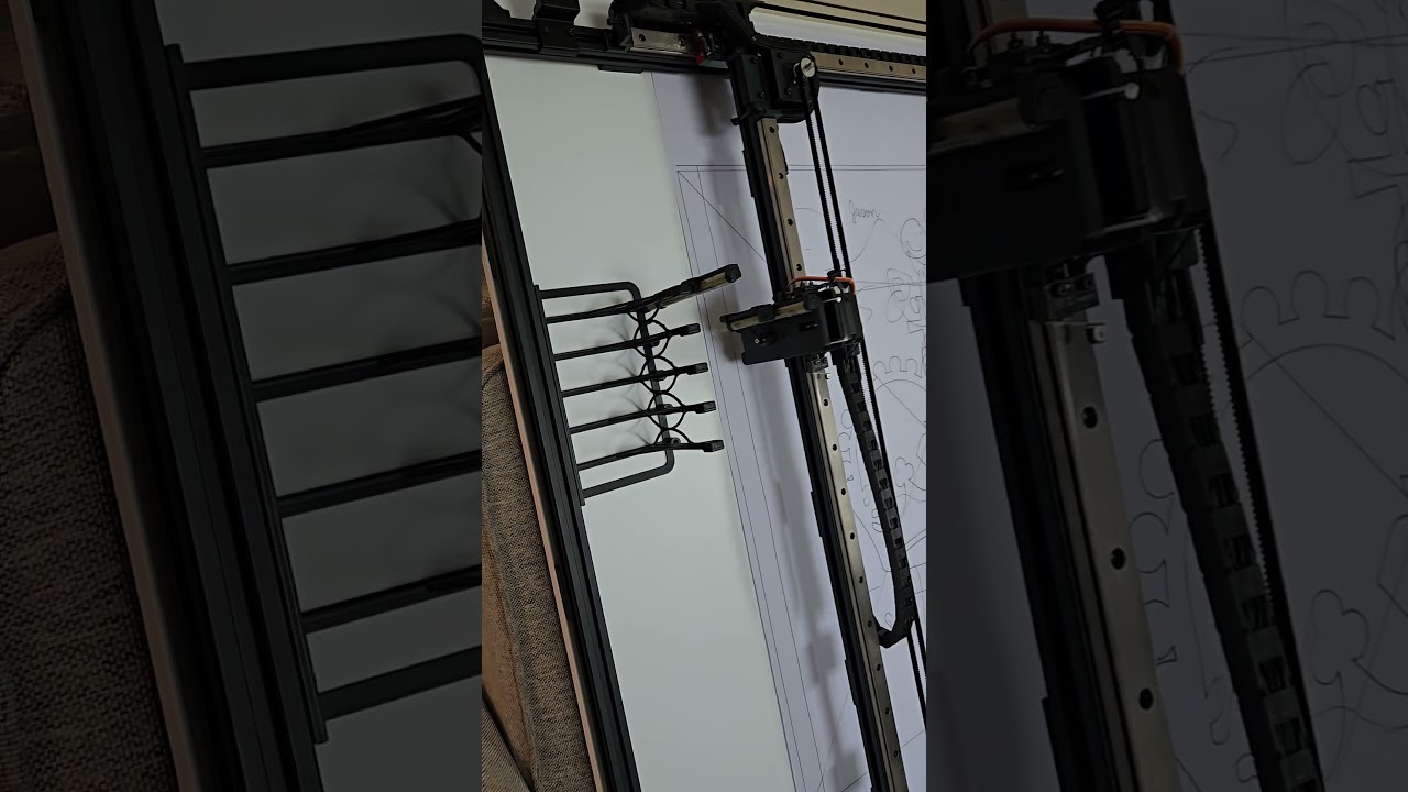

Then I got M6 macros working.
Updated the startup macro in the config.yaml:
macros:
  startup_line0: $SD/Run=init.gcode
init.gcode
#<_PenActive>=#5400
$H
Updated the m6 macro for the BESC spindle in config.yaml:
BESC:
  m6_macro: $SD/Run=penmacro.gcode
penmacro.gcode
#<Feedrate>=5000
#<PenNew>=#5400
#<PenOld>=#<_PenActive>
G54
F#<Feedrate>
(Return the old pen)
o100 if[#<PenOld> GT 0]
  #<YOffset>=[[#<PenOld>-1]*-30]
  G30 (move to the toolbin entry point)
  G1 Z10 (lift the pen so it clears the well)
  G91 (switch to relative)
  G1 Y#<YOffset>
  G1 G53 X1 (move to X1 in machine coords)
  G1 Z-9.5 (lower the pen into the well)
  M3S100 (release the claw)
  G1 Y4 (move the claw away from the pen)
  G90
  G1 X0 (move back to the entry point X)
  G91
  G1 Y-4 (move back to the entry point Y)
  G90 (switch back to absolute coords)
  #<_PenActive>=0
o100 endif
(Get the new pen)
o101 if[#<PenNew> GT 0]
  #<YOffset>=[[#<PenNew>-1]*-30]
  G1 Z1 (this is the height at which the claw grabs the pens)
  G1 Y#<YOffset>
  M3S100 (ensure servo is open)
  G1 Y4 (move 4mm up)
  G1 Y-4 (move down 4mm so the claw is around the pen)
  M3S0 (grab the pen with the servo)
  G1 Z10 (lift the pen out of the well)
  G1 X0 (move back to the toolbin entry point)
  #<_PenActive>=#<PenNew>
o101 endif
That should simplify post processing a bit. Here’s a video. This is just running “M6 T2” and then “M6 T1”. I may make some minor tweaks but it works. If you send “M6 T0” it will put the current pen back. I might update the script to send an alarm if you use a tool number higher than 5.

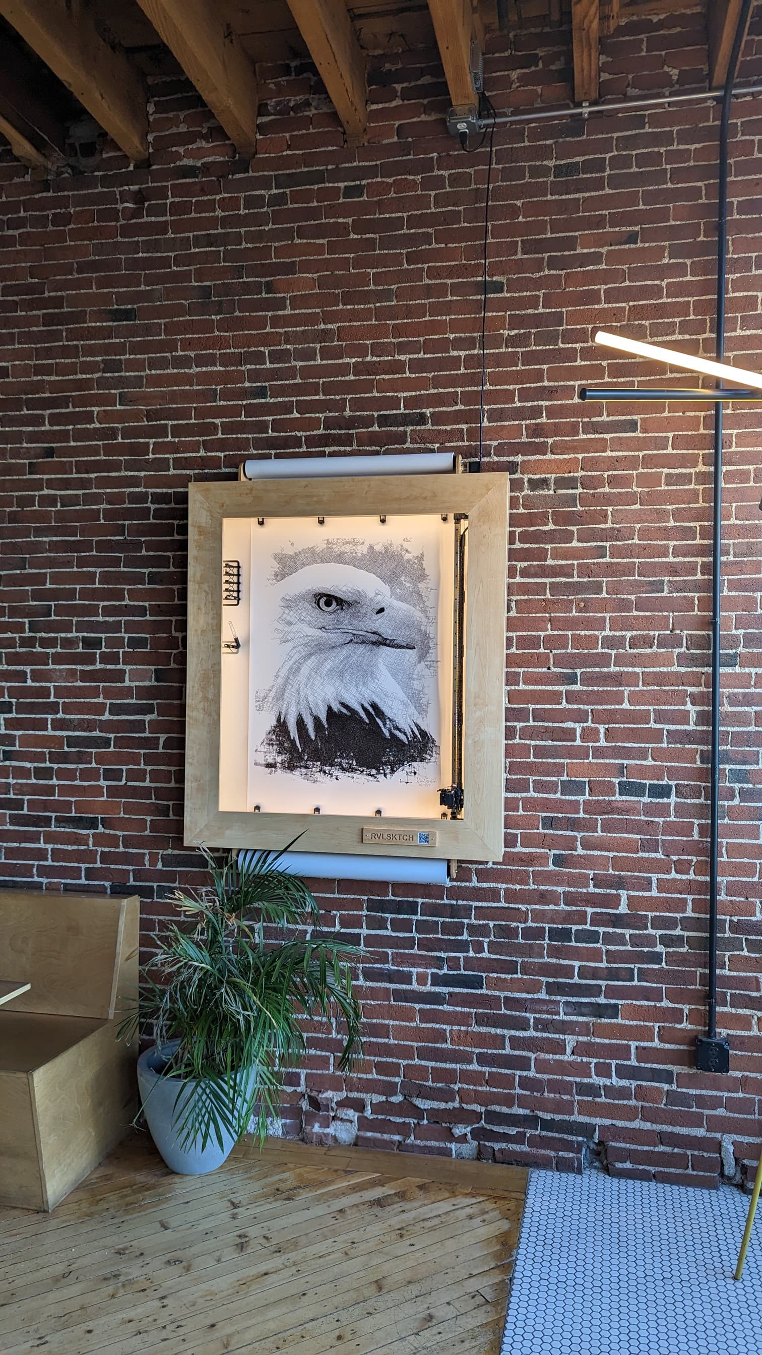

Finally hung a plotter on the wall at the coffee shop.

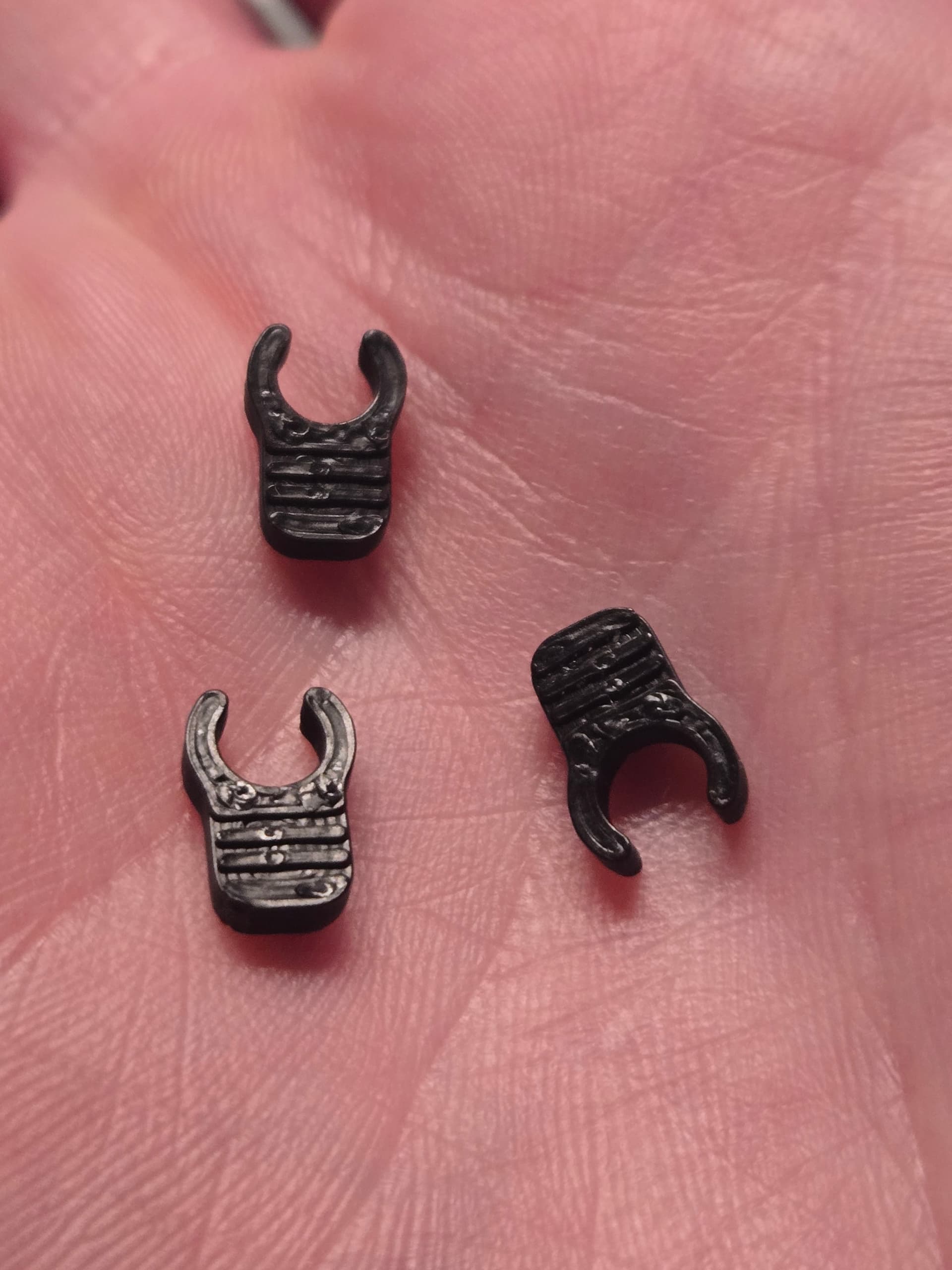

I removed my extra washers. Without them, the now flattened tip of the micron doesn’t have enough pressure for a fully solid line but it’s great with a fresh pen.
Instead, I printed out some ridiculously small clips that I can use to test out different spring pressures. They just clip on next to the washer. I need to make the tab bigger but it conceptually works.
3 of them uses 0.34 grams of filament.

Thanks. It’s been a huge hit so far. Lot’s of interest, comments and suggestions. It’s cool that you can make something with old technology (pen plotters were first introduced back in the 1960s, I believe) but present it in such a way that it captivates people who are otherwise calloused by new technology.
We are trying to plot at least 3 things a week. Keeping the photo conversions related to local lore or landmarks or a “this day in history” type of thing. I think Albert Einstein is on deck because he submitted his paper on the General Theory of Relativity on 20 March 1916. It took them a few months to actually publish it, probably because nobody understood what he was talking about at the time. :joy:
Anyways, there is a QR code on the frame that opens a page with a description/explanation of the device (embellished by AI) followed by a link to the current plot and from there you can see the entire history of what it has drawn.

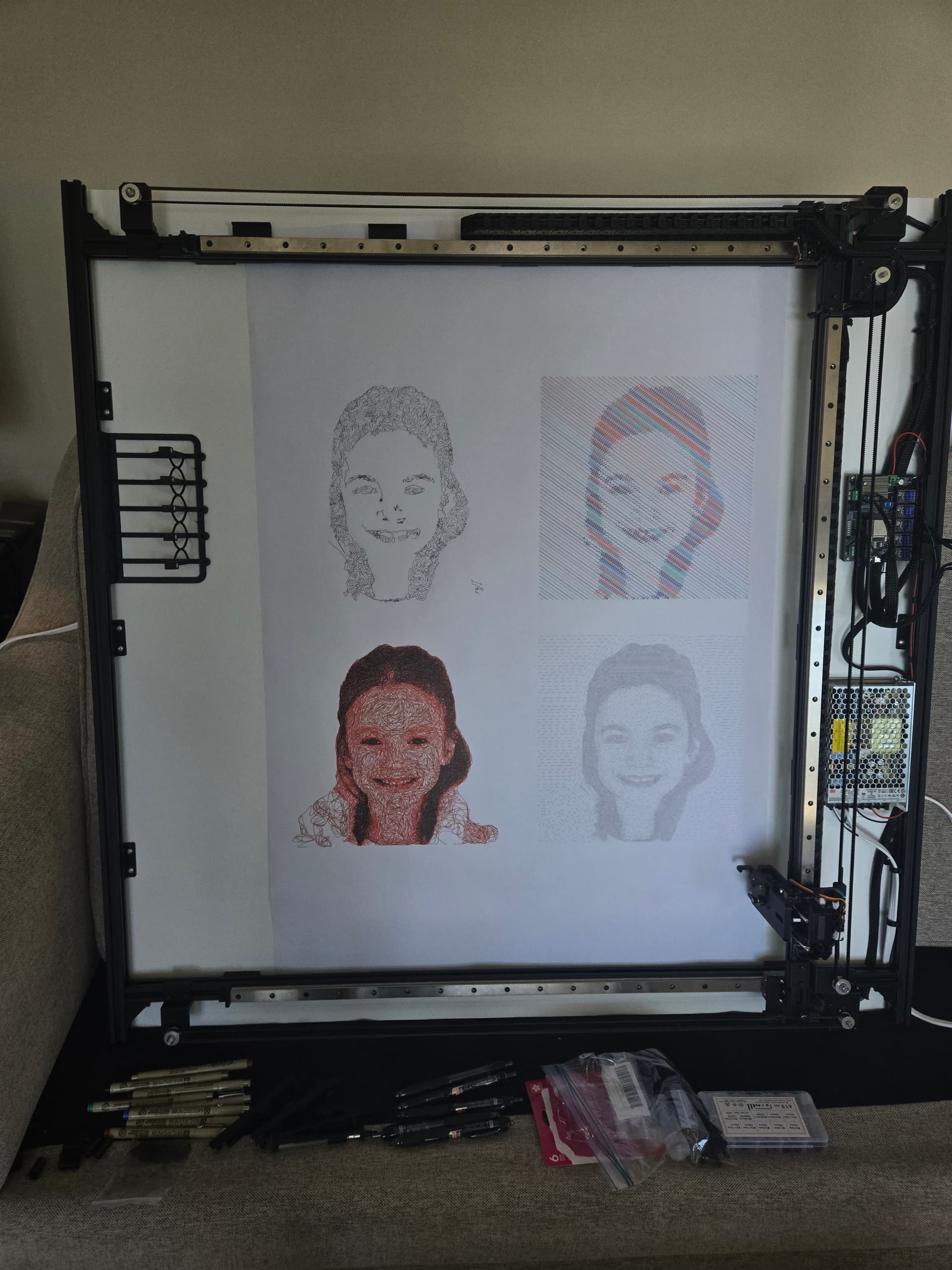

I ended up buying the DrawingBotv3 app. There’s a crazy number of options. I’ve been drawing things at quarter size for trying things out. I’ll end up slowing the speed down to zen mode when I’m not playing but not currently doing speed tests either.
Here’s some drawings of my daughter using the same image. Top left and bottom right are with a Uni-ball Powertank. Top left is darker because I made it skip steps to force the pen onto the page and drew it twice. Bottom right has over 7400 pen lifts. Bottom left is 3 colors with Pigma Microns. Top right is 4 colors with Pigma Microns.
Now I just need to get it off the couch. My wife isn’t a fan of it’s current location that is conveniently right next to my computer. I plan to put it on the wall in the next week and do lighting and frame afterwards.
