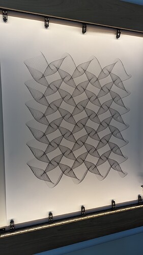

I’ve been spending some time playing around with a computer language called R, which I had never heard of until a few days ago. It’s main focus is statistical data analysis and visual representation. Turns out it is well suited to creating generative art. Anyways, I managed to come up with this…
I suspect that I will be spending a lot more time down in this rabbit hole.

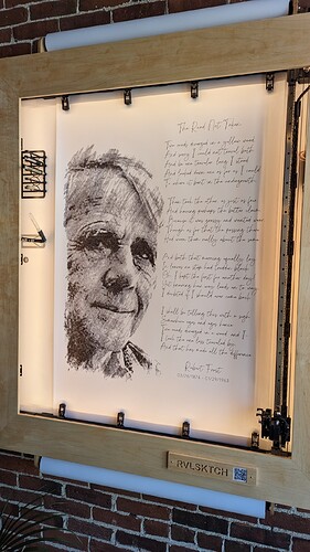

Thanks Riley. I’m fortunate in that I got to hang one of these things in a public place where a lot of people can watch it do it’s thing. Creating content is a bit time consuming, but I’m enjoying the experience. It was, or would have been, Robert Frost’s birthday today, so I paid him a little tribute…
I didn’t particularly enjoy High School English class (was more of a math, science and woodshop guy) but this poem stuck with me.

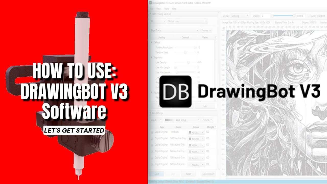

As for the photo conversions, I use some open-source Java software that I found on GitHub. It can be found here: Drawbot_image_to_gcode_v2. If you are not familiar with Java programming, there is a program (no coding required) you will find here: DrawingBotV3 which is based on the code that I use. I like the java code because I can customize it to my needs, however, the paid version of DrawingBotV3 does a lot more that the v2 code. I’m thinking about buying it to explore.
Both programs are based on the same algorithm, which basically analyzes a photo, groups areas in the photo from darkest to lightest, will color match if you want to use colored pens, and starts scribbling lines. The algorithm loves texture and contrast. It struggles with very dark or very light images as well as washed out and grainy photos. For instance, the previous image used an old photo of Robert Frost (who died before digital photography was invented) so it took me a while to get it to work, and it still isn’t that great compared to some others. Some images (like RF’s) need to be photoshopped for 30 minutes or so until they are acceptable.

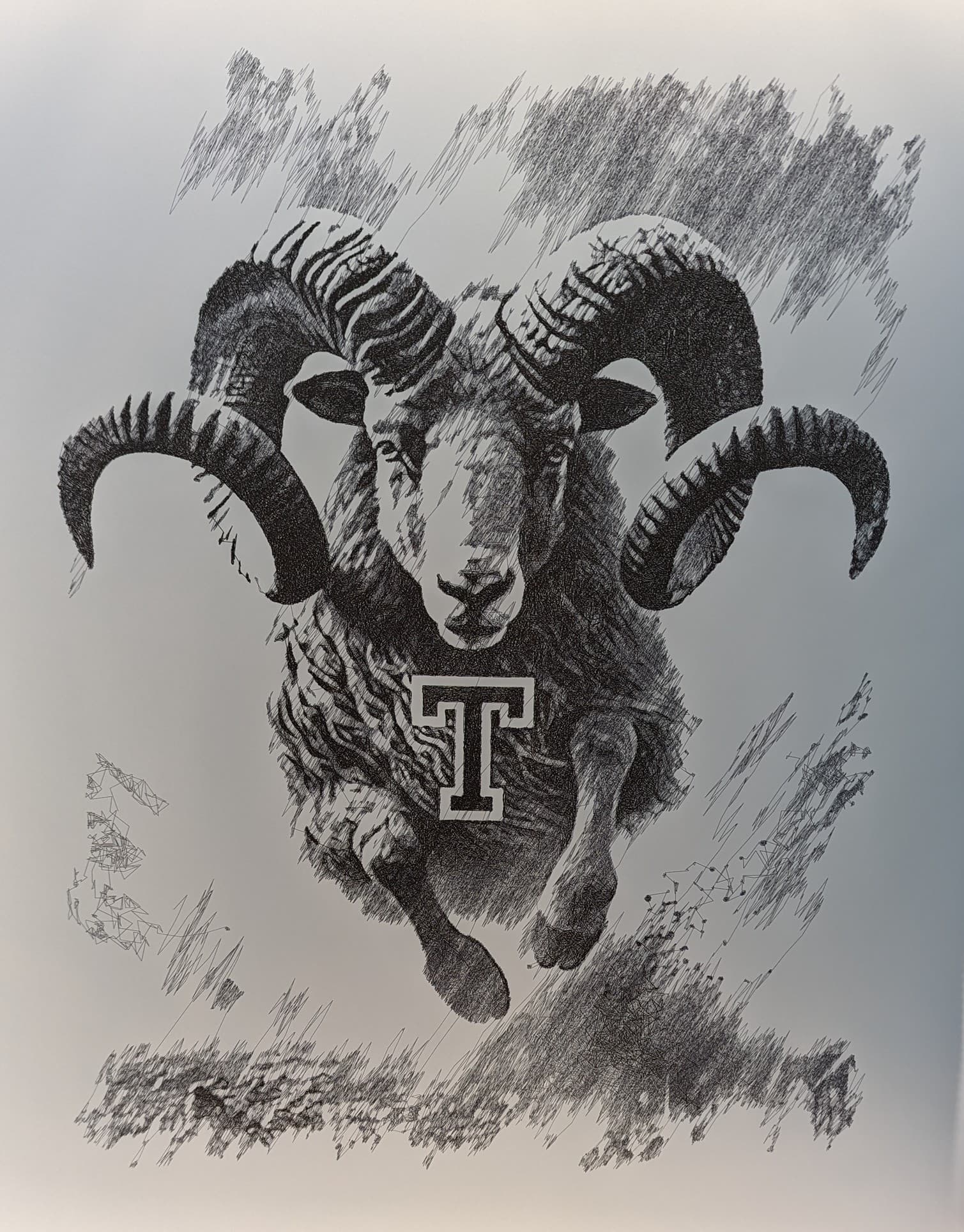

In comparison, I have started to use AI to generate the source images whenever possible. There have been some recent breakthroughs in AI image generation which are nothing less than astounding. Here is an example - my son wanted the machine to draw a charging ram for a private party who booked the use of the coffee shop (after hours) last week. They were associated with a local school whose mascot is a ram. I couldn’t find a photo online that worked, so I turned to chatGPT (Dalle) and in 5 minutes had this:
I then photoshopped a T (from the school’s logo) on its chest and ran it through the drawbot software. In another 5 minutes I had the gcode that made this:
They don’t always go that smooth, but I’m excited about the AI images because of the detail. For instance, the lighting, contour and shading in the horns and fur really made this an exceptional candidate for conversion. It’s where the software really shines.

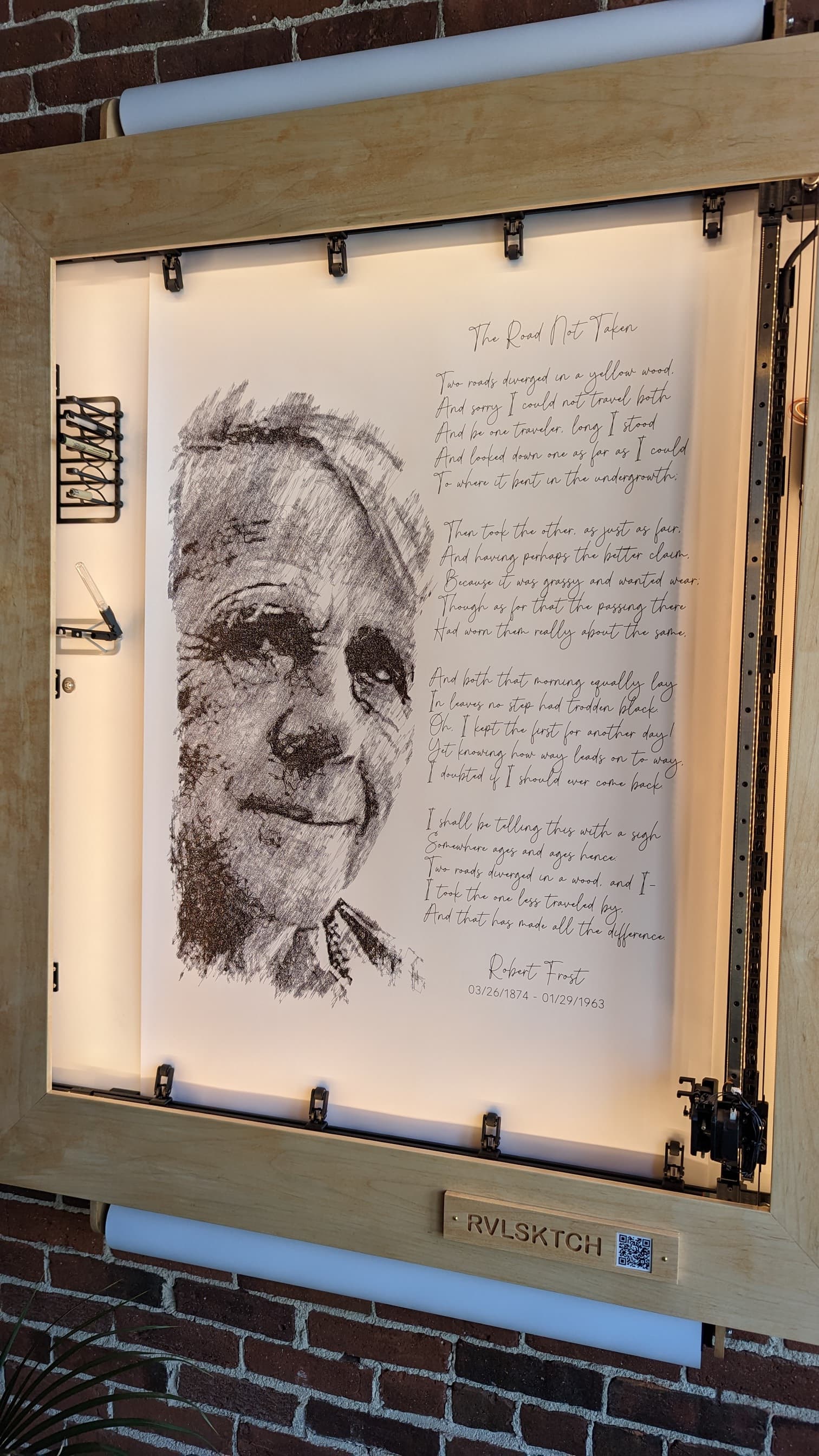

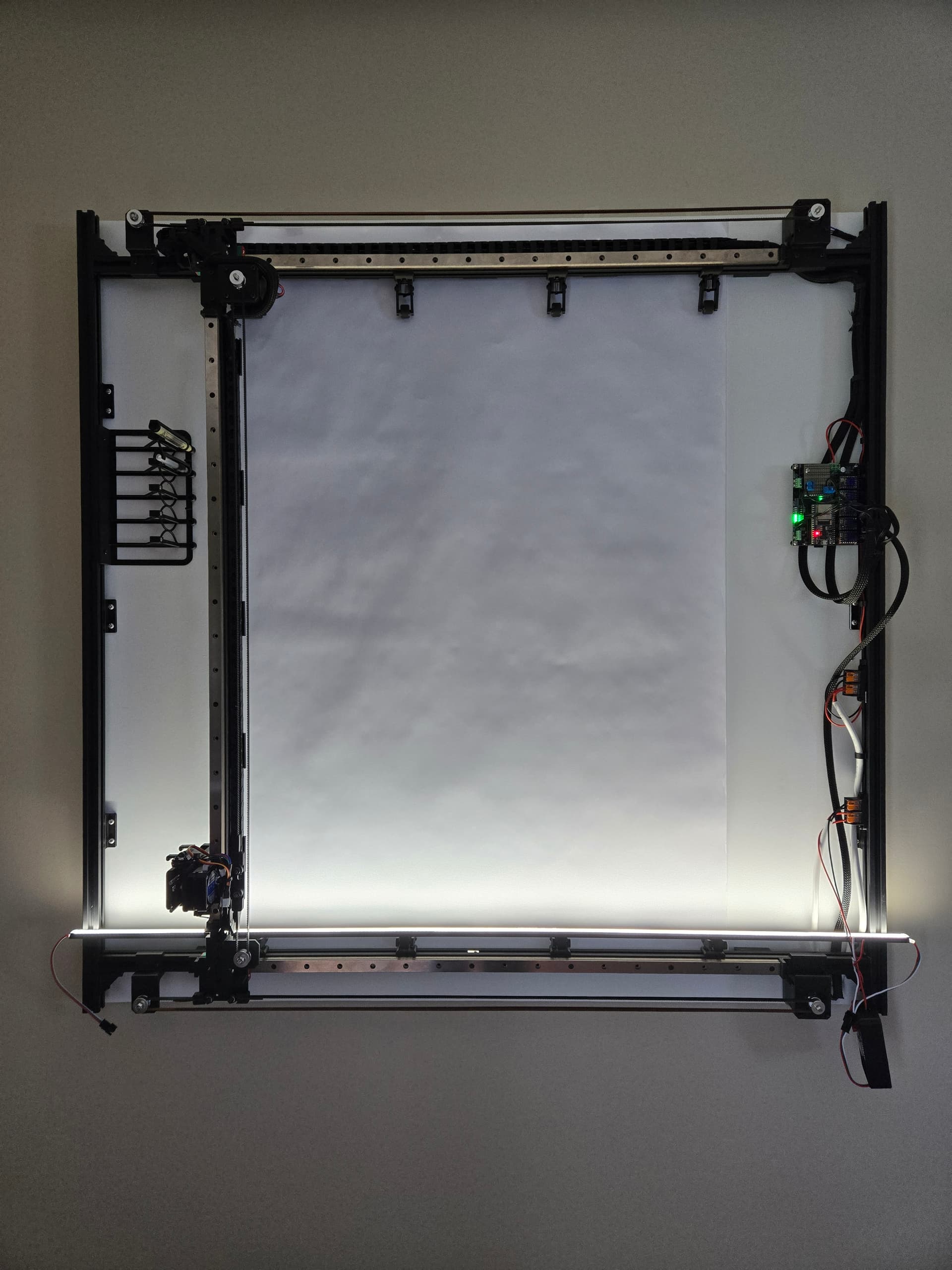

I did get my plotter mounted to the wall and power run through the wall to a supply mounted in my basement. So, it’s back running again. Need to play with LED mounting. I have an idea in my head about making some printed parts to mount LED channel to the extrusion so it’s independent of the frame. I also have to figure out how I’m mounting the paper roll to the wall. I think I’m going to mount it directly on the wall so that too is independent of the frame. I’m not sure what I stand to gain by putting a motor on that.
You might think it is monotonous, but watching something like that being drawn is mesmerizing. Noise can make the final image more interesting, but symmetry has a place as well.
If you can figure out how to mount the LEDs to the frame, do it. Same goes for keeping the paper separate. The goal being to be able to remove the frame without having to remove the paper or disconnect the lights. One thing that bothers me a little is the shadow cast by the gantry from the LEDs on the left and right. I don’t know if that can be avoided, but just another thing to consider.
I wouldn’t be surprised if we ditched the paper advance motor in the near future. Was thinking I might mount the fresh roll on the top, then manually pull it down for a new canvas. I also have a few ideas in my head for a cutter like you see on some plastic wrap boxes (and food savers) where a protected blade runs back and forth in a channel that slices the paper off cleanly and evenly.

Wow, Drawingbot is kinda cool. Just found this to check it out!

Do you think having LEDs only on the top and bottom would be sufficient? Did you start with just left and right, and then add the top and bottom? Or the other way around? I at least I thought I read something like that in this topic somewhere.

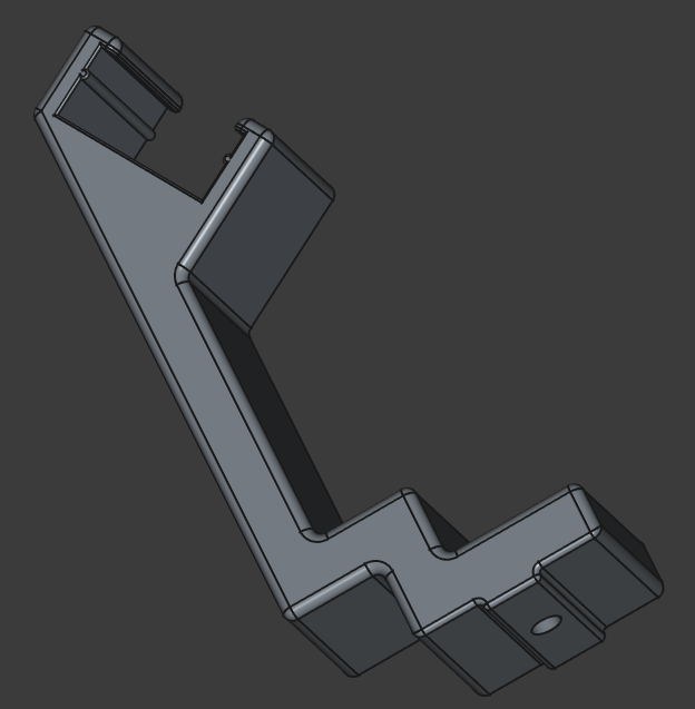

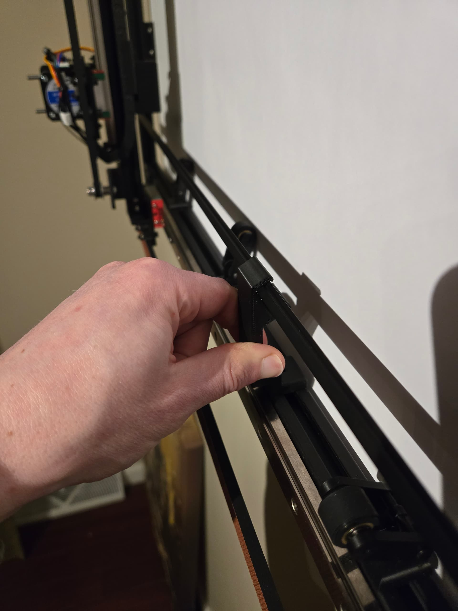

I’m playing with mounting them top and bottom below the gantry. This would require a rather thick frame to hide but if not at least the LED channel has a clean look. The LEDs are pointed toward the board at an angle. Mounting them low like that would prevent shadows from the gantry. It still leaves room for the rollers to swing out. Although, maybe I could limit how far they can swing and shorten it.
I’m going to try this out tomorrow. If this doesn’t work out, I can just mount it to the wood frame. Either way, it’s fun to mess with.

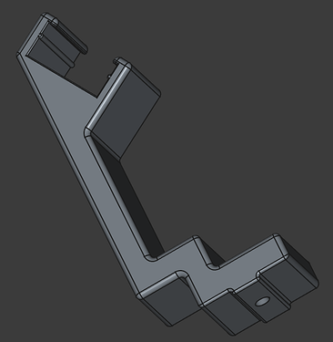

That 3d printed part is likely only needed on the ends but I made sure there was clearance in case one was needed for support in the middle. Top and bottom had different restrictions.
I think I now understand how to not anger FreeCAD when doing fillets.
Well that didn’t work out. I’m going to try a higher mount more similar to if it was mounted to the wood frame. Light doesn’t reach the middle and the angle highlights the ripples in the paper.
For reference, my light strips are 3" off the face of the extrusion frame and are angled so they face directly at the center of the print area. To be honest, I don’t think you’ll get much better than what you have now, but obviously the further from the paper surface the better. A couple things that helped for me - less intensity was better, in that it lessens the contrast between the bright area on the edges compared to the relatively “unlit” area in the middle and doesn’t accentuate the wrinkles in the paper. So, I went with a warmer (yellower) led, and as I mentioned before, 25% duty cycle on the brightness.
My memory is a little fuzzy, but I think what I did first was to connect all four edges to one switch. Then, when I didn’t like the gantry shadow, I rewired them so top/bottom and left/right were on separate switches. For my home plotter, I typically have everything lit during a plot, then turn off the sides when the gantry is parked on the right side (lighting is set in each plot’s gcode by the pre-processor). For the one in the shop, everything is lit all the time and the shadow is not as noticeable because the general lighting where it is located.
An idea - what if you pointed them outward, used 100% duty cycle, and let the light bounce off the inside of the frame back into the drawing area?
