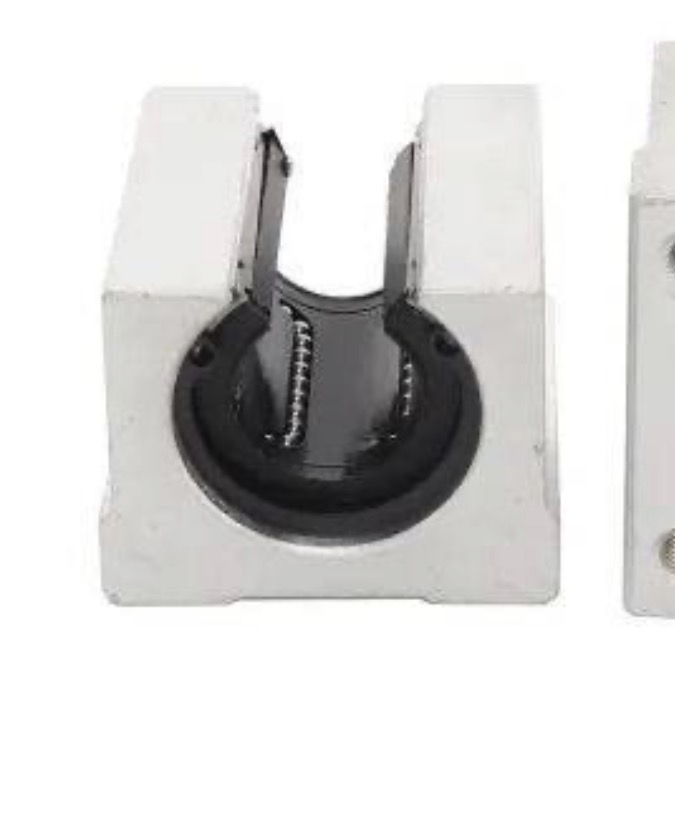

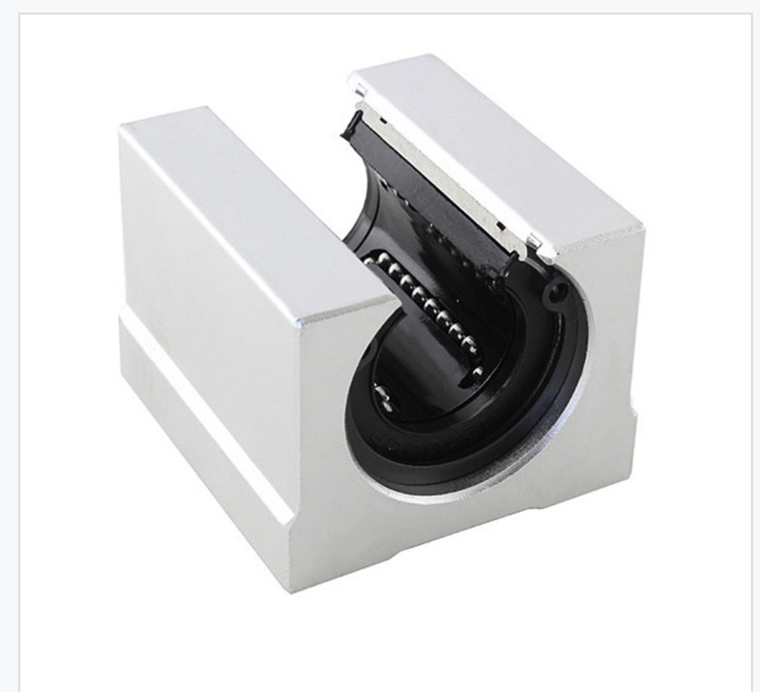

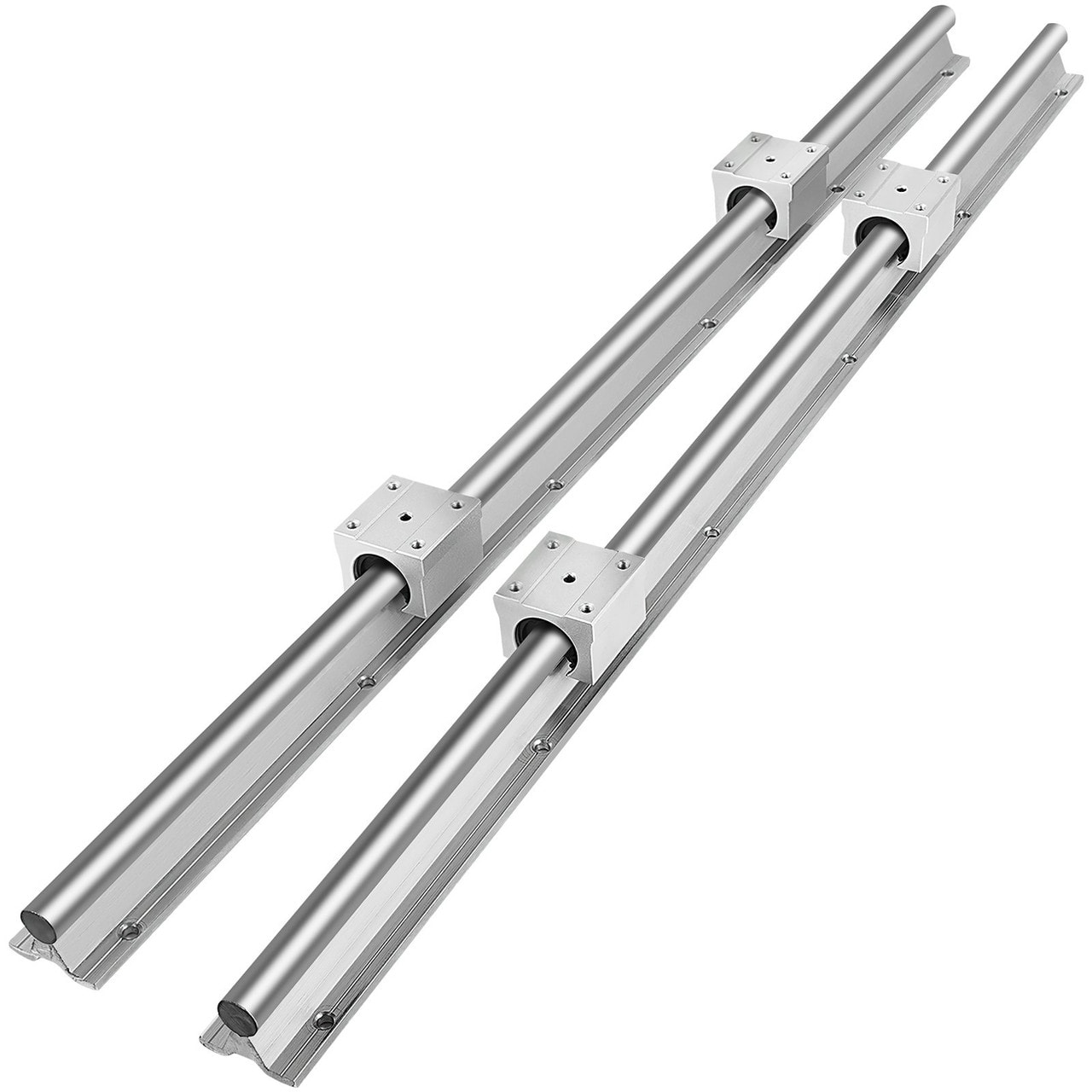

SBRs are widely used in linear motion. I even know of a relatively easily way to attach SBRs to the LR4 YZ plates. But if you do that, you start getting janky compromises in where the belts are positioned and held and the resulting lever arms. To fix issues like that, you’re now redesigning things away from the LowRider layout. You also get situations where by having constrained rails the alignment needs to be really good or you introduce binding. LowRider only having one rail for Y axis is really brialliant that way and it’s one of the things that makes the machine so forgiving of first-time, amateur builders. You’re not the first person to think about this type of mod or discuss it. Those are interesting though experiments to conduct.
So, if you’re going to use SBR rails, USE SBRs for the whole machine. Or, you could use MGNs. Or several other linear rail systems.
By the time you’ve designed all of those in, it’s got very little commonality with a LowRider, and it will now cost much more money to build.
The X axis is the least powerful axis on a LowRider. Y has dual motors, and Z has screws and dual motors.
