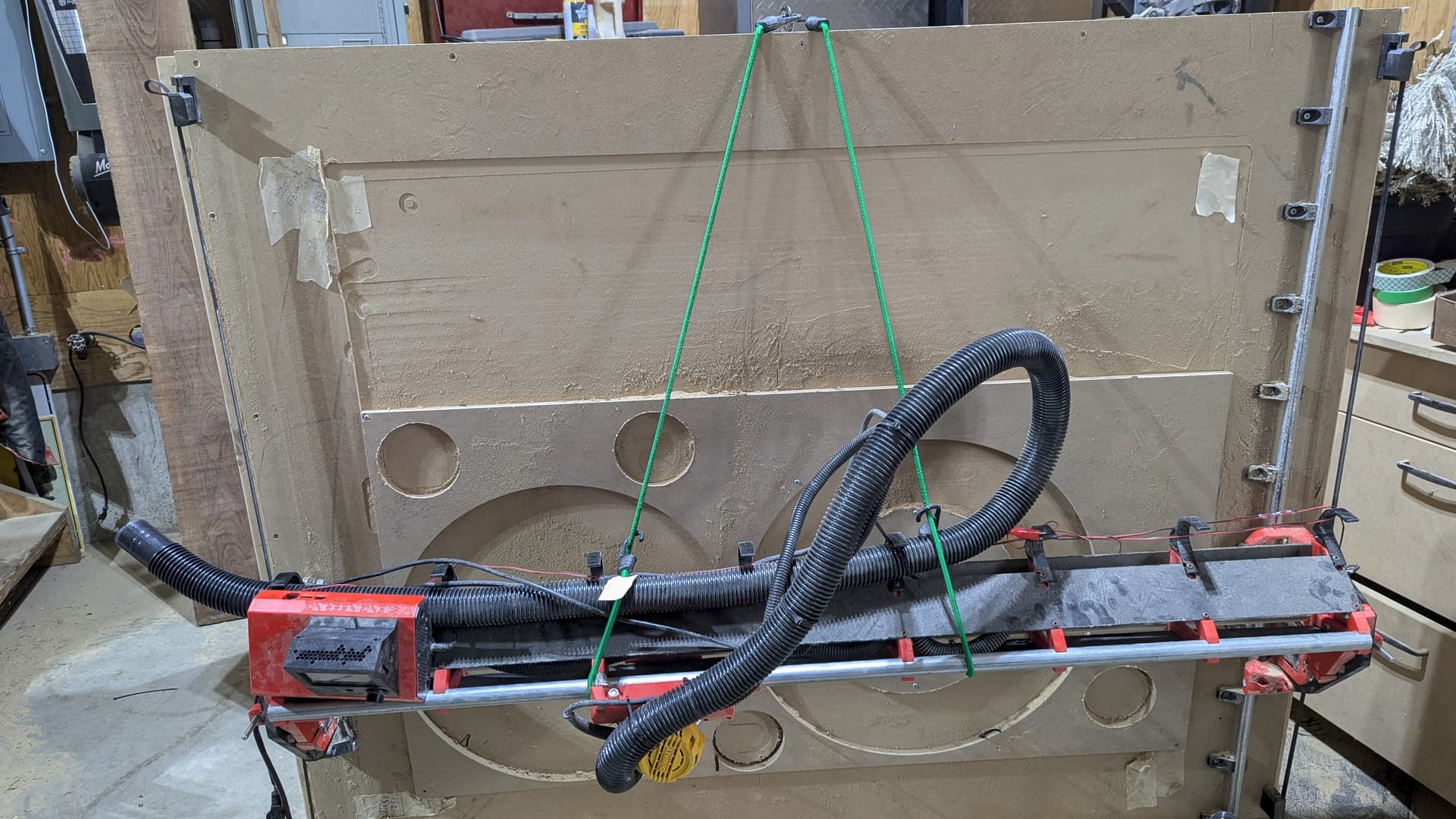

I considered just removing it, but then I have to store it somewhere. If I can store it on the table then that is just simpler. Maybe some bungee straps looped around the XZ plates and hooked into some loops fitted into the T-track might work.
I currently have a LR3 with a table that flips up 90 degrees for storage. I was using bungie cords wrapped around the gantry to an eyelet hook screwed into the table at the top of it. It certainly works but it isn’t super ideal or elegant. The first time I tipped the table up vertical, my anxiety ramped right up.

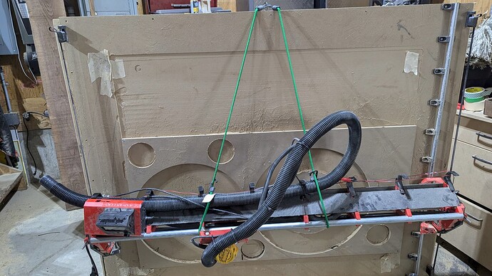

Here is how I hang the LR3 from bungee cords.
