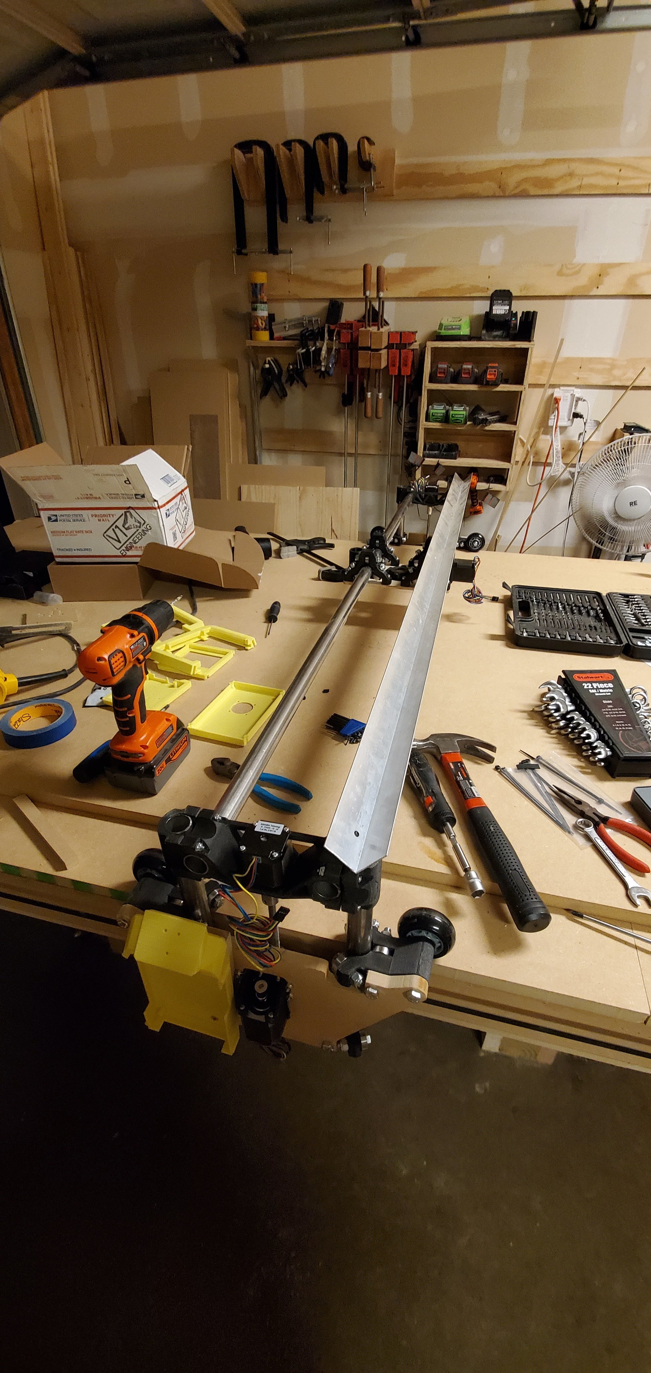

Hello! I’m Patrick. I’ve been thinking for awhile about building a full 4’x8’ lowrider2. I figured if I’m going to do it, I might as well go big. The only thing is that I work out of a 2 car garage (that my wife would rather like to keep parking in) so I don’t have space to dedicate to a table full time. So I designed a flip up version.
My full designed version is 57" x 112", so just under 5’x10’, and folds up to just under 3’ wide. It features a 4" thick torsion box top, and weighs roughly 500 lbs. You can see the finished table below:
I’ve currently assemble the gantry. Next I need to assemble my dust boot, attach the router, and do all of the electronics.
One question I do have, are the end caps on the z rails (I think they’re called the xz parts) supposed to fit flush with the Z rail? I think my rails aren’t quite parallel, but I’m not sure how to actually adjust it to get them parallel and allow those parts to sit flush. Does it matter to much? The whole axis can move up and down quite easily by twisting the lead screw, so it can’t be too out of square, but I’m worried it’ll affect cut accuracy.

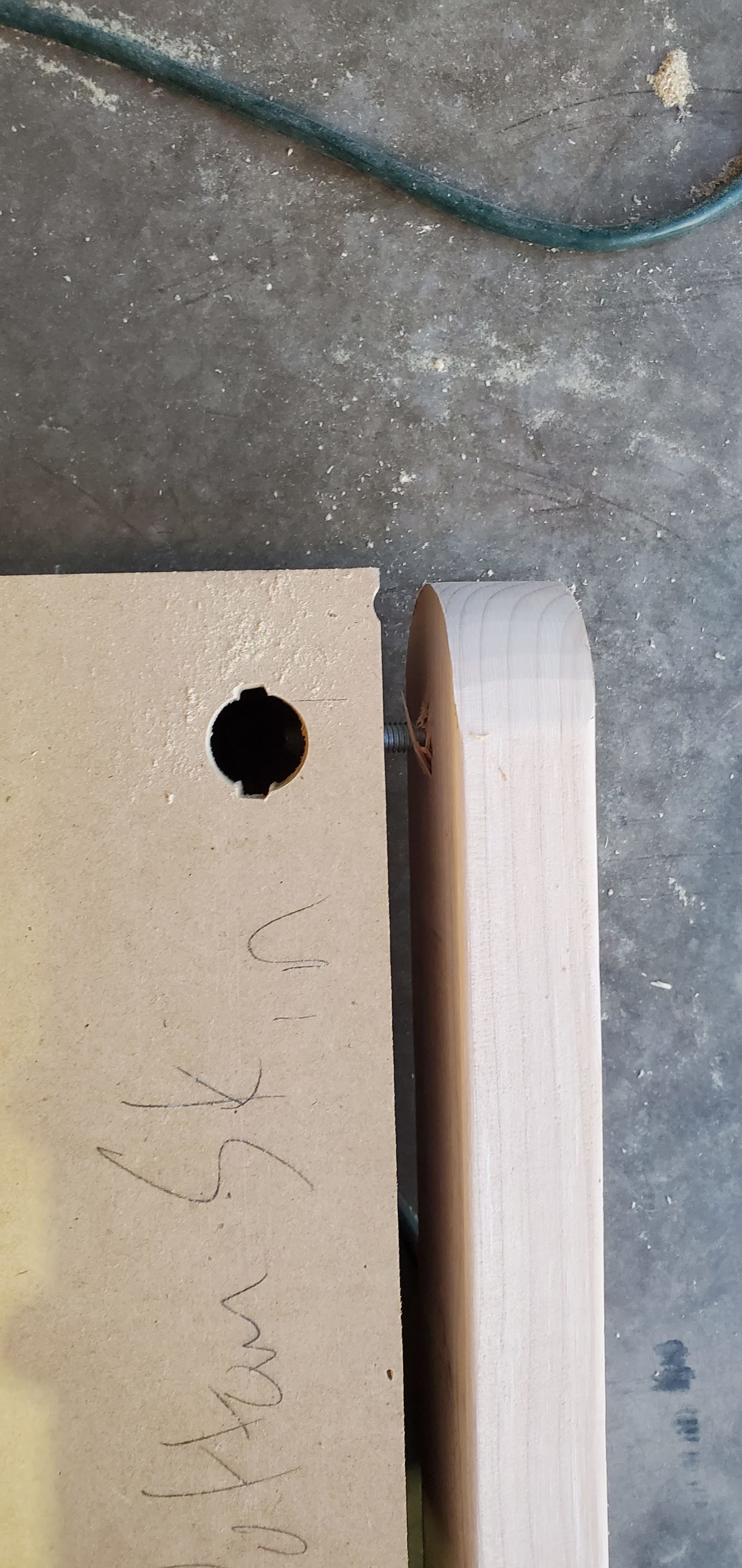

Actually building this beast was a task, as I don’t have a flat surface that big. I ended up putting the 3/4" 4’x8’ sheet of MDF I’m going to use a spoil board on my garage floor and shimming it with scraps until it was as flat as I could get it. This worked reasonably well. After cutting all my MDF sheets to size (which took a couple weekends), I started assembly.
I started with laying the skins down and framing the outside to make sure it was square, then worked on the internal webbing, which took a few days of gluing and brad nailing. I used the 4x4 post to position the hinge posts, which are 1/2" off center to let the table hang a little more positively. Probably unnecessary, but doesn’t hurt.
Got the bottom skins on after cutting some holes for the hinge posts. I didn’t cut some of the holes big enough, which resulted in a lot of clamping and hitting with a mallet to try to get the skins in place.

This shows more clearly my question, are the end caps on the z rails (I think they’re called the xz parts) supposed to fit flush with the Z rail? I think my rails aren’t quite parallel, but I’m not sure how to actually adjust it to get them parallel and allow those parts to sit flush. Does it matter to much? The whole axis can move up and down quite easily by twisting the lead screw, so it can’t be too out of square, but I’m worried it’ll affect cut accuracy.

I think if your whole gantry can rest at the bottom you should be good. The z-bars are parallel enough to pass through the two bearing holders in the y bracket.
If one side of the xy piece doesn’t sit on the y-bracket at rest then some adjustment is needed. I’ve found I needed to square the whole setup by resting the x bars on supports that were of equal height from the spoilboard and loosening/tightening the nuts and bolts on the xz parts until the bars were aligned correctly.
Hope this helps.
@ArstenA
I’m using the SKR 1.2 Pro, with this case from thingiverse.
@Darwin Thanks for the advice! I’ll try to square that all up this weekend. I won’t fret as much if the xz parts aren’t all the way tightened then. :slight_smile:
