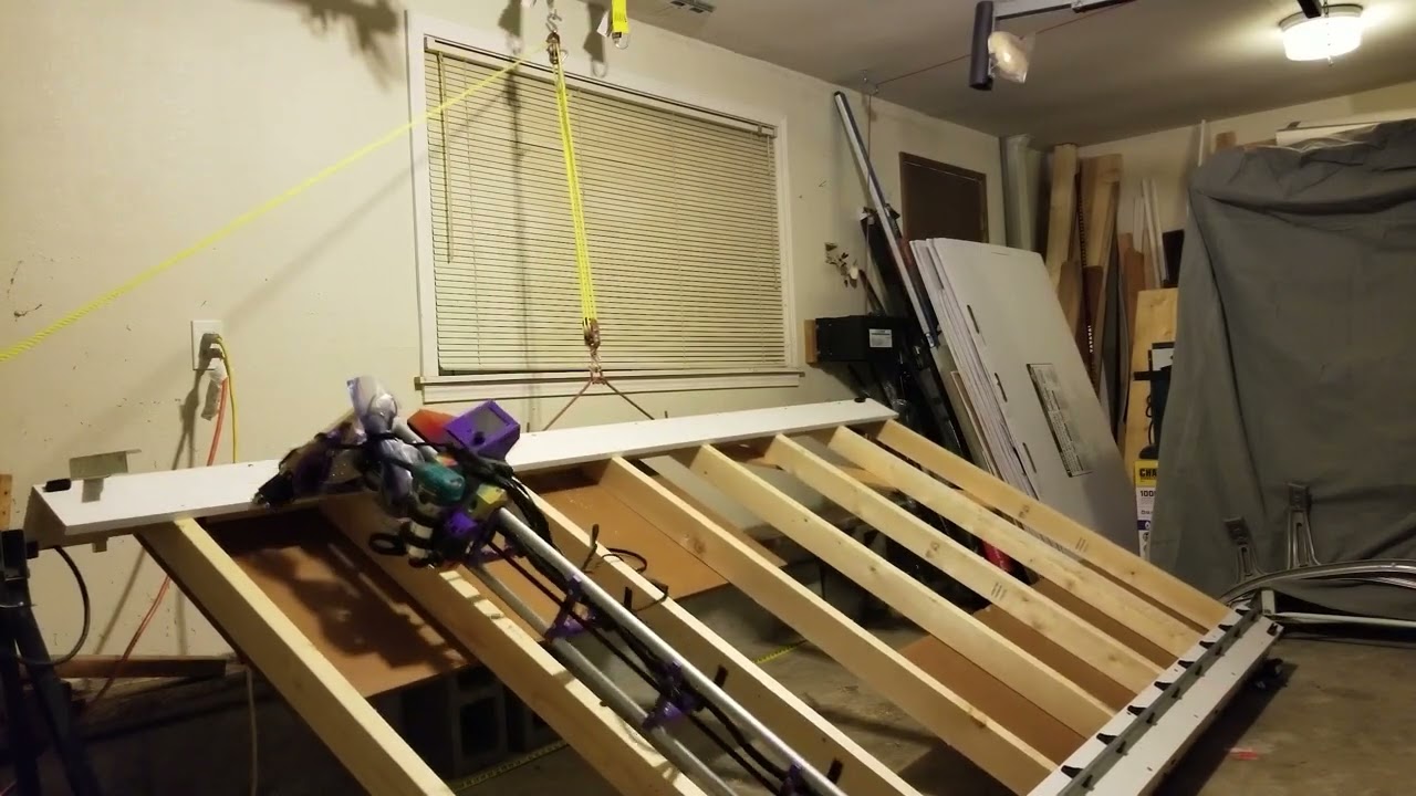

This is an idea I was thinking about
Do you have any picture?

Or, change EMT angle if always using at an incline, and/or add another EMT rail (and rollers) if planning to use both horizontally and some what inclined.
Consider building a stock version, get it running, get some usage to help discover/learn things… Like, LR3 is good up until ~30 degrees, maybe.
I like the idea of a some what vertical LR4, but requires bunch of changes I’ve not seen anyone brave enough to invest time experimenting and having a go​:popcorn:
OSHA ladder angle of 75 degrees would be perfect for a few reasons when you start to think about how the LR “table” could now also be storage rack you’re also able to climb…
