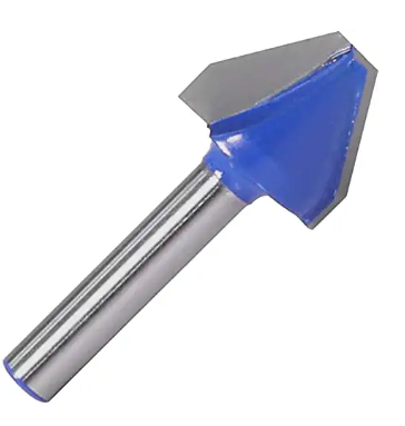

Anyone tried flat bottom v-groove bits?
Seems like maybe you could avoid the tool changes?
I don’t think that will work.
F-engrave doesn’t have a provision for the flat nose, and it generates the g-code on the expectation that the bit comes to a point. I’m pretty sure the male and female parts won’t mate with this bit.
I’d love to see you prove me wrong, though! 8^)

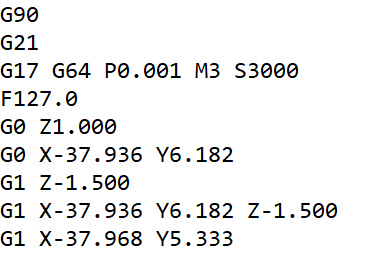

I’m cutting the female part now with a 30 degree 1/8” v bit. The rough outline went pretty fast but now it’s going back and clearing with the v bit by doing one swipe at the material, raising the z, lowering the z, doing the next pass. Looks like it will take hours. It’s spending most of the time just going up and down. Did I do something wrong ?
Well the first half finished… it took 5 hours for a two inch high carving of a name though.
I was poking around the gcode trying to speed things up and figured out why the first pass was so much faster… the F127 line is not valid I think… changing it to G1 F127 should fix it up. I might also try setting a faster travel feedrate with G0 F500 etc in the start script. Still not sure why so much up and down motion but I’ll try setting the safe height lower to speed things up.
Edit: Also, feedrates seem to not get applied at all to the carving file but they do get applied to the cleanup files. Which means the plunge feedrate doesn’t seem to have any effect.
I think the main carve file is expected to be a 3d carve, moving simultaneously in X, Y and Z, so it doesn’t set aseparate plunge speed.
I’ve done about a dozen v-carves with F-Engrave, and it sets a feedrate like your F127.0, but mine show F540.0 which matches what I have set in the G-code properties. I have a plunge rate of 180, but it doesn’t use that in the main V-carve, just the clean-up code, where it’s doing all that up and down motion.
Are you sure you didn’t get you’re plunge rate entered in the feedrate box? That might explain the F127.0 I agree that would be frustratingly slow.
Most of the text V-carves I’ve done didn’t produce any clean up code at all.
I made one sign where I neglected to fill in the multi-pass settings. It carved the ~12mm deep cut in one go. I was a bit concerned when I saw it diving into the stock, but the Lowrider plowed right through, and the sign turned out great.
It’s not setting any feedrate at all as far as I can tell F127 isn’t valid gcode it just seemed to ignore it and plow ahead with the feedrate I had last used before running the gcode which was quite fast for the carving. Maybe all the Z retractions were some weird edge case from the particular font and bit size I’m using.
