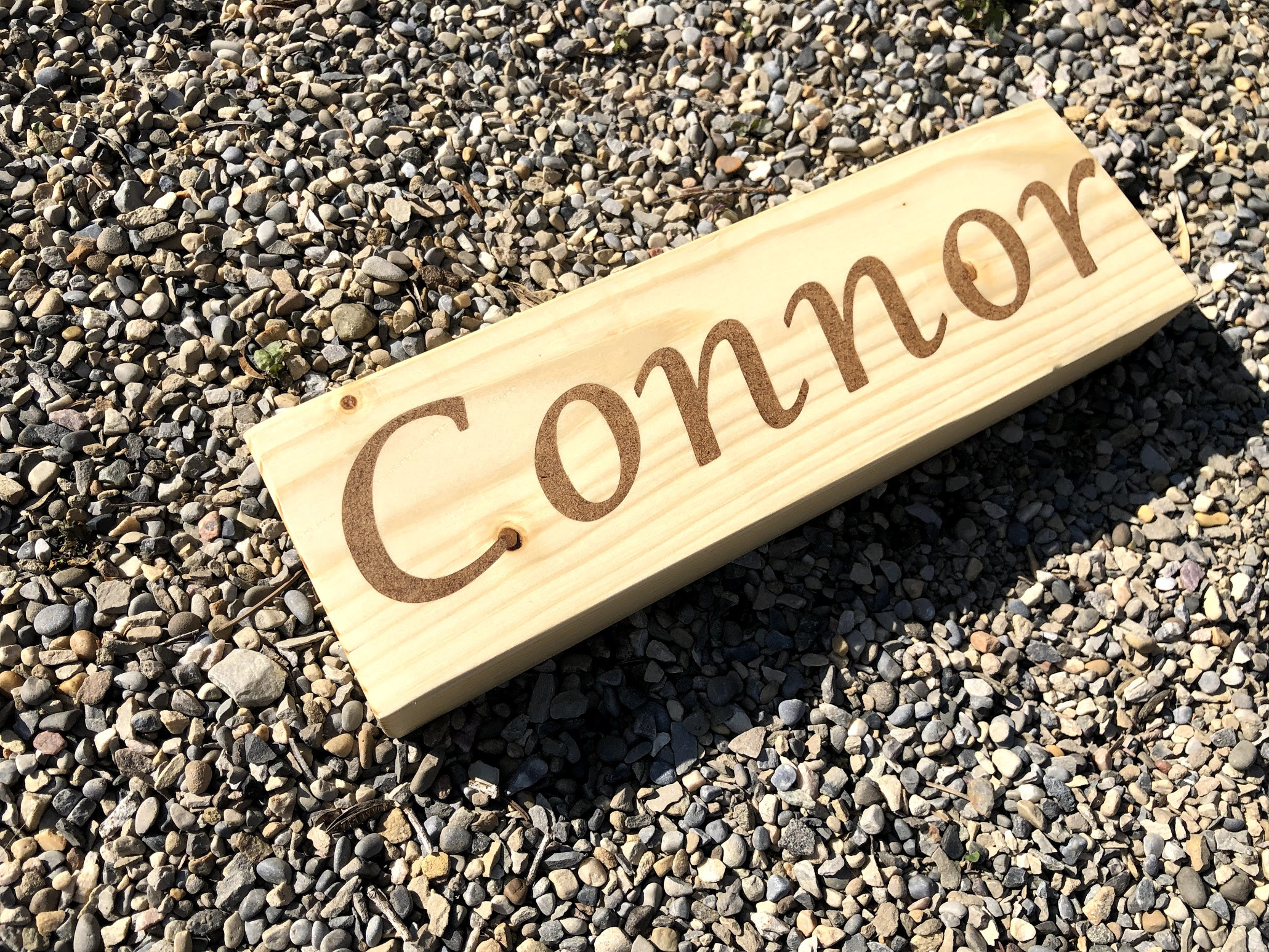

Thanks for the guide! Despite making a few mistakes (I assumed the software handled cutting deeper than your V), I managed to salvage it. MDF in a 2x4 makes a cheap way to test if you add some danish oil.
