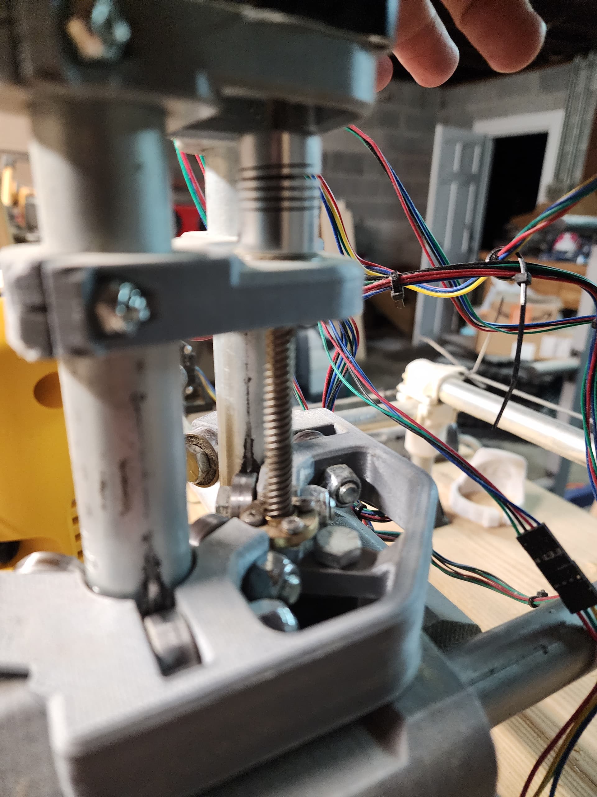

So is the steps in the programming of my board incorrect? If all the setting in estlcam look good. Like is my board flashed with incorrect settings? I am using the lead screw on my machine and pretty sure i downloaded the correct file from ryan…
It did also produce the same issue when trying to use easel instead of estlcam. Same exact issue 1mm is going down way to far.

Did you set the steps right for Z? I don’t know how you do that with Marlin.

I am not sure if i did or not. There was a file on the site somehwere its been so long ago for me to download the file and just flash it to arduino.
X and y seem to work perfectly just not z

Z has different settings. But you need to wait for one of the Marlin guys for that question. Sorry.

Can you open the. Gcode files in notepad and paste the first 25 lines here? Enough for me to see the G1 commands from the start?
Don’t change your z steps until you can confirm they are broken. The easiest way to tell (from the lcd) is to jog the machine some distance (start with something small, like 1mm) and then see if it moved that far.
If you can make it move 10mm and measure that it is close to 10mm, then the steps are not the issue.

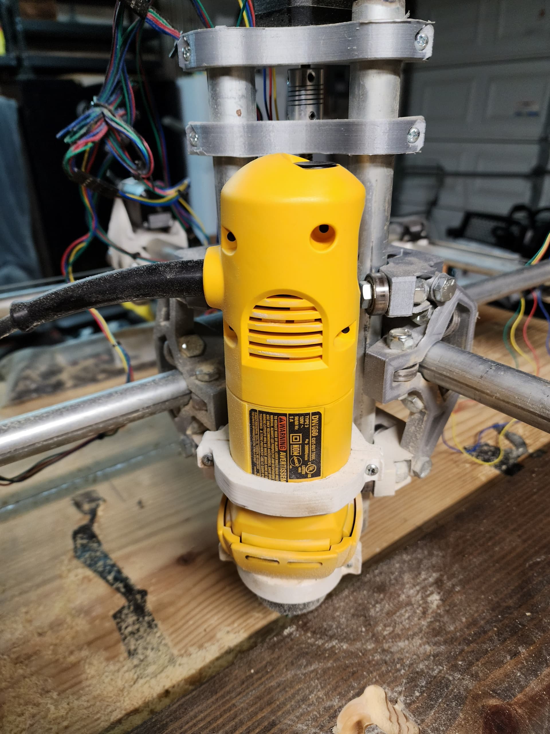

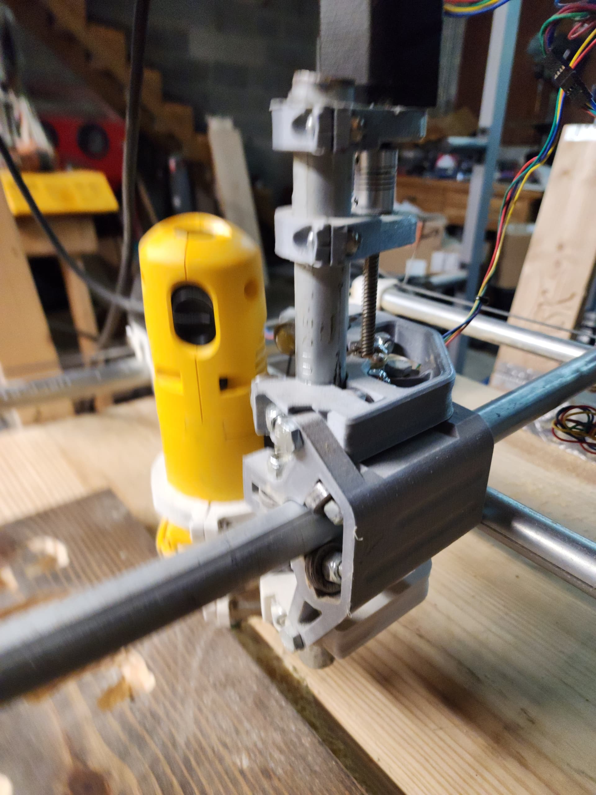

That explains it. M92 Z400 sets the steps per mm. The default for the rambo and skr pro is 400. 40 would be really weird. M92 on its own should show you the current setting. M500 will save the setting once you have it where you want it.
I’d like to understand how it got weird, and you will need to connect a computer to fix it.
Can you share some pictures showing the Z axis and the leadscrew? What controller do you have?
