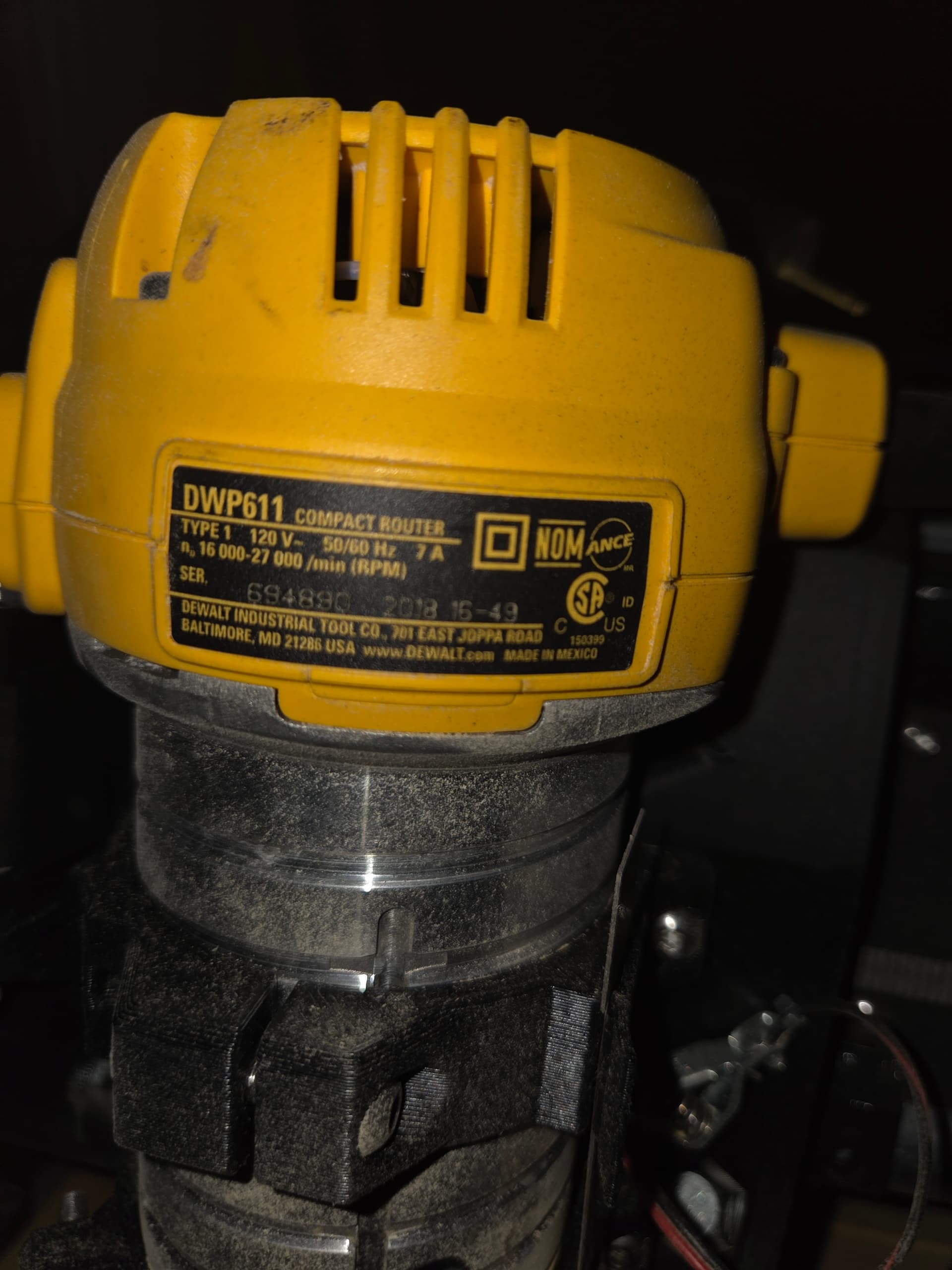

That said, im thinking it’s the router somehow (dewalt dwp611) when the router is on seem to be the only time I have issues.

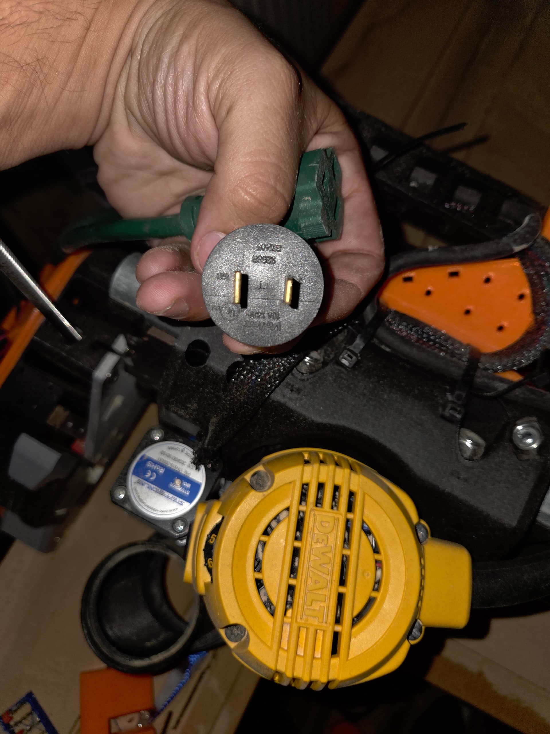

And as I am writing this I go check the router and sure enough it doesn’t have a ground on the plug.
Thoughts?
I am assuming I need to replace it, just don’t know what direction to go there either.
EDIT: Added photo
I’m not sure any of the routers that size have the ground lug. I will have to go out and look at my Kobalt to be sure, and the Carbide3D one I have as well.

You can try grounding the body to your Vac Hose ground. Maybe that will clear it up?
Make sure if you are using a touchplate the part that touches the router is the ground, and the plate is connected to the signal side of the plug on the board. The easiest way for router issues to make it back to the board is that touch plate set of wires so make sure there is no contact while it is running.
Sorry for my understanding could you specify as to what you mean by the “body”?
My first thought was the router body. But this is not something I’d like to make an assumption on.

Yeah the metal part.of the router.

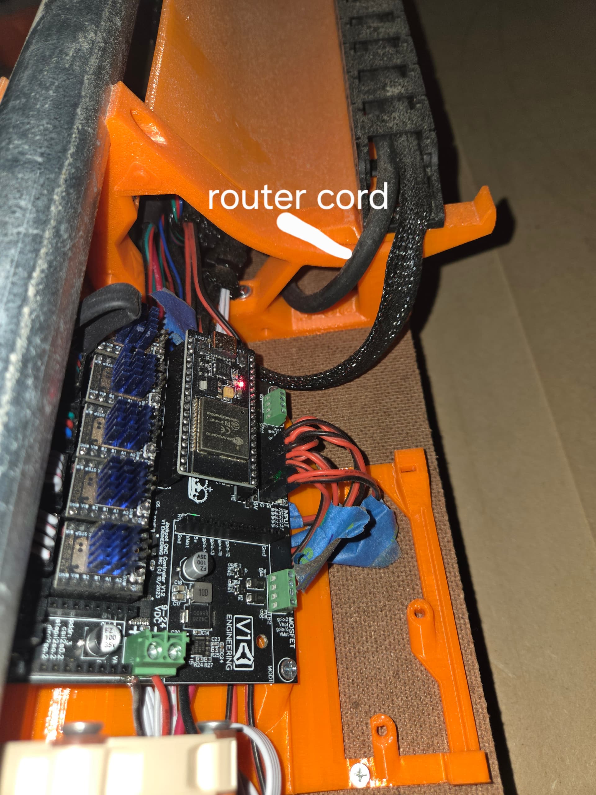

I connected a ground line directly to my router (I’ll post pictures later along with the link I used as a reference, in case anyone is curious). This actually helped a bit—the machine would run longer before stopping—but it still ended up pausing randomly.
Then a random thought hit me: what if I relocate the Jackpot? I moved it about 2 inches farther back from its original inside mounting position by modifying its mounting board.
Surprisingly, that extra bit of distance between the board and the router’s crossing point on the X-axis seems to have made all the difference. As of writing this, it’s been running properly while surfacing my spoilboard.
I also reattached the vacuum, and everything still seems to be working fine.
I’m not sure yet whether this is a permanent fix or just a temporary improvement, so any thoughts or advice would be greatly appreciated.
