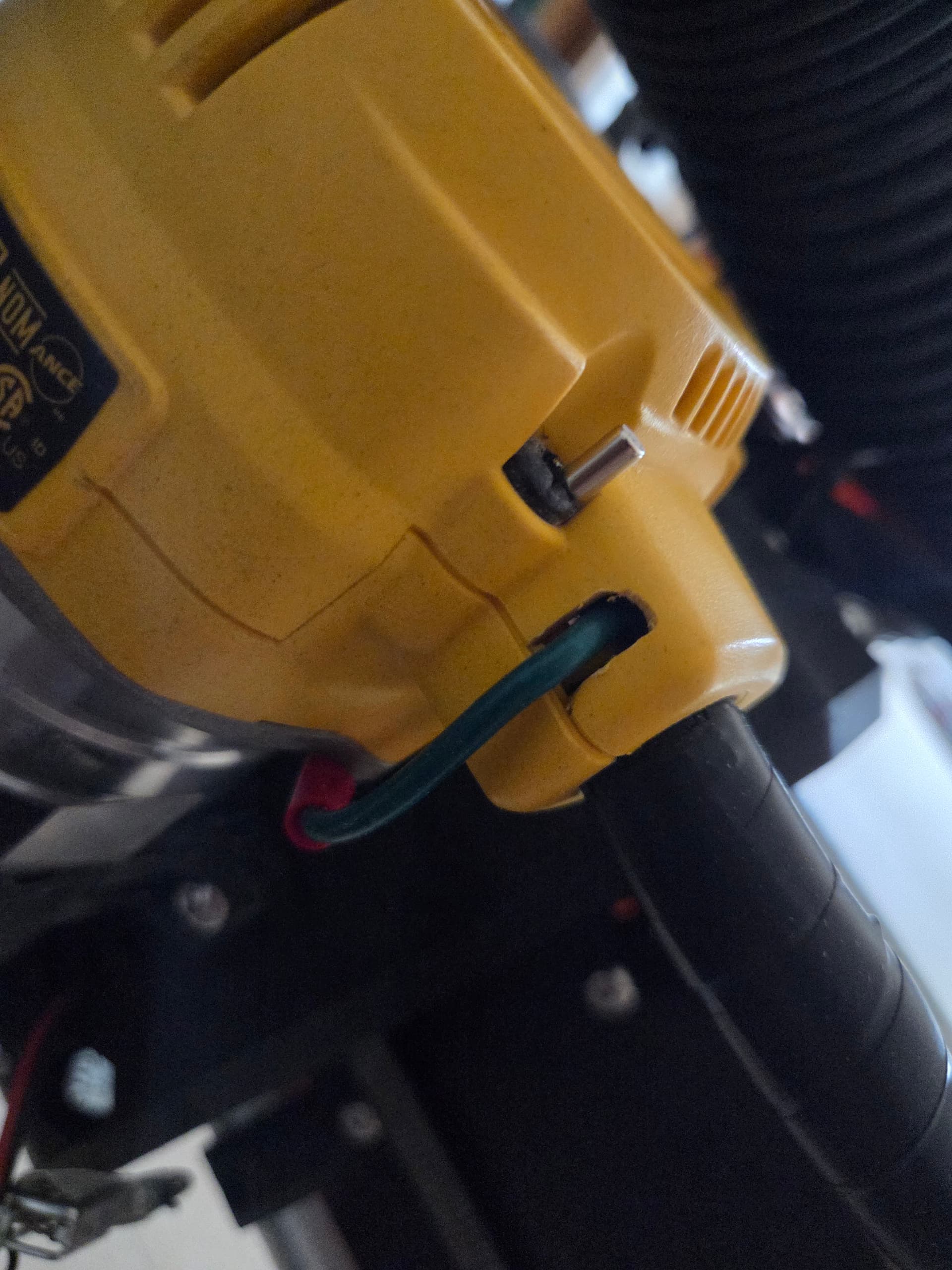

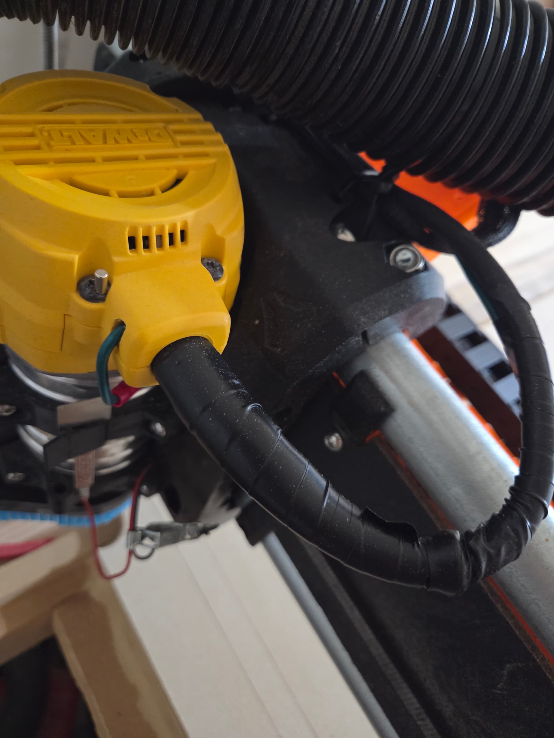

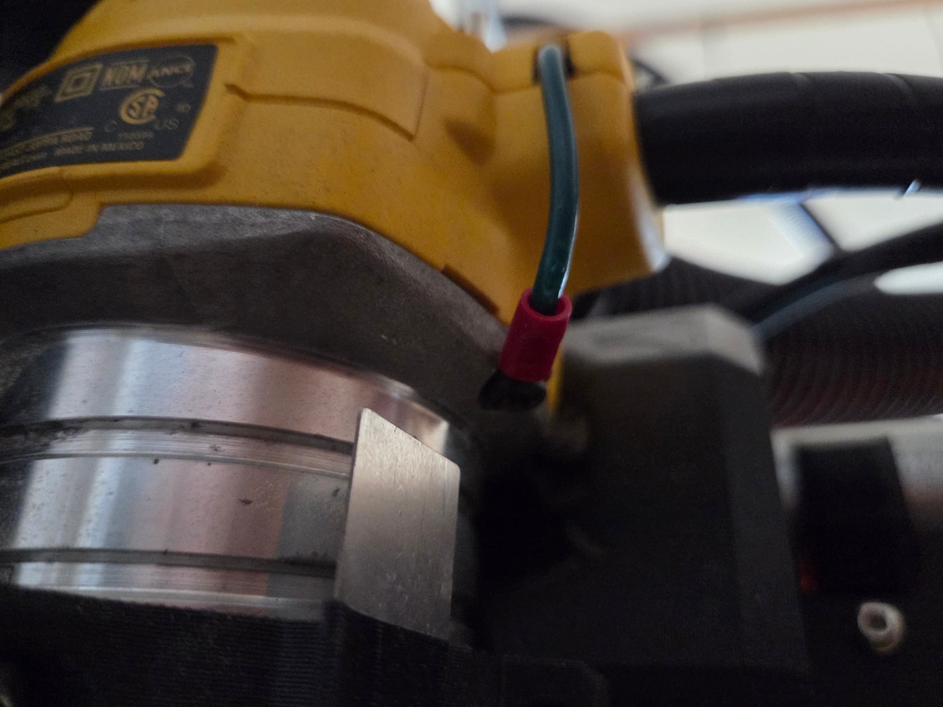

In case anyone was interested, here’s how I grounded the router:
I attached the ground wire to the body using the housing screw shown in the photo, then routed the wire into the original wiring channel. To make room for the wire, I drilled a small hole in the top housing, fed the ground through, and sealed everything up with heat-shrink tubing. After that, I installed a new 3-prong plug on the end.
I could have just bought a new 3-wire plug, but once I opened the housing and saw the internal connections, it looked like it would require soldering—which isn’t a skill I have yet.

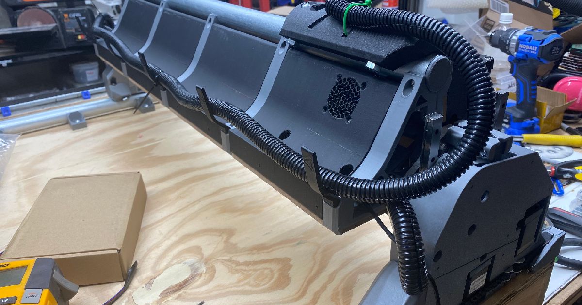

So all you did is move the board and it worked fine? Stretched wire comes to mind! what is the black wire by the last stepper that is nearly folded in half?
also that black wire(should be ground) is not Healthy at all! it looks like it is only half attached.
I wouldn’t say that exactly… there was definitely a grounding issue. As I mentioned before, after adding the ground to the router, it ran the program much farther before the same issue occurred. Yes I also relocated the board about 1.5 to 2 inches further back from the router’s crossing point. I’m not sure if “stretched wires” were part of the problem (I’m not even sure I fully understand what that means), but as of last night I switched to his recommended box mount, which puts the board in a much better position than before. Since making that change, everything seems to be running smoothly.
As for the last stepper, the wire just has a lot of heat shrink on it, but after switching to the new mounting box I was able to place it in a better position with less stress. Thanks for pointing that out!
