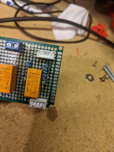

Could we use a lower wattage resistor for the brake since it is a motor simulation? 10 W is a lot. the inductor is 0.25 W currently.
Just an assumption, but if there’s no real current flowing through the resistor, then it should be able to be smaller.
v3 prototype board with smaller wattage resistors is in progress to test the smaller watt option to save space. My resistor stash only has 10 ohm resistors. So putting a bunch in parallel gets both lower resistance and a higher watt rating, and it is going to have both motor coils shorted since this brake doesn’t actually stop anything. It just loudly slows down the descent. I’m curious what a double brake will do.
Working on durability testing the V2 board currently installed.

Update:
New experiment:
  • single coil of one motor connected to the braking circuit vs both coils of one motors routed through the short-circuit resistor and inductor circuit.
All tests to date have been only one motor coil from each motor.
Result:
  • One coil is a loud “bumping” noise as the motor spins through to the bottom. this is effective, but very noticeable.
  • Two coils when powered off produce a very quite descent that is much slower
NOTE: In no case of z-brakes does the bed actually hold position. The brakes only act to slow the descent to minimize crash damage.
Board with double coil brake on one motor shown below (modified v1 board). Each brake circuit is 5 resistors of 20 ohms in parallel (because this is what I had on hand) and one inductor in series and 2 jst-xh plugs for board signal in and motor out connections
