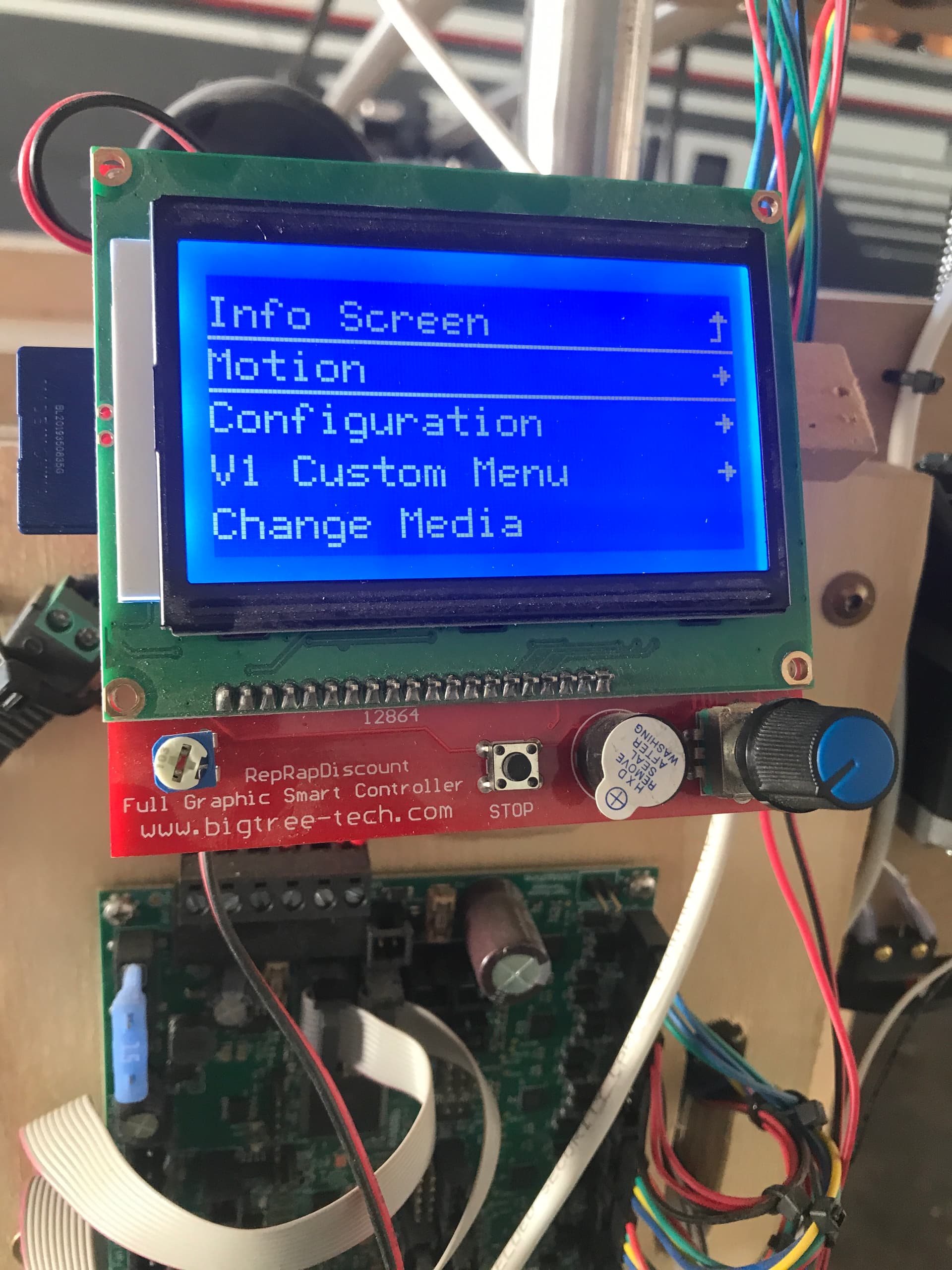

When I put the SD card in the slot the display states that the SD card is inserted and shows the SD Card image.
When I go into the menu, the bottom option says No SD Card Inserted, when you go into that option you just get Return to Main Menu and the Directory Level icon.

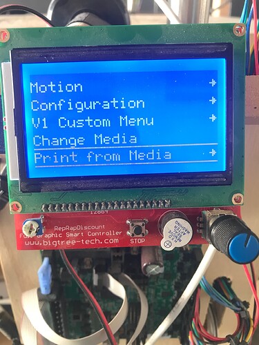

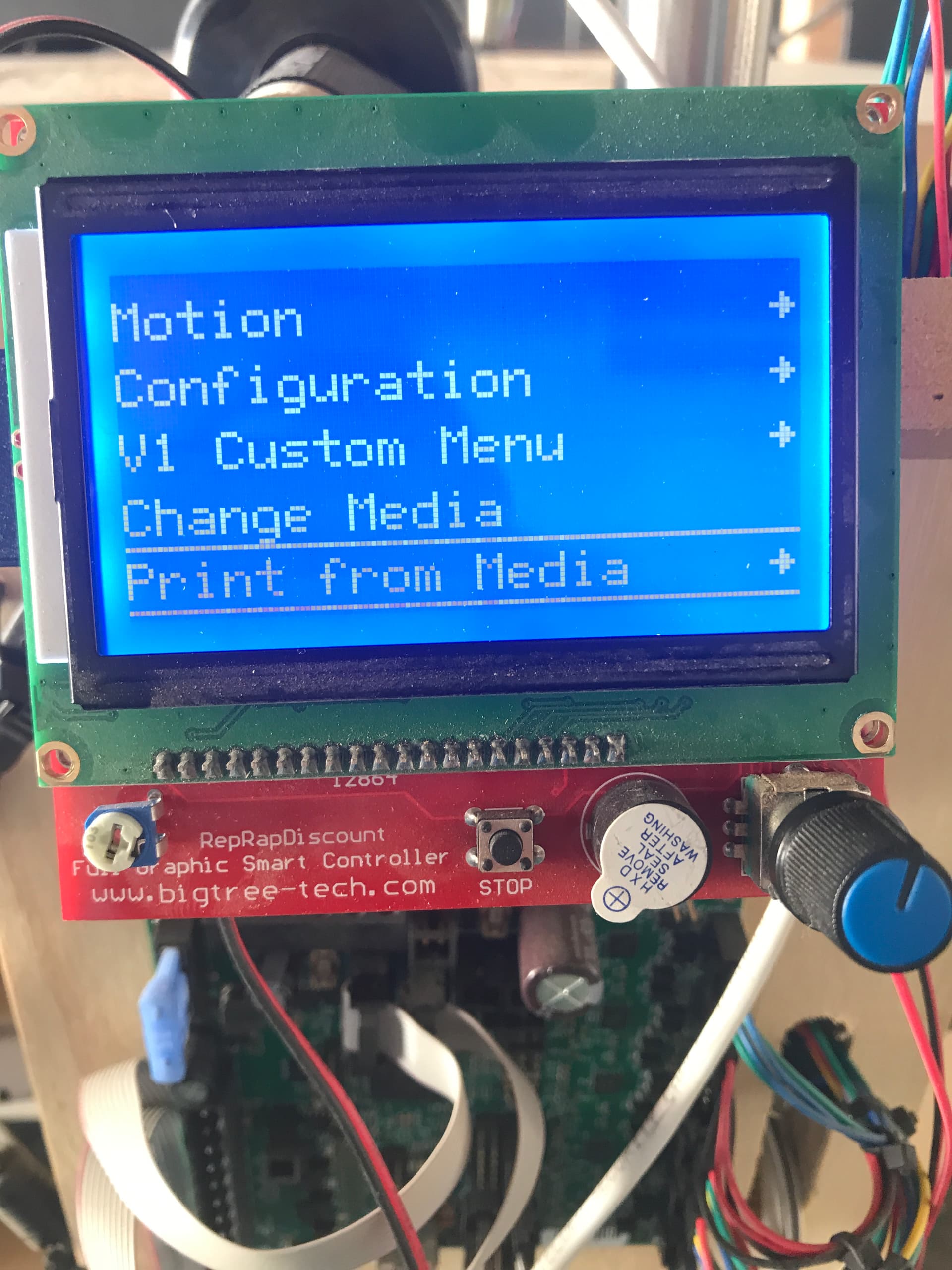

Then ejected it from the lap top and brought out to the controller and put it in while the board was off. Powered it up and on the bottom instead of no sd as it said before it says change media ???
Am I doing this process wrong and if so any good threads to correct it?
As mentioned sure the pi is easier via all that but I don’t have the knowledge on that stuff to support messing with it.
Just wanna be able to use the router

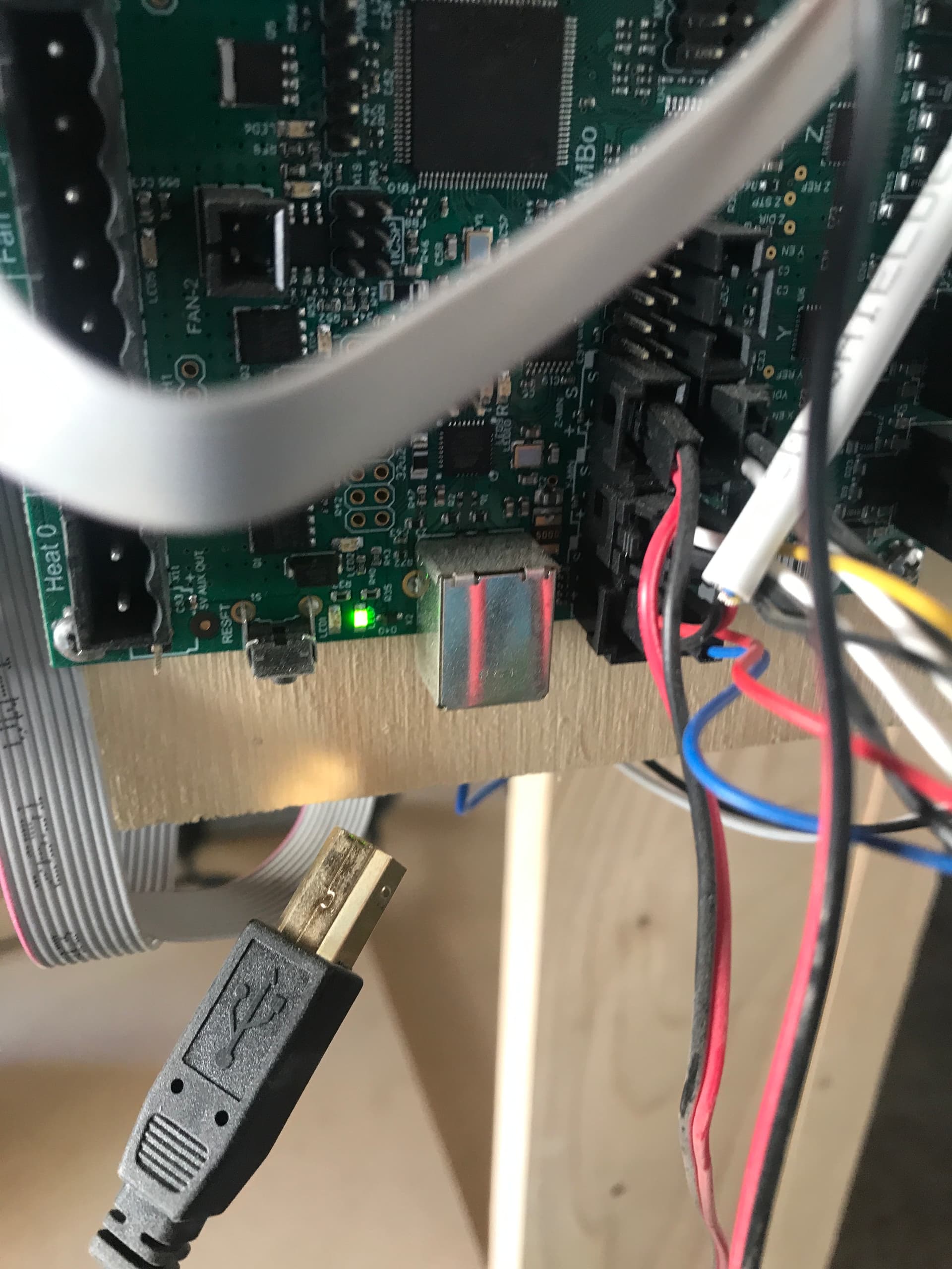

Another thing I thought of after the fact is the usb cord was still plugged in so powered down and then unplugged it

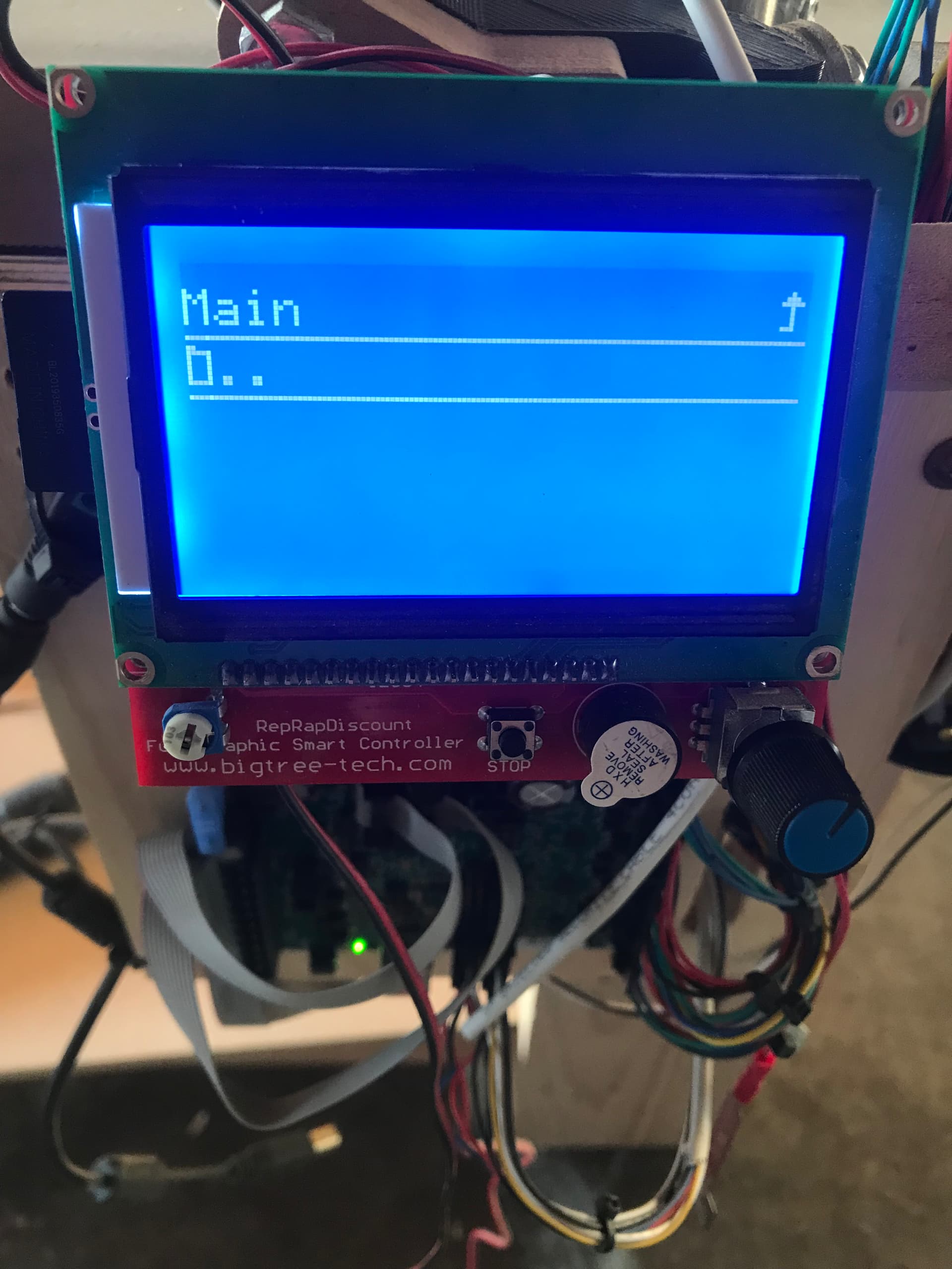

Then powered back up and went down after homing the machine and I see below change media > it says print from media > clicked that and it goes to next screen that just says main
Main>
Do you just create a subdirectory folder within the sd card and put g code files in there ?

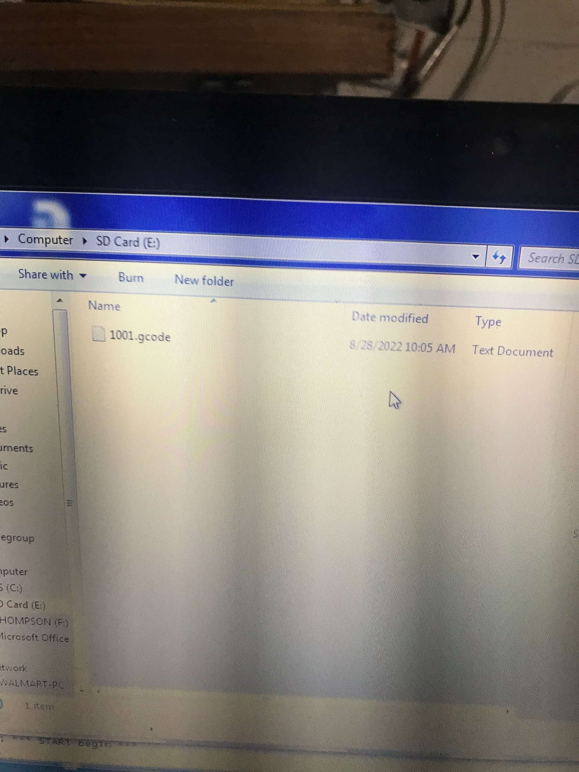

You can create a sub-directory, but it is not necessary. The files in the root directory will appear. The display/Marlin is seeing the card, just not displaying any files. The most common reason, as mention above, is that you have the wrong file extension on the files. It must .gcode. Can you show us the contents of the card in Windows?

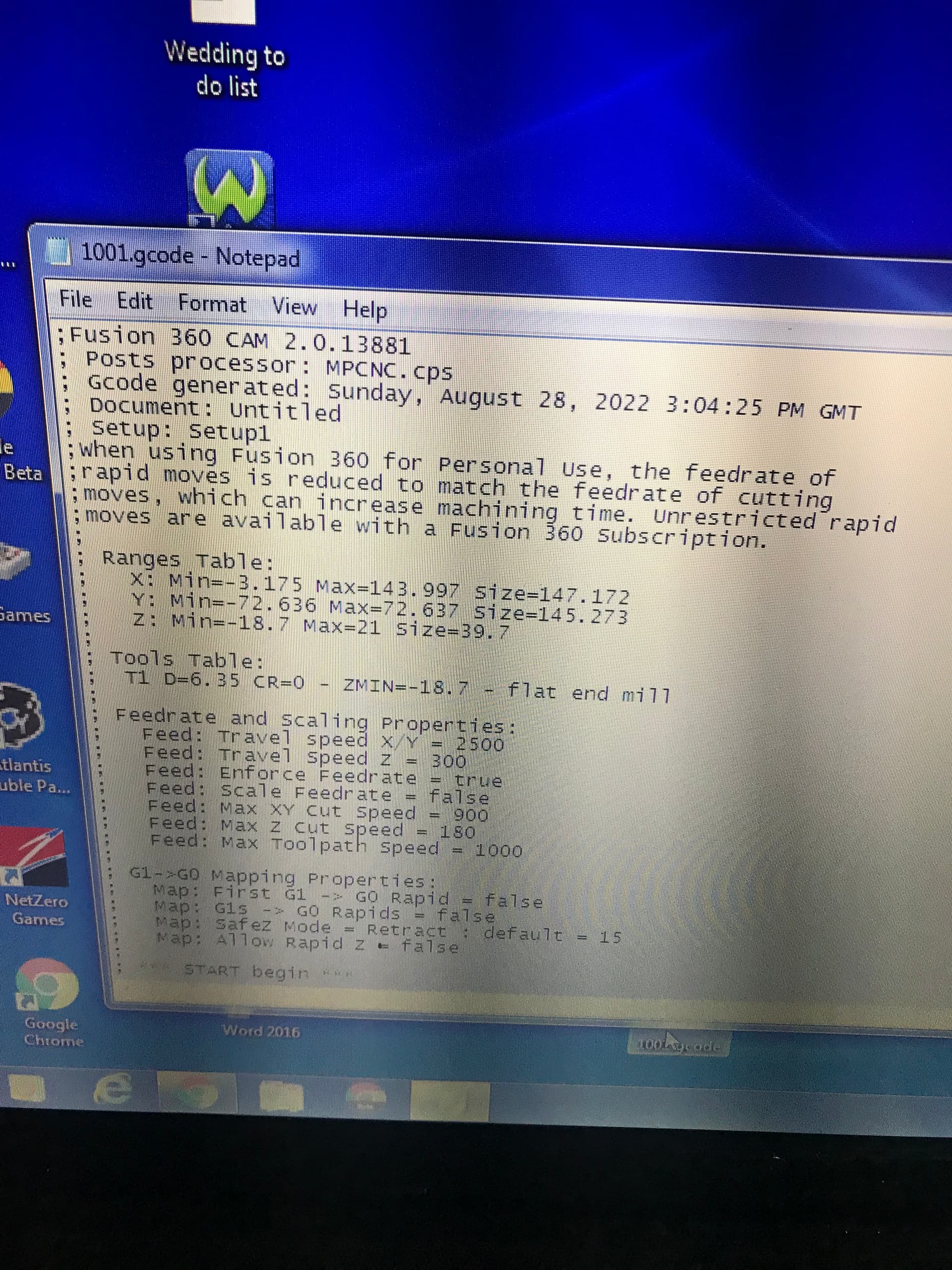

I can I just looked at the usb file. It was saved 1001.gcode I’ll get a pic in a minute and show ya.
It should normally show the code there on that display? Would there be any other connections to look for on the board as he was running this via pi >octoprint before
Here is the note pad file from the desk top
Here is the Sd card E:

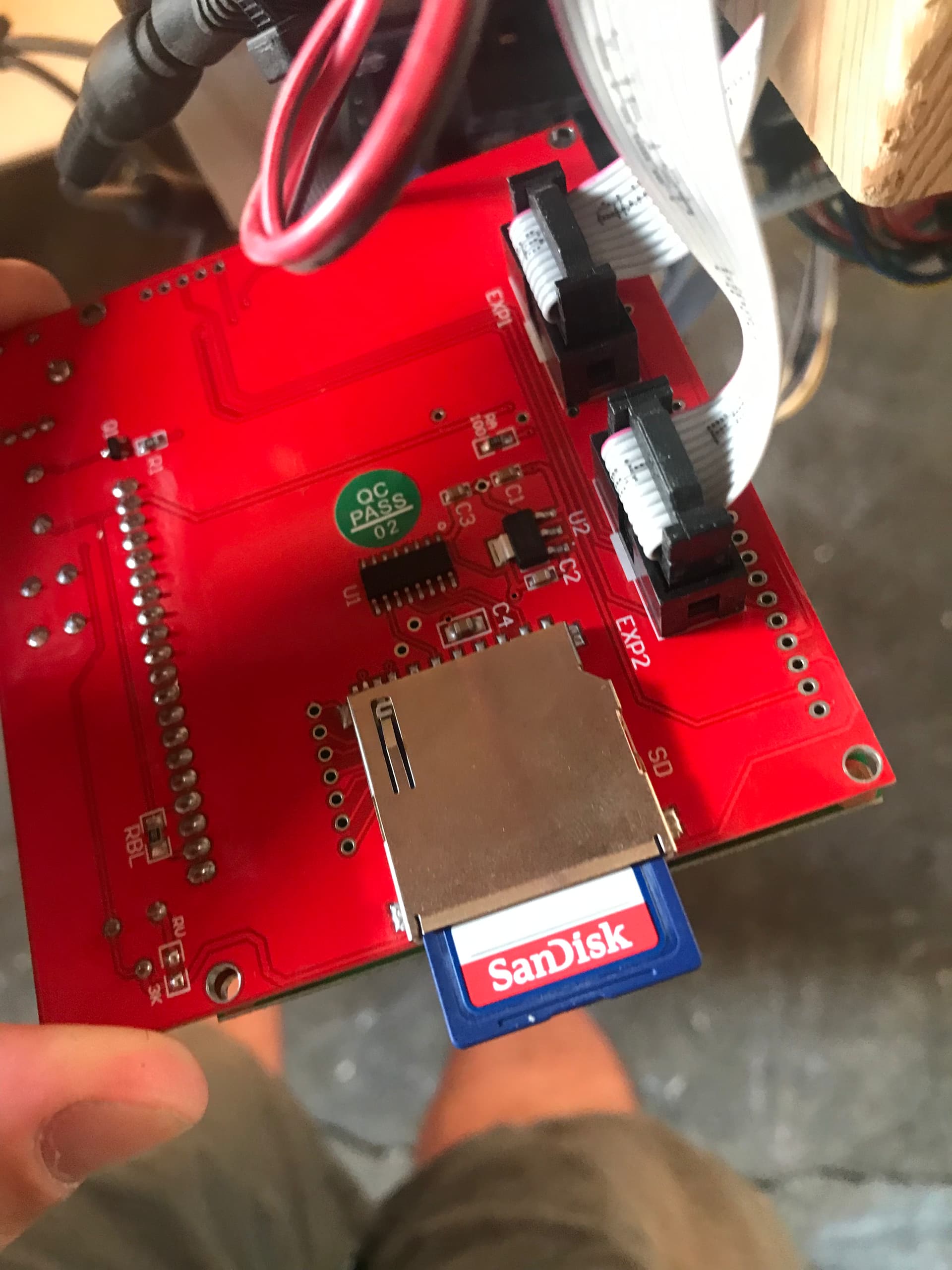

The files on the card look fine. Here are some failure points. Not sure what ones would give this behavior.
  • Size of the SD card. I know that larger capacity SD cards have issues. I use cards in the 2GB to 8GB range.
  • Bad SD card reader in the display…you can test a replacement for $15.
  • Bad connection between display and control board. Look for bent pens and cables that are not seated. Swap the two cables to see if the behavior changes.
The card reader on my 3D printer has issues. I have to sometimes insert and remove the card a couple of times to get the printer to read the card. I keep thinking I’ll have to replace the display, but the problem is not getting any worse.

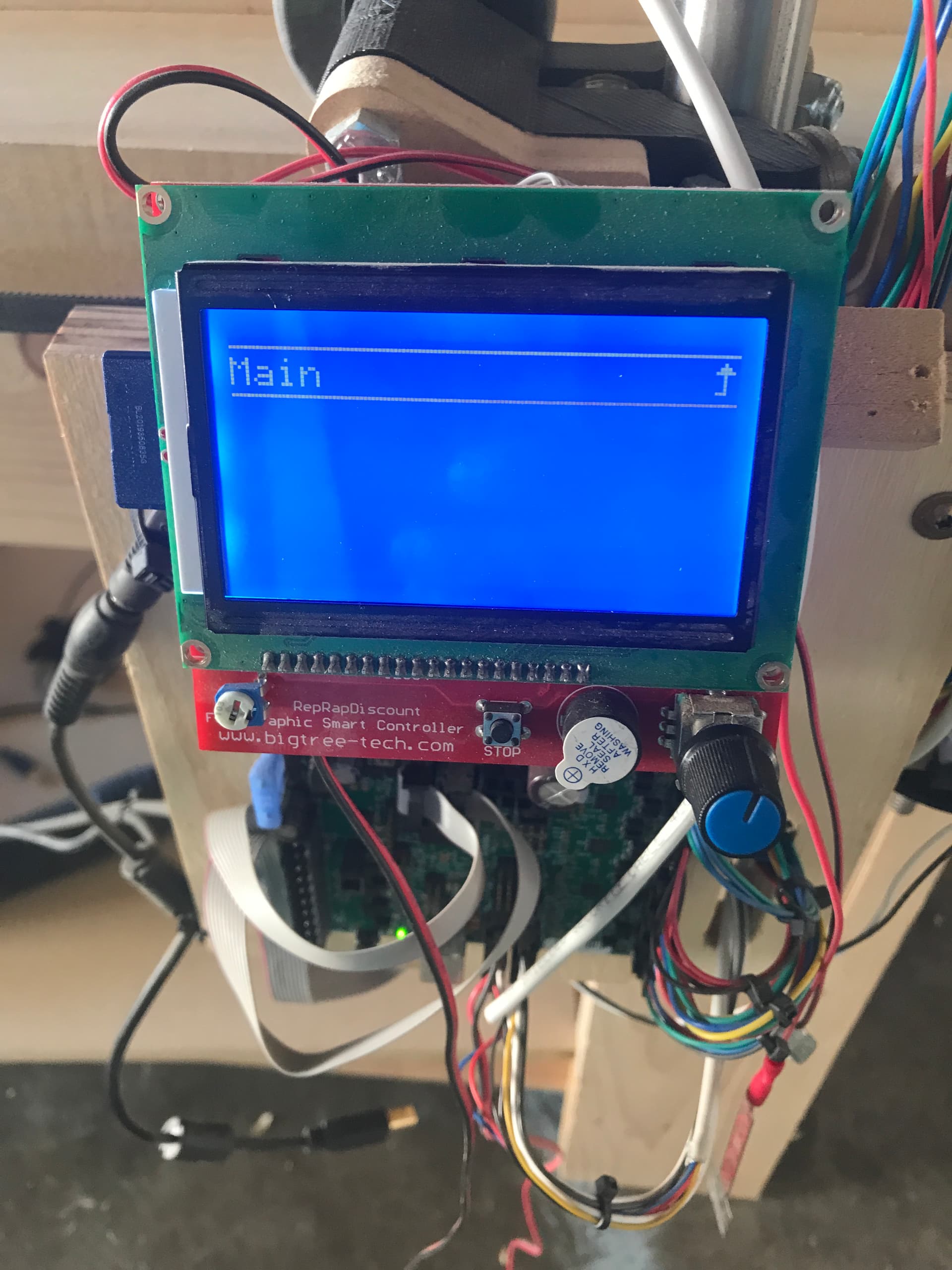

So I reformatted another San disk card and created a sub file. Added it in the sd card. Made sure it had the .gcode and added the program.
Put it in the back of the display.
Here’s what I see.
Another thing how does one change out the reader without the whole board being replaced?
Wish it was easier than this to load code
Try the test crown premade gcode. That has to work.
Try it with an empty folder next to it.
Try it inside a folder in the main folder. Don’t use spaces in the folder name.
It is a very simple file system reader. I wouldn’t be surprised if just 1001 is the problem. Change it to carve.gcode and see if that works better.
Just spit balling here, not sure what the issue is. But there is some goofy thing that will be easy to work around once you figure it out.
