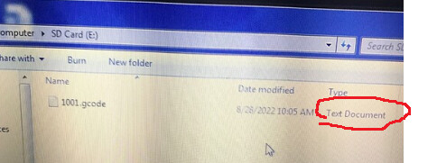

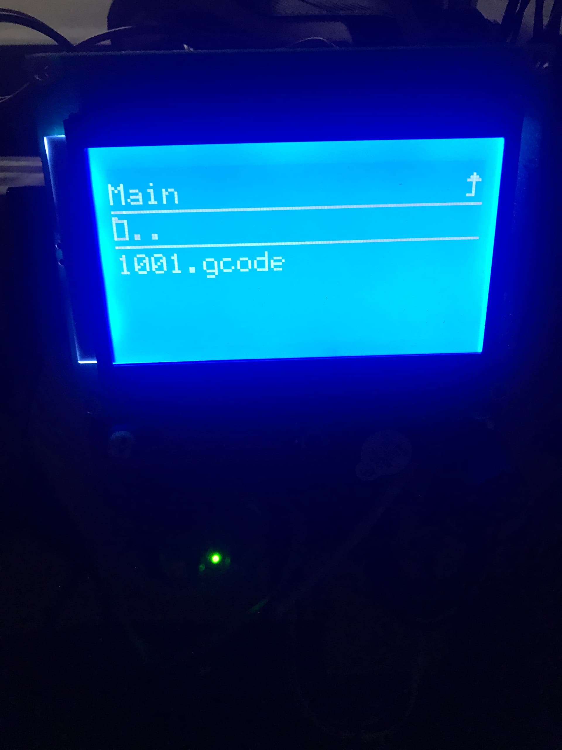

Unable to CNC via SDCARD or Repetier
Hello @BFUNKSJIGS! Is the 1001.gcode file actually saved as 1001.gcode.txt, but windows file explorer isn’t showing file extension?

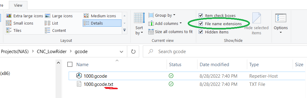

Curious about something in the screenshot you shared earlier… I wouldn’t expect .gcode to be recognized by Windows as a text document unless you explicitly configured it to.

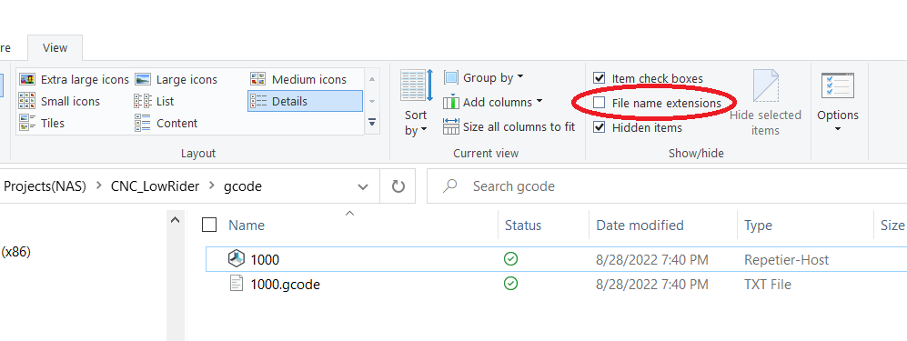

I could see how you could end up here if File Explorer is not displaying “File name extensions”
Please ensure “File name extensions” is checked, what do you see then? Maybe the file needs to be renamed from 1001.gcode.txt to 1001.gcode ?

Where can I locate that check box about the extensions ?

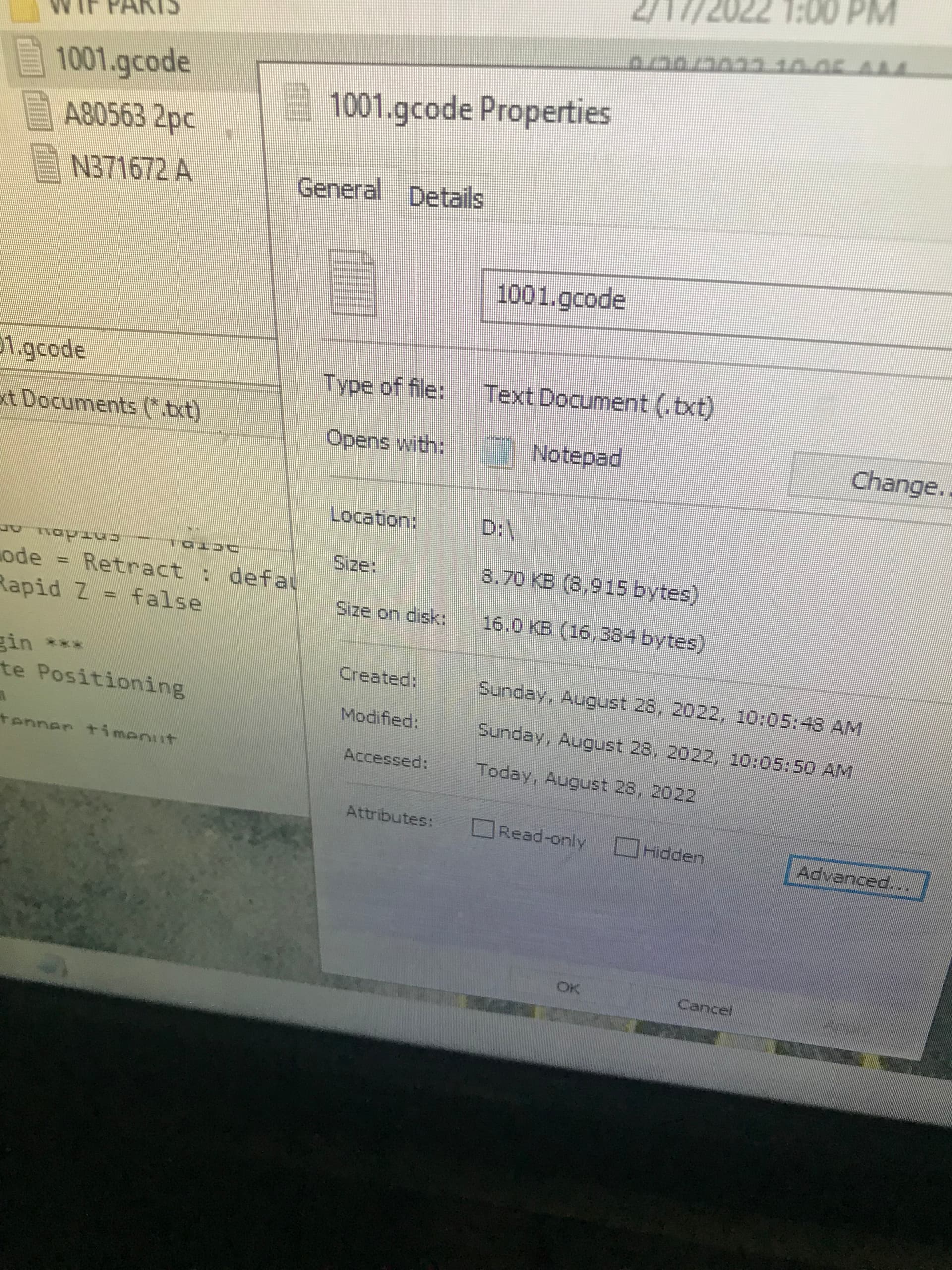

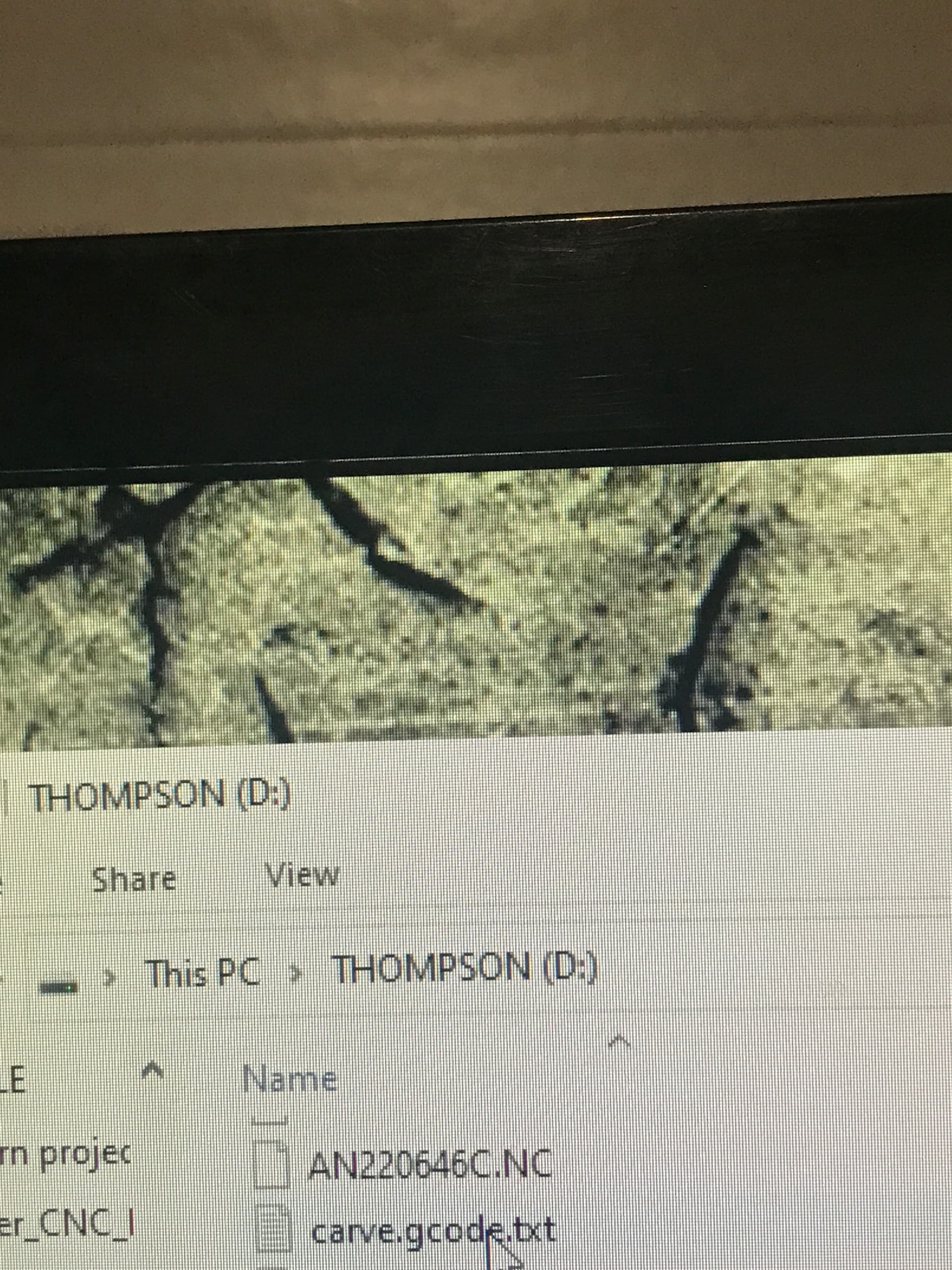

@azab2c so I went back to the usb stick where originally saved the file. Right clicked on it and went to properties and shows type of file is .txt, that fall in line with what your thinking??
What’s the best way to have it saved to where the controller will read it? When I put save as I didn’t have any other options in that word pad/note pad

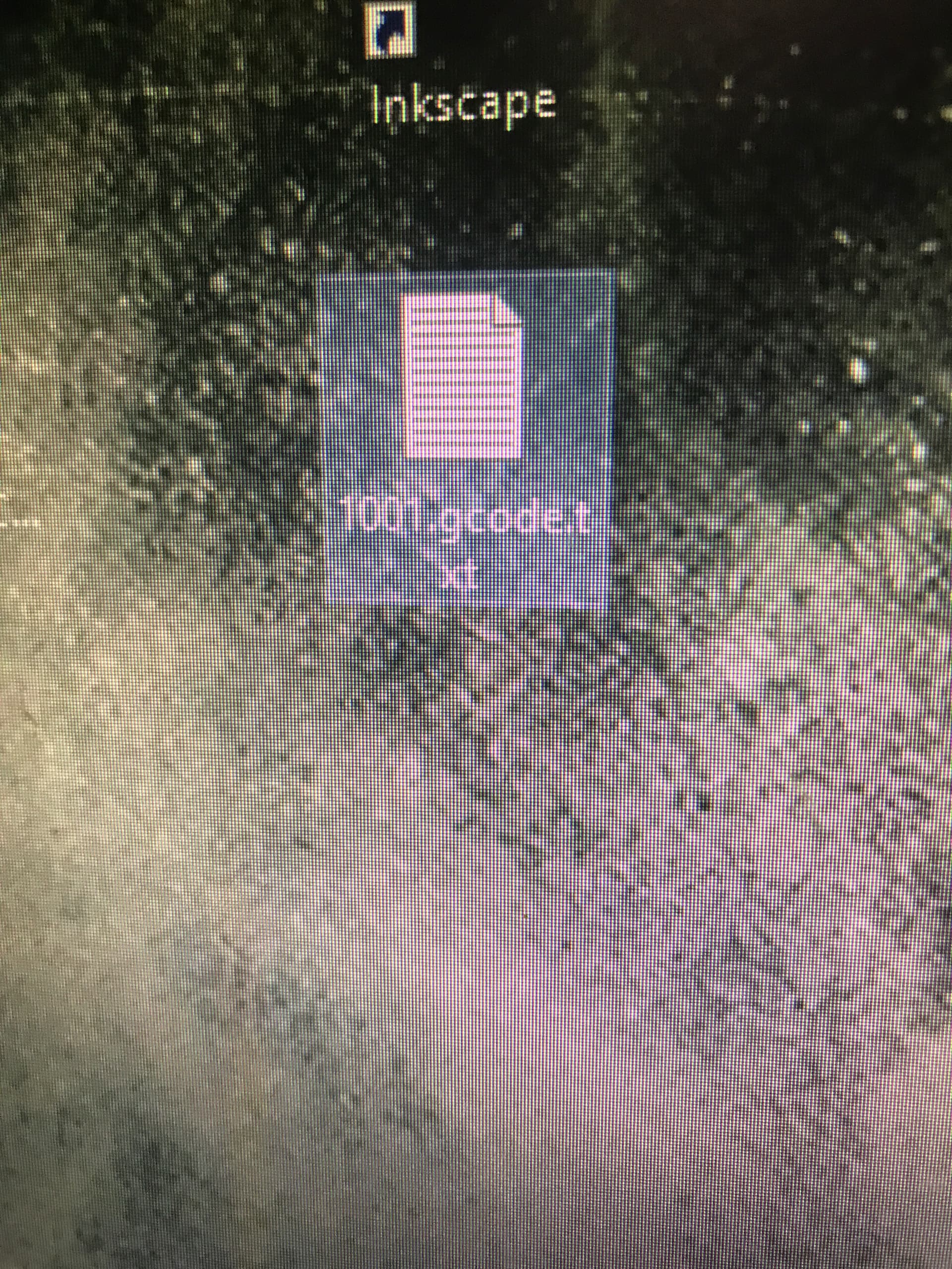

@azab2c well that was quick to figure out but that is def what happened. I went to the usb and clicked view to show the file extensions and yes, it shows 1001.gcode.txt
I tried renaming it carve.gcode and it automatically inputs the .txt when it saves.
How can I prevent that ???

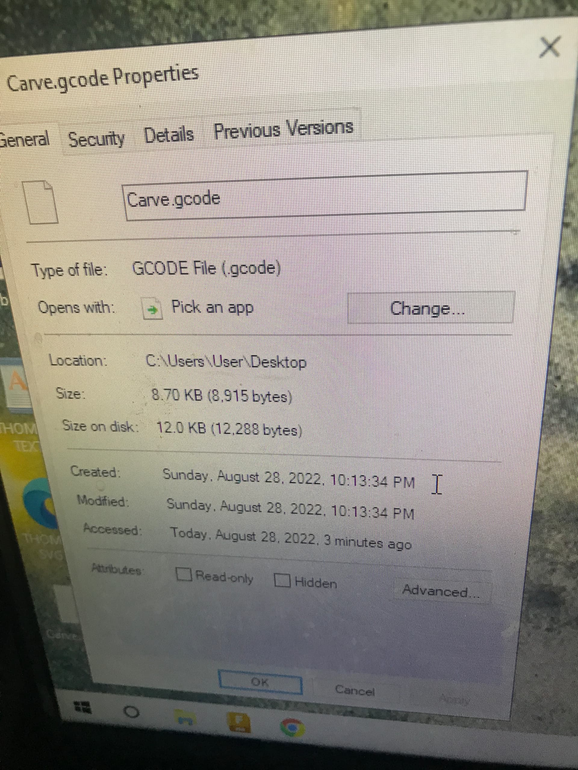

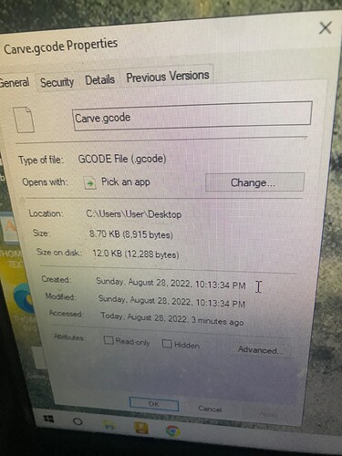

@azab2c so I made if carve.gcode again without the txt and selected save as > mended to all files and then it saved it on desk top without a file designation

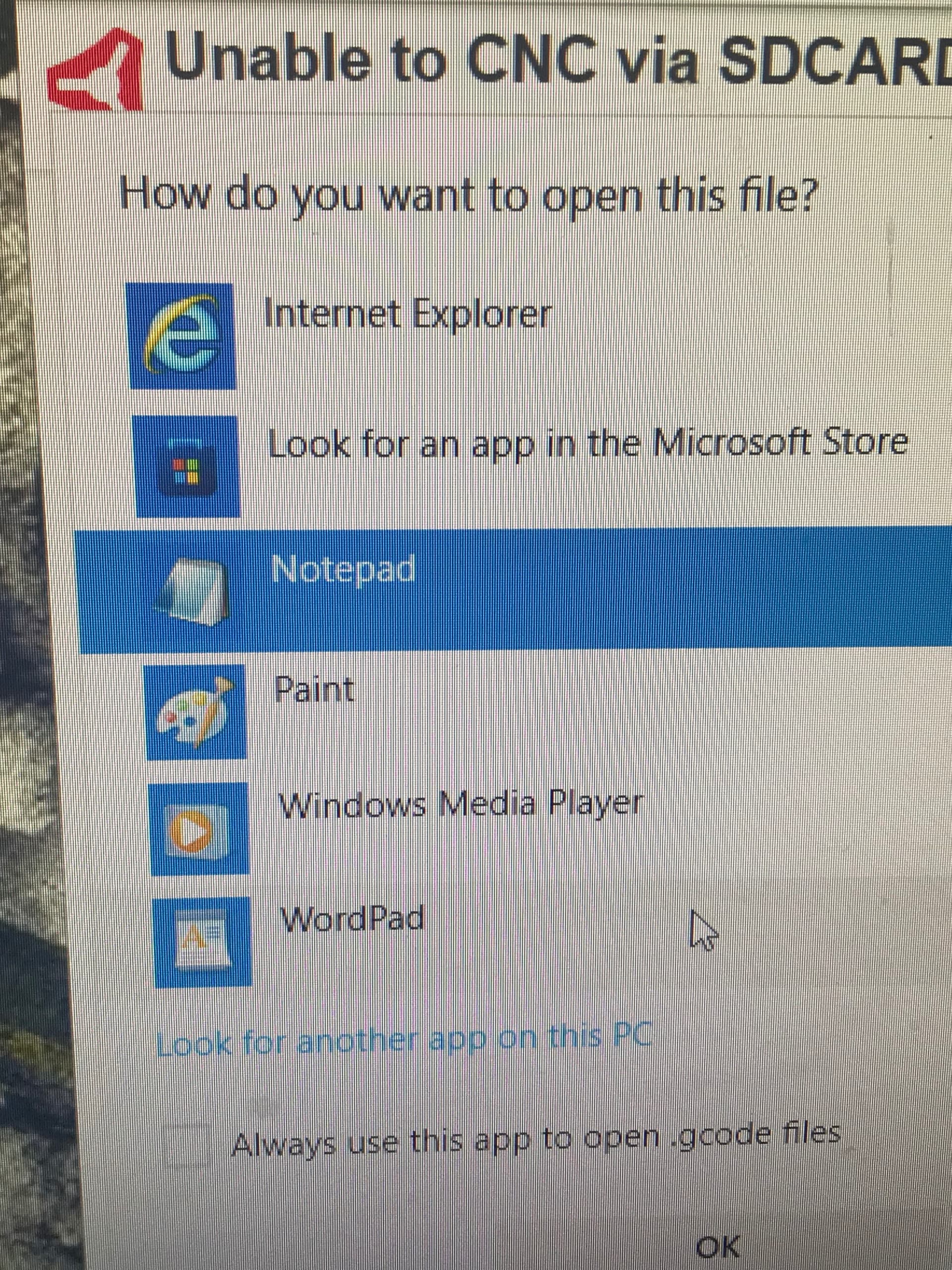

Says pick an app.
^ these are my options from my computer. Which most I think will be a text style document. Unless there’s one that may work that you guys see?

@azab2c lol we havent figured it out yet, however hoping thatll work as intended. Going to try to kick the file out from fusion to the usb. Yes, that was the plan with reviving the thread that maybe i can find some success with this. Set the next one up with less head banging later on lol.
Ill keep ya posted. Thanks aaron
Well with a saturated post with a lot of me rambling and such. We’ve made it over that sort of this hurdle!
In short it was exactly what you mentioned!
I saved the file with out a dedicated program (such as .txt) and I did reformat the sad card to default FAT32 > added a sub folder inside the as card > gcode.
Then drug the file and dropped it in there.
BOOM! It was read and the controller picked it up!!!
