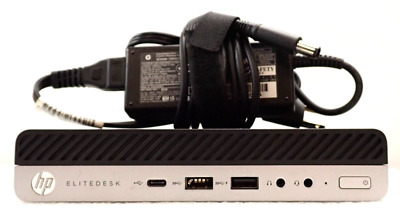

I have been mucking around with homelab stuff. It started when my nas had a bad drive, so I added some new drives. Then I wanted more docker, so I bought an ho elite desk mini on ebay (didn’t Turninbjorn have some extra of these? They are awesome and it was $60). I have been messing around with Next Cloud, Jellyfin, and Navidrome. But I want secure access to everything remotely.

I have one of these I run home assistant on. Started out on a pi4 but always seemed like it was hanging up. Now it’s been on the elite desk for over a year running on proxmox and I have no issues at all. Was definitely worth it. I tried to get another one to run my NAS from and was just going to 3D print an external drive bay but ended up with the larger elite desk and have them inside. It burns more power than the small one but is working well. If I could get my hands on another mini I would swap it out for sure lol. Just need to make sure it has enough sata ports for the drives
I bought this one. It has one SATA port and one nvme drive spot. It has a M.2 slot too. I am planning on trying frigate with coral there. I’m very impressed with it so far. I tried a couple of OSs, but I am most familiar with Ubuntu, so it is running 22.04 and I pretty much immediately installed docker and portainer and have been managing it through portainer. One of the front USBs is definitely broken, but otherwise, it’s working great.
My HA is running on a HA blue. This HP could easily run it instead. I have considered moving it, but the blue ain’t broke, and I bought the HP hoping I could be a little risky with it and not worry about complaints from the family if I broke it for a few days.
They seem to have come down in price some. I believe mine is a G1 and I paid more than that without a power supply lol.
My trunas computer has 2 4tb sata drives in it now with plans to upgrade to more in the future so not sure how I could run that with just a single sata port. Might be better off sticking with the larger form factor for that computer lol. I do want to move both of them into my “electronics” closet soon, but havent gotten there yet lol
