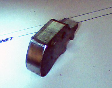

I stayed with the 4 flute carbide endmill as it was all I have left. Reduced the stepover as suggested, kept everything else the same.
Was a fast milling operation, it surprised me.
Came out pretty good in my view, 8mm thick mild steel.

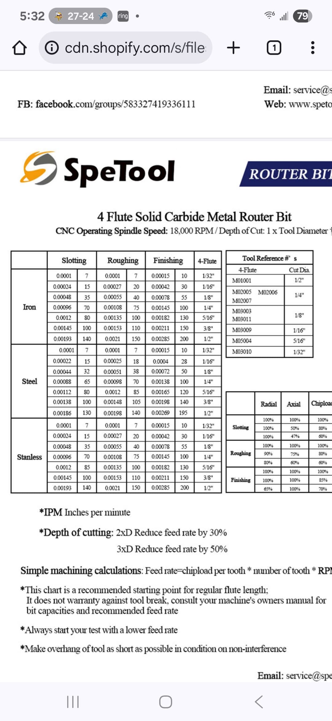

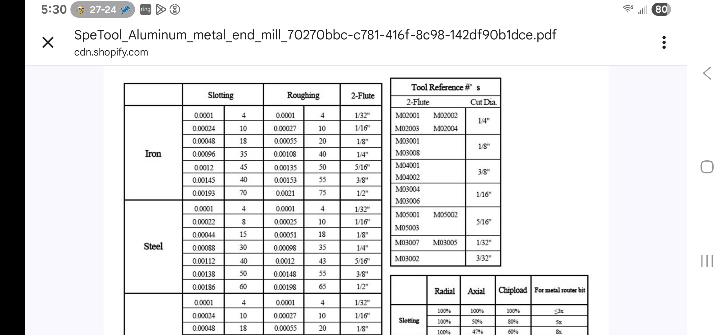

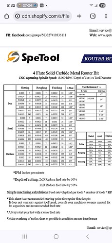

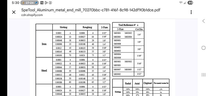

Here is another site that also doesn’t cover enough, but is also very useful.
Spetool has a little bit on steel
Didn’t notice they had a 4 flute!
Great, I will check that out.
