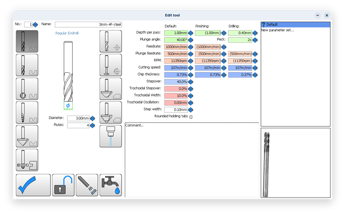

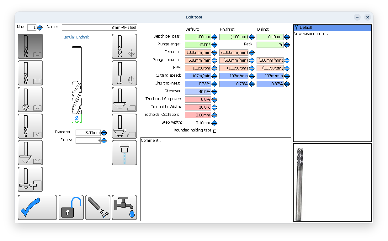

I have been trying to use trochoidal milling of steel and had some success and a lot of failures.
The first time I used it the cut came out okay, a bit slow, but a good finish.
Those settings I lost while trying to improve the settings, so I went to AI to get some help.
AI came back with settings that seem too fast for my liking, and I am afraid to try it out as I only have one cutter left.
Maybe some one on this forum can look at my tools and assist in getting the right settings.
The tool I have left is a 3mm carbide endmill, 4 flute and I am cutting into 8mm mild steel, air cooling and a bit of WD40 (applied by hand)
These are the screenshots of the main tools I am trying to use.

Definitely. My dad is a traditional machinist so talking about bits with him is interesting. He uses 4 flute endmills but on a milling machine going much slower than a trim router is capable of. Running a 4 flute endmill at 10000 RPMs just doesn’t make sense unless you have an insane feedrate.
My machine has a 24000 RPM spindle.
but you need it to go like 2400 rpm…
or…
Note that your screenshot is suggesting 188 METERS/minute which is 7 miles per hour which would mean that’s how fast of a feedrate you would need to get an appropriate chip load.
Edit: Maybe I’m interpreting that wrong. But the point stands that you would need ludacrous speed at 24000 RPM.

24000 RPM is too fast a spindle speed for any reasonable attempt at what you’re trying to achieve.
