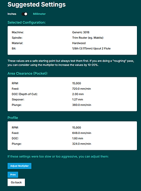

I created a throwaway account just to check it out. The available models to select are mainly from the sponsors, which makes sense, but there are two generic options.
I made some selections just to see and this was the results it spit out for the parameters.
Take it with a grain of salt since it will not match the machine profile but it at least gives you a picture of what numbers that it gives you.

Performance capabilities vary depending on build materials, endmill runtime+condition, build assembly, table assembly, and more… Accurate modeling not informed by actual real data would be tricky. You’d likely end up with a calc spitting out safe numbers, leaving perf on the table.
Personally like knowing what the conservative safe numbers are, but, also what’s possible, what limits have been pushed by community members via their videos, and profiles they’re using.

For me, no calc. Just tested and proven basic starting point. Beyond that fswizard has always been linked on the basics page and is easy enough to use once you know what you need.
Too complicated. it will never work for everybody.
“here are some super conservative setting that should work, if not your bi tis dull or you have a build issue.” and “here is how far it can be pushed”. Let lets people know when 8mm/s-40mm/s is the window or 2mm/s-5mm/s.
