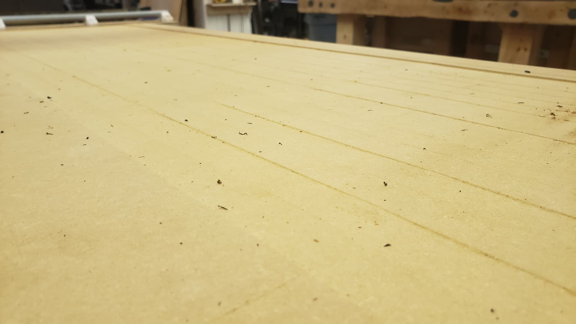

I got around to surfacing my spoilboard but only did one of two passes after seeing that my router wasn’t parallel resulting in ridges and uneven work surface

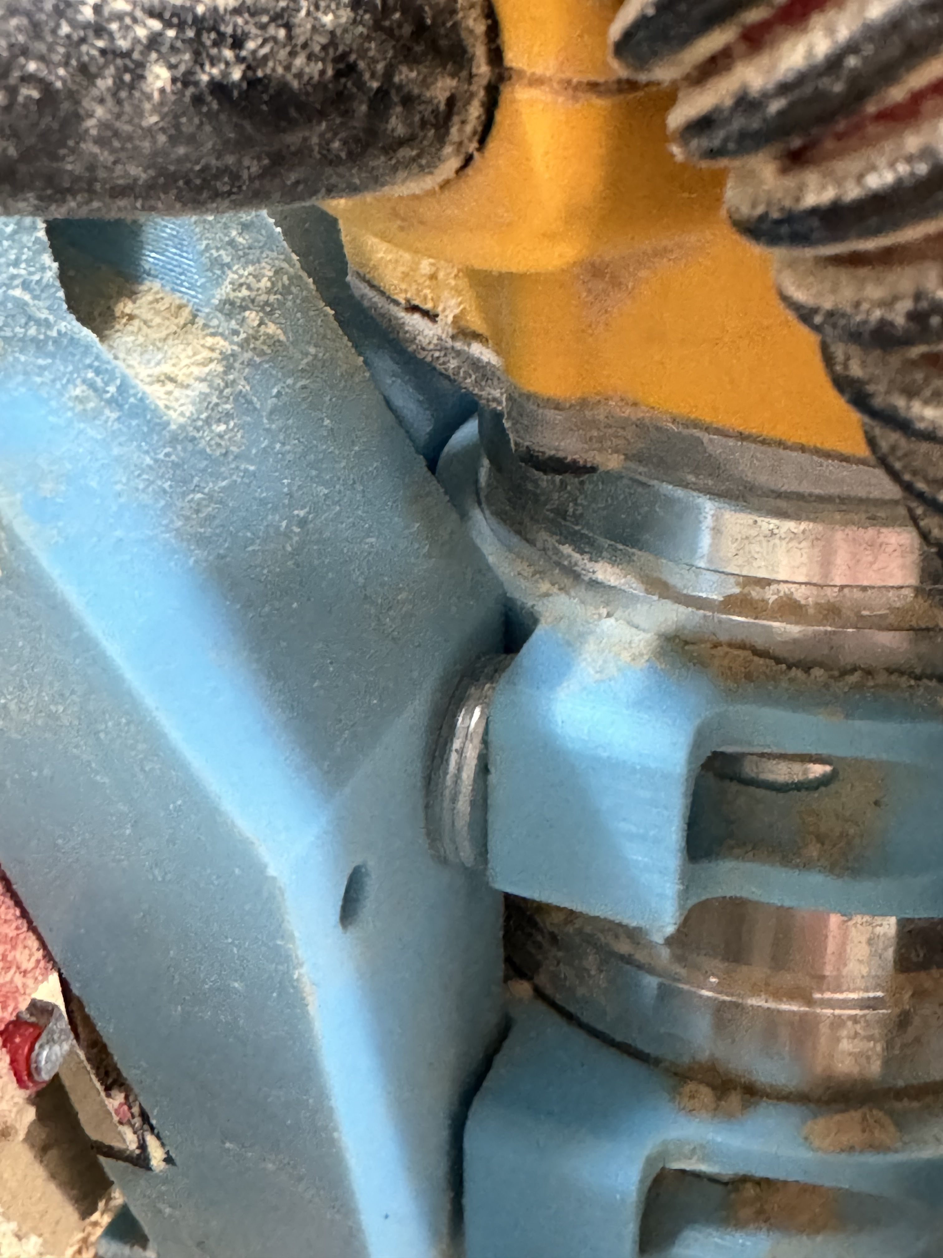

I ended up tramming the router early this morning. Used 3 washers (6 in total) on the top brace. It is still 1-2mm out at 4 inches. Is this good enough? If not is 4 washers too much?
That sounds like a lot.
What kind of router is it?
If it was 4-5 mm out of square, I would guess there’s likely a bigger underlying issue that needs to be addressed.
Dewalt 611. I have been away for most the day, I’ll try and get a picture and some legitimate measurements once I get the little one down
So here are the photos I could get. Washers are 1.25 mm so 3.75 mm shims

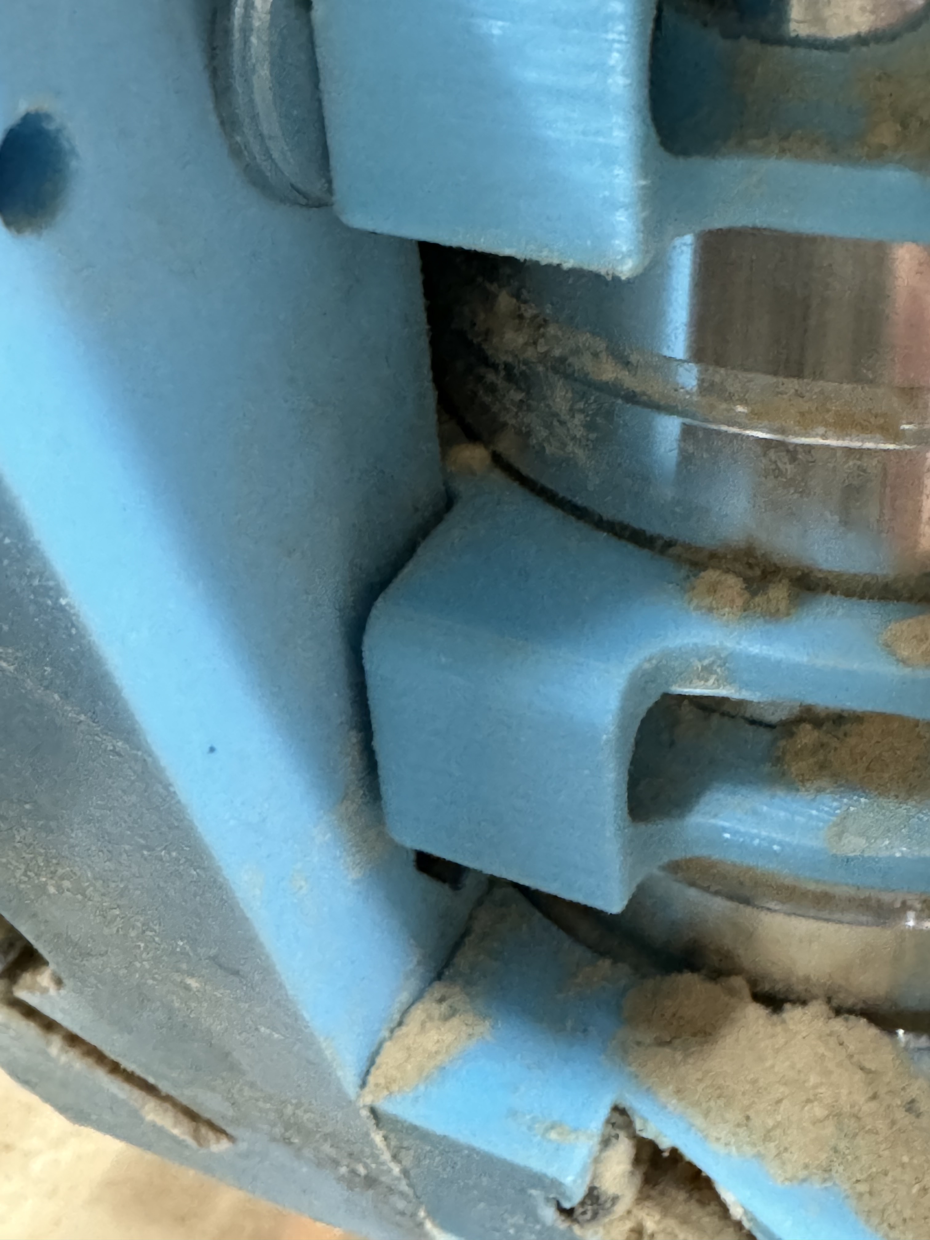

It also looks like my bottom tool mount isn’t sitting flush but the bolt is tight (snug then two rotations). It look like that gap may fix the last of the tramming. But should I tighten this?

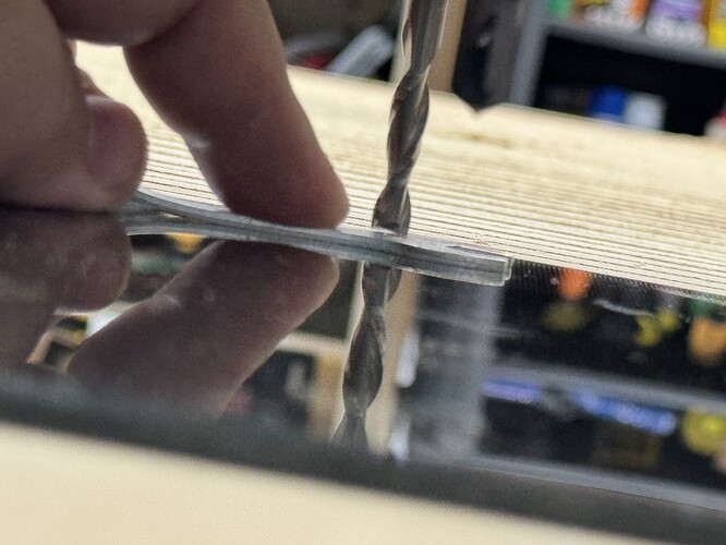

Edit/update: apparently I fixed it??? Attached the two bits on a tram arm again and now it’s parallel? I had losened the lower mount and started retightening both sides again. Gap is still there but the issue is fixed? Do I mess with this black magic to figure out why that worked?
Tested it in a couple of different areas. Occasionally light would be visible under one flute but so minimal like maybe 0.1-0.2
I’m no expert, but I’m pretty sure that the gap on the lower mount indicates a problem with the whole system.
Typically the printed parts fit together pretty tight (at least in my very limited experience), with no gaps or voids. I would look for things like elephant foot, and maybe check the printer calibration again. You may need to shave any edges or protrusions to make a better fit.
The gap wasn’t there before adding the washers to the top mount. I’ll check everything again when I get back in there in the AM. I don’t usually have calibration issues as I print a lot of precision parts but 3d printers can be unpredictable so I’ll double check
Yeah, it’s probably pivoting on the vacuum shoe, so you may not be able to close the gap with all of those washers in the top mount. Tightening the bolts too far could cause a crack.

Ummm… Got a wire coat hanger and a 1/8" collet? Make yourself a quick double-90 ‘Z’ with a decent throw, and use that to test for perpendicularity. It’s a lot easier than trying to check the ends of the flutes. It’s also a lot more sensitive, since you’re exaggerating the error across the throw of the arm, rather than the diameter of the bit. Doesn’t even have to be perfectly square angles, either. Just as long as it’s consistent all the way around, it’s perpendicular. Maybe wrap some tape around the end so it fits snug in the collet.

You would not add the washers behind the screws since your router does not sit tight any more. You add a strip of tape behind the router on the mount.
I didn’t realize Ryan had one. I printed two different types one that uses two 1/4 router bits and another that uses a dial indicator. I’ve only used the router bit version as my dial indicator is bigger than the 8mm.
