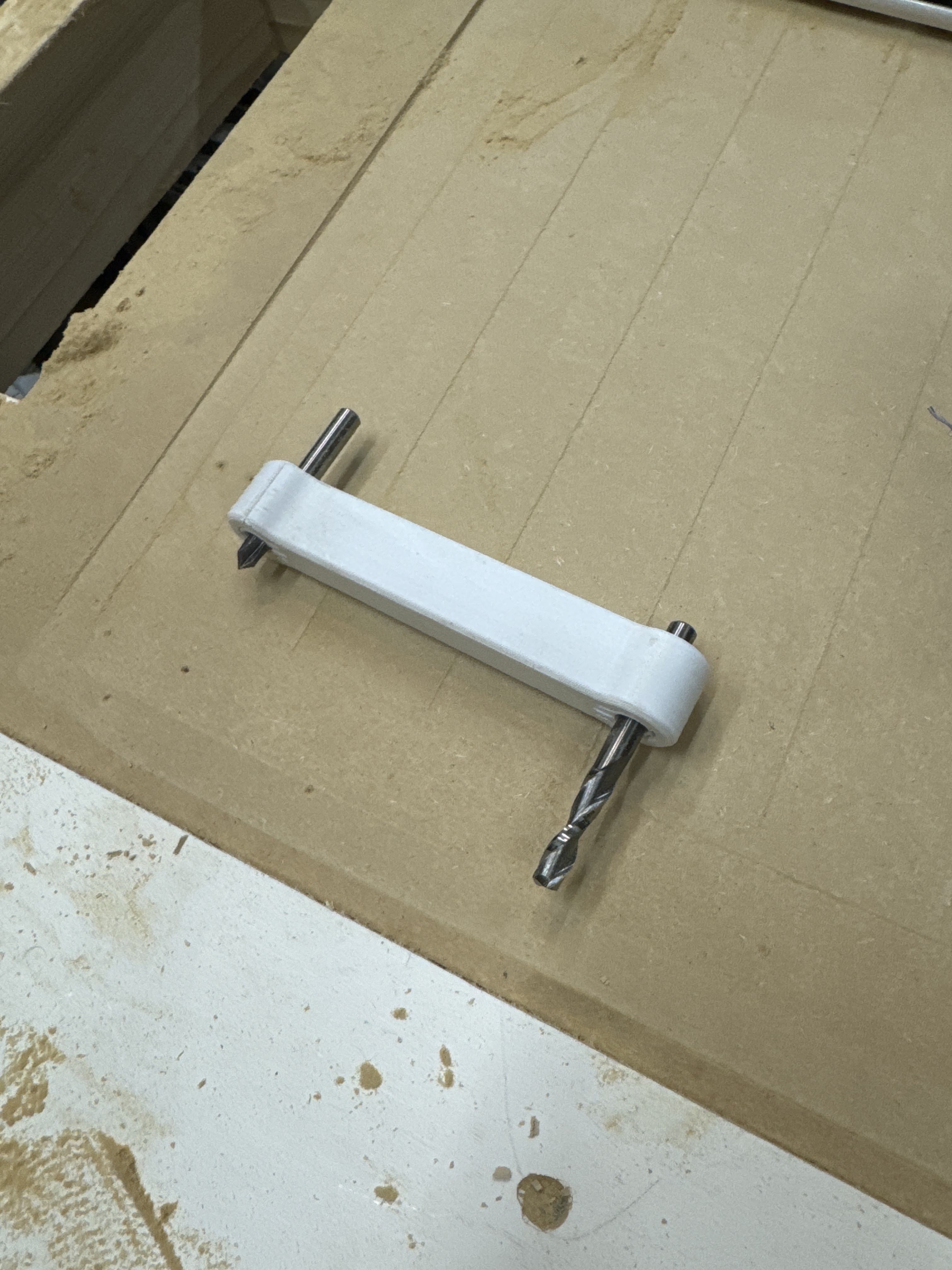

Oh okay sorry. I am measuring from the router bit in the tram arm I printed. 1.88mm away from my 3d printed glass bed. This is constant cause it is the distance of my touch plate so for easy math sense we can make those zero
X0 the back or +Y is +1.22mm above the glass bed
X1200 the back is 2.08mm below the glass (I had to raise Z axis to get bit to graze glass)
Is this Ryan’s printed arm? Or a different one.
I ask because for the ones that slip over the collet, I found it very easy for me to have it installed where it was actually not completely perpendicular to the tool.
A very slight variation at the collet gets multiplied out at the end of the arm.
It is a different one. Also side not the gantry it is not noticeably twisted. Flat on the table with no flex wherever I push

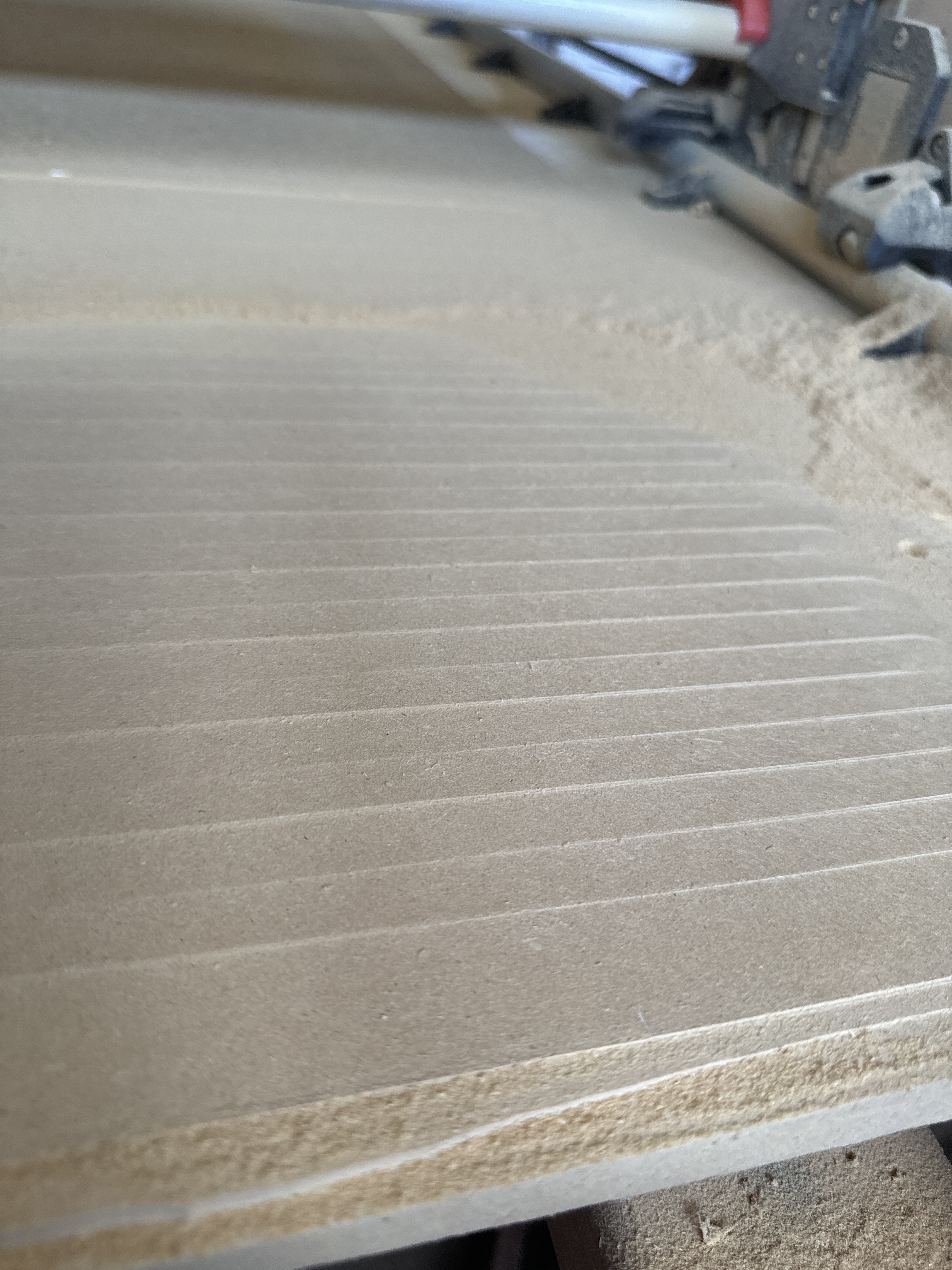

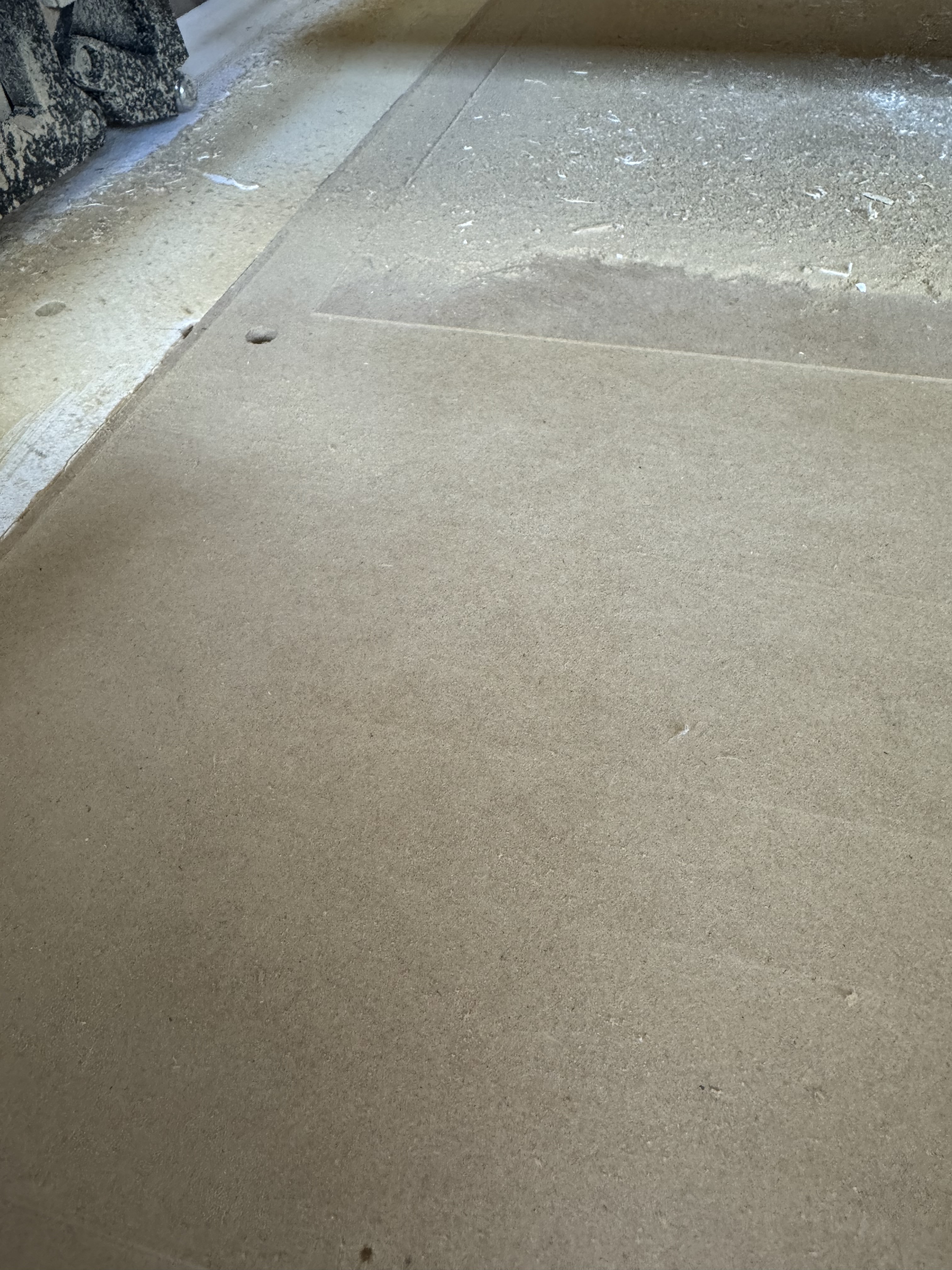

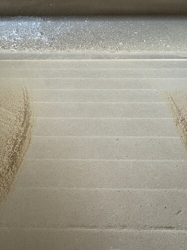

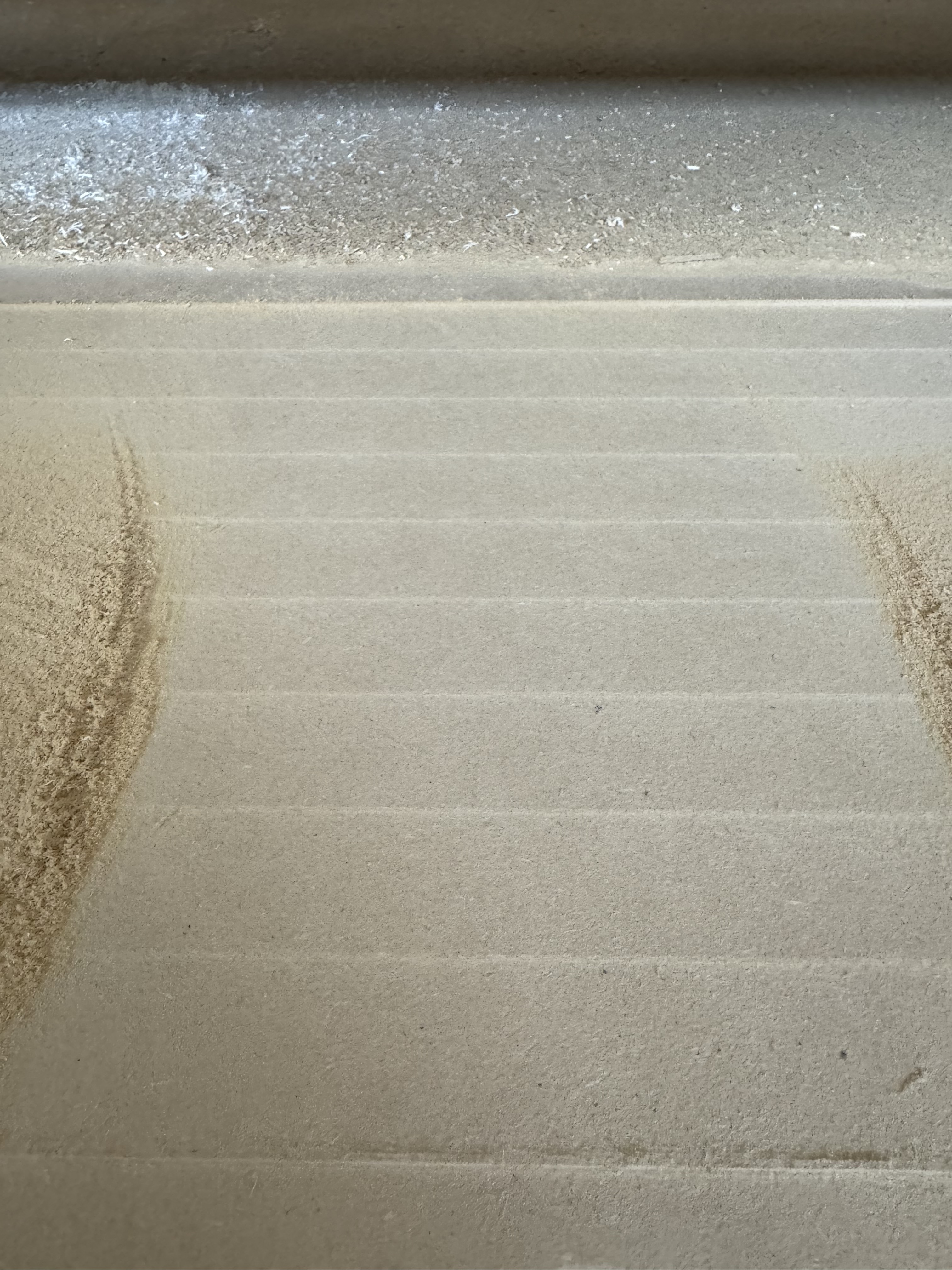

Some new info. Worked really hard on getting spoil board more flat. Went got another mdf sheet (much better this time. 3 mm out in some areas. Currently trying to surface and going to figure out the ridges later.
But new info. Left side (X0) has a ridge every 2 cuts that I am not able to feel. Right side has ridges every cut that you can feel but I can’t seem to measure yet (any ideas here?) the middle is a hybrid. It’s every two cuts and you can feel them, doesn’t feel any bigger/smaller than the right side
Photos
Left
Middle
Right
Left side ridges don’t show up for 5” (TBDmm)
Right side ridges are the last 8” (TBDmm)
