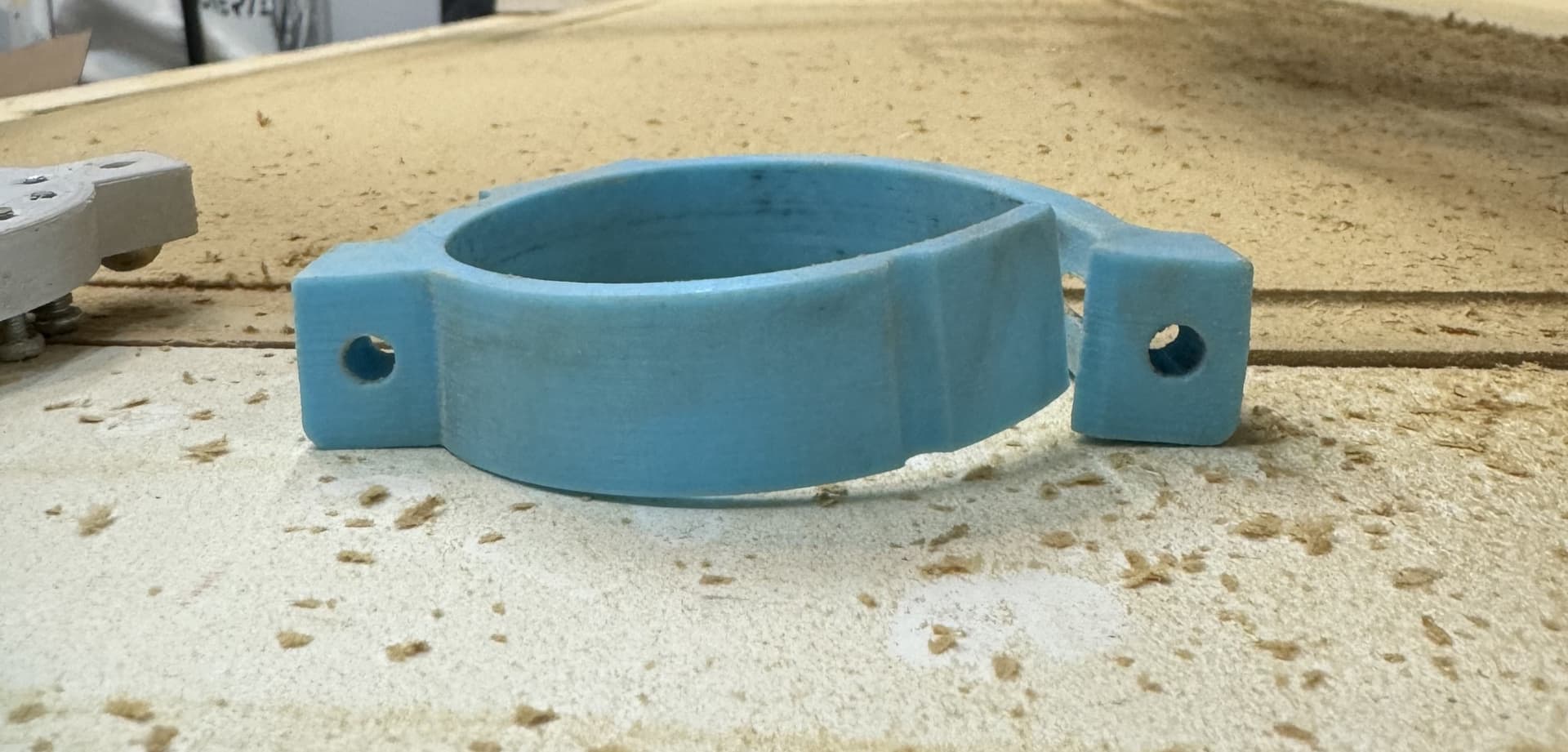

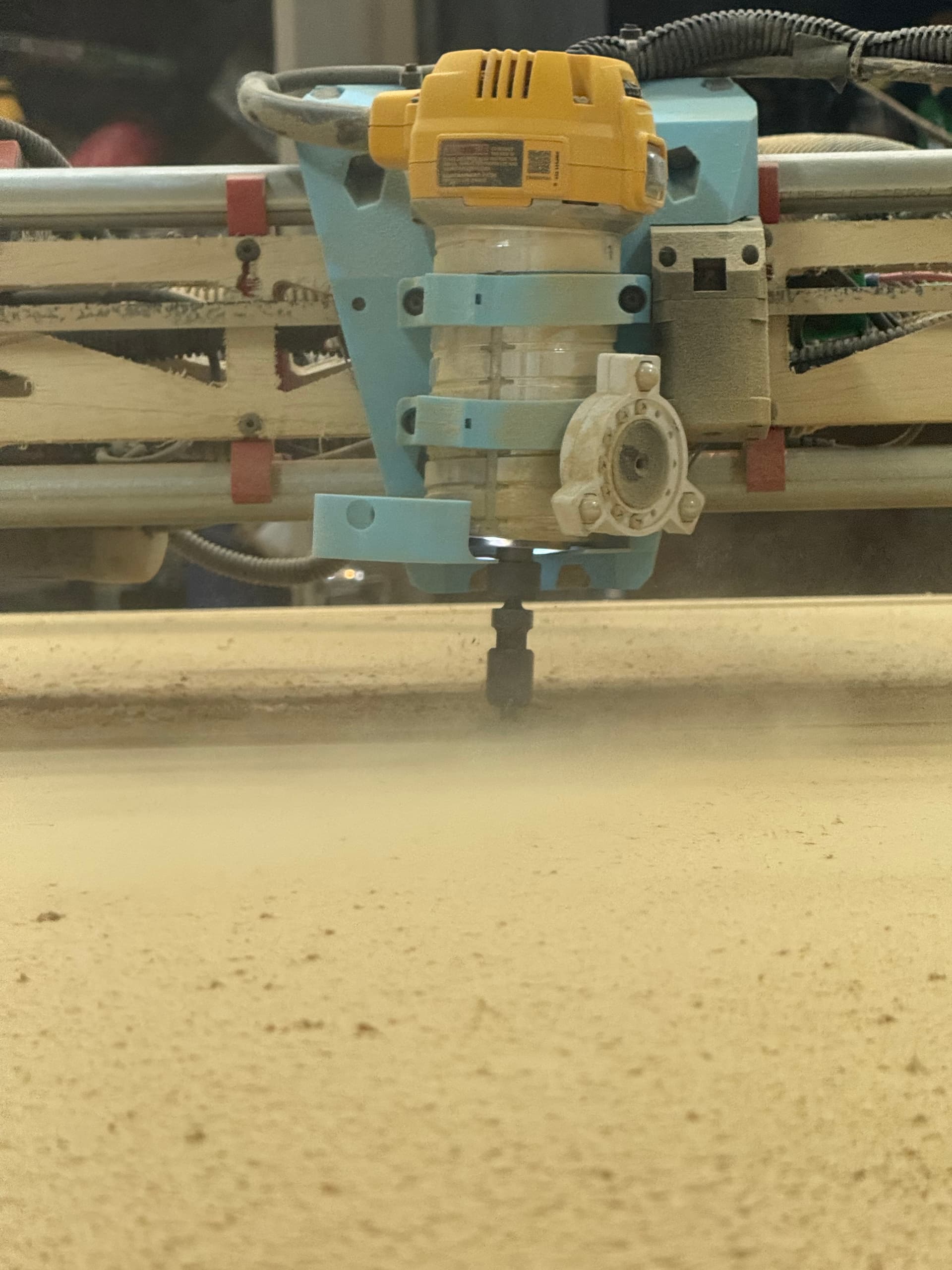

-My Router seems like it is running HOT; Measured it after letting it cool for 10 minute and it read around 100°F
Story:
I decided after not getting it 100% trammed I would try and surface again as we couldn’t find what may have been causing the issue. After 3/4 of the way my GFCI was tripped (believe it was static build up in dust hose) I was out of shop time at that moment so I shut everything down took the SD card with me to slice the Gcode later. Later I sliced the Gcode and restarted it. I initially noticed bigger and more ridges. after going to the far end of the table I saw the router was significantly tilted (Image below), I went upto it and could physically wobble the router. After stopping it I took apart the tool mounts and the bottom looked Funny (Image below). Did the heat cause this? Was this a result of another issue? Top one doesn’t look twisted but will reprint both.

Are your parts printed in PLA as recommended?
The glass transition temp for PLA is around 140F, so it’s really likely that your router has heated the mounts at least enough for them to deform and fail.
There is significant misalignment of the router in the mounts in your picture, and based on the temps you reported you’re going to need to reprint all the deformed parts. The washer stack to get it back to level means that the deformation was well under way as you were trying to sort this all out.

I do. I have never used the ammeter but do have one. Tool mounts are almost reprinted. I didn’t notice any damage to the core minus maybe some slight slop in the bolts. I imagine that isn’t enough to need to reprint the core?
