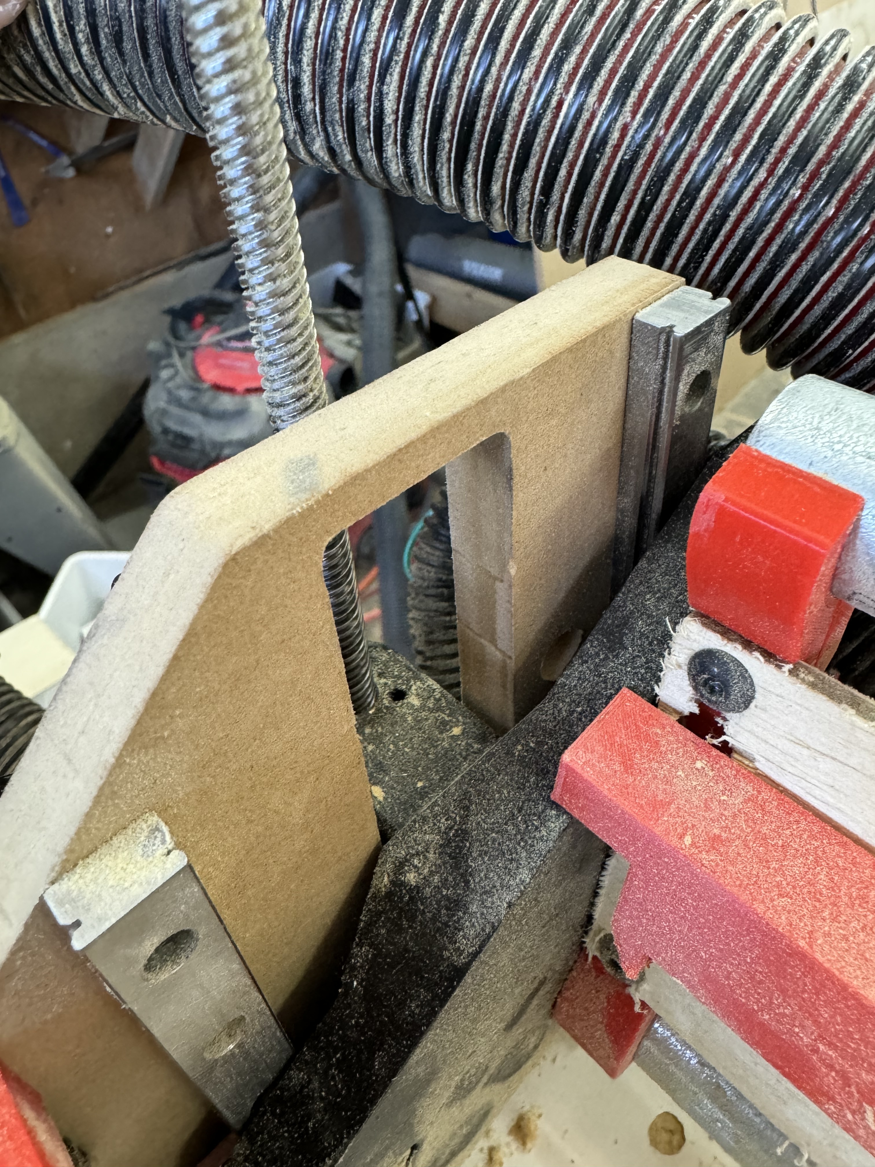

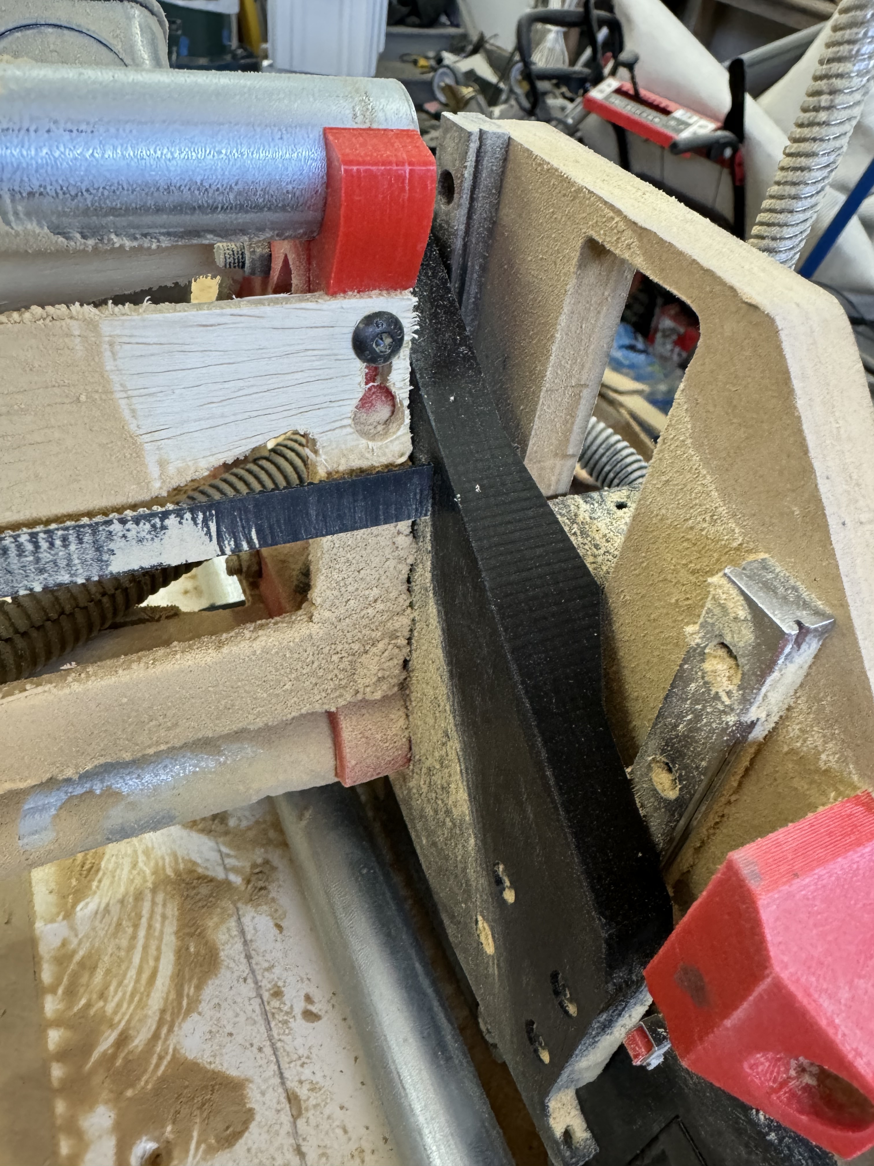

Help me determine if I’ve figured out my issue and/or a possible fix. For my build I have built everything but the YZ plates. I had a friend cnc it on his machine. He didn’t know how/wasn’t able to pilot drill the holes for the Z Rails. What I did was take some measurements off F360 and used my digital caliper to transfer those onto the plates. It appears I messed up somewhere as the front (-y) side is down and the back (+y) side is up compared to the other side.
The back (+y) rail is only above the yz plate by .7mm
The front (-y) however is 2-3mm lower
Any ideas on fixes for this? Or will I need to recut the plates and reassemble the whole machine? Would this be what is causing my issue of what appears to be a twisted rail?

You can definitely see that the tops of your linear rails are not in the same spot, but I would expect that to cause more of a problem with Z level than twist.
However, if your rails are not both perfectly perpendicular to the Y-Axis as they should be or not parallel, I would expect that to cause you problems.
I’m wondering if that is my issue. If I managed to get the heights wrong wouldn’t be far off to assume they have a slight twist.
I’ll think of a way to check it when I can. Any thoughts on a fix? Only thing I can think of currently is printing some kind of template and drilling holes through the back side and replacing the screws with similar sized bolts. Only question is, is it worth the hassle or should I just recut both sides to make sure everything is set
If it’s worth the hassle or not I think is up to you.
It’s likely you can print a template and find a way to get it just right.
If it were me, and I had access to another CNC machine and enough MDF, I would recut it just for peace of mind if nothing else

This is where my mind is at. It should be well within parameters to cut most things. It’s just those super accurate parts will be slightly twisted.
I did however ask for a outside perspective from the wife and she pointed out to me that I could try fixing it with the template and some bolts and if that doesn’t fix it enough I can always cut new ones later.
Well I decided to try the bolt method and I ripped everything apart used a template to drill some holes and bolted everything back down. The issue is now 99% fixed. The 3d printed part that had a partial failure is now causing a square issue and I believe the other 1%. My variance is now down to .5mm and only on right side (X max). I am currently reprinting the part and have not had a layer lifting issue sense printing these parts.
