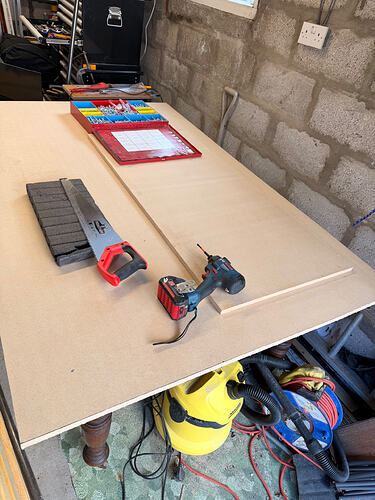

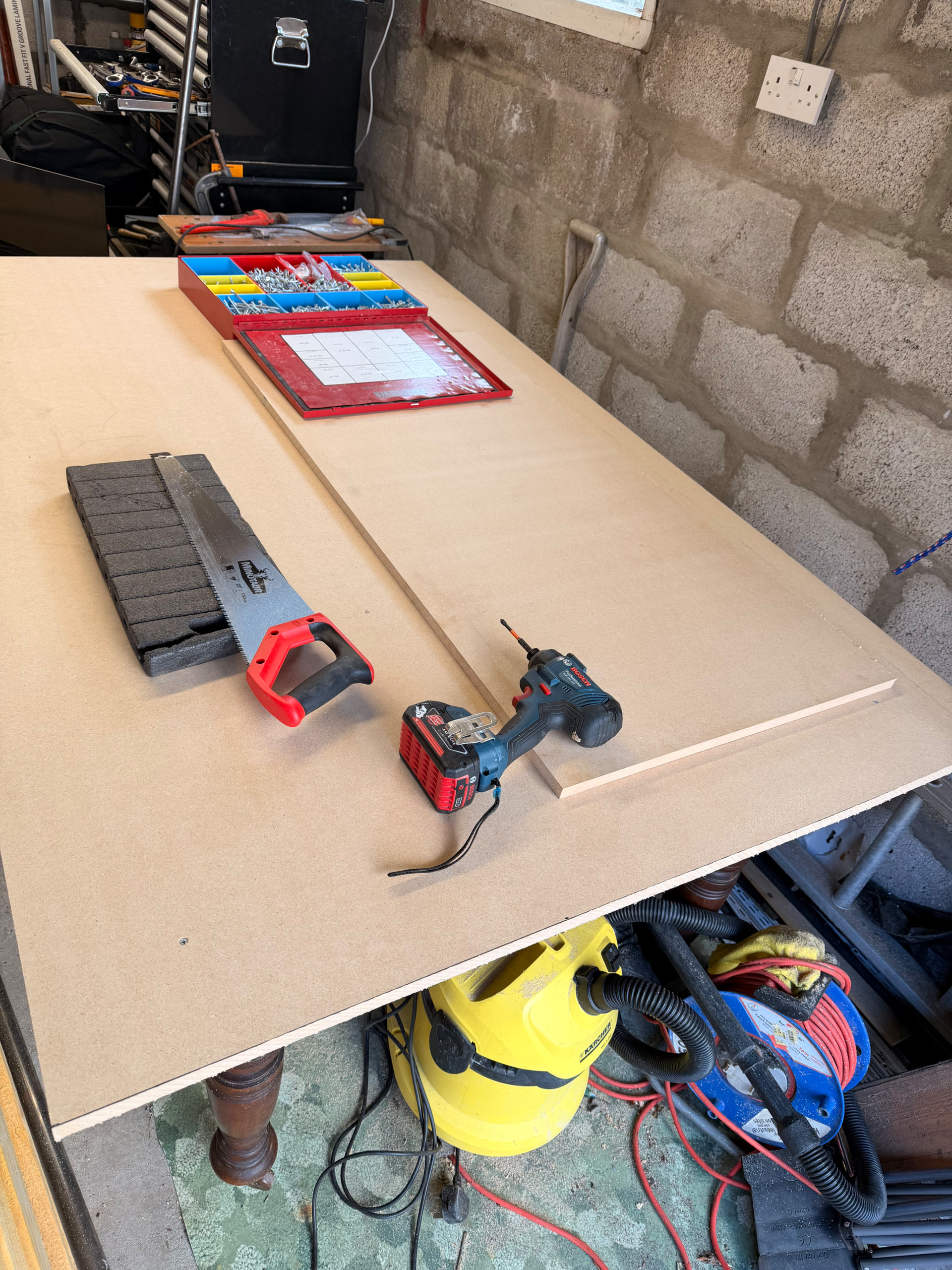

Fun with a hand saw today… pretty straight tho Tbf :smiling_face_with_sunglasses:

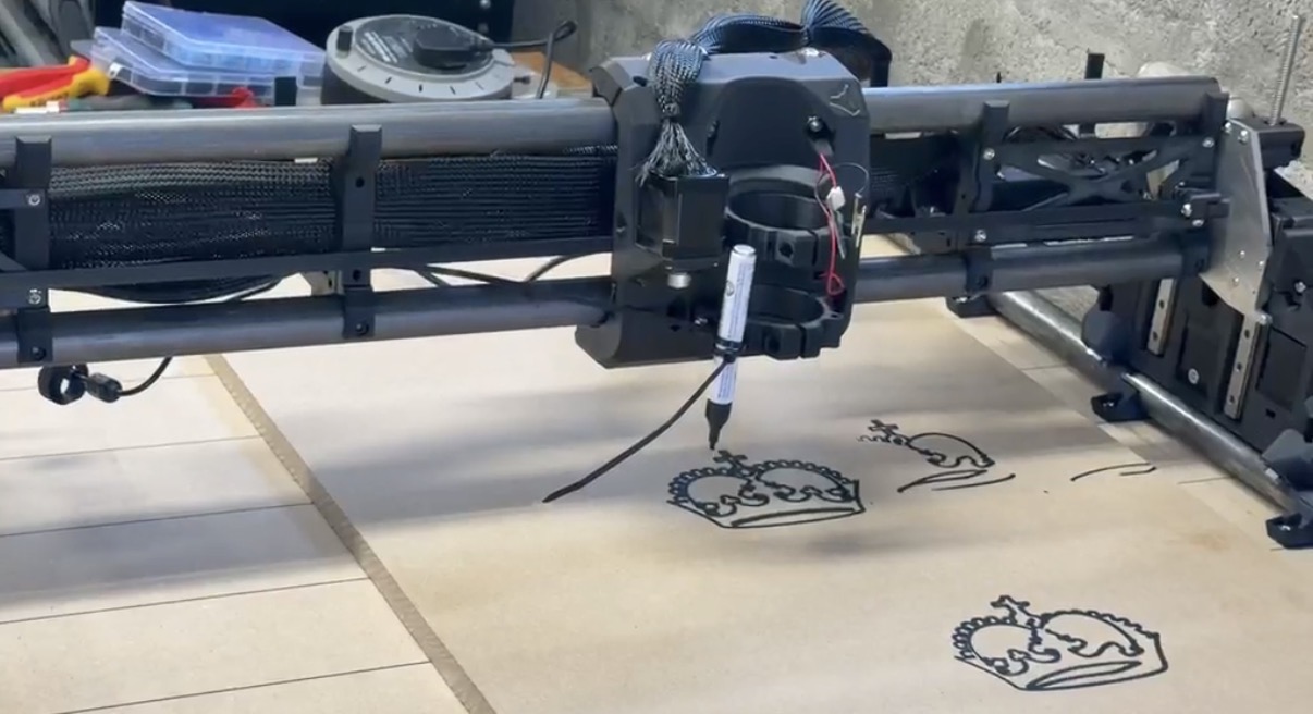

All probes and wiring done bar core. All probes reading :slight_smile: amazed since I had managed to rub the writing off a couple of the markers ( gel marker pens )
Spoke too soon, z and y on one side were back to front, being lazy I just swapped them over in the yaml file so alls good :slight_smile:

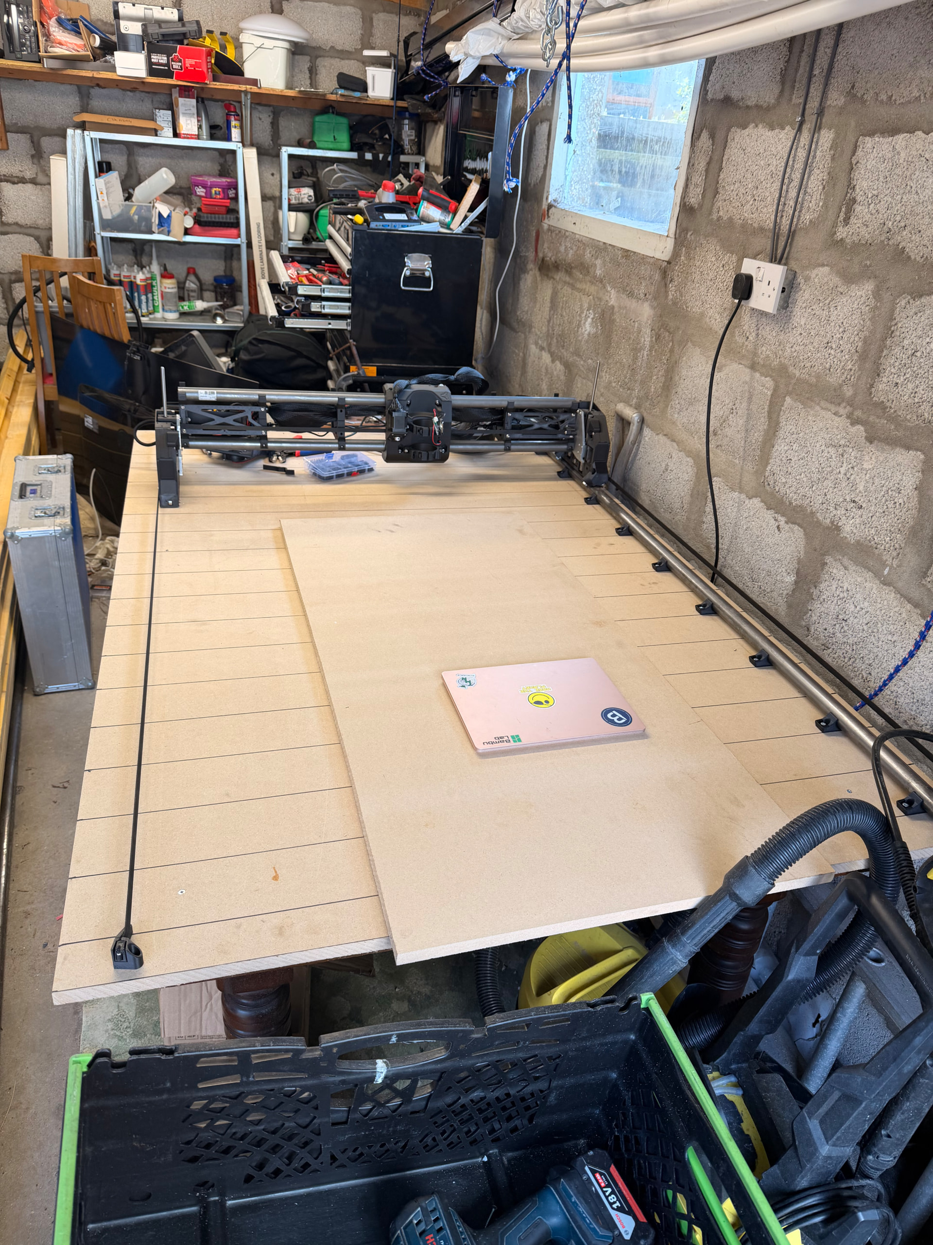

The saga continues. My limit switches are obv a tad short hence the offset placement of triggers. Belts don’t rub.

Some fine tuning done hence the mistakes ( tie wrapped pens are not the most secure as you can tell )
Well impressed!

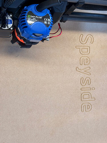

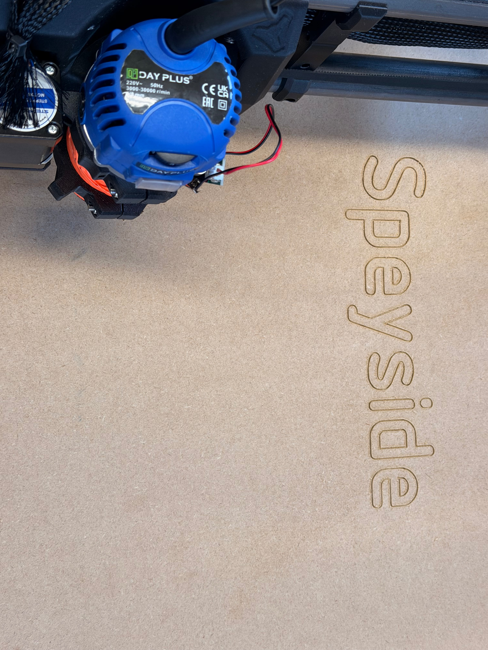

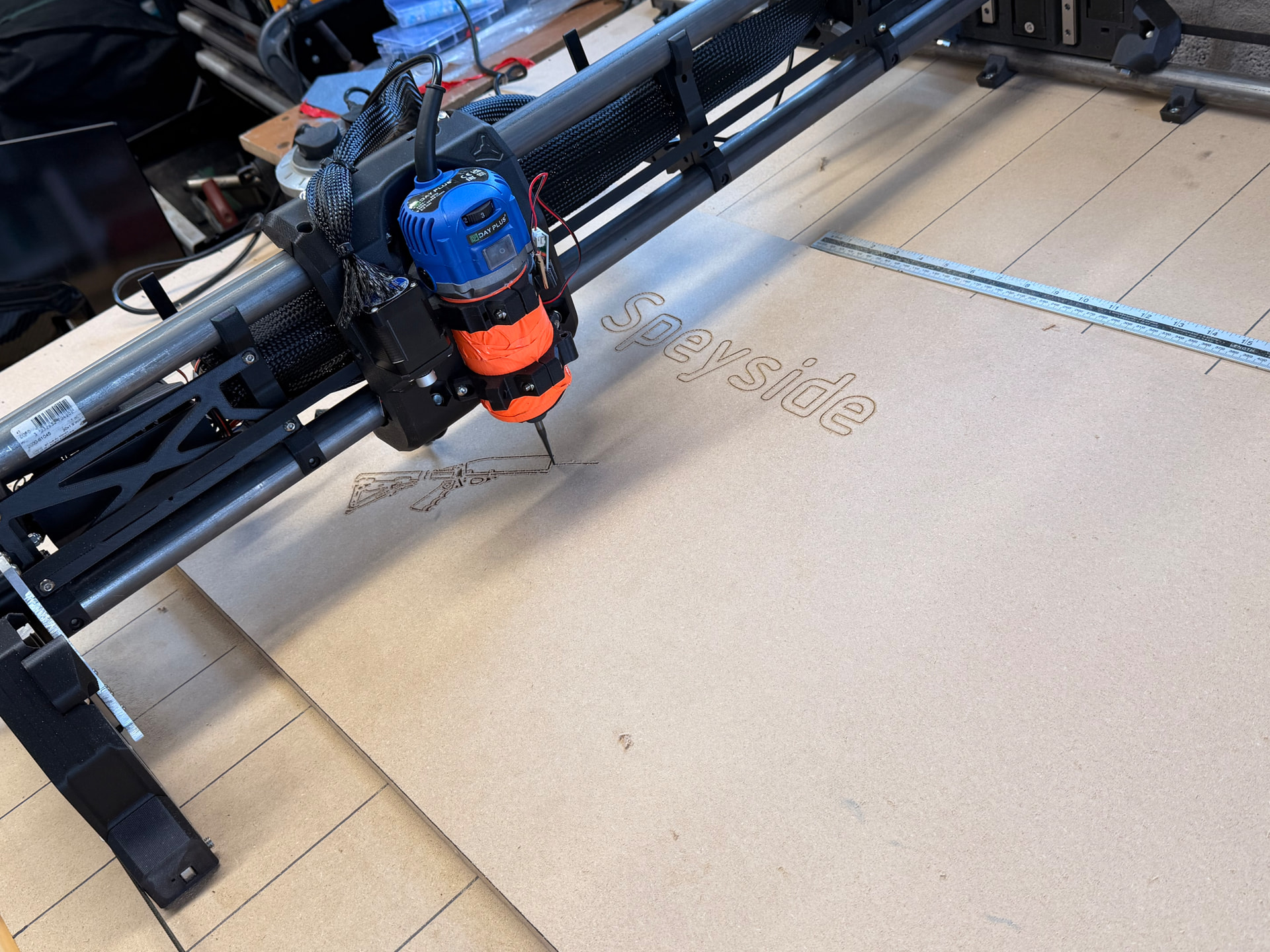

First carving/engraving attempt :heart: this things fantastic!

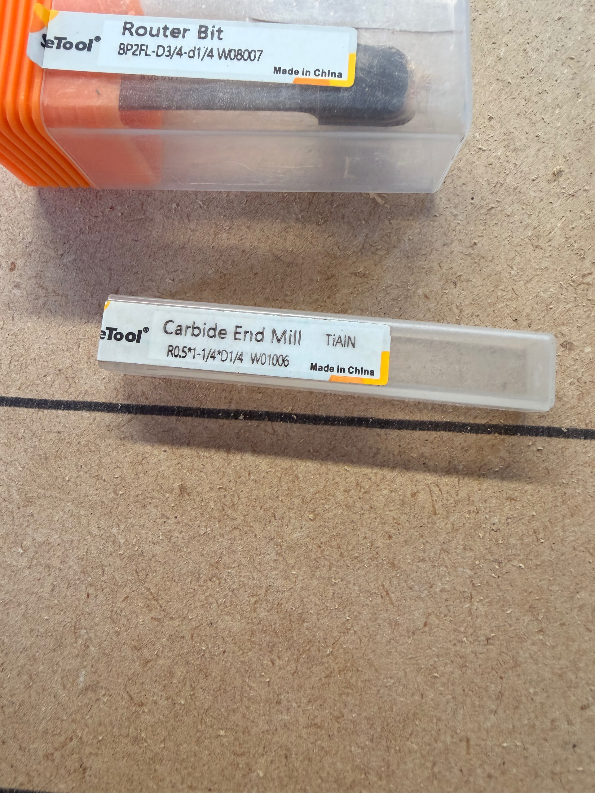

Looks great! What kind of bit are you using?
An spetool nicked from a mate :rofl: they allow downloading of their database. I went to see him today and he gave me loads of bits, a collet, sander, router on loan, loads of solid oak and such :slight_smile:
You haven’t cut your permanent strut plates yet?

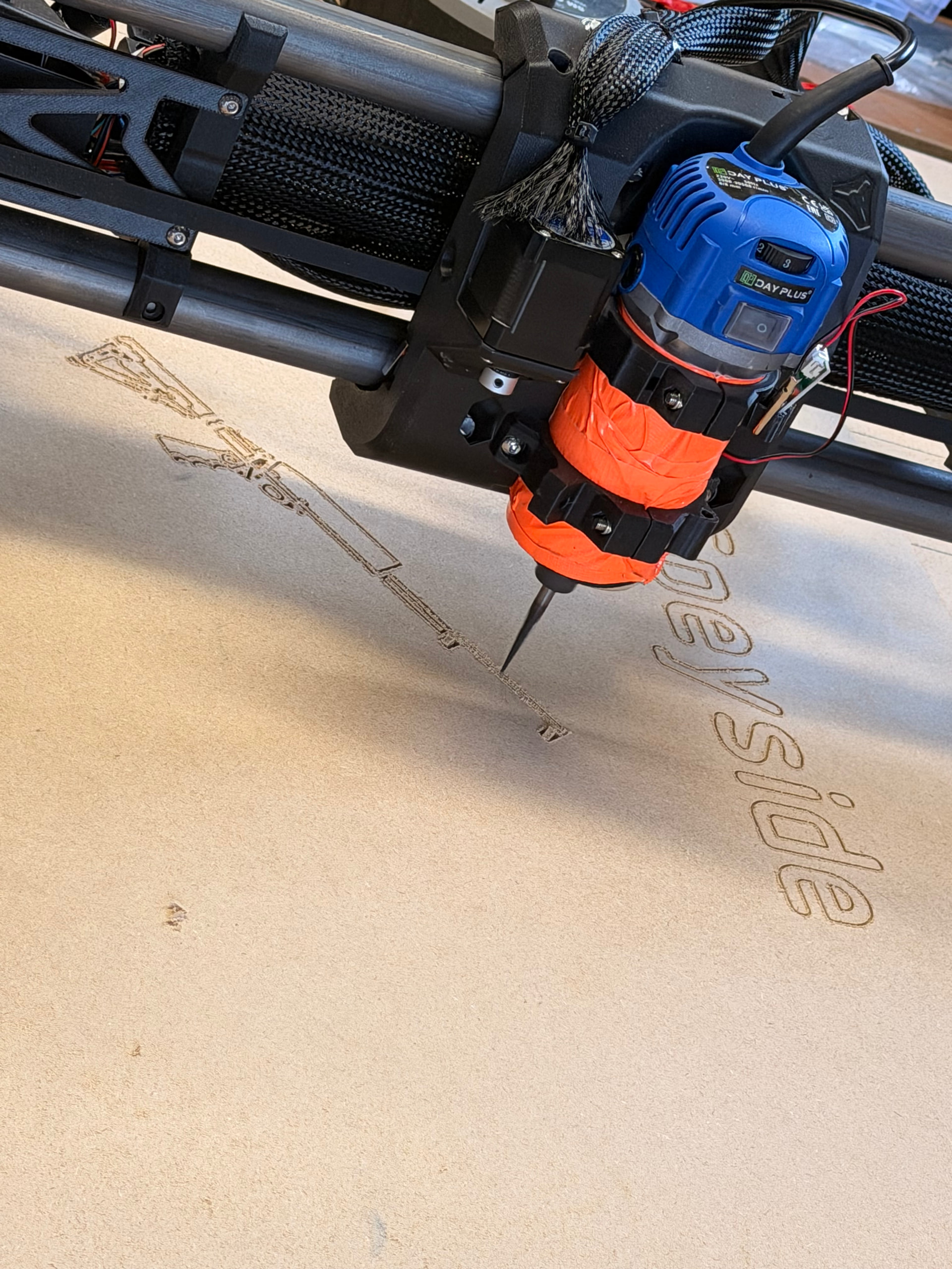

No. I don’t have the correct thickness wood yet. Only playing about. Seems my belt wasn’t tensioned enough and had a slight issue and I need to be 100% sure the table/spoils boards flat, noticing an issue but it’s all good :slight_smile:
If it was me, I would cut and install the permanent struts BEFORE surfacing the table/spoil boards.
Cutting the struts is a through cut, so adding a couple of mm to the depth of cut (DOC) will be fine, and will compensate for any difference in table height. The load will be mostly consistent throughout the cut, so flex in the gantry (due to temporary struts) will also be consistent.
Surfacing the spoil board will have varying loads at different locations, so the gantry will flex differently in different locations. Having the permanent struts installed will mitigate this a lot.
IMO

I have some of those SpeTools as well, well worth the money.. To practise you can also buy 3,175mm engraving endmills for 7€ a pop instead of 22… :sweat_smile:
I was going to buy some idc woodcraft ones after watching his videos tbh, but once more USA company and taxes…. Plus I saw the cost of them :open_mouth: spetools may also be USA but they are cheap as you say on Amazon :slight_smile: I’ll order a set of my own before I destroy my mates with mistakes :see_no_evil_monkey:
