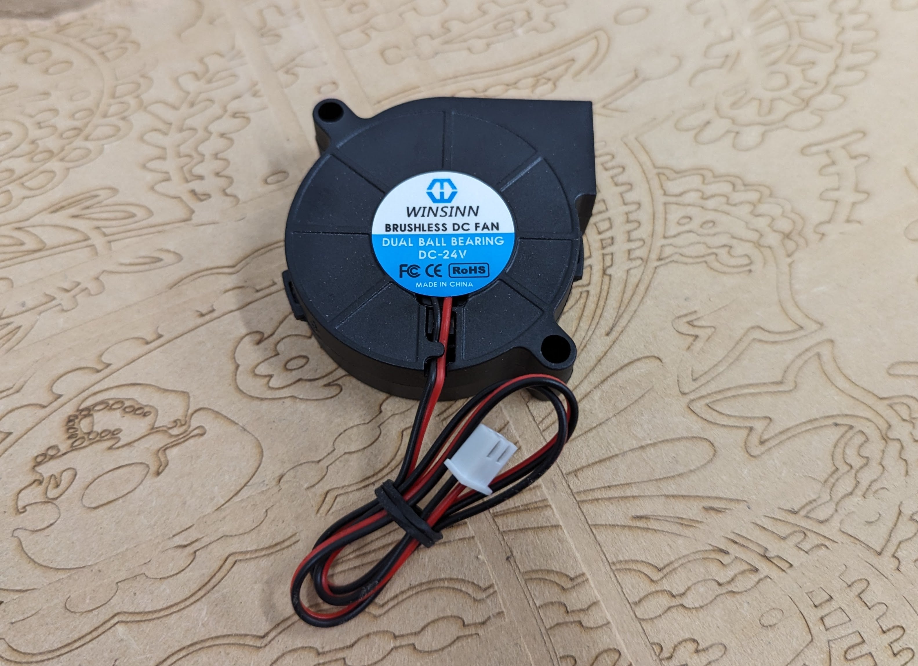

No belt as yet tho so still on downtime. I also need to find a 40mm fan. Assuming it’s an exhaust rather than intake.
This is the fan that Ryan suggest. Also what I put on all of my builds.

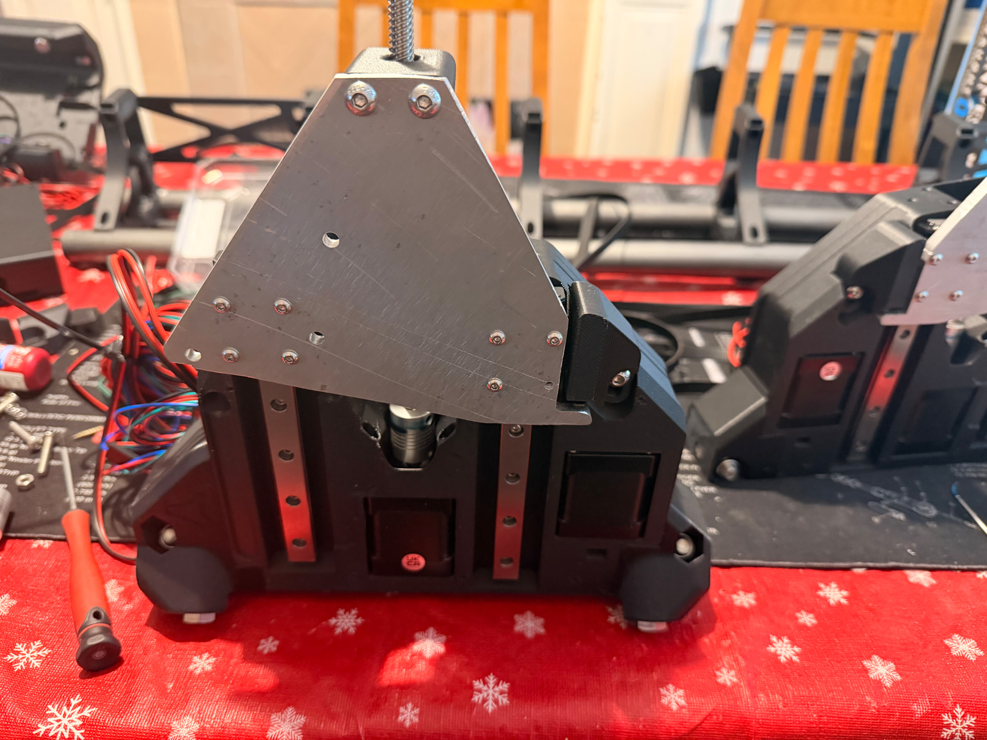

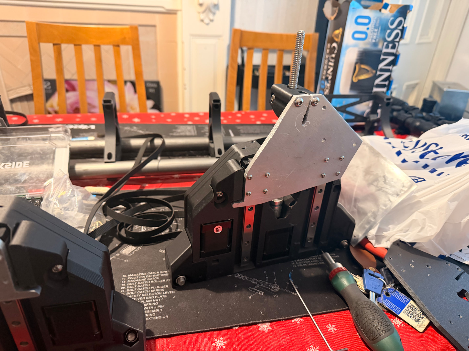

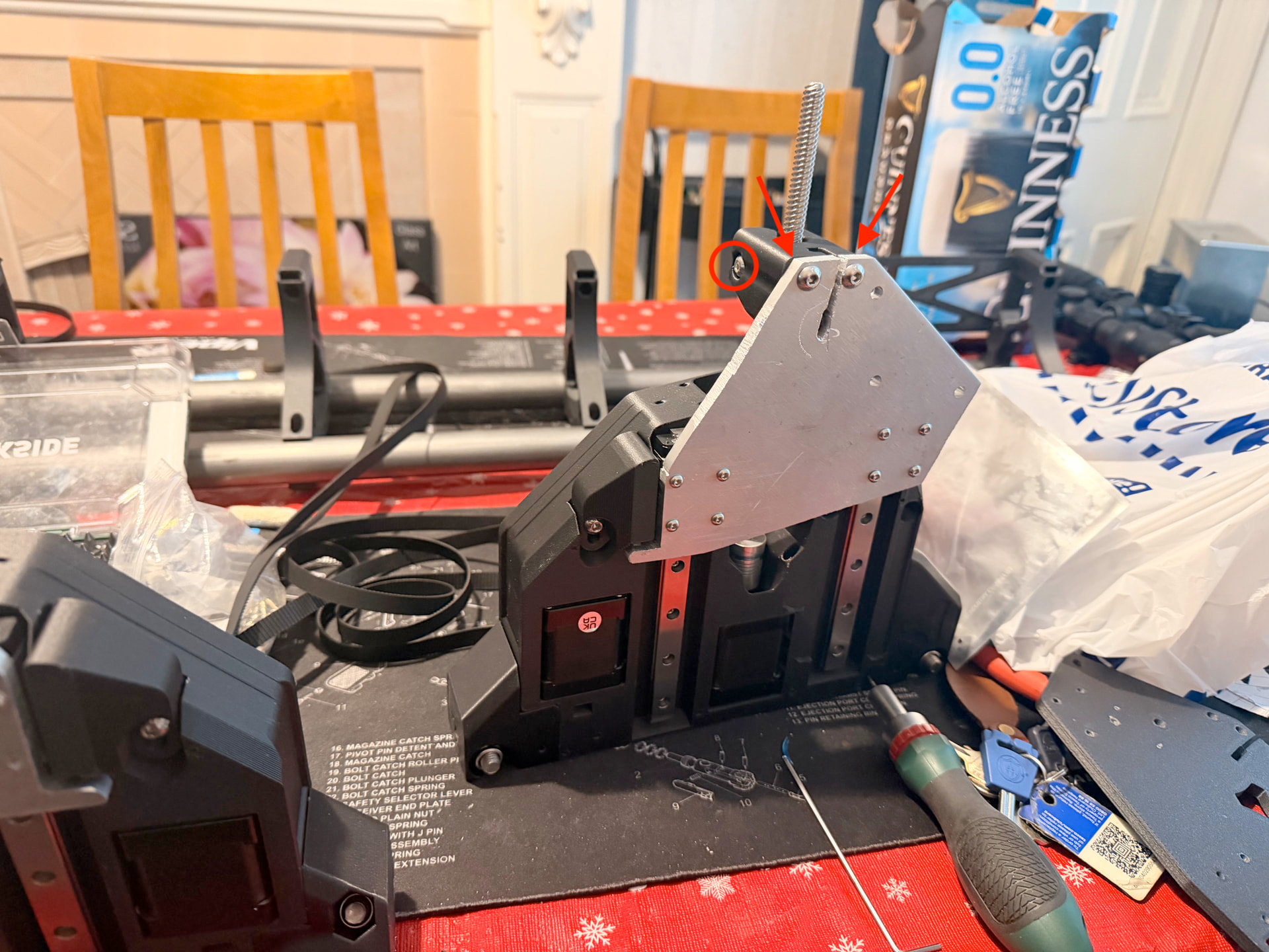

A bit of progress today! Yes yes, 1 hole is like 0.01mm out, be fine with 3 screws I’m sure :see_no_evil_monkey::rofl:
I’ve ordered some wire sheath stuff to keep it a bit tidier as I can foresee issues without.
Found out my stepper extenders were wrong… but I ordered a kit to make ones for the jackpot anyhow so need to wait.

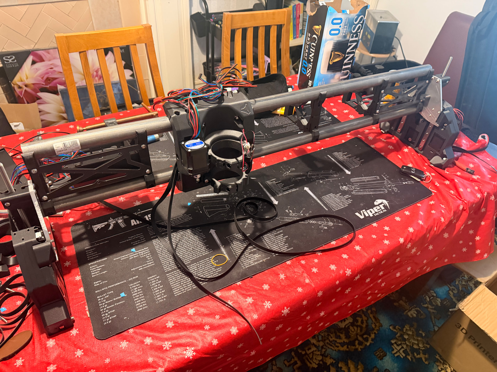

She’s taking shape tho, not long now!
You should really fix that. .01mm wouldn’t be an issue, enough that it won’t go in is sufficient to cause issues later and forever. Fix it now so you’ll avoid issues later.
Edit- also, your Zstub looks crooked, and you don’t want to tighten down the cross-screw in the Zstub.
1 screw out of 13? cant see it tbh, the 3 others align perfectly so its secure. It is enough to allow the screw to try to crossthread, but on tightening if all are loose puts strain.
EDIT - it looks crooked only as the plate was cut with a hacksaw by hand using a stencil 3d printed.
The plates are kind of impressive, ngl! :heart:
Aha! Well spotted re the extra 2 I stuck in! Removed now. What purpose do they serve?
They rarely have one. I’d go so far as to say they never do, but then someone would be mad. :slight_smile:

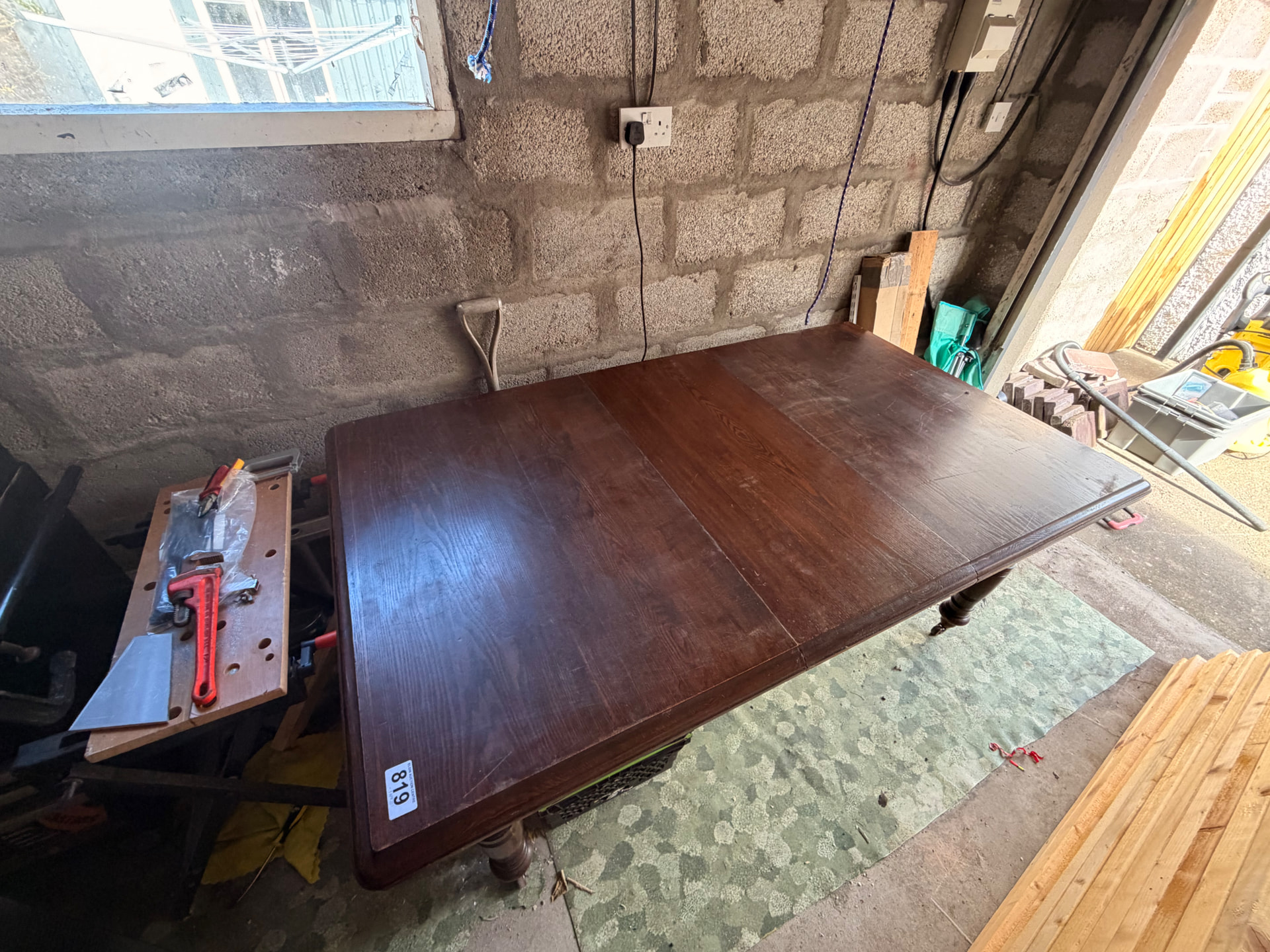

Well, picked up a sheet of 18mm MDF today ( price of woods insane! ) Meant to be £35 but the manager knows me so £20…. and he gave me 2 ratchet straps for the trailer to tie it down :slight_smile:
Currently the highest bidder on a makeshift table ( ex dining room one ) at £2 local, so hopefully things can progress soon….
Currently loosing the will to live feeding cables through that springy stuff that holds all together… fml….
Got my table tho! Pickup Friday, bit gutted as it cost £20 for final bid but I guess woods probably worth more.

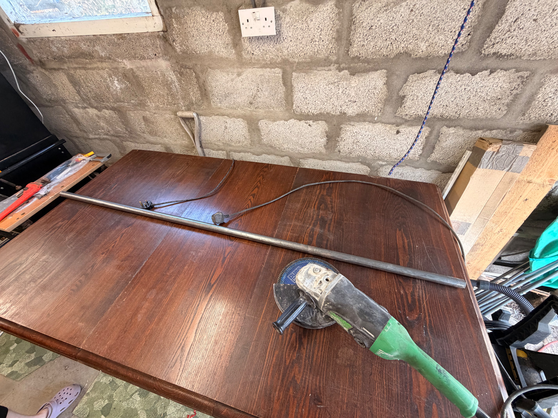

£20 table aquired and pipe cut today, still waiting on deliveries! Tables sturdy tbf but I’ll likely remove the castors. Bet it’s 100 years old.
1000x1775mm not taking into account the edging so I’ll need to cut the mdf slightly larger at 1125x1813 plus 50mm each for a comfortable 834x1500 cut area.
