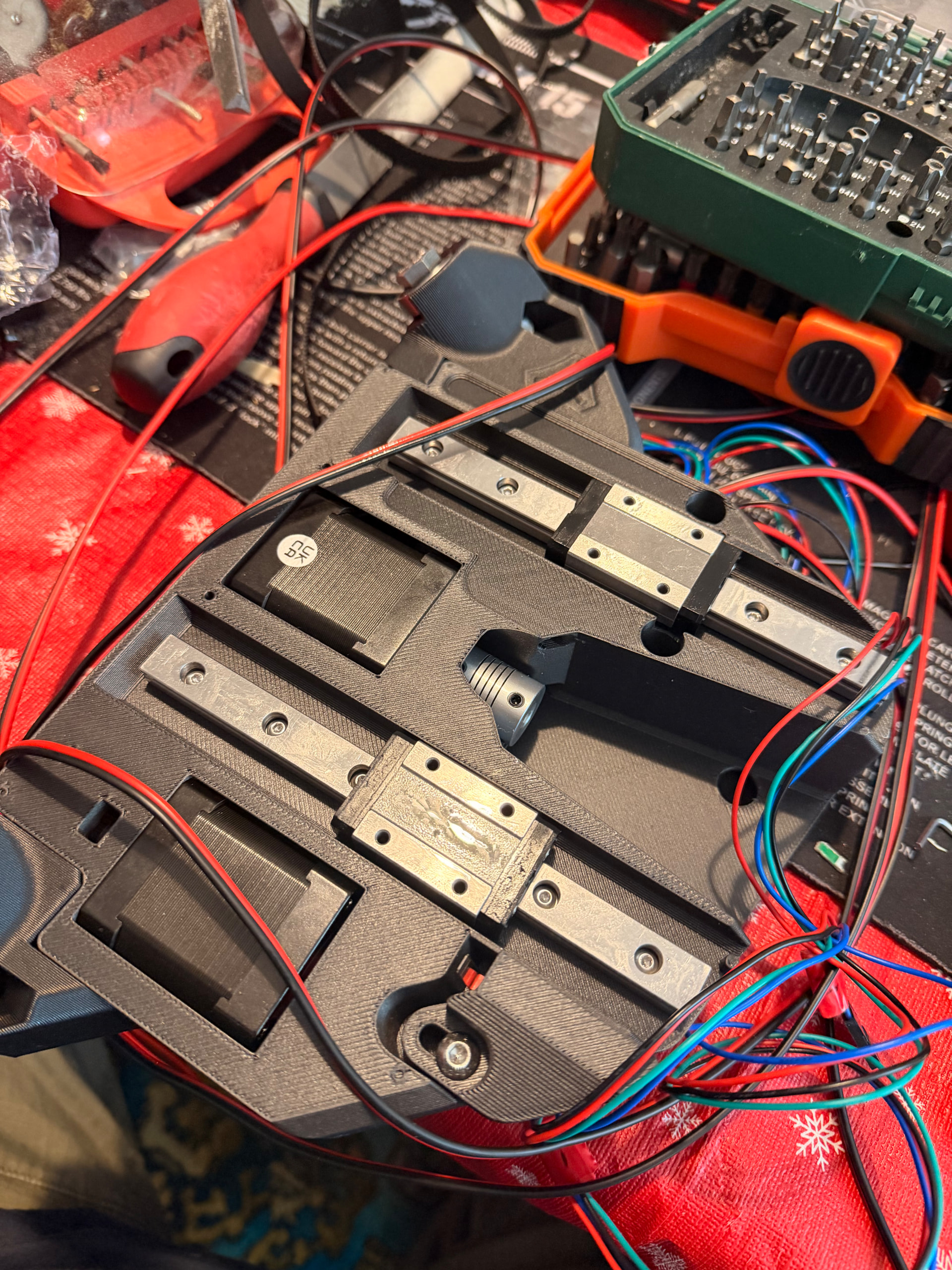

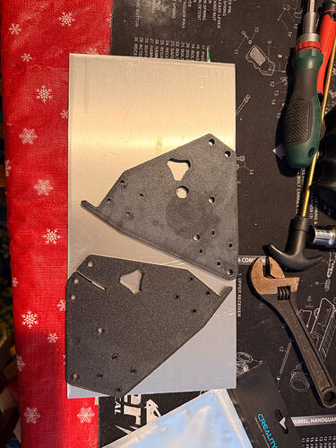

Well, got some done today, and realised I had ordered the wrong 16t pulleys ( or the wrong ones were sent, I have yet to check ) But so far so good. I did have an issue with 1 captive nut ( I hate captive nuts tbh ) but its on past the nylok and is just an axle anyhow so it should be fine. Fun and games :smiley:

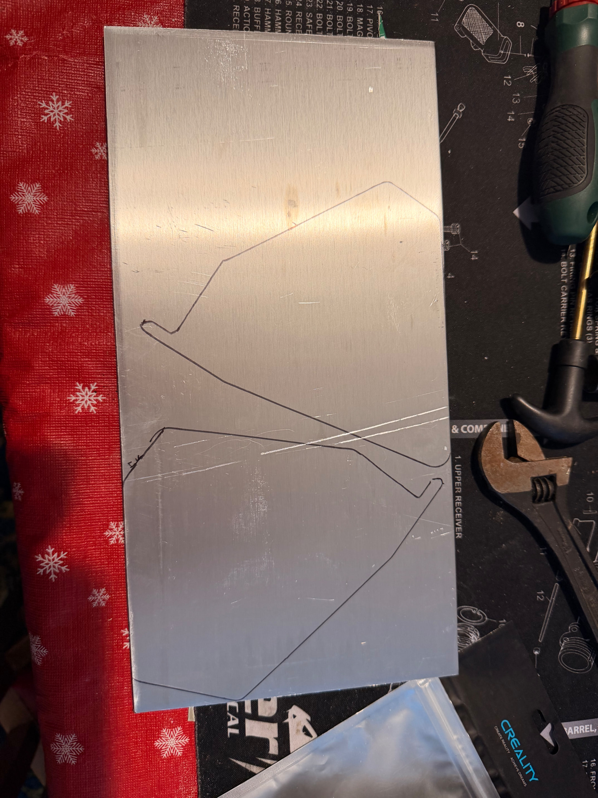

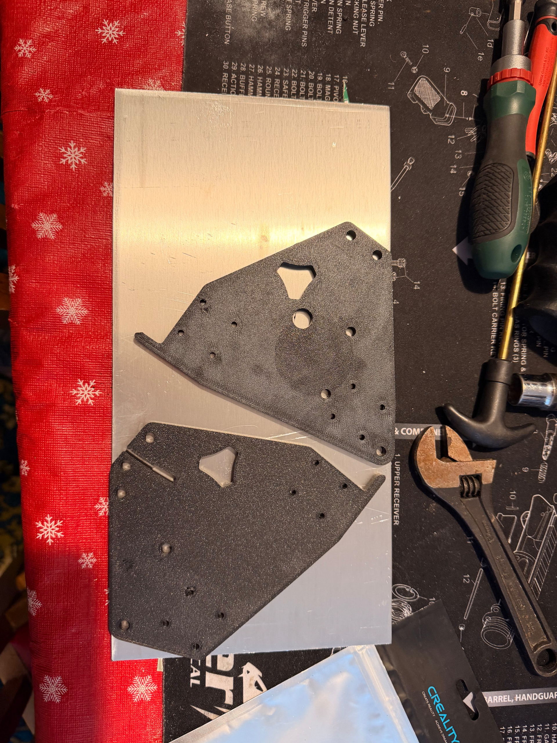

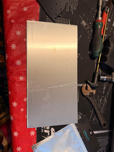

My aluminium came today so I used the printed ones as a template.

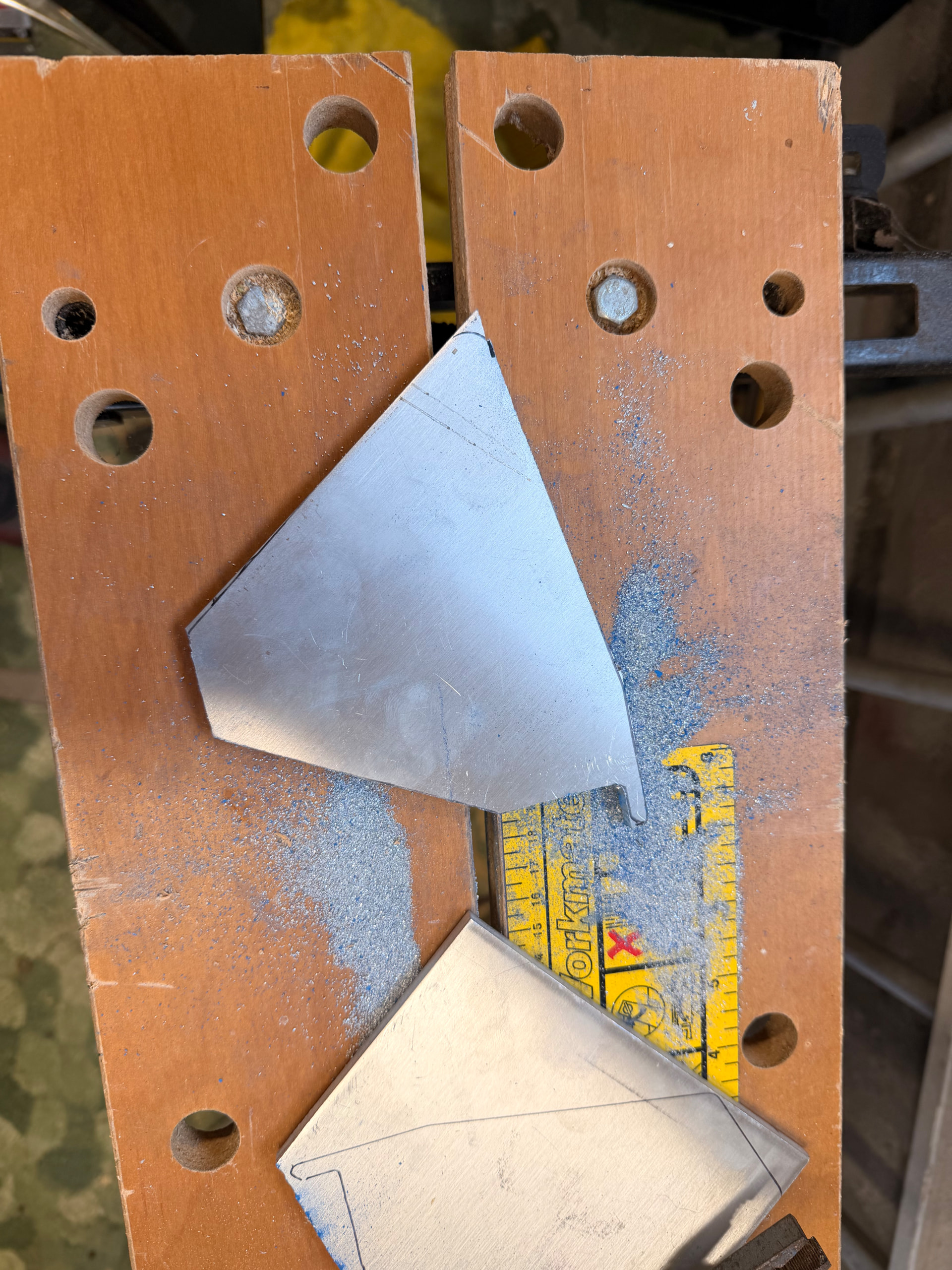

If you consider doing this, with a hacksaw, my advice is don’t! Arms killing me and I’ve only rough cut 1 so far.

It never entered my mind… 1000 times whilst dulling 4 hacksaw blades… honest! :rofl:
I’ll get there eventually :slight_smile: I’m going to clamp the printed parts to the metal ones and use a drill press to align the holes.
I take it the logo cutouts serve no real purpose other than look cool?

Correct. :slightly_smiling_face:

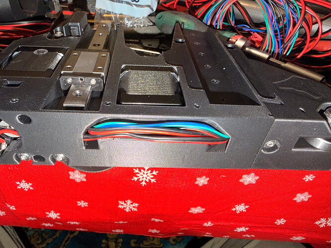

Isn’t at least one of them a convenient access hole for assembly/maintenance?
I’ve never used it for anything. :slightly_smiling_face:
The large round hole on the X Max side is for inserting the M5 nut into the brace if you forget it. As long as you put it in before you’ll never need that hole.
I was going to drill that but may not bother if I know. I just meant the logo shaped holes :slight_smile:
Right arms like a teenage boys today, absolutely killing me! Got 1.5 rough cut tho :slight_smile:
Yeah logos are just to look good. Not at all needed. And as long as you remember the M5 nut you are good. And even if you forget, you just have to take it back off of the brace, 3 screws and you can insert the nut.

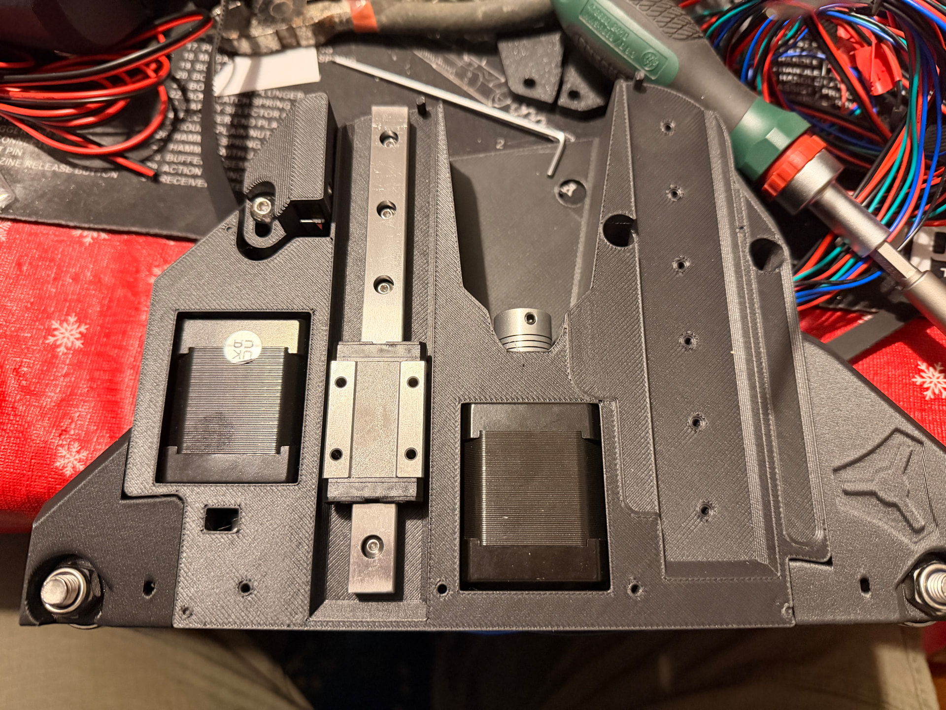

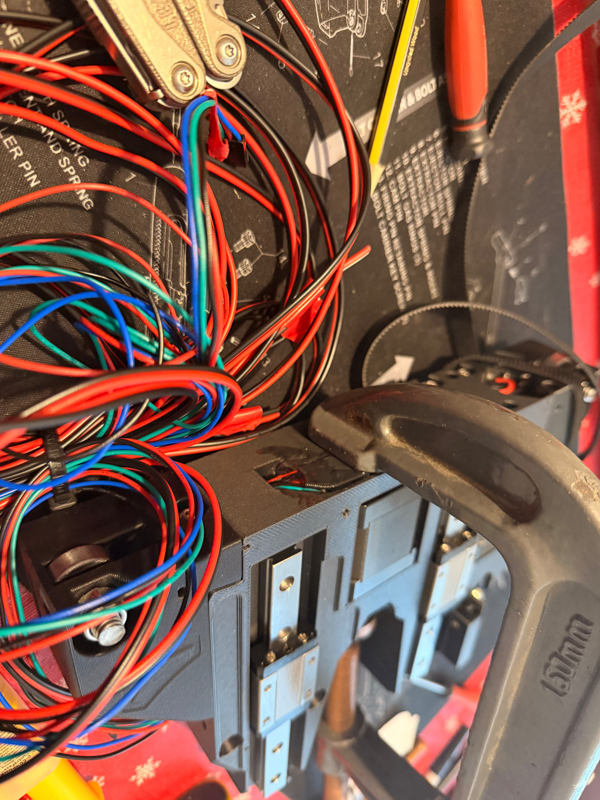

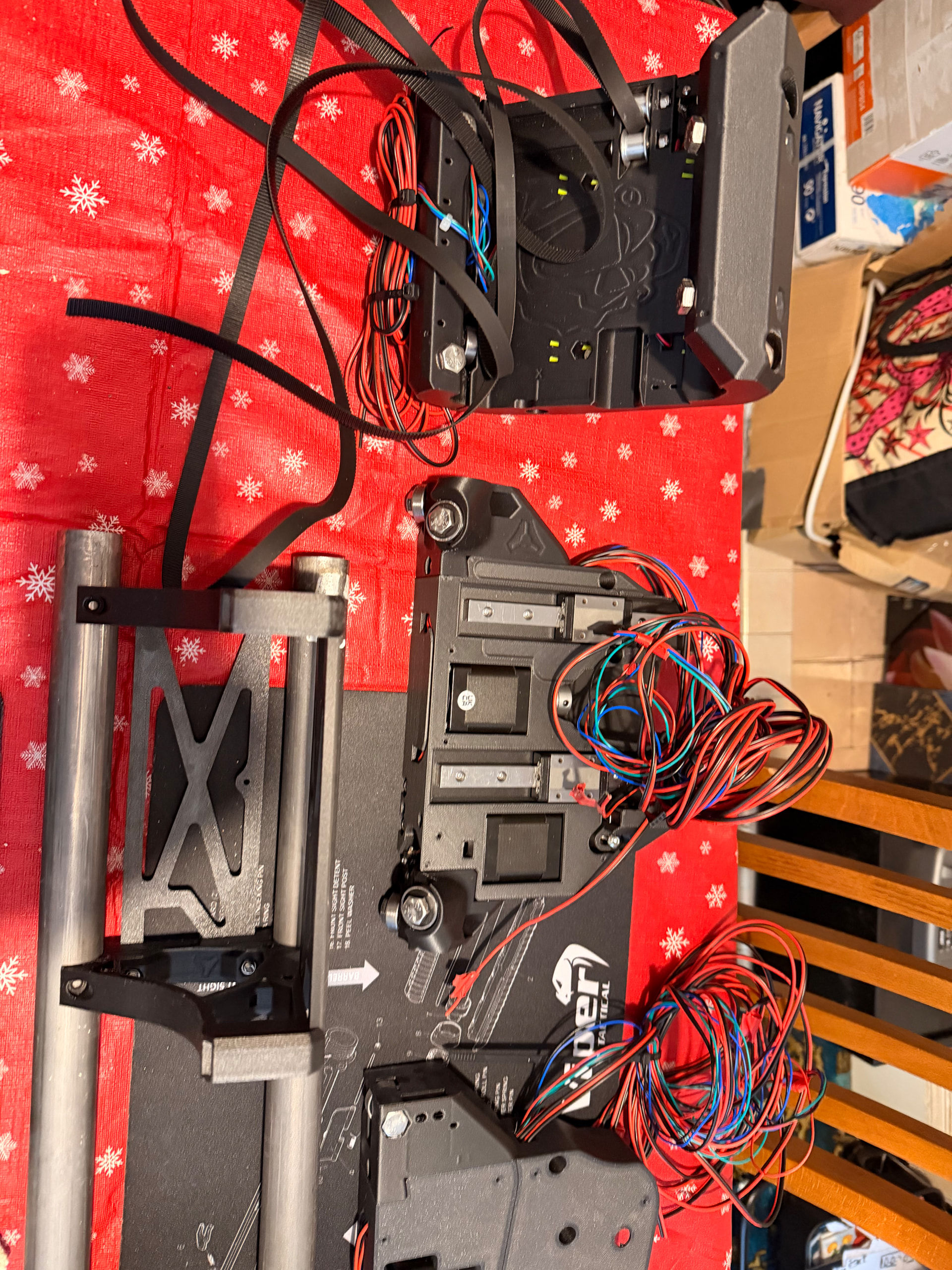

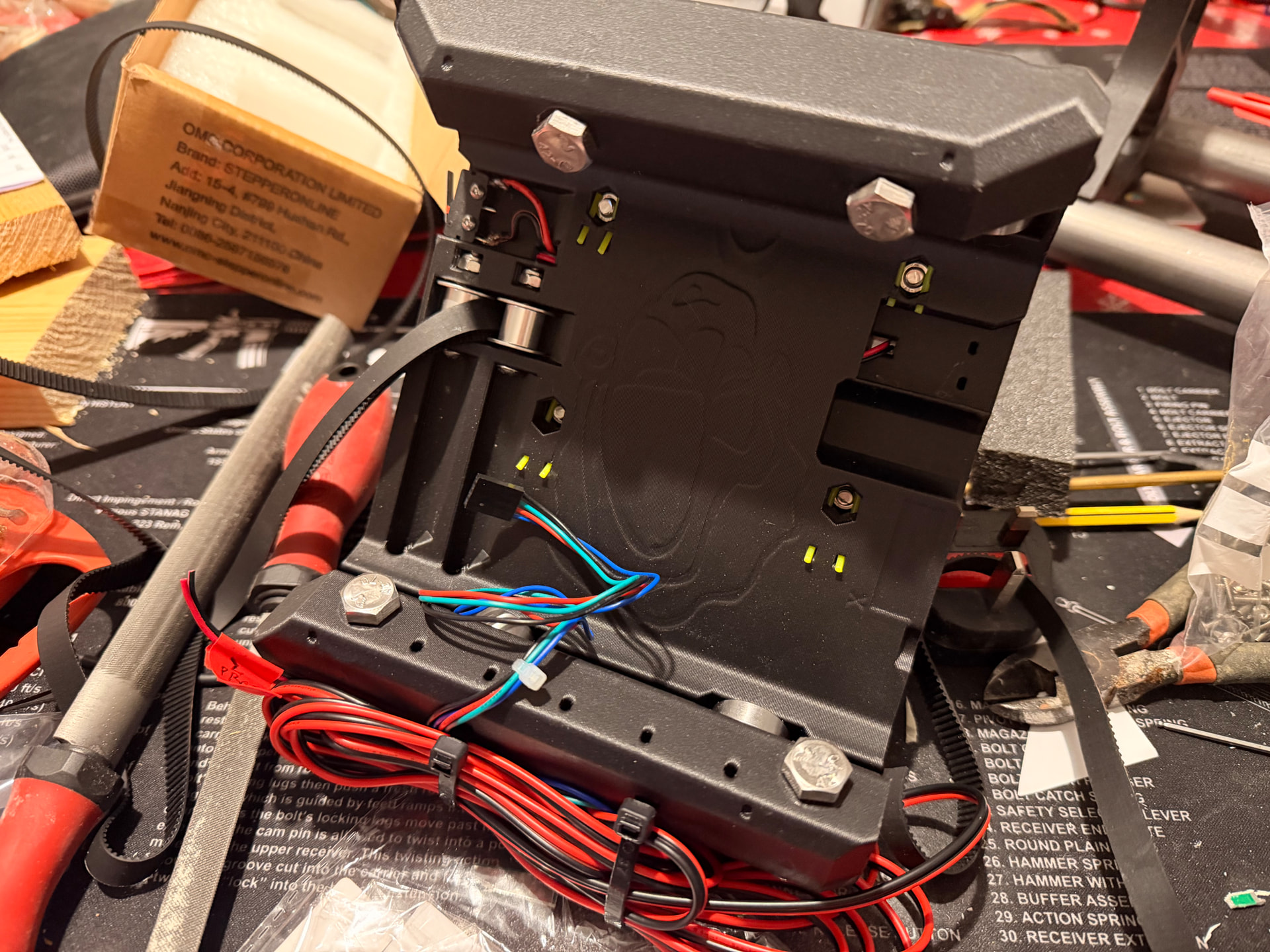

Fun and games today, finished my head unit ( or core as you call it )
Broke one of my side parts for the wires tho …. Grrrrr…. I’ll likely epoxy them in.
Also realised I underestimated the amount of drive belt needed, as I upped size :see_no_evil_monkey::man_shrugging::rofl:

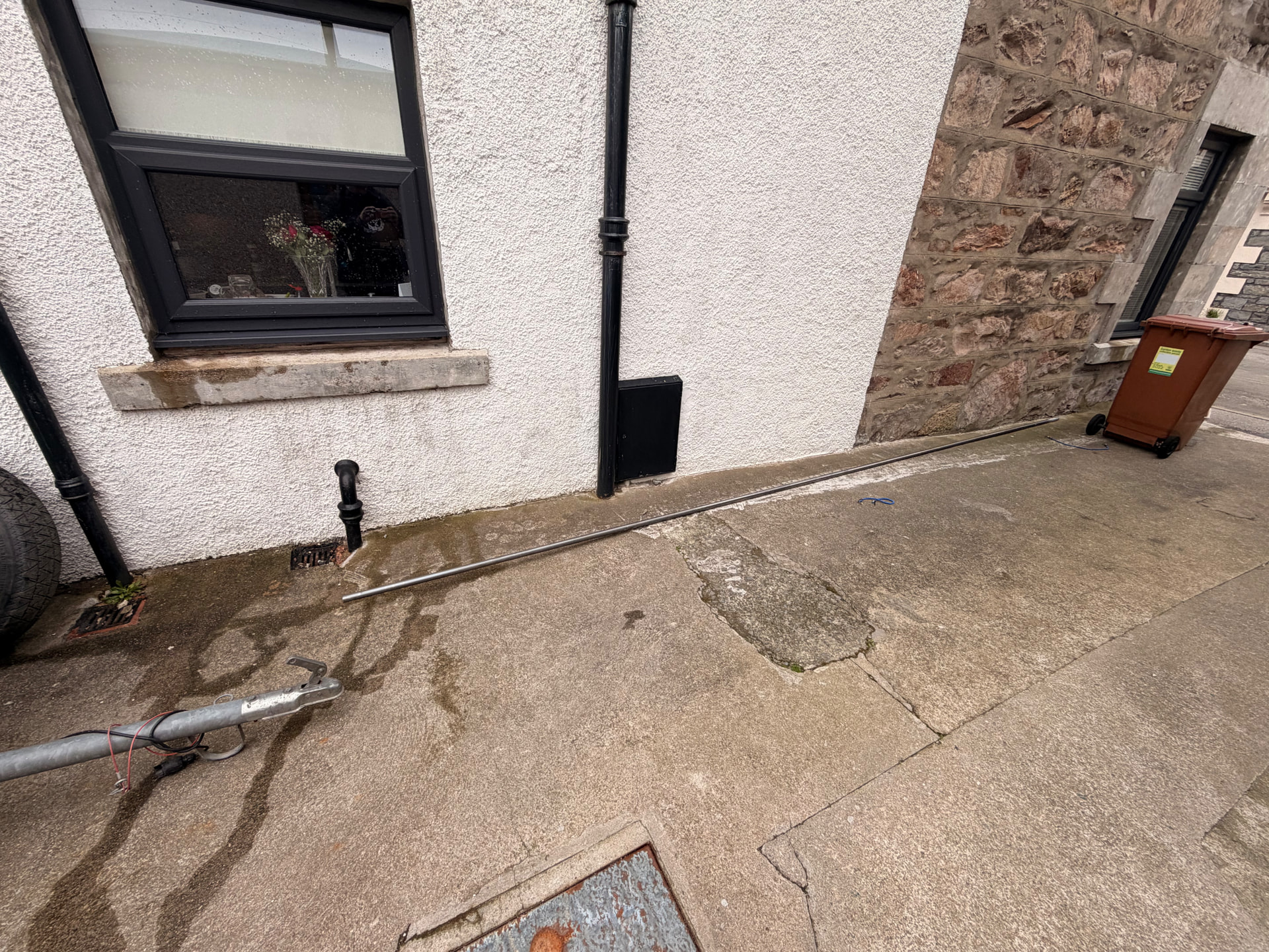

Pipe also arrived, should have enough for a long bed now!

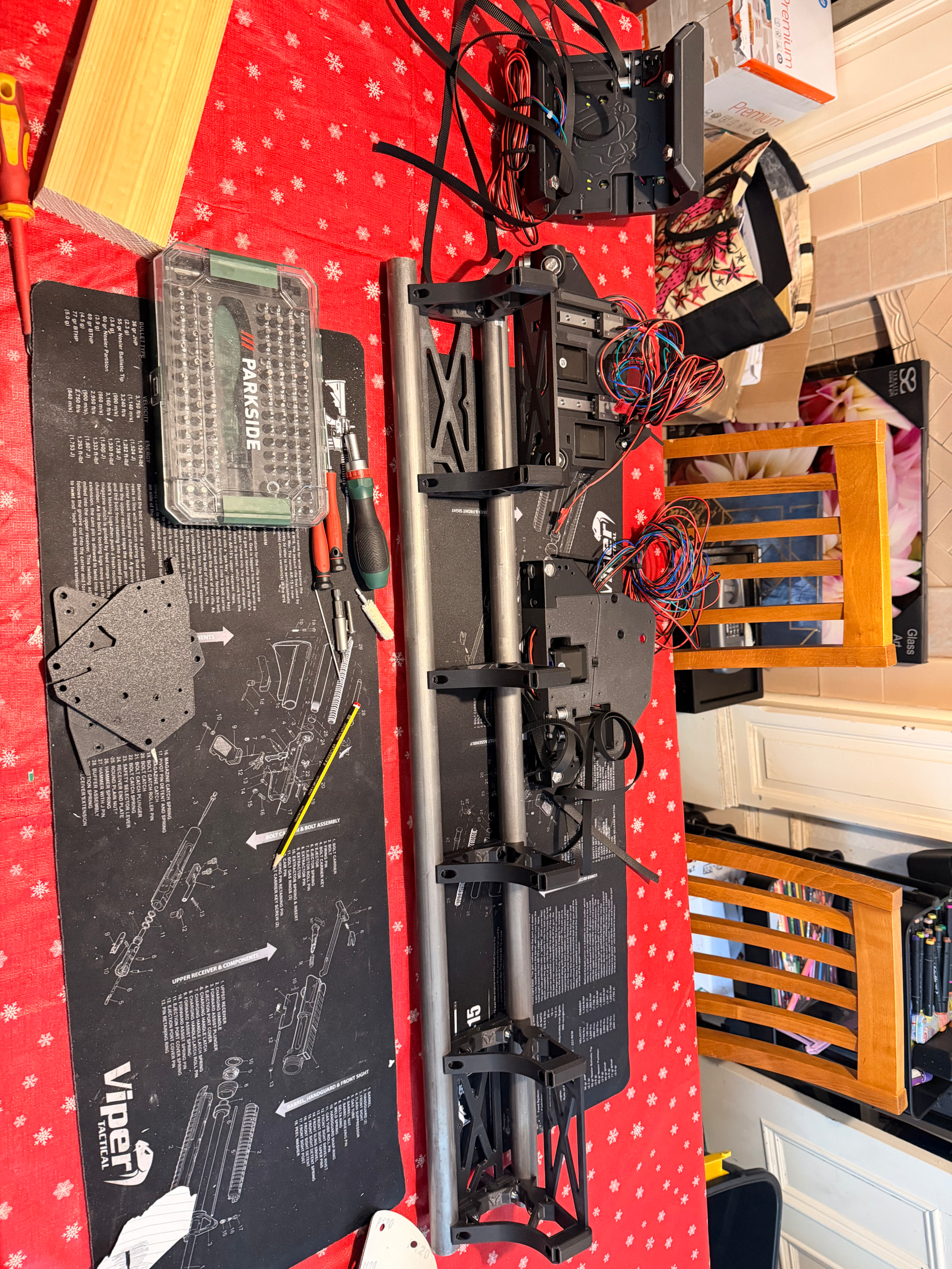

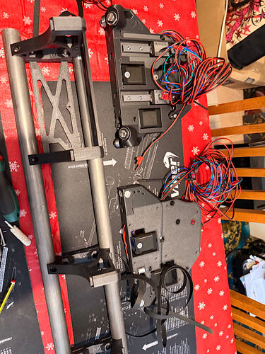

Bit more progress….
I’ve noticed the ends have space for extra limit switches. I didn’t see anything in the documentation ( but I am half blind in fairness ) - are these a non-required extra? New belt also ordered.
That’s not for extra switches, that’s alternative mounting points.
In some uses cases it can be preferable to have the lowrider home to other corners, for example if you want y to be the short axis in CAM or if the machine is in an awkard corner.
