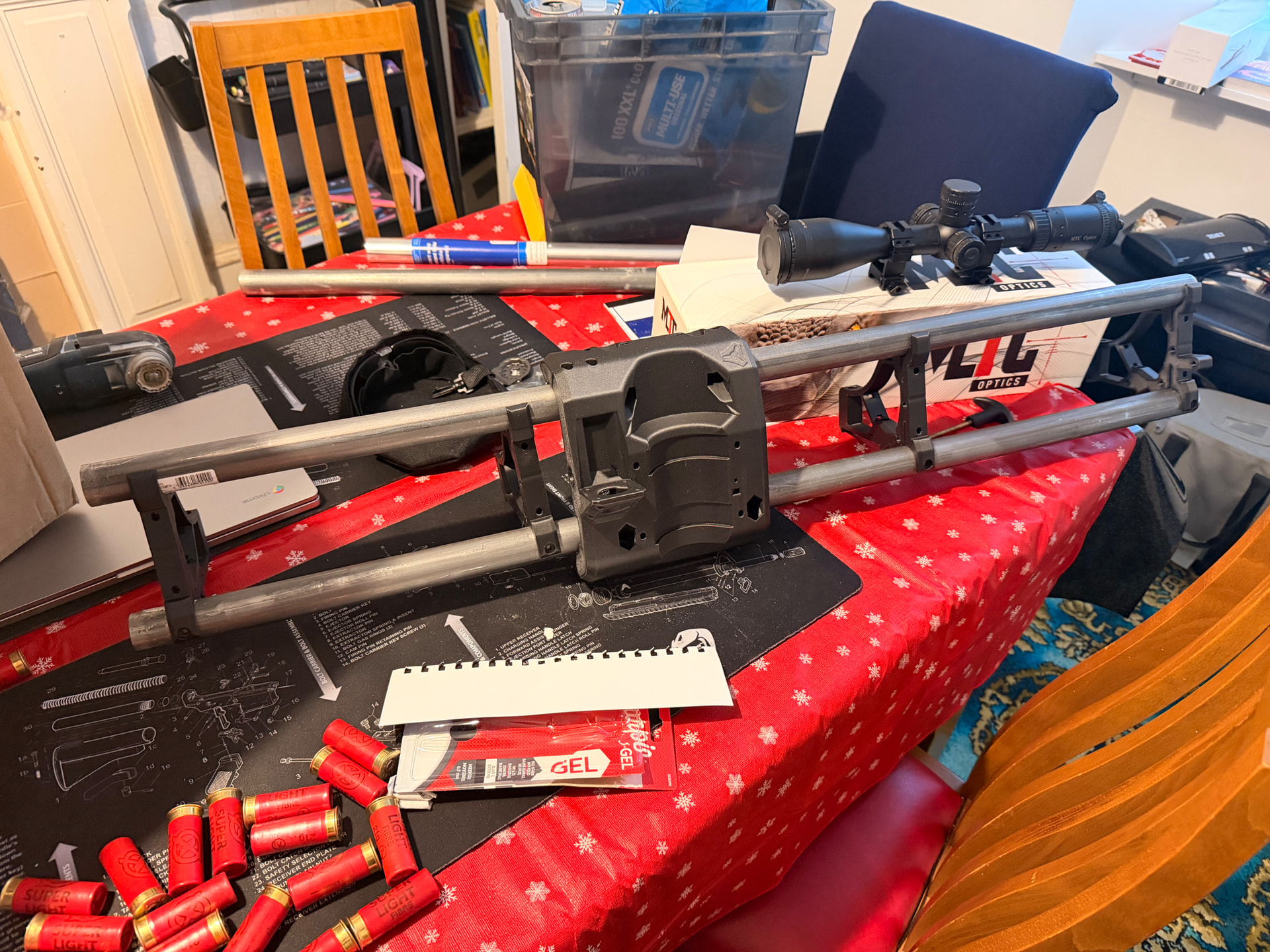

Hi all, I bought a used 3018 after Xmas and fast discovered it was pants. A local lad I know had an older version lowrider I’d seen, and he persuaded me to build my own.

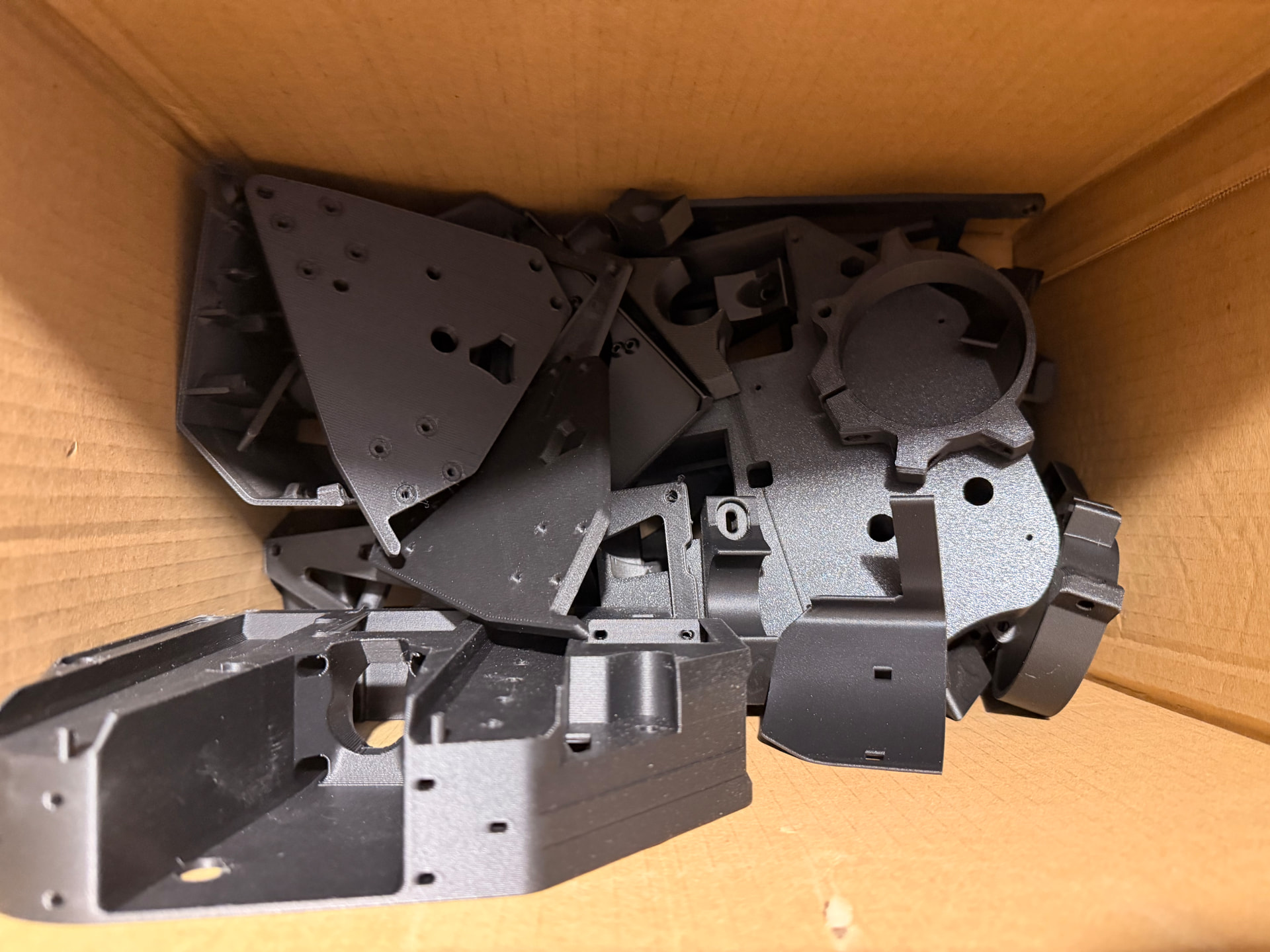

So far I have 3d printed everything, sourced 3x 1m lengths of 30mm tubing, ordered everything bar the cnc controller individually from various places since tax to Scotland from Germany or USA is ridiculous these days ( as is post, I was £9.75 to send a letter last week! )

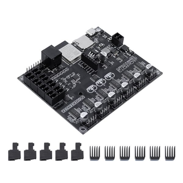

Regarding the jackpot controller, I see a few options but I was also pointed in the direction of one called tinybee. I would prefer to use jackpot if there’s a uk or even china source as for some reason China seems to get through customs everytime…
Ohh, and I 3d printed the meant to be aluminium plates for the same reason, but will likely either make some with mdf, or metal when I get it up and running.

You can get the Jackpot 3 from Elecrow (China):
I’m uncertain how well printed plates will work, certainly not as well as aluminum. I seem to recall someone trying it during the Lowrider 4 beta.
Yeah they won’t hold long but hopefully long enough to make proper ones - or perhaps even mdf ones :slight_smile:

I am making it 1m tube size which iirc was 834x745mm usable area, just as I see not point cutting the metal bar - which is also a bit of a nuisance to get in the uk. If I get to grips with it, I aim to expand it but it should be ample to learn on.

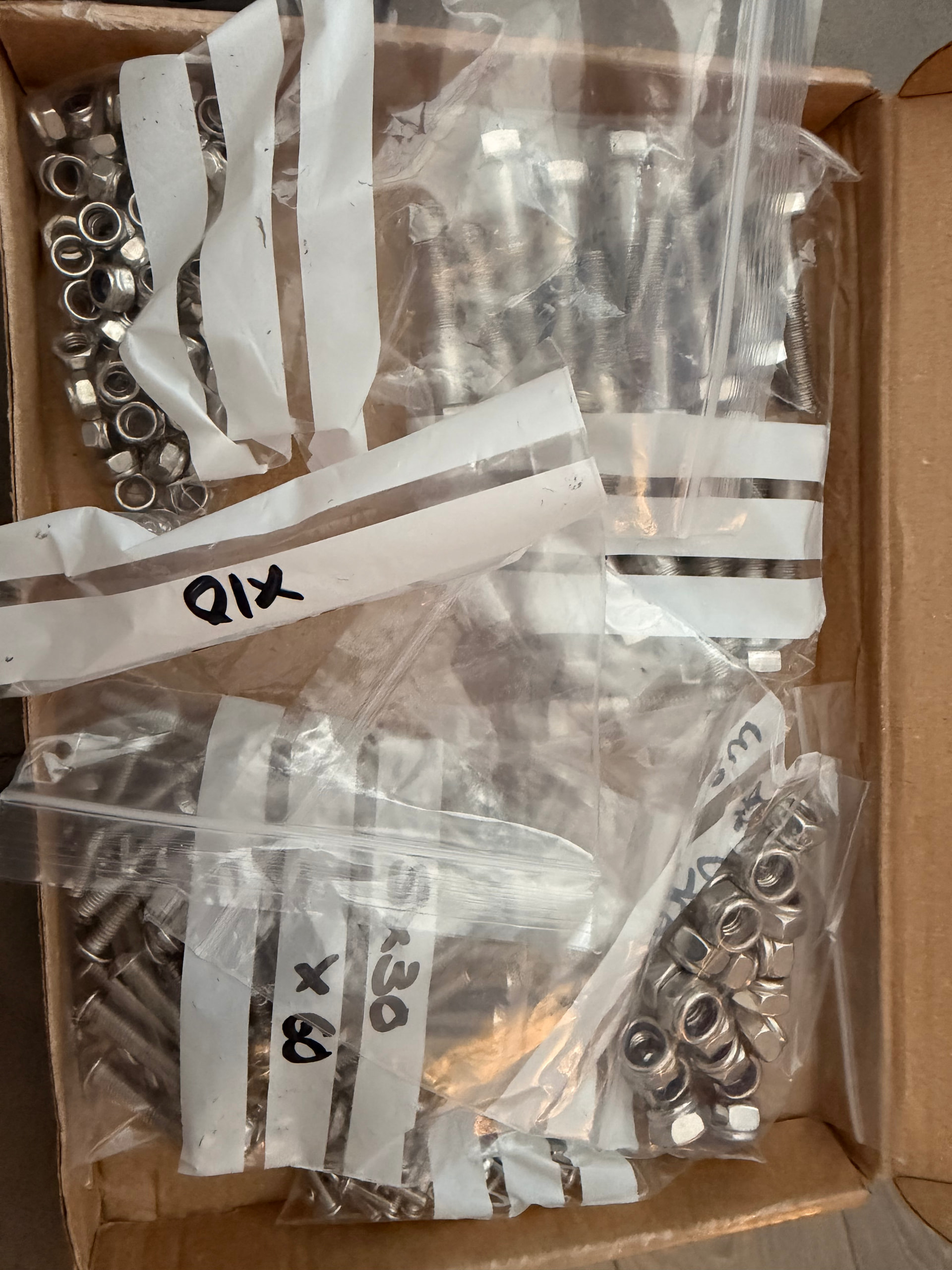

Nut and bolt kit arrived today :slight_smile:
I’ll list prices I think for others. This was £52 from kayfast.co.uk - I got off their eBay tho.
