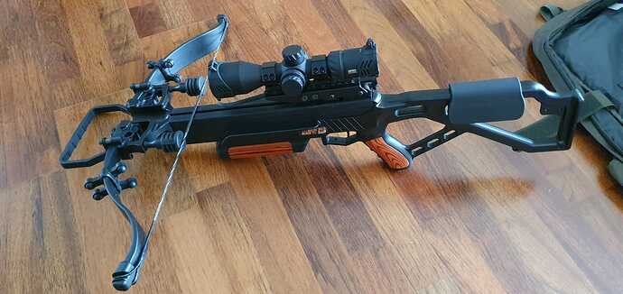

My current project is an “Excalibur Crossbow Stock”.
Excalibur is a canadian crossbow manufacturer who is constructing really fantastic crossbows.
My crossbow is a “Excalibur 365 Micro black limited edition” (for the specialists: with ArcheropterX Hunter 9 Scope, R.E.D.S suppressors and a couple of other accessories)

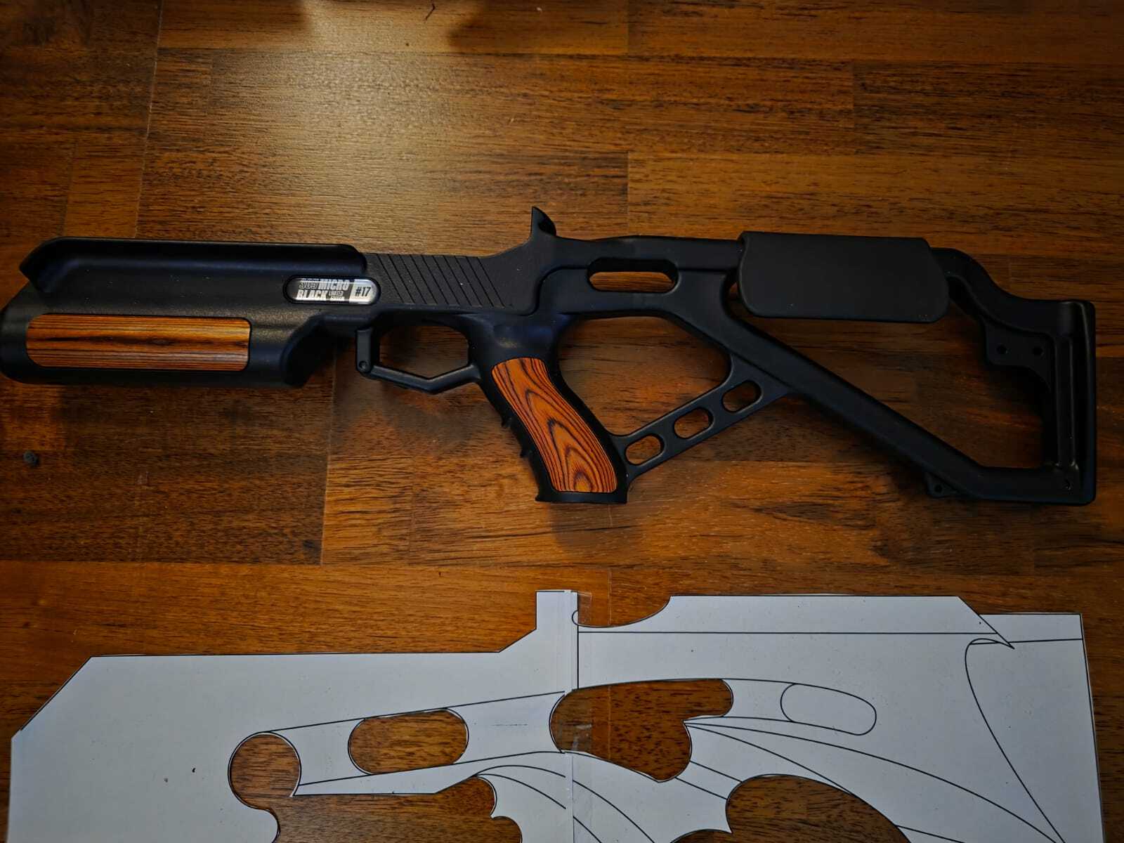

So here is the original:

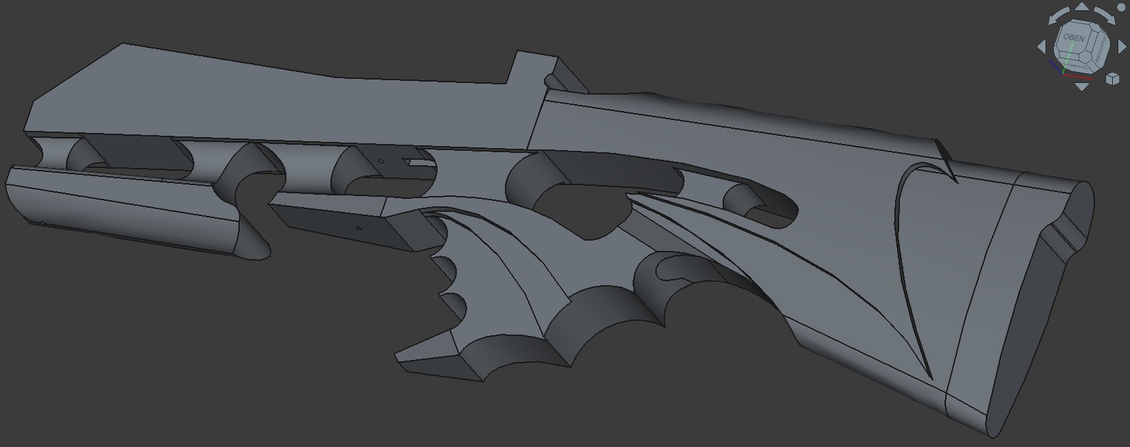

Although I like the “clean” and black stock, I would like to change a litte bit the design of the crossbow.

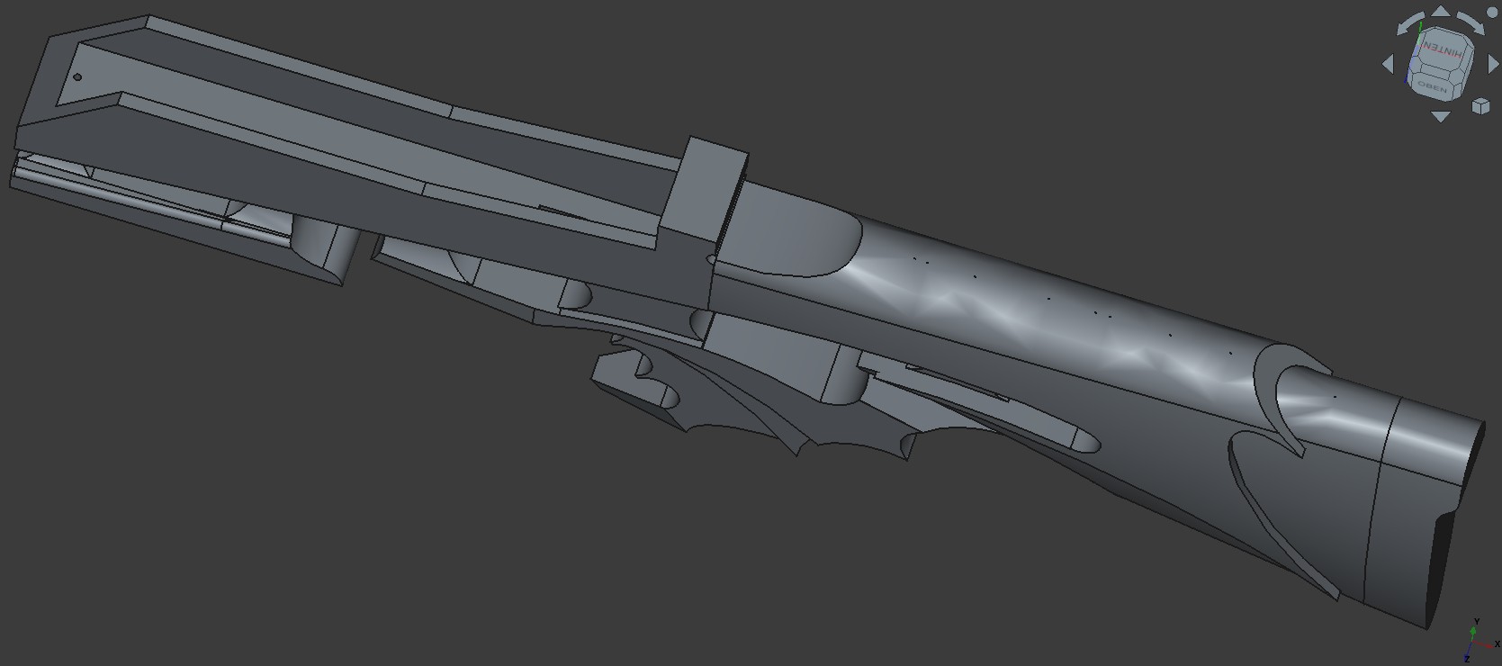

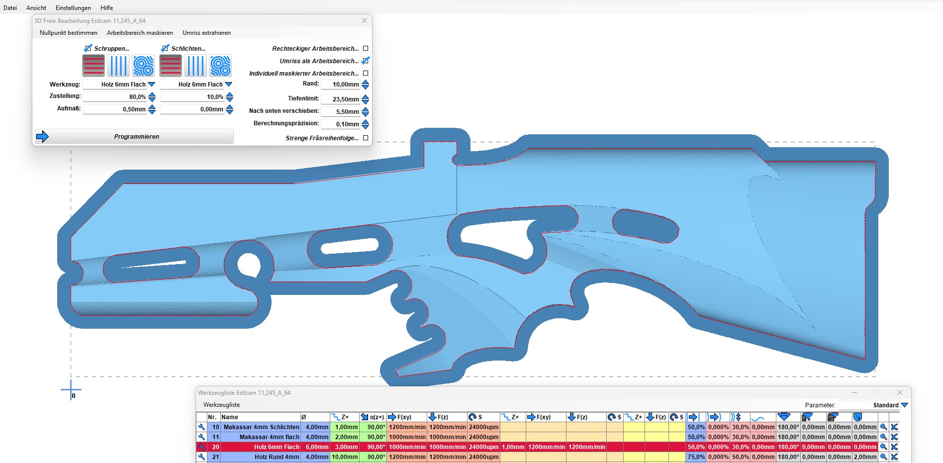

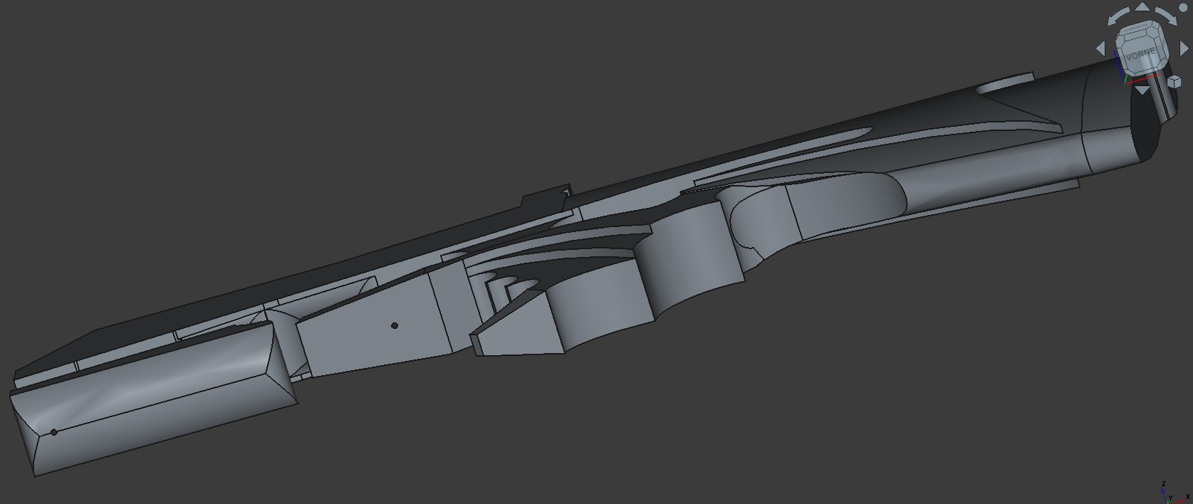

So I have started to “draw” and experimenting a little bit in FreeCAD.
This was the result.To be honest it was quite a hard challenge to “draw” it in FreeCAD, but the result is …. let’s say …. presentable :joy: :joy: :joy: :joy:

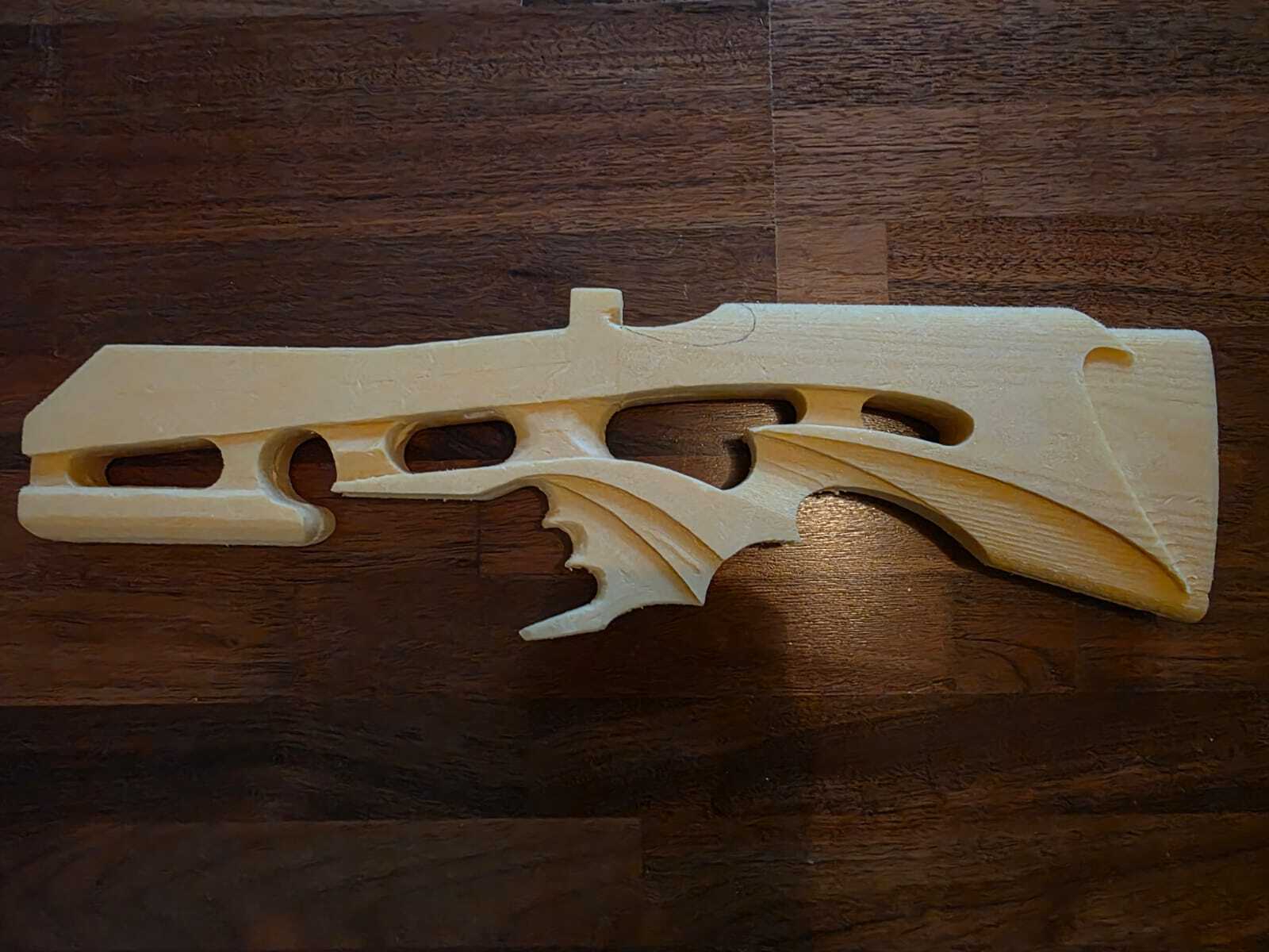

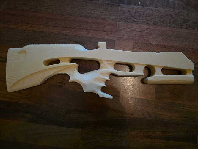

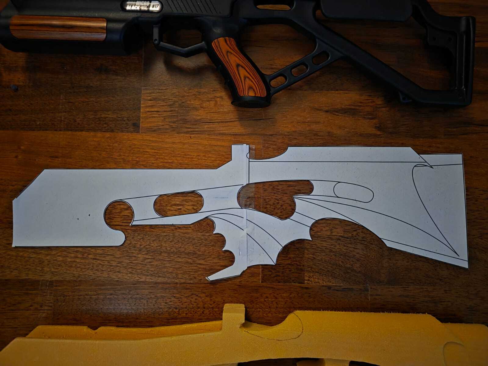

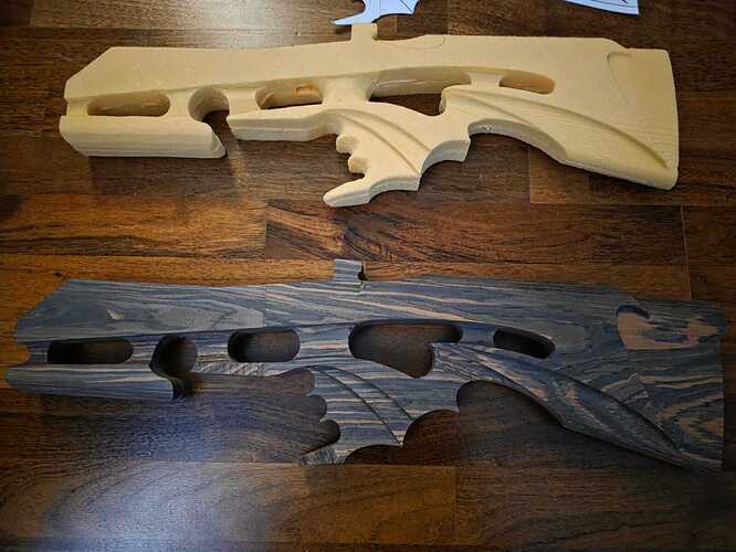

To not waste the “expensive” wood, I created 3 or 4 prototype out of polystyrene, to get exactly the right dimensions and that the body of the crossbow will fit correctly in the stock!
I have modified the back (at the shoulder) so that this stock became 2.5 cm (1 inch) longer.
This was the last “prototype” I have realized.
You can see that left and right sides are different from each other. The stock will be for right-hander use.

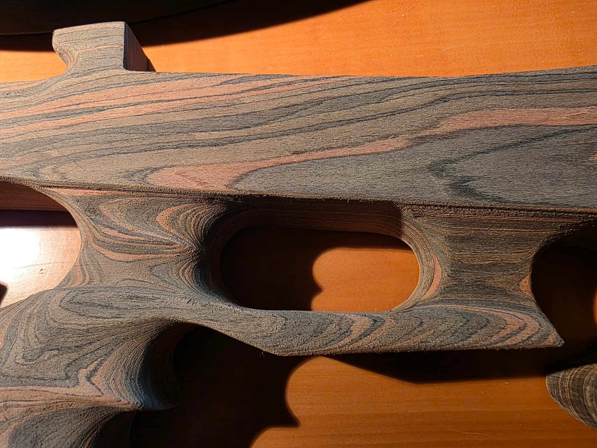

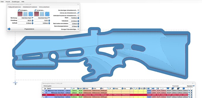

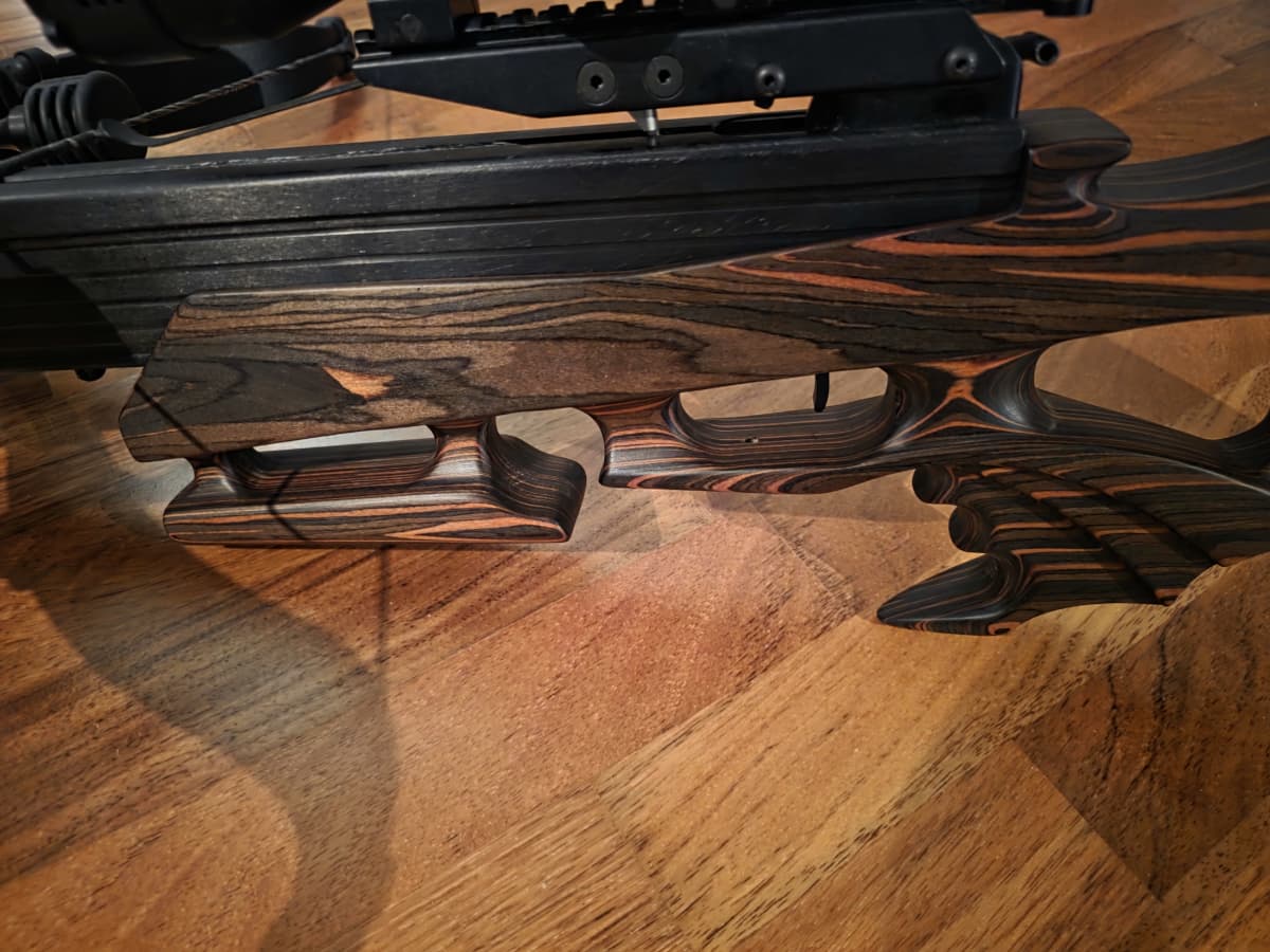

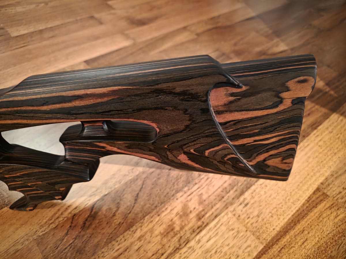

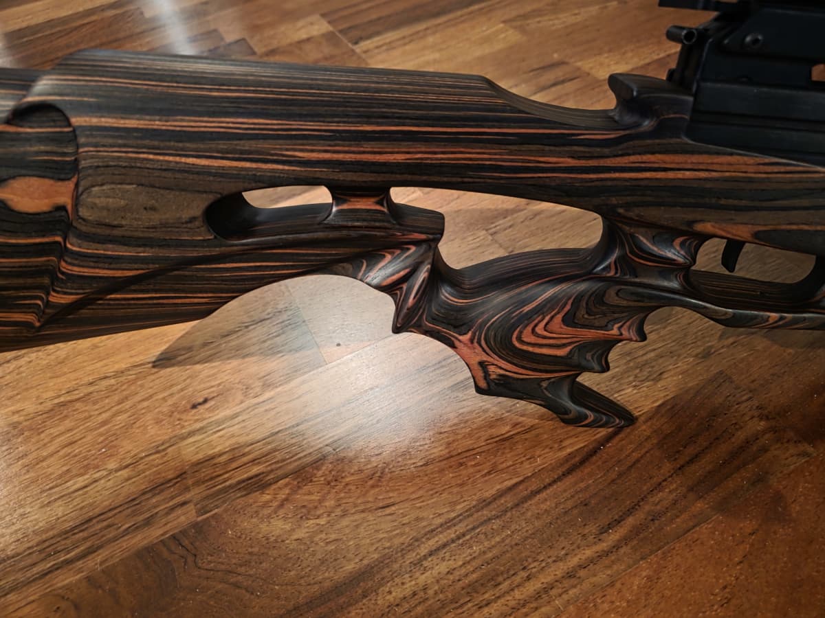

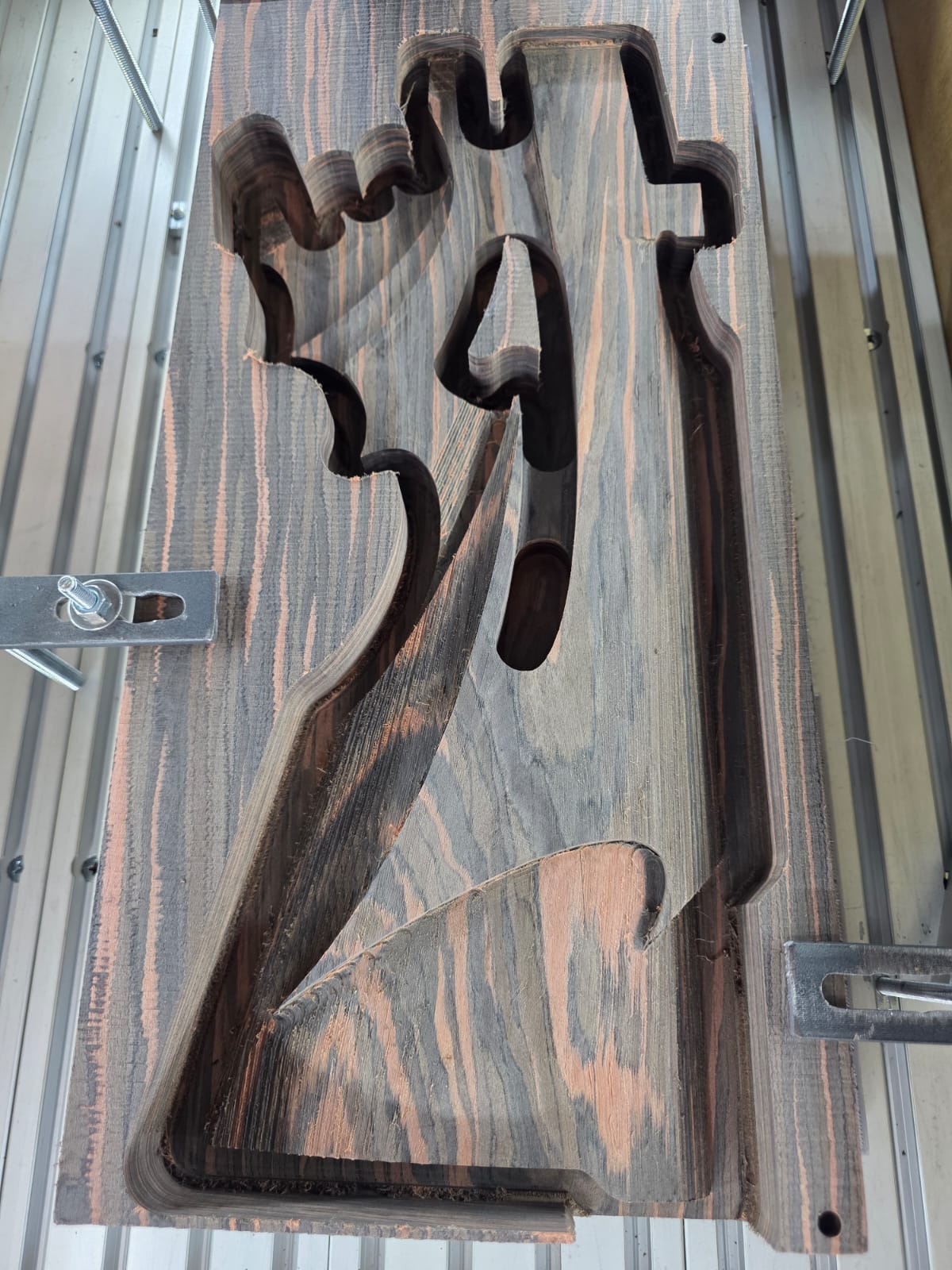

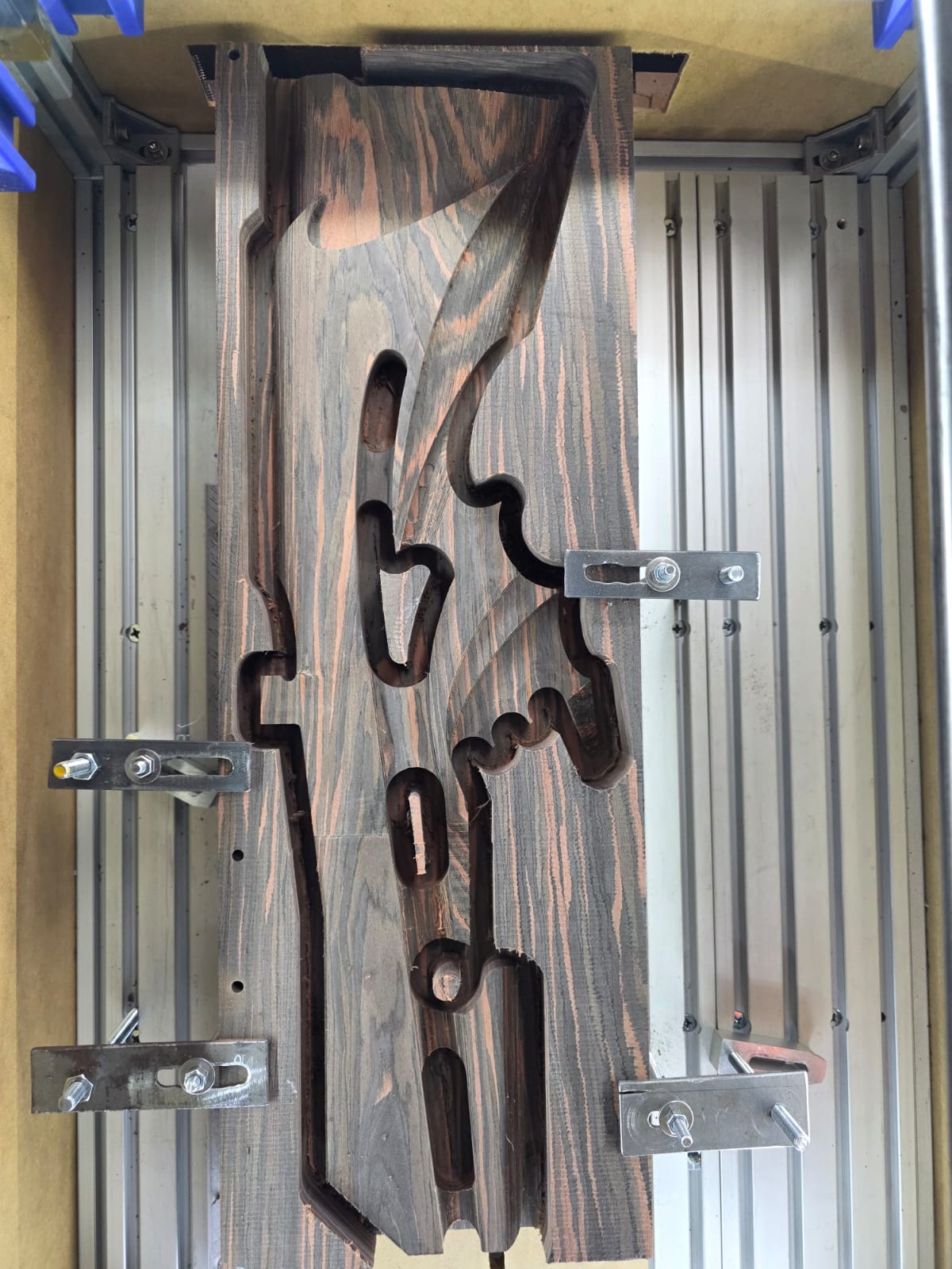

After the last prototype I started with the wood.
Material: Makassar Ebony
Dimensions: 620 x 220 x 60 mm
Drill: 6mm flat

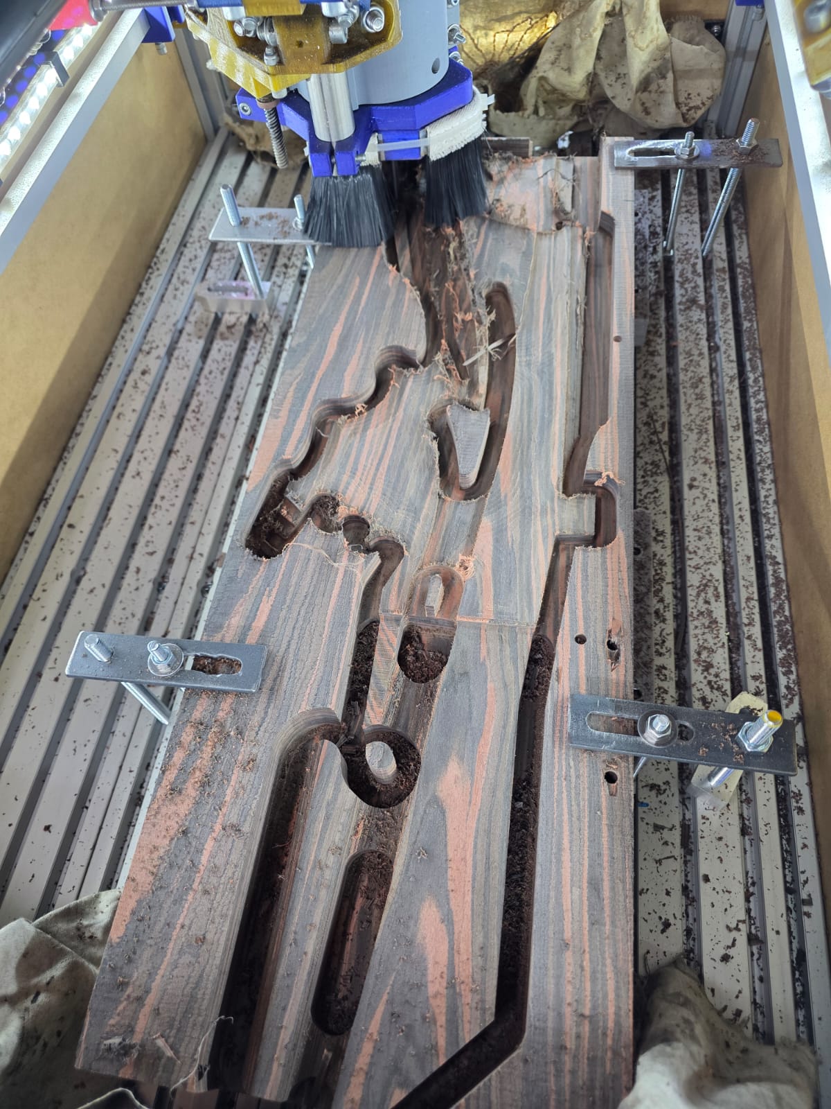

Milling duration: ca. 12 - 13 hours (even with a speed of 1.000 - 1200 mm/min) but I wanted to get sure, that the surface would be quite fine.
I had to run the milling in 4 steps, 2 for each side because the length of my milling bed is only usable for 50 cm.
So now I got:

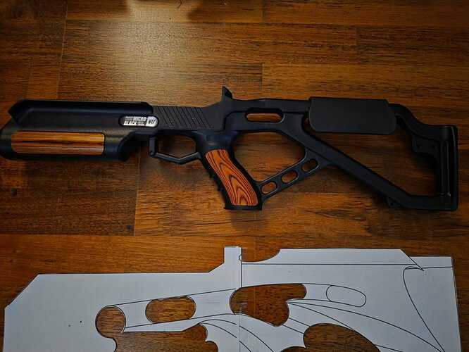

Original, first design on paper, last prototype and the 1st step of the wodden stock.
It is really COOL! :smiling_face_with_three_hearts: :heart_eyes: and I am existed, for the next steps:

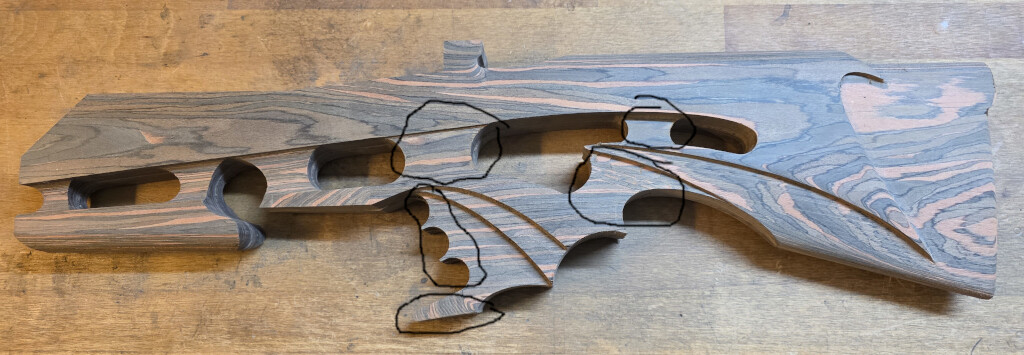

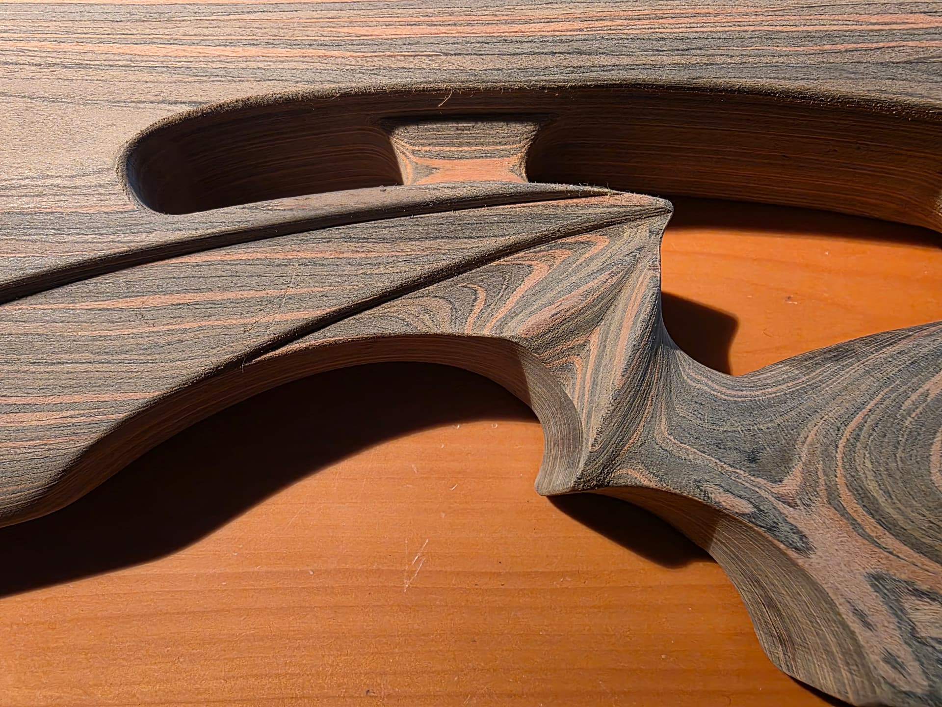

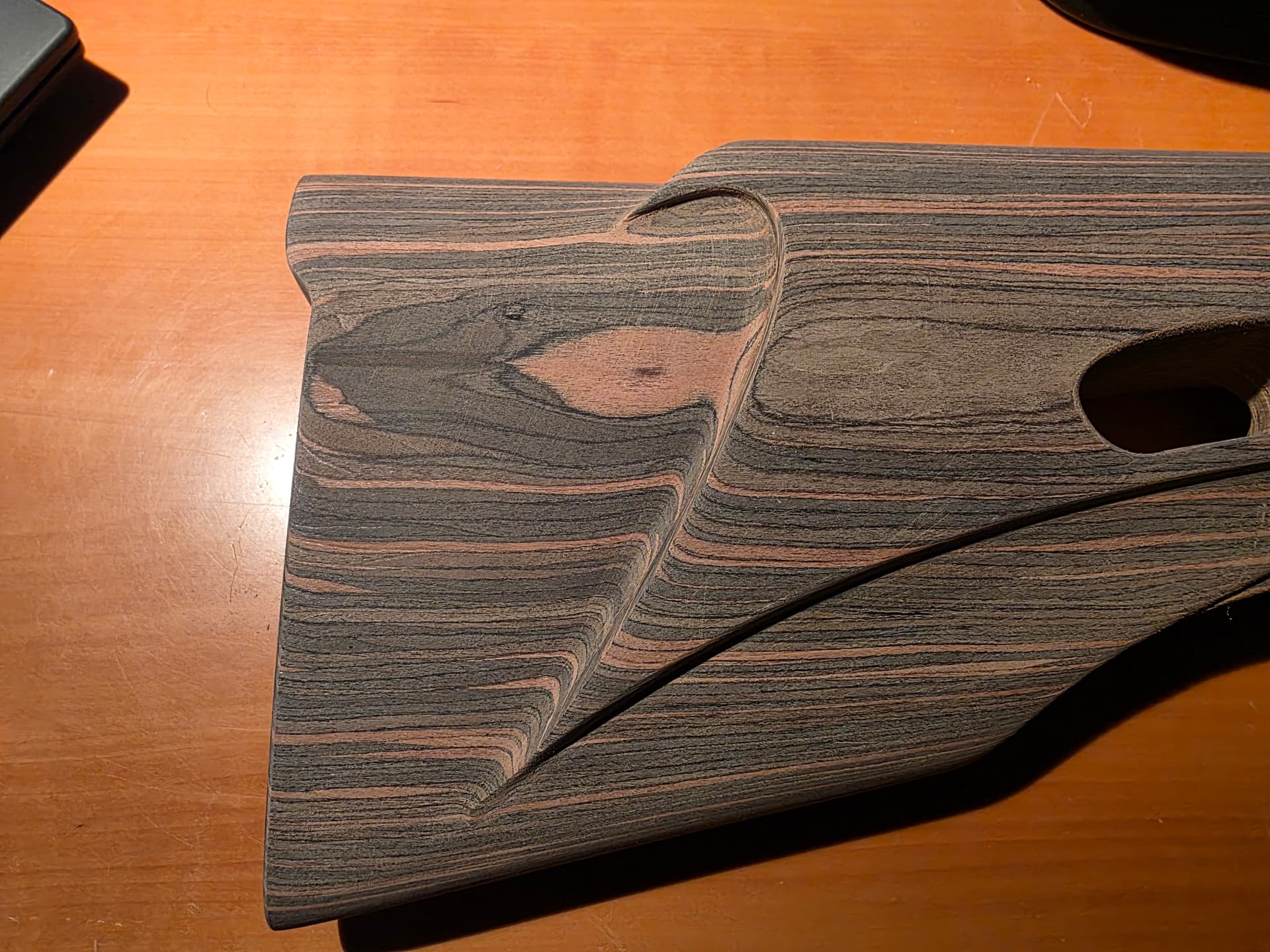

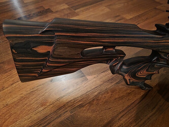

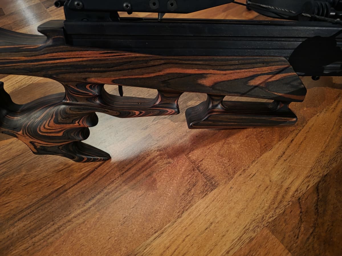

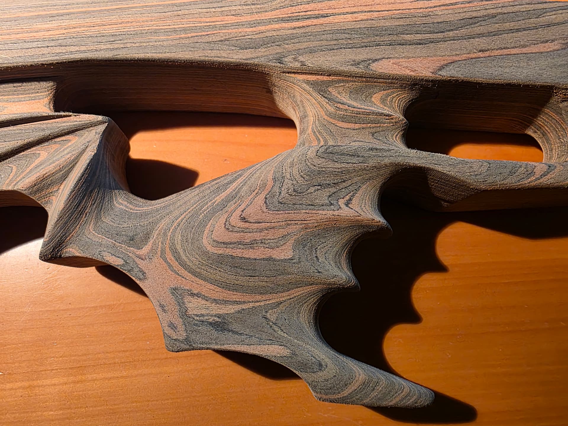

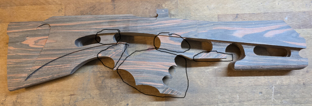

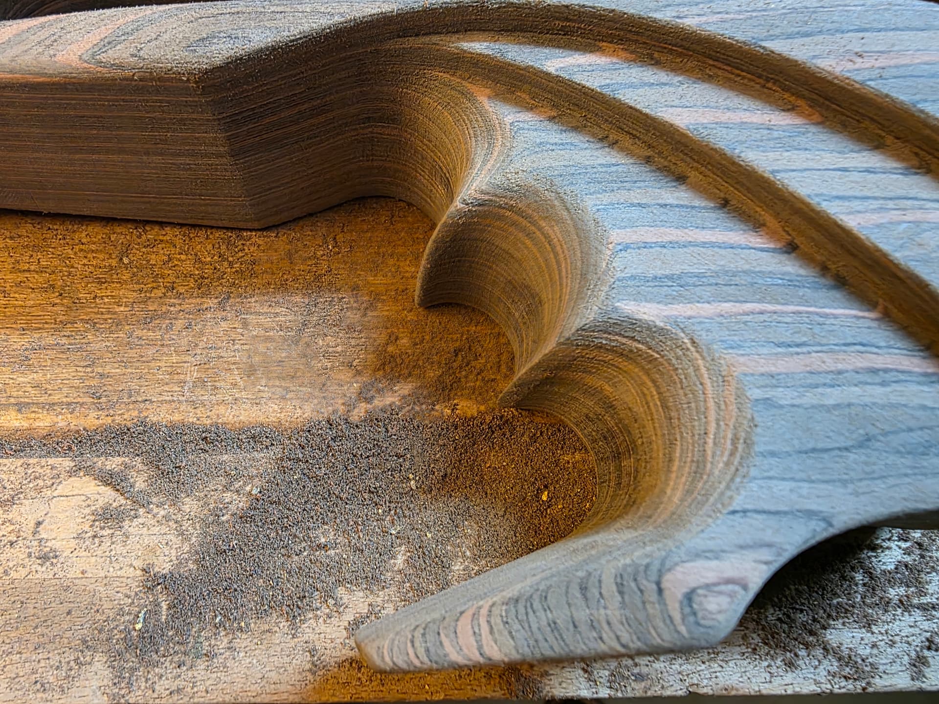

OK, so here are the next steps, but from now on, everything’s a “hand-job” :winking_face_with_tongue:.

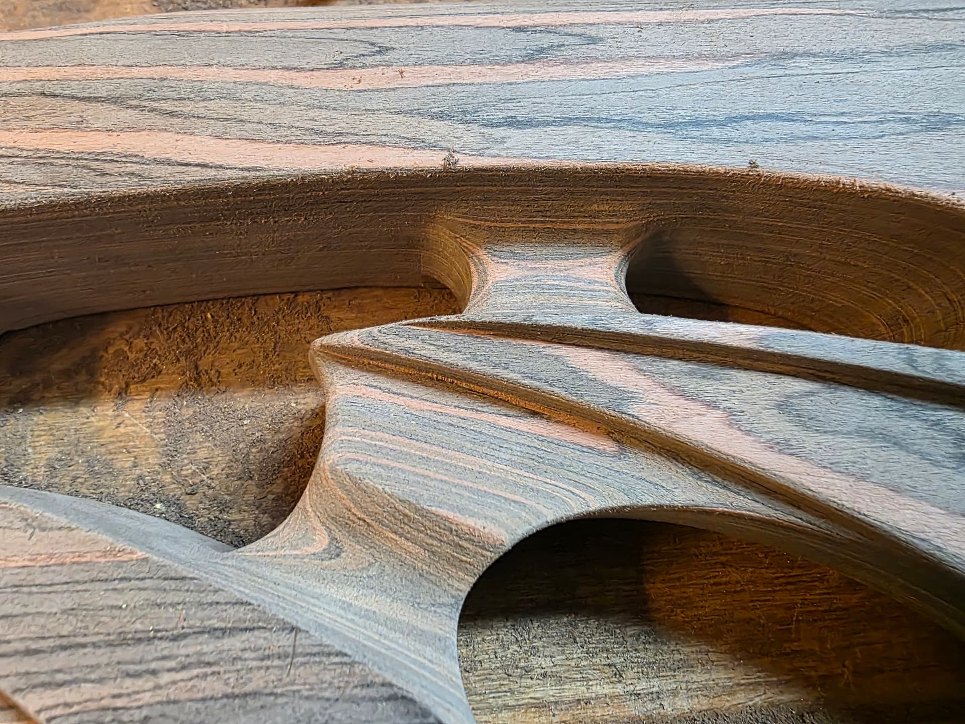

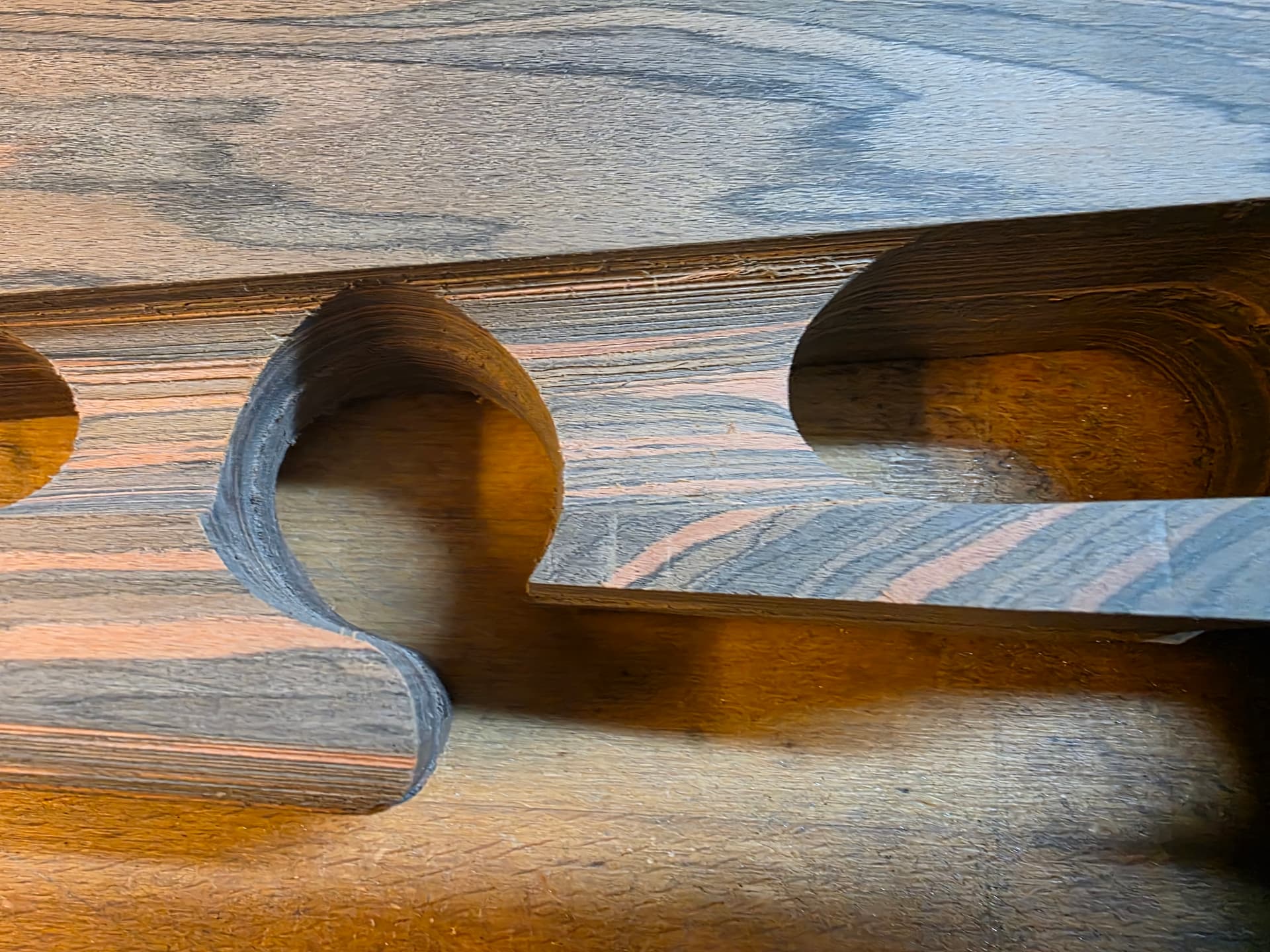

  1. all markers from milling need to be checked and “destroyed” using sandpaper 120
    => most important step to get all signs out of the wood, now!
And in parallel a couple of things need to be modified for the use and design.
On the left side the following areas need to be changed:
On the right side similar:
Left side modifications:
Right side modifications:

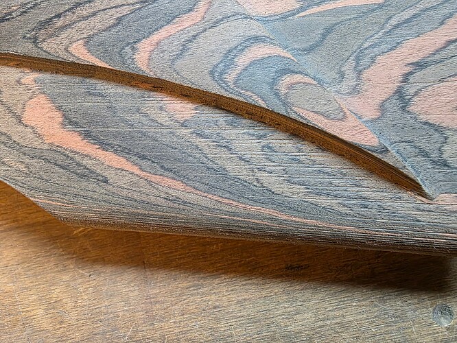

Of course it is only “pre-work” because of the sandpaper (120).
So now, all individual markers are coming out, very nice to see! :winking_face_with_tongue: :winking_face_with_tongue: :smiling_face_with_three_hearts:

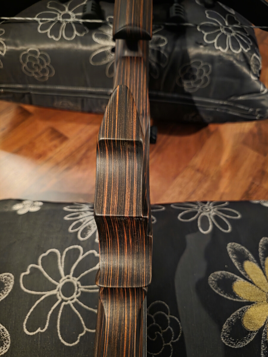

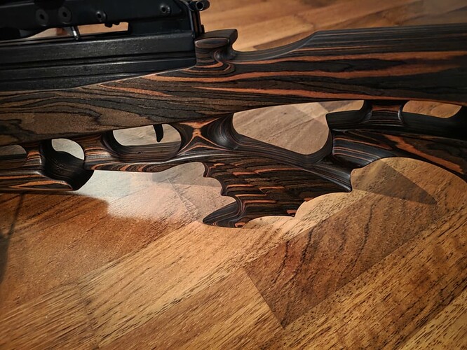

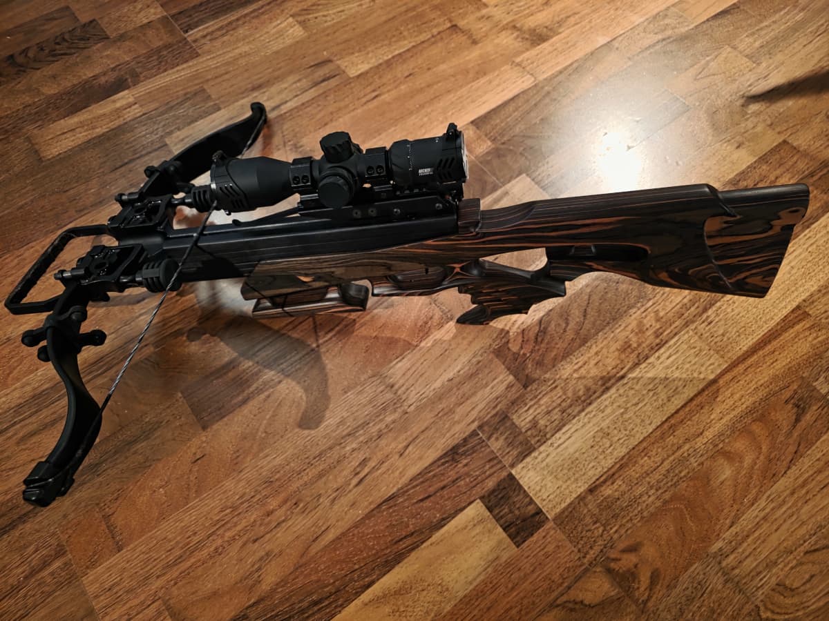

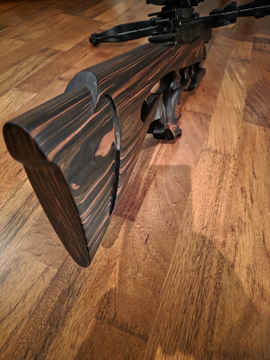

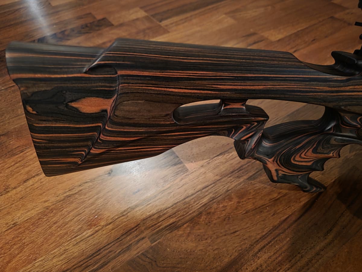

OK ho finito! :winking_face_with_tongue: :heart_eyes:
I love it! :winking_face_with_tongue: :smiling_face_with_three_hearts: :heart_eyes:
