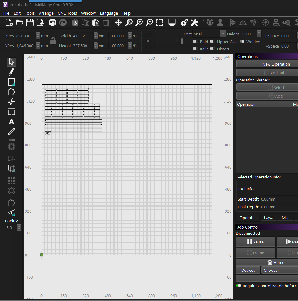

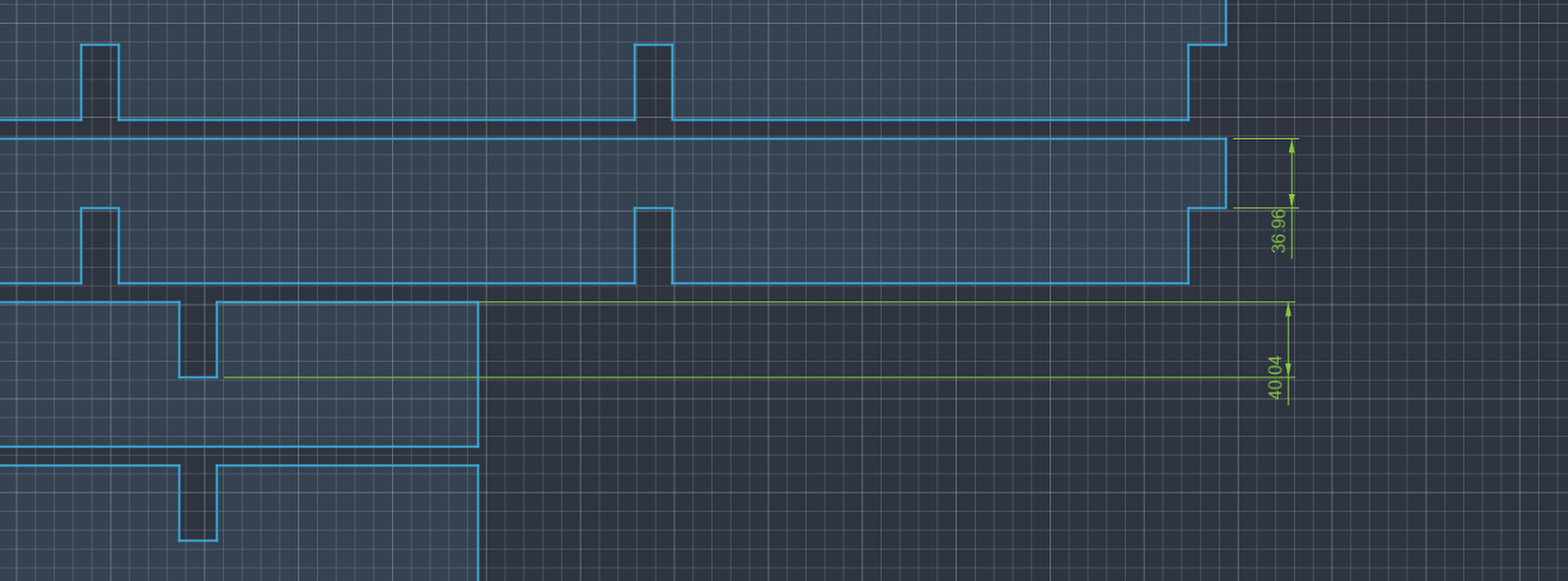

I generated the table and here is what I got:
I must be doing something wrong- or am I missing something?
MillMerge : 1240 x 1240 project.
thanks
let me know if you figure it out.
Seems there was a mix-up somewhere regarding the units. Mm/inch, mm/cm, something like that.
I fixed this in my pull request.

You could try processing the SVG in a LLM like Claude or ChatGPT. Ask it to convert 1px to 1mm. I believe that will also work.
:waving_hand:
Mr. Claude did it!

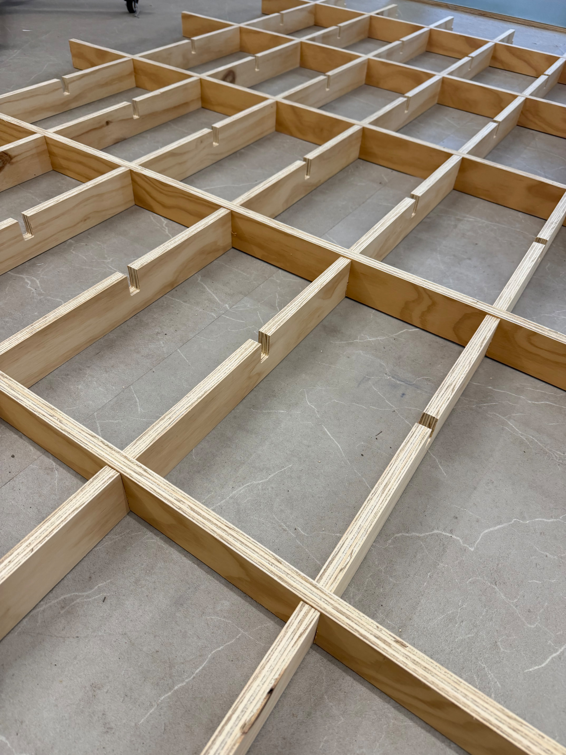

So started to build the torsion box!

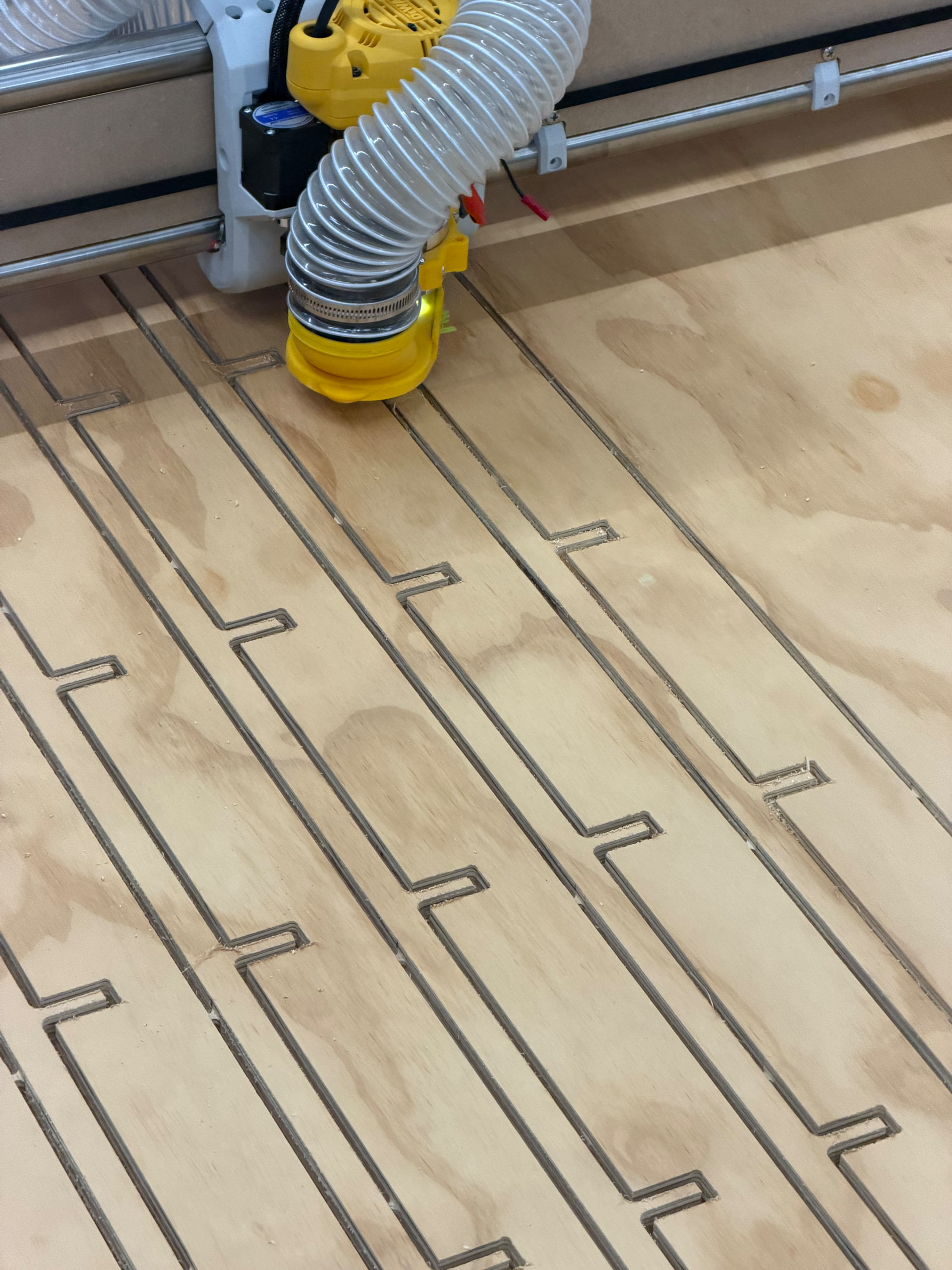

How long did it take to cut the table?
Around 3:30h total for 2 multiplex sheets (easily done in one day with removing tabs and sanding).
Material and size:
  • 18mm multiplex pine (underlayment)
  • Full sheet size 2440x1220mm
  • 70mm rib height for table
CAM Settings
  • 6mm single flute endmill
  • 5mm dept per pass
  • 6 tabs per part
  • 2000 mm/min speed
  • 16.000rpm on DeWalt D26200 (setting 1)
  • Conventional milling
The pine multiplex was bend badly, that made it hard to perfectly align everything… will be much easier with MDF i think… or better multiplex. :sweat_smile:

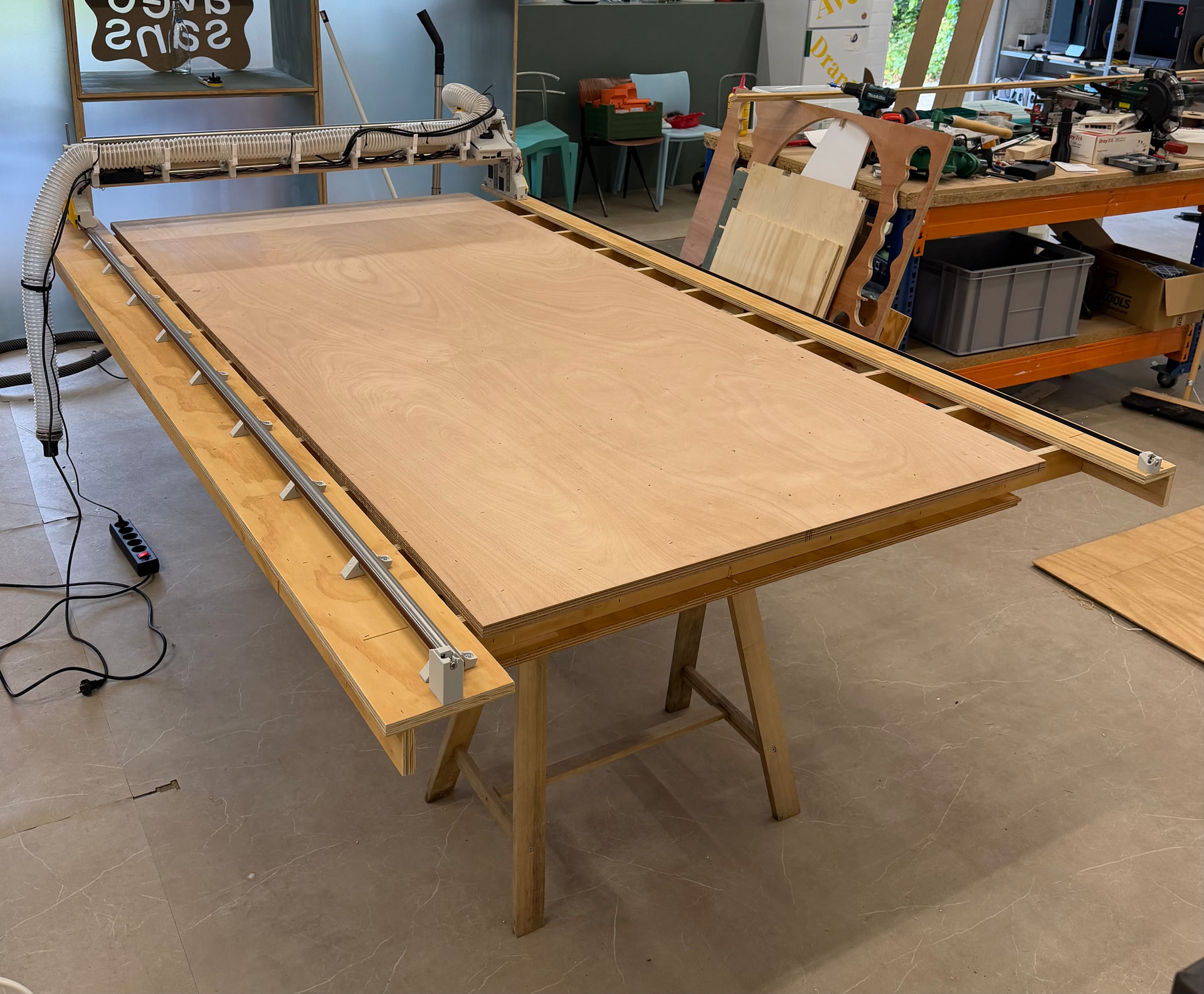

The top sheet is a 22mm Okoume sheet (2500x1220) we had lying around from a previous project.

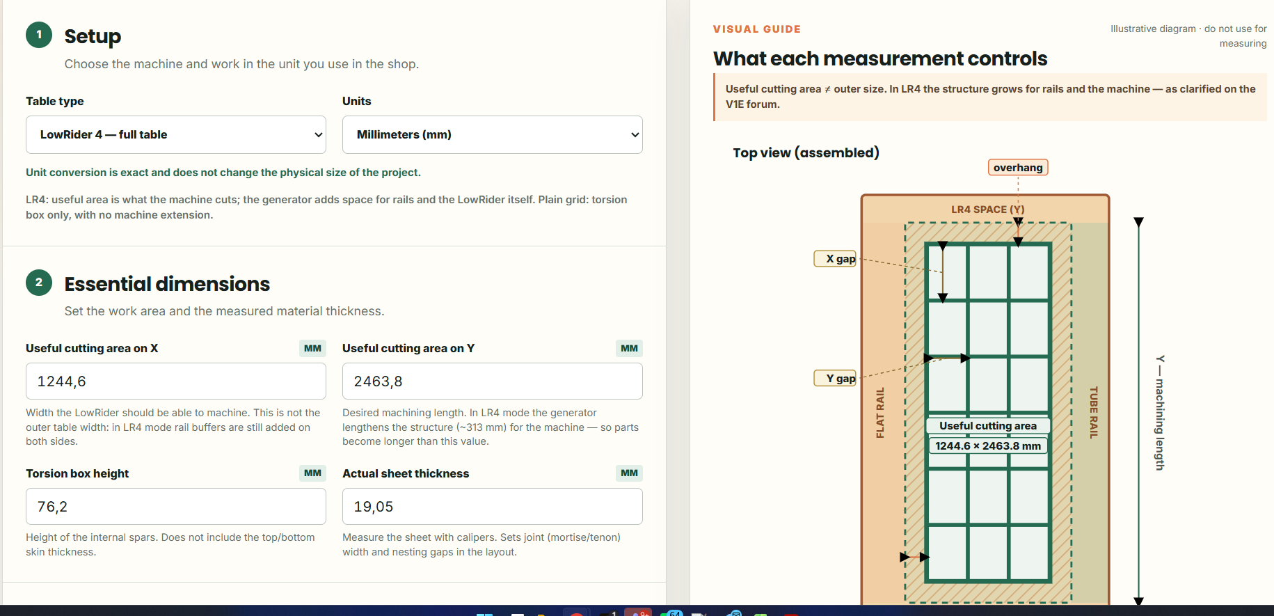

Hi folks!
I’m new here, and I’m really impressed by how much people collaborate and share their work.
Inspired by @franklyrosalind’s work, I forked his excellent Torsion Table Generator and tried to improve some aspects of how the parameters are interpreted and, especially, how they are presented visually.
I’ve made some fairly significant changes, so for now I decided not to send a pull request to @franklyrosalind’s repository. However, if you think this approach could be useful to the original project, I’d be happy to contribute the changes back and remove my fork.
For now, I’ve published my version here:
Feel free to try it out and report any issues or suggestions!

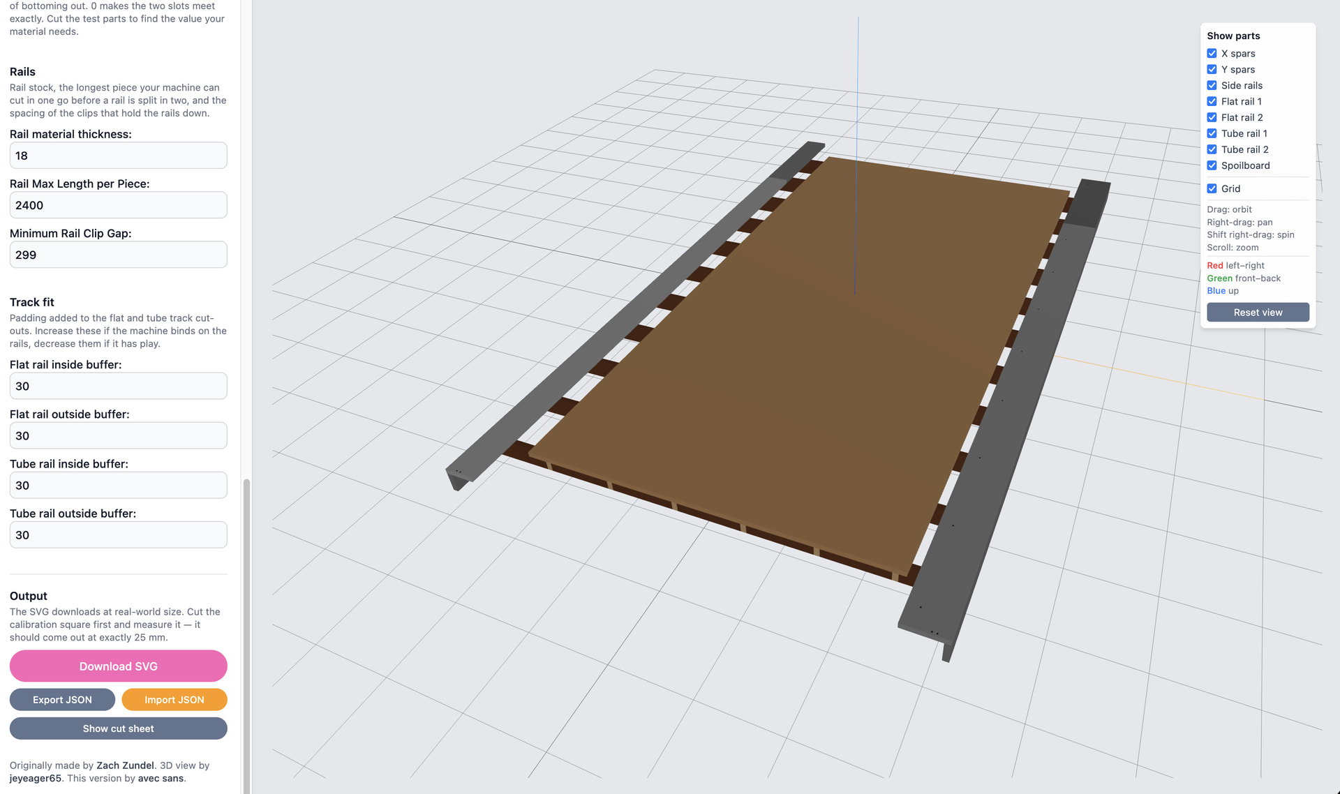

Well, I’ve added @jeyeager his 3D view to the table generator. There is a button on the end of the the sidebar that says “Show 3D view”.
