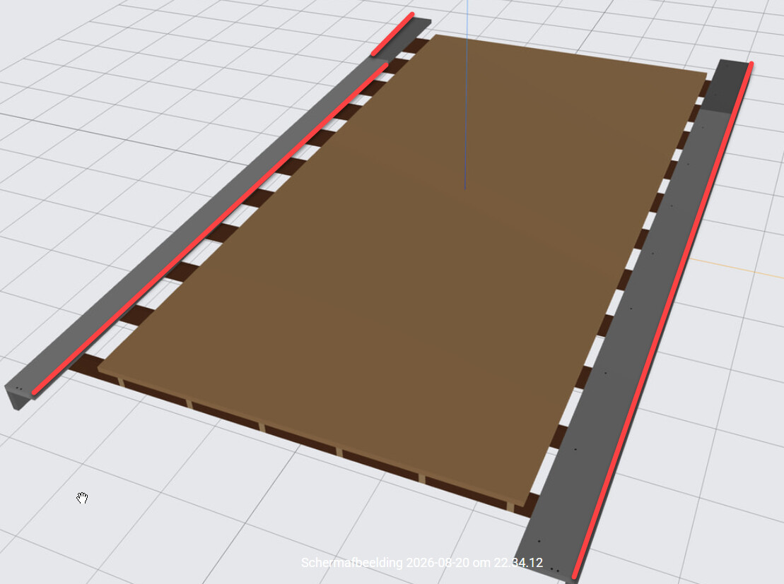

Torsion LR4 table generator
I don’t think I ever got that quite working all the way.
I made some fixes. Will check it again!
Hello
What straight material is this such that is larger than 8ft?
Are they 2 parts or one?
Two parts.
my local hardware store has lots of 10’ options
Do you have these templates available?
I never published it as I was not totally convinced it was usable for other people as-is.
You can find the STL attached though if you want to take a look and try :slight_smile:
LR4-Table - Drill template.zip (136.9 KB)
