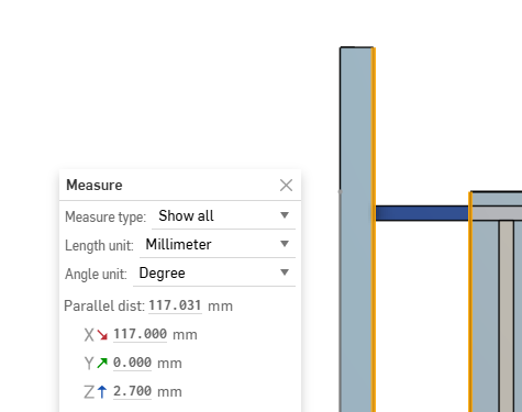

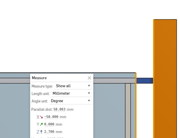

Ryan’s non-CNC design uses different widths for the side rails. And it appears that the distance from the edge of the spoilboard to siderail is different from one side to the other.
I wonder if it would be possible to make the rail width configurable for each side? I’ll be looking to add a drag chain on the Xmin side, just outboard of the belt. On the Xmax side, I only need the side rail to be wide enough to accommodate the mounting clips for the EMT conduit track and belt. Changing those widths would change the length of the X spars to accommodate.
