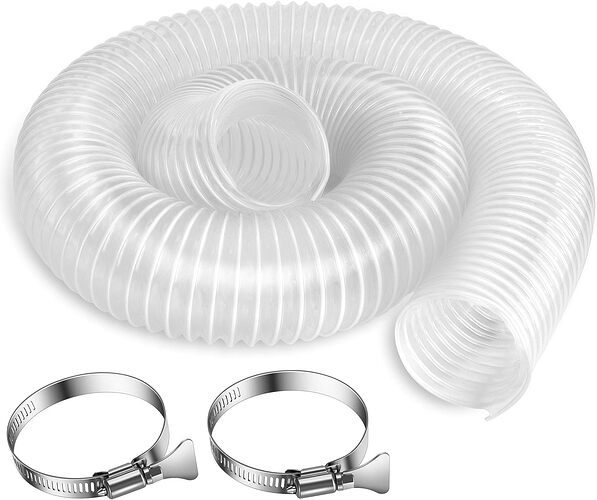

One area of need to be addressed is to keep the suction path tight against both the router and the dust shoe. One option is to use an “accordion” tube:
Although probably the easiest and most durable is to use some standard dust tubing:
71hbvx2qpaL.AC_SL1500
https://amzn.to/3YAUgQ3
