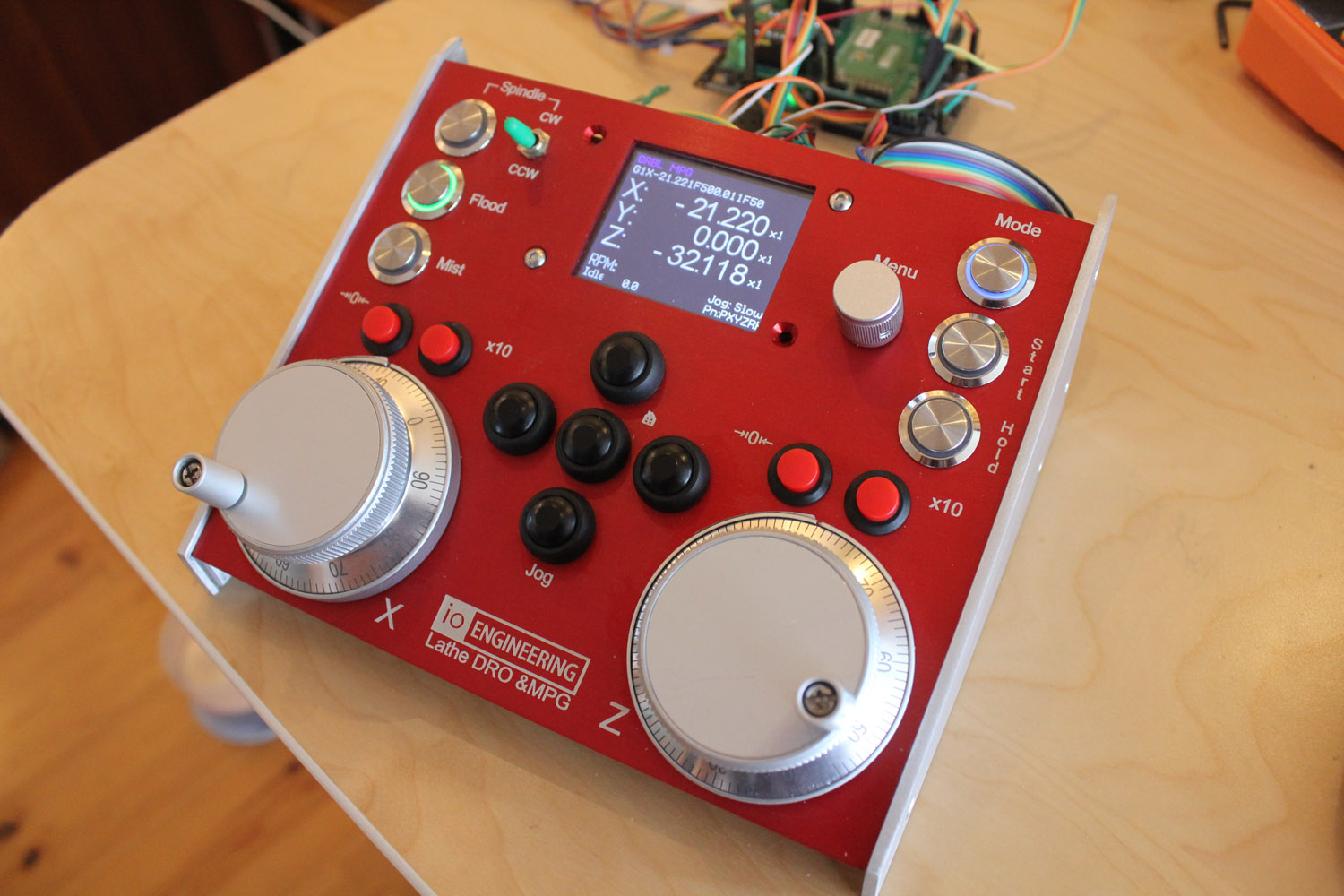

I love this anodized one by Terje Io, the guy who created grblHAL. I believe it controls his lathe.
That is a SERIOUS pendant, wow!
