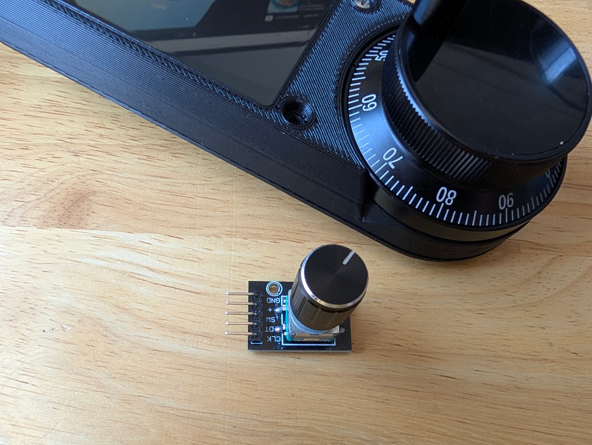

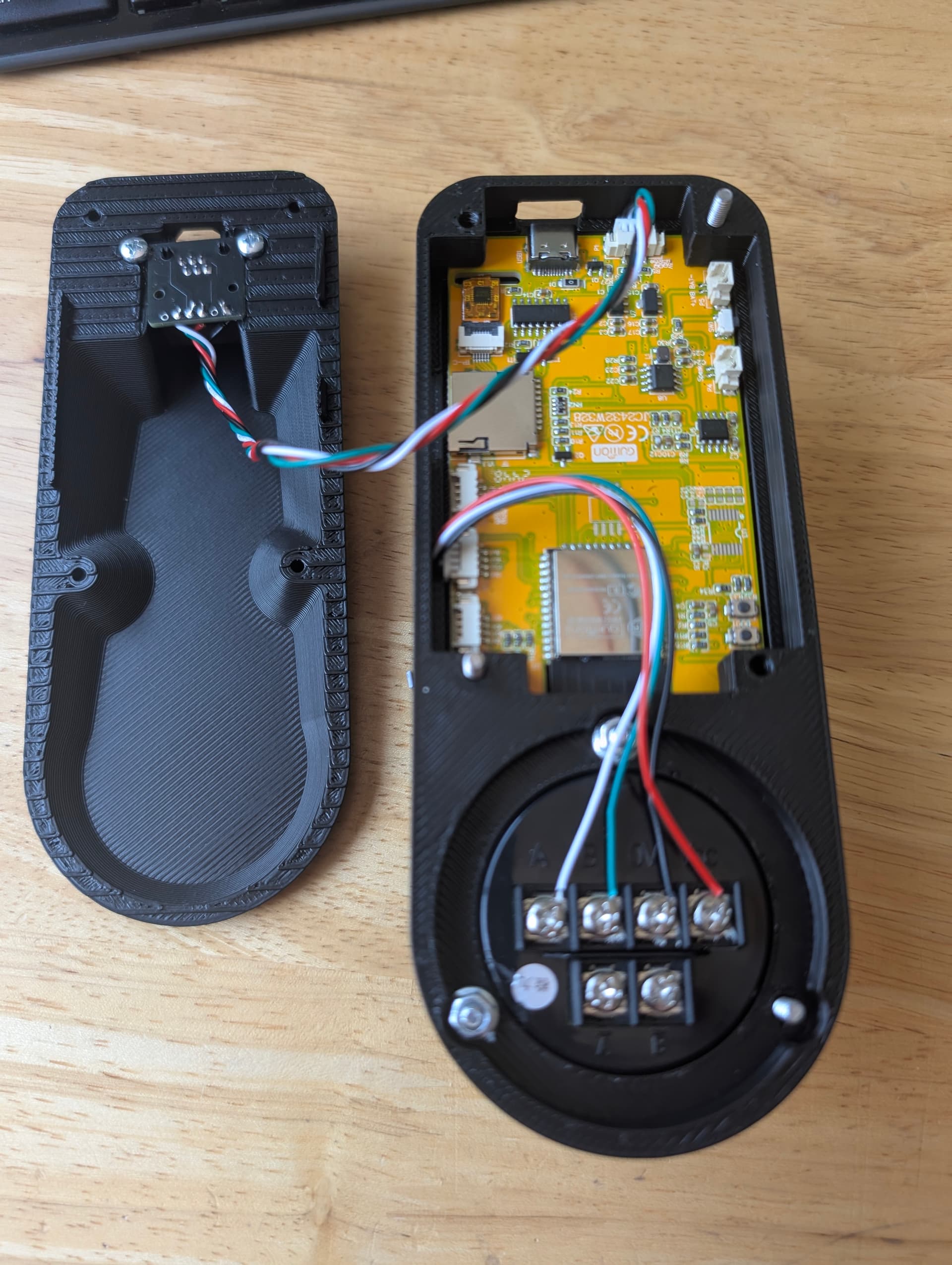

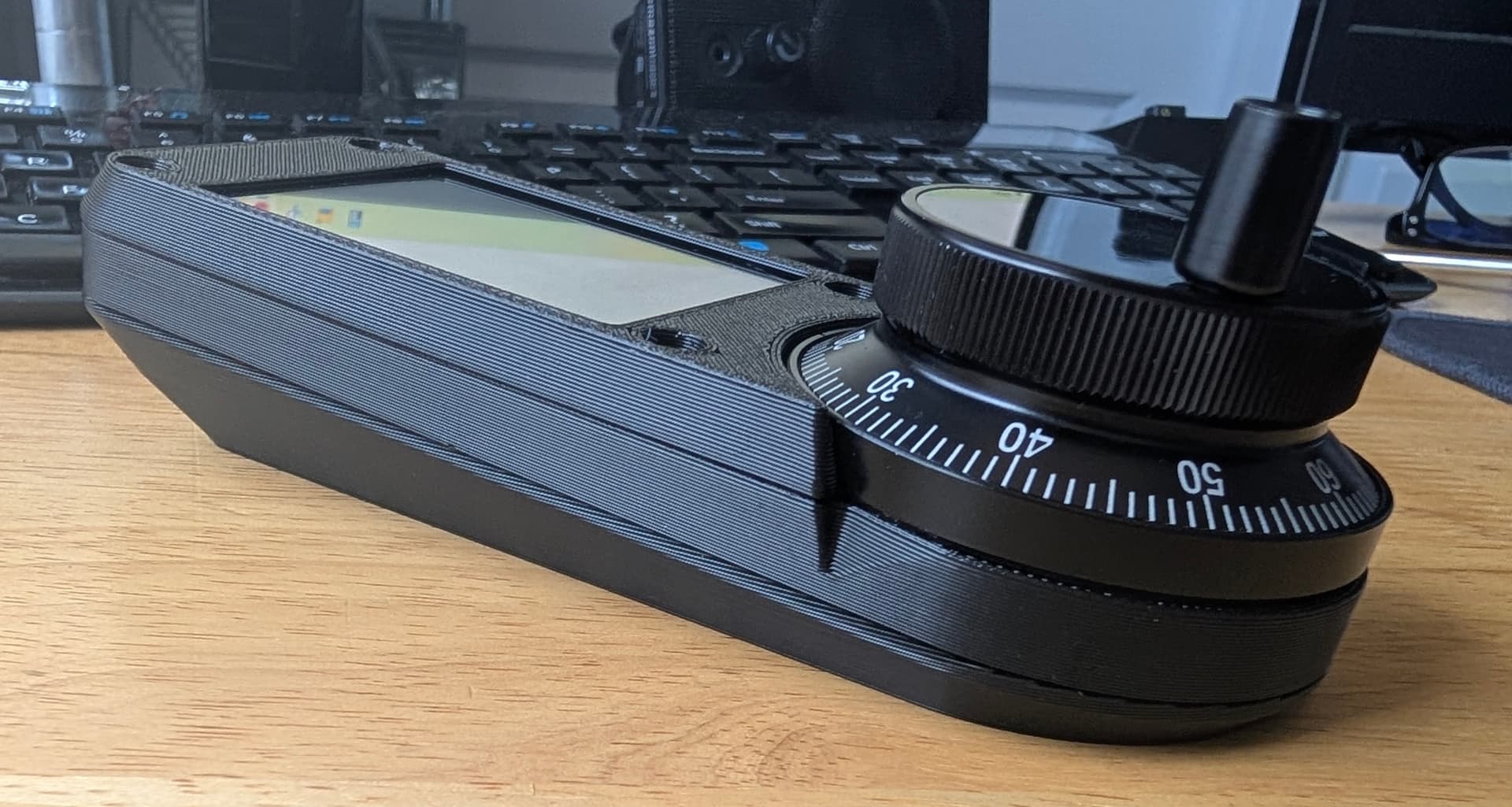

I did make a little box, it is almost done. I wanted something smaller without the space for buttons I definitely will not use.

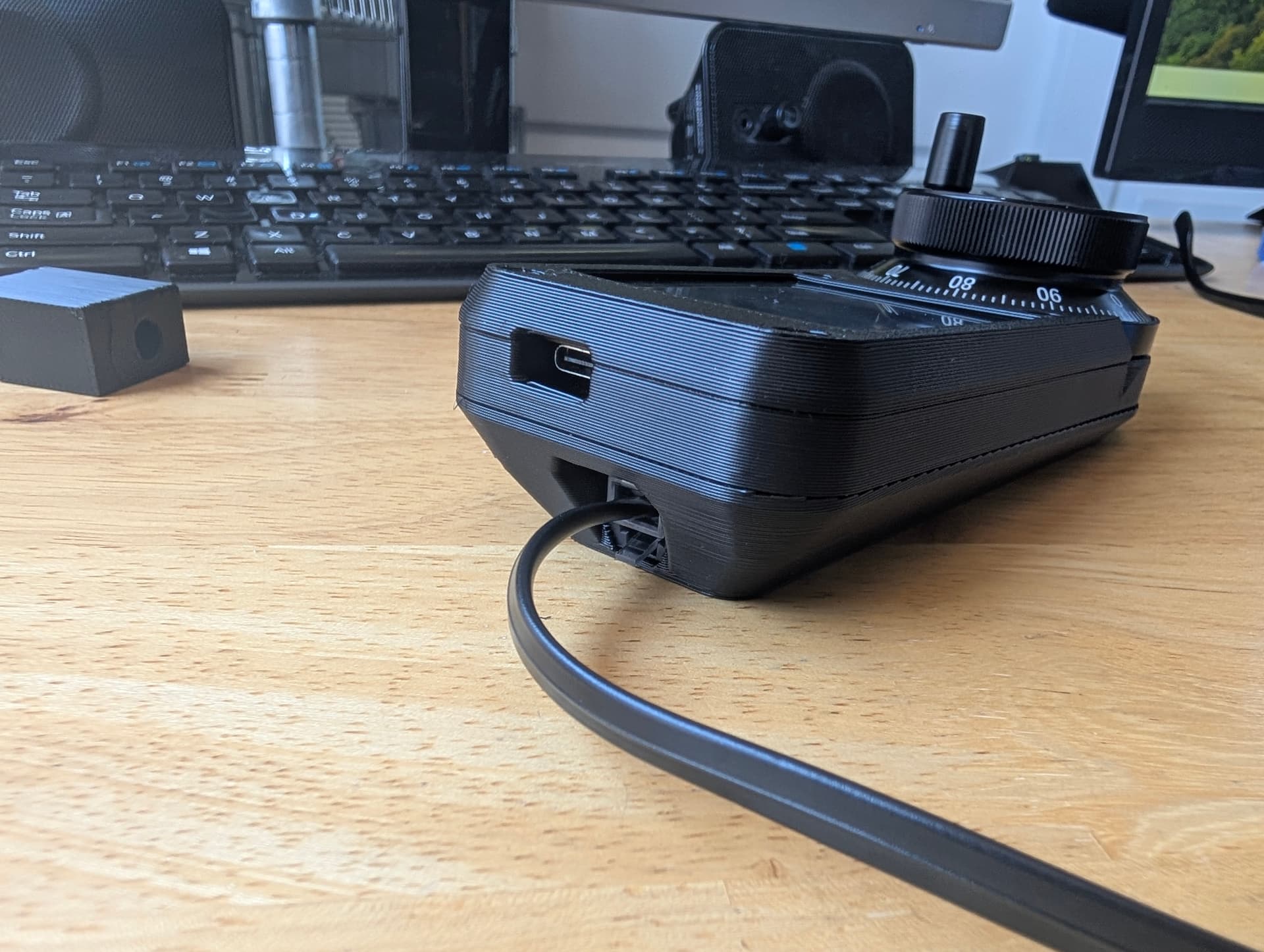

Cable out the top, or cable out the bottom? (Presuming the handwheel is the bottom). I can’t make up my mind.
How did you package the RJ12? Same breakout board that Bart / Mitch recommend?
Room inside for a battery?

I was worried that stairstep from the shallow angle was going to be fugly but you can barely see it. I had a whole convoluted plan to hide it, glad I don’t need to.
Yeah, for some other use cases I’m not super cost sensitive on a device like that, for me it’s more about finding a good screen/controller/pin availability/periphals option. The orange of the M5 dial is a bit goofy and the feeling in the hand is a little rattly for me to be super happy with it.
Not quite sure what you mean, but the whole thing looks absolutely mint. Would 100% make one of those in a heartbeat.
How does it feel to use just sitting down? Does it move under the force of the scroll wheel? Would some rubber feet or something help, or some added weight?
On the slick desk it barely moves while spinning the wheel. I think it would be fine on the CNC table. The dial is heavy.
99% sure I will be making another version, so I can use the little dial instead. It feels better to me, but I will not know until I try. Plus it will be a much smaller pendant, lighter, a little less cost.
It’ll be interesting to see how the actual usability of the 2 is relatively. I prefer the larger dial, theoretically, because it seems like it’ll be easier to get a larger range of motion out of it. Just grab the pendant in one hand and get cranking with the other. It’s the equivalent of having an unlockable scroll wheel on a mouse.
That could be avoided by having a 10x rapid button or something, but it’s all a bit ephemeral. And ultimately it all depends on how hard it is to adjust the resolution of the wheel etc.

Should be ready tomorrow. I missed the stupid little rj11 clip bumps so I kept tweaking the socket. I need another test fit or two. I will add the CAD as well so you all can move things around or make more room if you want it. Should be easy to move it back and add buttons as well.

Love the design. And I’m a big fan of the large dial over a small encoder. I tried a standard encoder when building mine but didn’t like the feel even with a larger knob on it. The clicks on the big encoder make it really feel “right” to me.
I would like hardware buttons though. But I’d also like to see the software buttons go away when using hardware buttons and make better use of the available screen. Then again I’m not impressed with my current hardware buttons since they’re just as fiddly as the touch buttons for actually registering.
The M5 is a neat idea…but the interface is way too cramped for me. My fingers aren’t very large but I still had a really hard time using the touch interface and too many things needed to be touched. The dial on the M5 also just didn’t have the right feel - much like a standard encoder over the big metal one.
For me the main reason I like the pendant is I’m not having to look at an interface when jogging. On my ipad I have to look at what I’m tapping which means I can’t be looking at the machine. I want my attention on the machine and the pendant to be intuitive to my fingers. The big knob does that best - easily doing big moves or fine moves depending on how much I spin it. The smaller knobs that just didn’t work.
