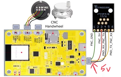

I’ve tried both the M5 and the CYD pendant and honestly I’m not a big fan of either. I liked the CYD more but mine just fried last week and I can’t say I’m in a big hurry to rebuild it. Apparently I thought I had added a strain relief to it’s cord but never actually did - so powering on the machine last week the cord pulled loose from the jackpot as it was booting and now the CYD is dead.

But - yesterday I did find a few minutes to open up the case on my CYD Pendant and do some bench testing. Good news - it does power up over USB. And it does boot up quickly - about 2-3 seconds until it’s waiting for connection. So my memory about where the delay is was a bit off - it’s just how long it takes to connect to the jackpot/fulidnc that’s annoying to me.
Now though I’m not sure why it stopped working on the actual machine and I’ll have to do some additional digging/testing. Have to confirm it will run off 5v directly instead of USB next but didn’t have time to clear enough of the desk to get to my power supply. Hopefully in the next few days.

Oh I know it’s supposed to - and it was. Up until last weekend when the cord pulled loose and then it wasn’t coming up at all when plugged into the Jackpot.
Over lunch I took a few more minutes and hooked up my bench supply and confirmed that the CYD still powers up over it’s 5v line. So now I’ll have to take a look at the jackpot on my machine to confirm it’s still got 5v on the header. That may take a bit longer because it’s too hot for me to go out there unless I need to right now and while the LR4 may be “portable” I don’t really feel like taking it off the table and bringing it inside just to debug why the pendant is suddenly not working.
But - it seems the pendant works by itself still when powered through the cord so It’s either the connector on the jackpot or a regulator on the jackpot went out when it came loose (though that seems unlikely since the jackpot is still working otherwise…but I haven’t looked at the schematics to see what else may be on that power rail.)
Alright - not sure why my pendant stopped working the other day now. Because over lunch I went out and plugged it into the LR4 and sure enough it worked again. Maybe I just didn’t seat the connector well after it came unplugged?
