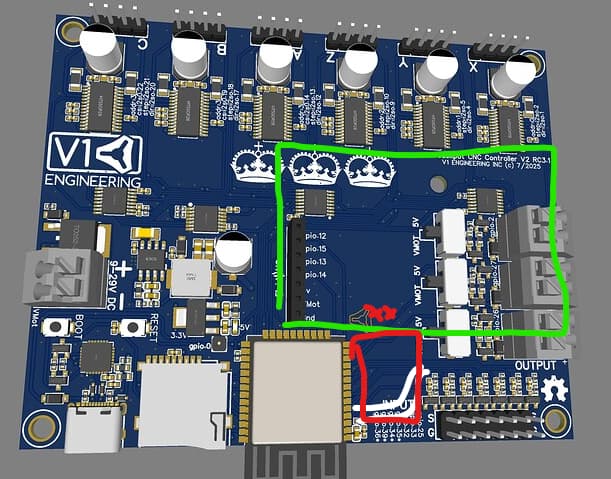

Ah, that makes sense. I spent some time yesterday and I do think I can squeeze the RJ port on there and hopefully the little protection chip Jono found.
If you do that, use the upper two GPIOs from the header, not the lower two. That preserves the use of the expansion header for non-UART stuff as you wouldn’t need a pin swizzler for the expansion modules. In other words, makes the JackpotV2 IO asssignments better by default.
gpio.12 and 15. Got it, that makes sense.
green is the module outline, white are the traces I would need to bend, red is hopefully where it would fit. The current v1 log is another option but getting traces over there is no good. Anything else takes substantial rework.
Use GPIO 12 and GPIO 15 if you bring them to a connector.
