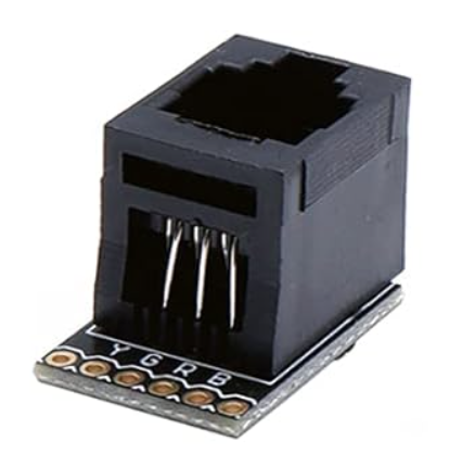

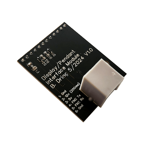

Do you have the Display/Pendant Interface Module for the 6pack already? If so, all you need is the RJ12 Breakout board for the pendant. If you don’t have the module you can use another RJ12 Breakout board for the 6pack.
This is the one you should use on the jackpot/6pack side so you have ESD protection.
Its the same one that comes in the M5 dial kit, just without the other side since its different for the CYD

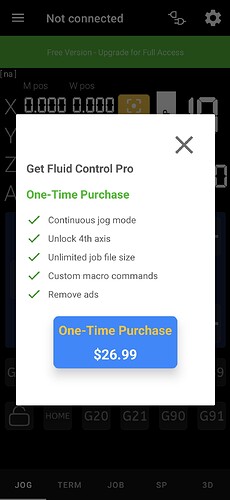

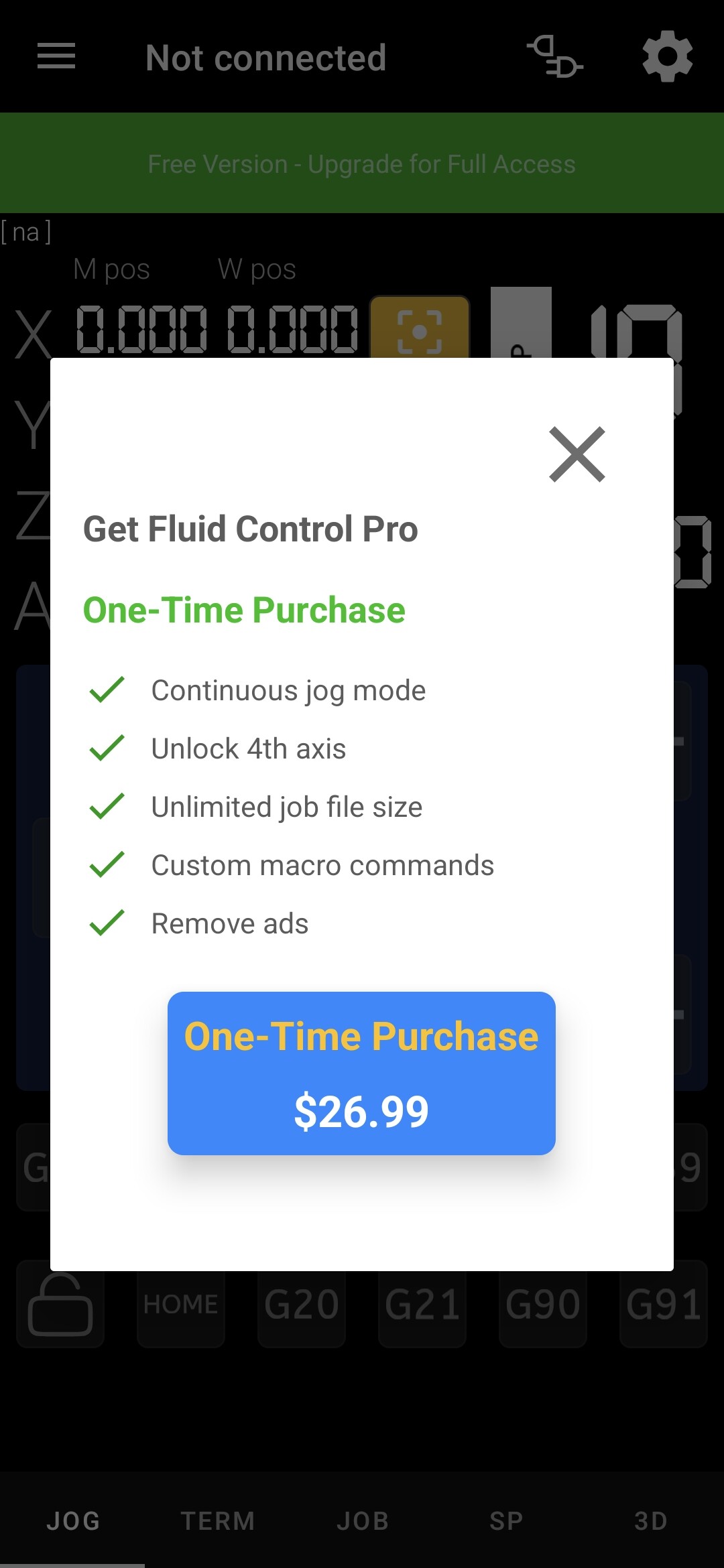

There is an Android fluidnc app. Will post the link if i find it
Webui without ads is 100times better, just configure your tablet to not dropoff the wifi/dont sleepmode

It does have a visualizer.
Nah, not another webpage that pretends to be an App. :expressionless:
Never used it, it contains ads.

I tried that app at one point awhile ago. You can pay to remove ads but it’s kind of expensive.

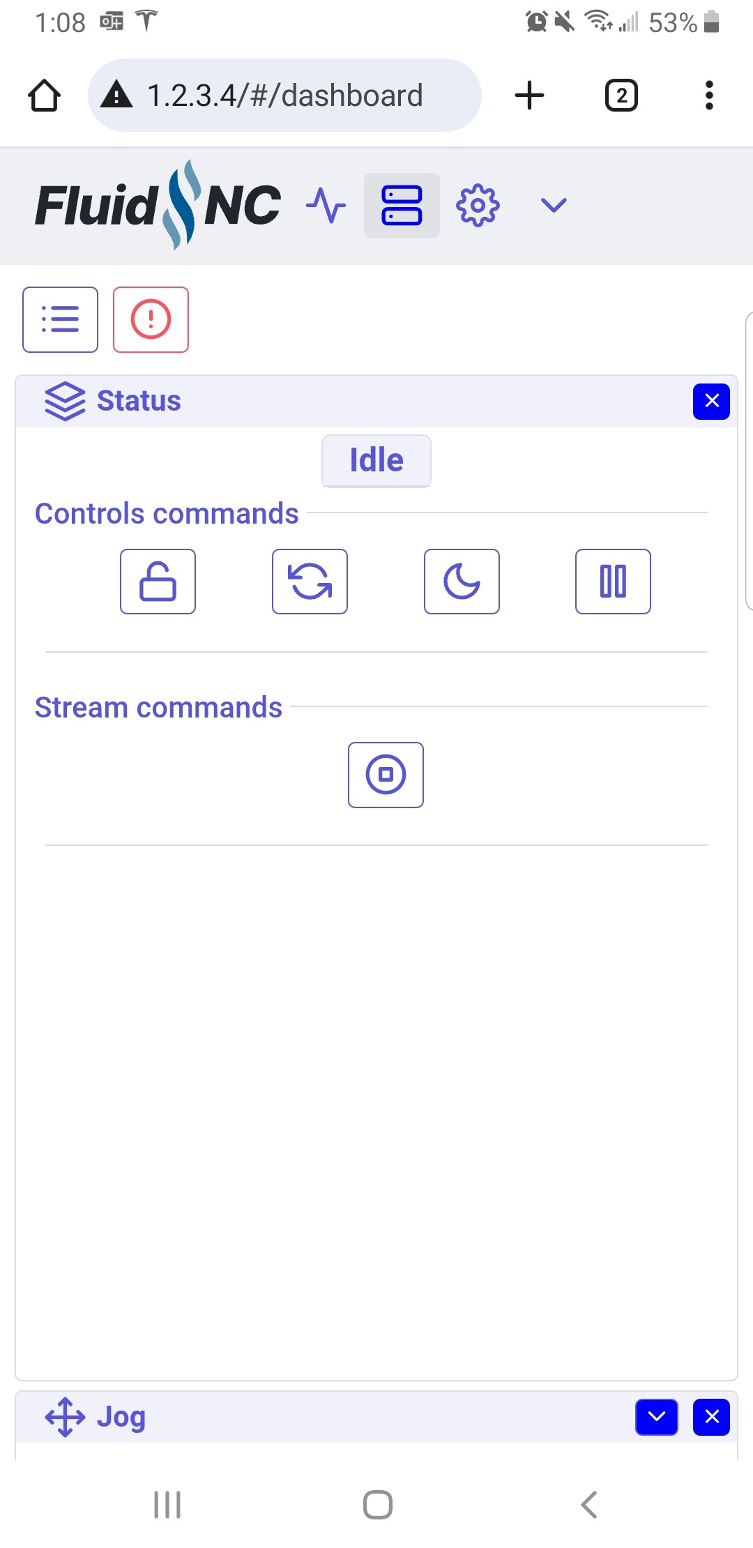

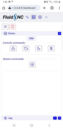

Are some people wanting a pendant because they struggle to use WebUI on mobile? Is that the problem (or one problem…) that should be addressed?
I just installed and tried the fluid control app. I didn’t like, the Ad popups and permissions overreach was annoying. But then I wasn’t very patient with the app. Have uninstalled…

Existing WebUI on mobile is not fun imo, too much finicky scrolling needed. Ideally, would have a more responsive layout, that’s appropriately compact, task focused and intuitive for mobile screens similar to tablet page. I use 10" tablet+ BT keyboard, and even then I often grumble about some of the WebUX quirks.

This is what I see on mobile, not ideal…
