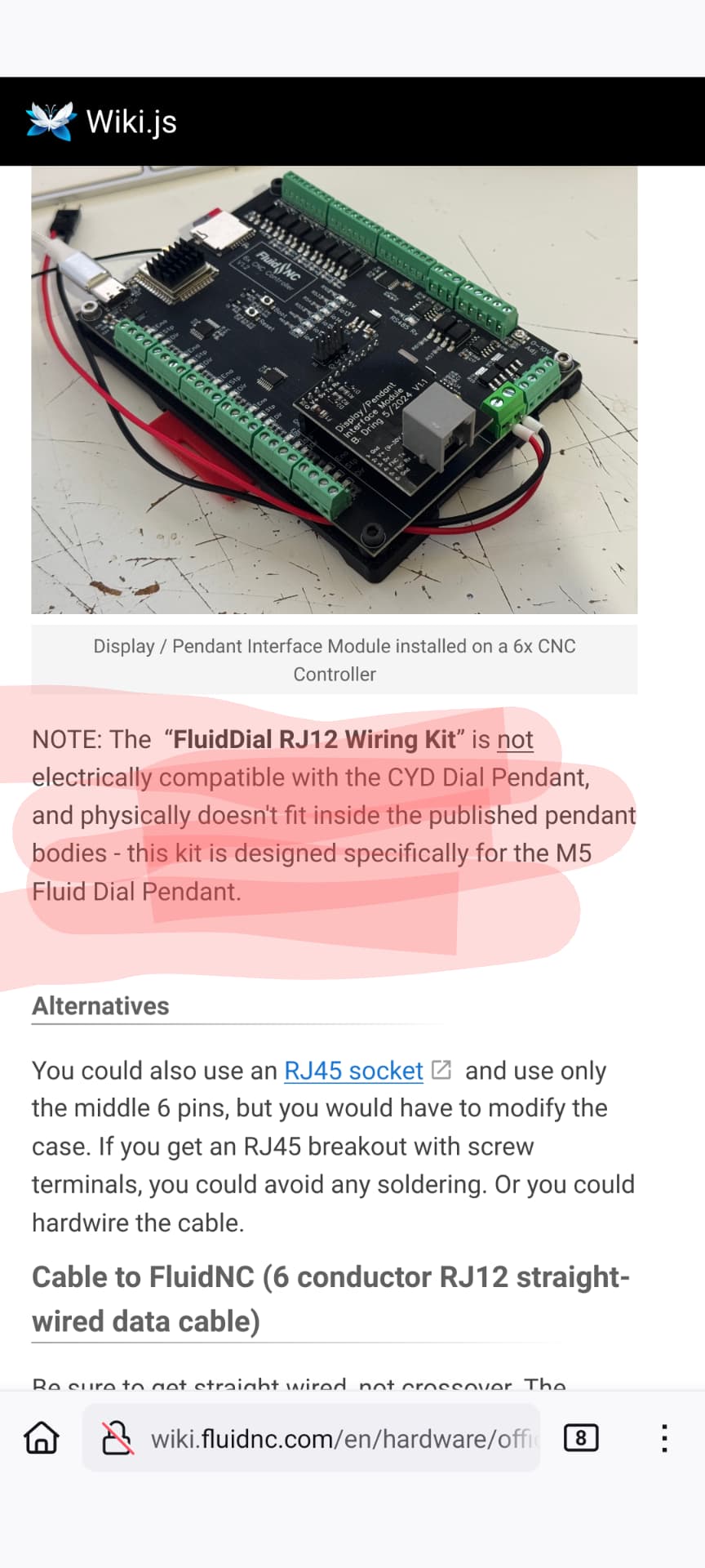

Would someone write a bom list with links for the pendant (preferably amazon or AliExpress but one you can get everything in a single app)
I got everything I needed from the wiki
This kind of stuff lol, what connetor works with a module out of the box!
Just below what you marked in red. That socket is what I used. Yes I had to solder the pins socket to the board. There might be one out there that has the right orientation already soldered but I didn’t look for one.
You can get the other side separate from the M5 dial kit. He has a link to it on elecrow since his tindle store is closed right now.
