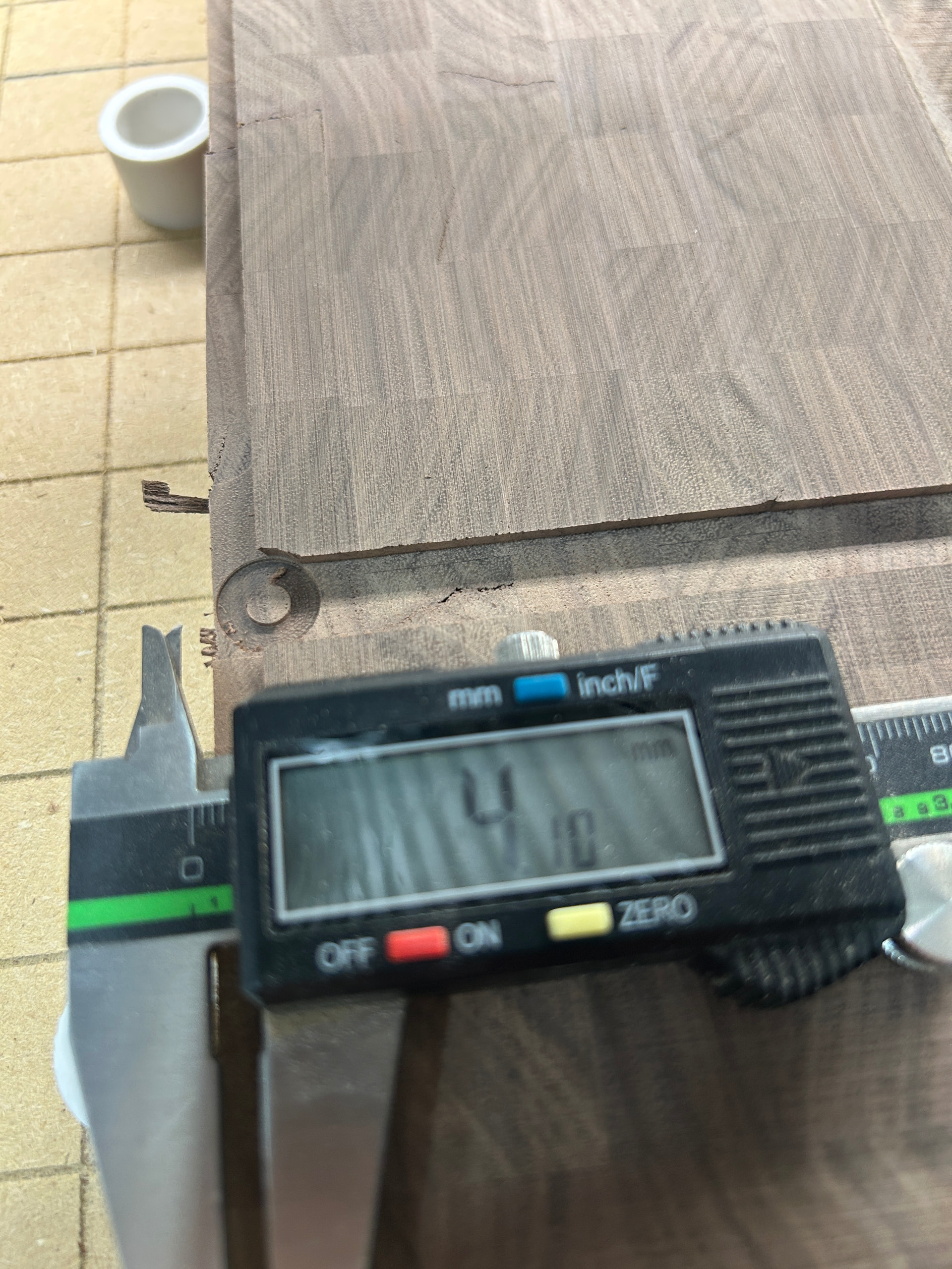

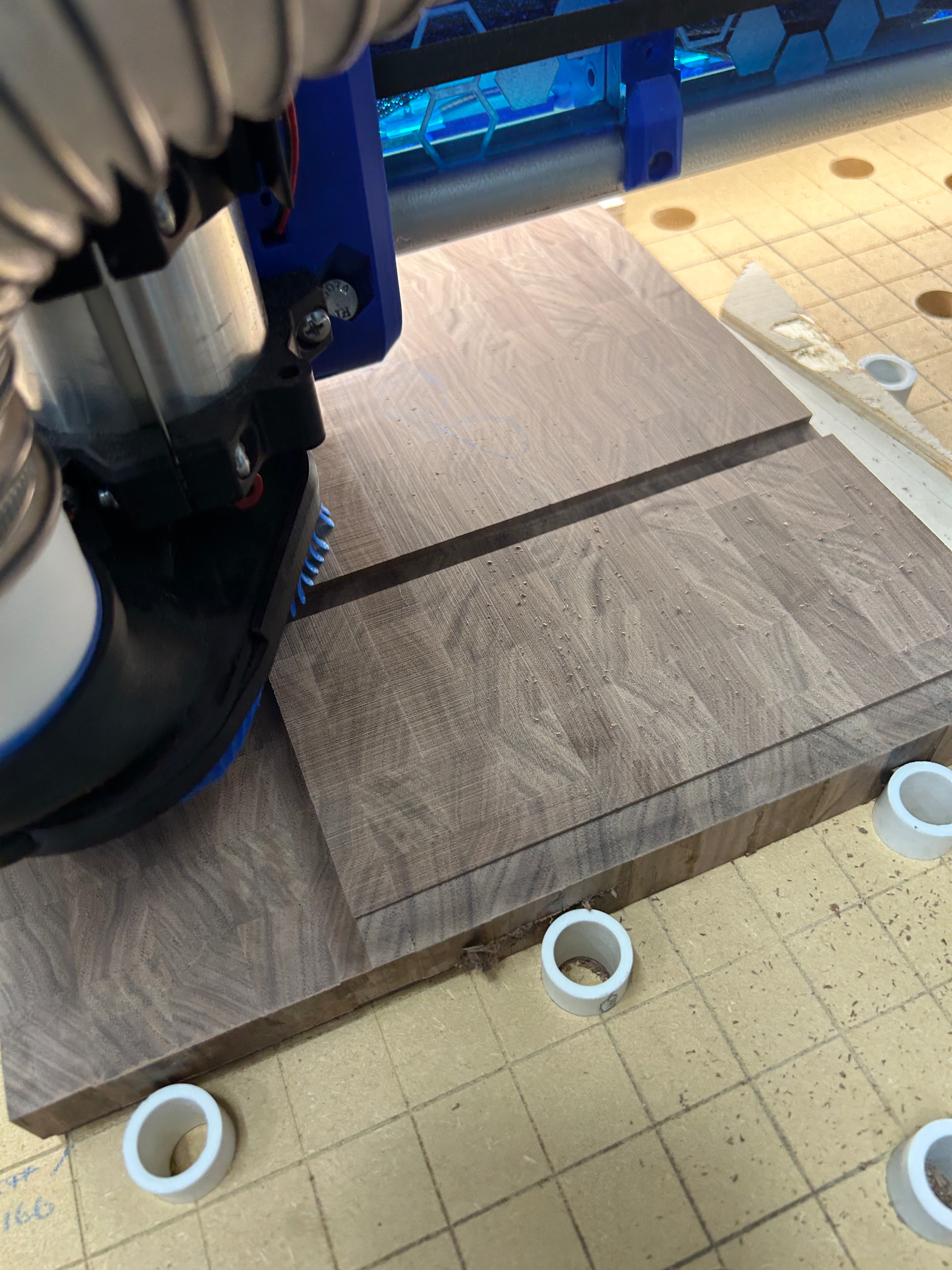

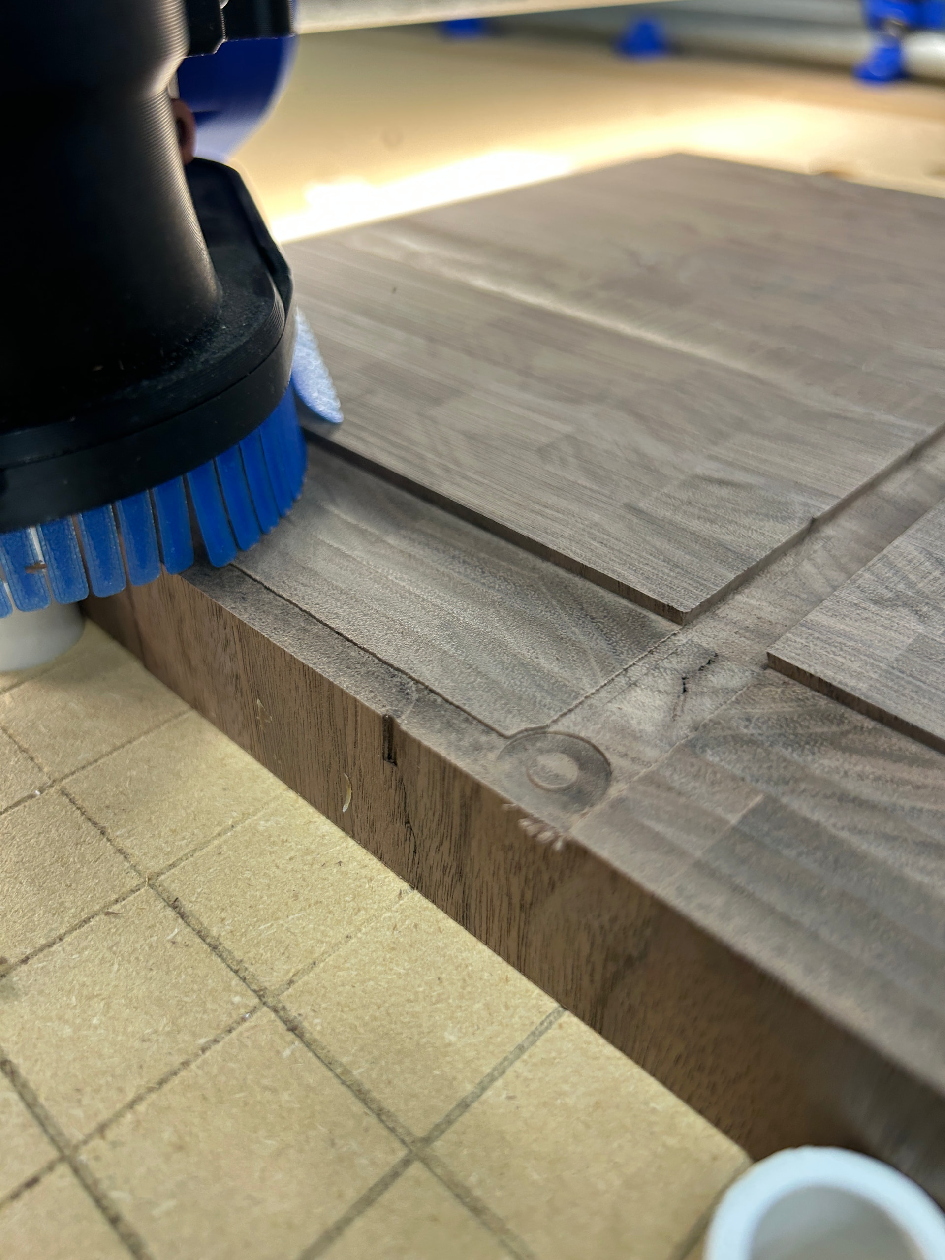

Set up to do the other side, and 5 seconds after I pushed go, the file seemed to reset itself, and glitched, leaving a 4.1mm deep dovetail groove right through the middle.
without bogging down.
so, in theory, I can do walnut endgrain grain at 4mm DOC, 1500mm/min feed with th 1/2” dovetail bit. Good to know.
Reset everything, plugged the tab into power, and reran- all good.

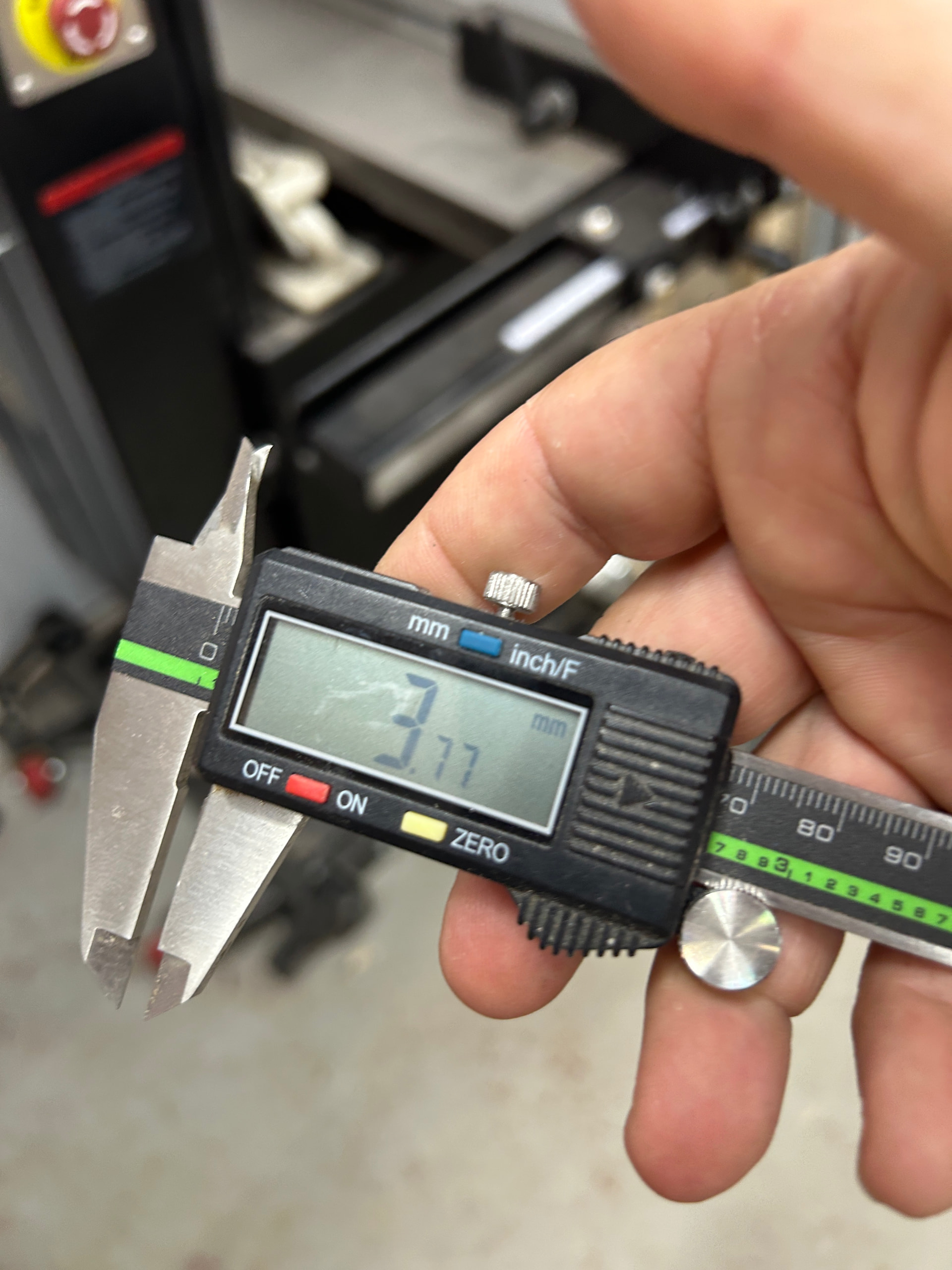

it’s currently cutting the surface away at 3.77 mm DOC because that’s how warped that side of the board was.
