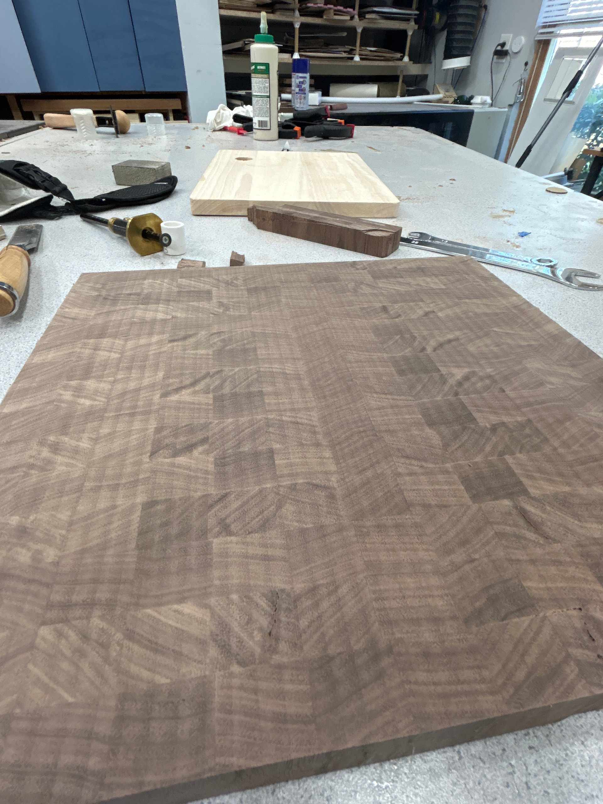

Plan is to put it on the bed, with a 1/16th shim under the front corner, then surface. Thatll make the vcarve surface parallel to the gantry. Vcarve, remove waste, then I can flip and make the backside parallel to the top.
If I don’t make the top surface parallel to the gantry initially, I’ll have slight mismatches in the machined depth depending on how far off flat the board came out the glue up

So, I’m guessing that means you don’t do an initial surfacing of your boards before doing your v-carves then?
I’ll mention this flattening is my normal workflow for end grain boards- I normally would use a router sled on my work table.
I just figured the process was to make a complete end grain boards, minus finish, then do the v-carves. So a finish flattening is the second to last step of making the initial boards.
the process I’ve seen by the ‘big’ vcarve people on YouTube always starts with a Cnc flattening to make the top surface coplanar with the spoilboard an parallel to the gantry, for accuracy.

I didn’t have the sander until now, but I would not do that with the boards. I’d scrap the glue, then surface the board on both sides. Maybe that’s too much. I should run it through the sander, then surface one side.
For the plug I just sand it, it’s flat enough then. :slight_smile:

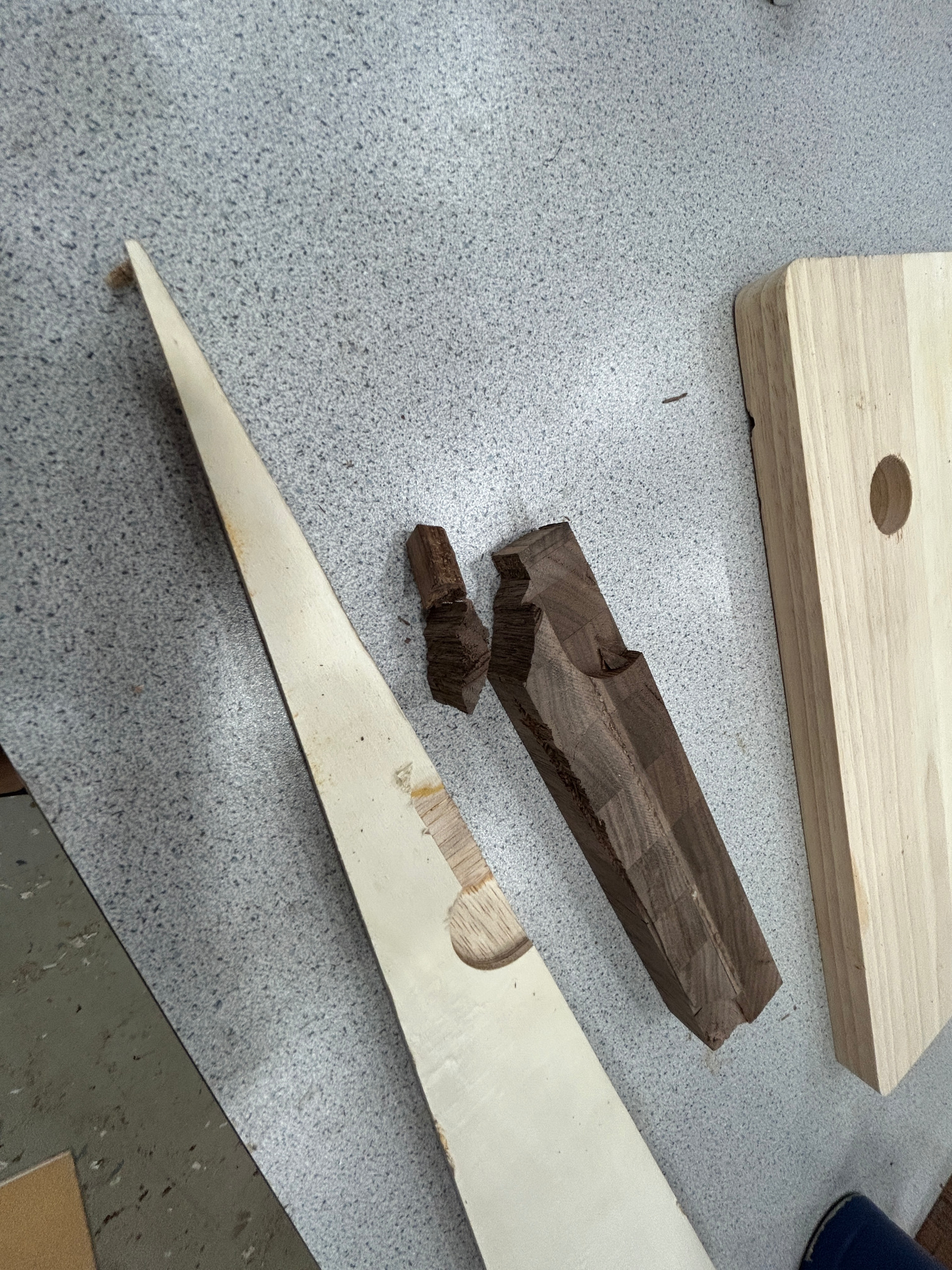

Going okay until the bit hit a hidden crack and threw 2 chunks of walnut across the room, and 1 into my chest. Hit the estop, picked up the pieces, turned off the lights, and ate some pie.
Try again tomorrow, with a different bit. I have a 1/4” upcut 2 flute I might try if I can’t find the 1/2” dovetail bit

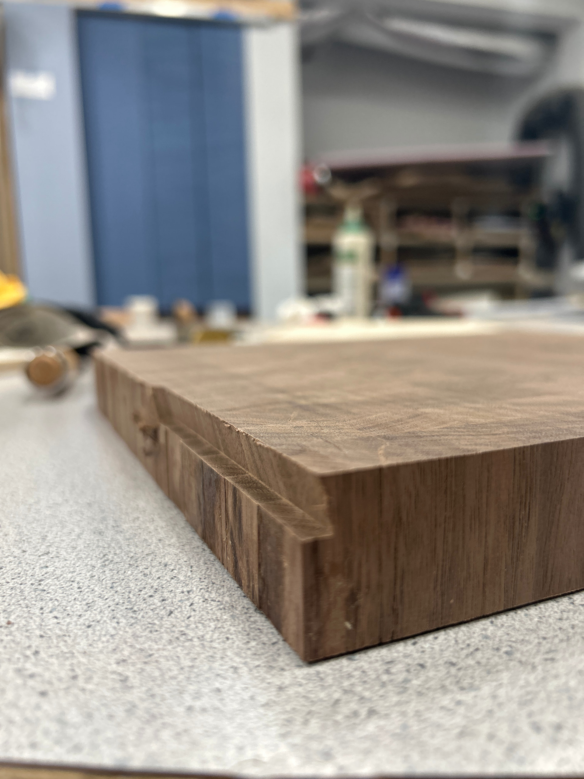

Anyway- took a while to find the sweet spot, including one instance of hitting the wrong program, that resulted in a full send of the aforementioned 1/2” DVT through the side of my walnut endgrain.
interestingly, the machine don’t bog down, and the cut looked pretty good, so at least now I know I can do a 50% step over dovetail in walnut at 25mm/sec
Anyway, 90 minutes of running different variables, and I got it to where I can do a 1.5mm DOC at 30mm/sec 50% step over. Finish is flawless, no tactile ridges (although the visual ridges are there because the way the fibres smoosh) . I’m very happy with that at this point.
