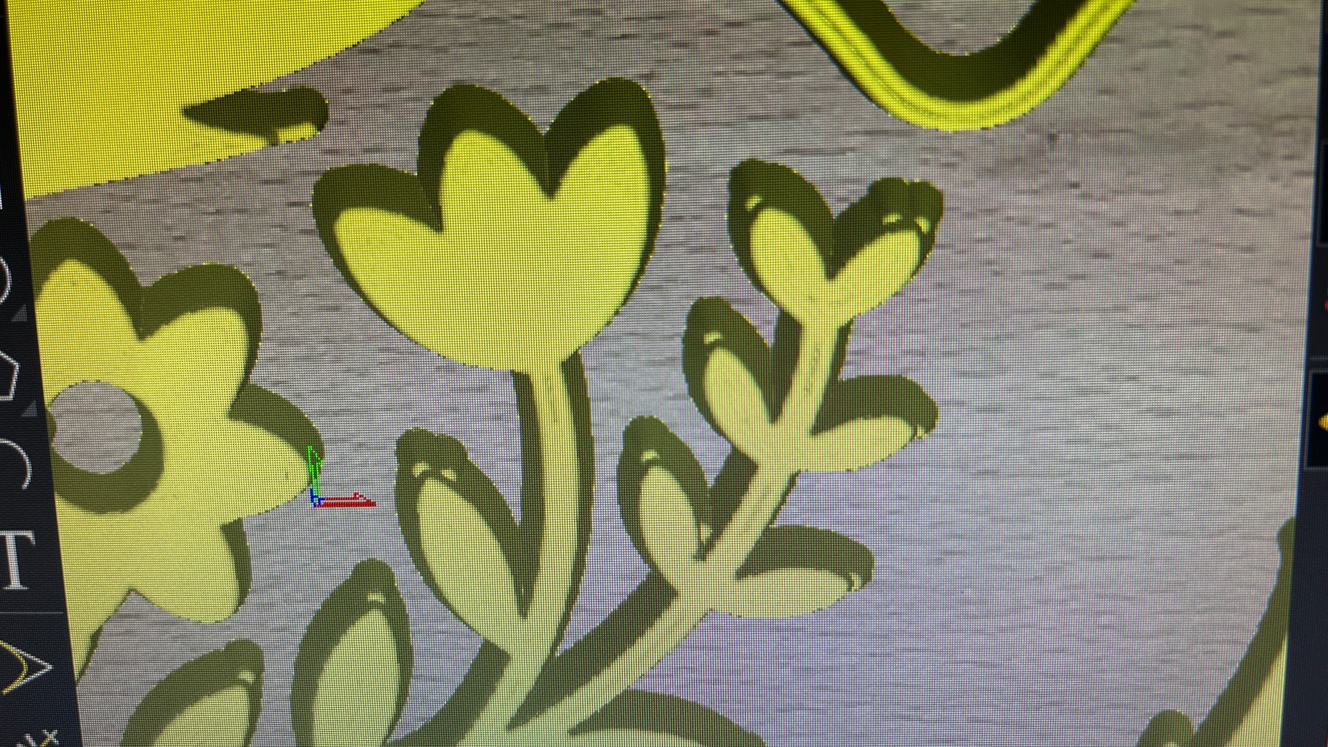

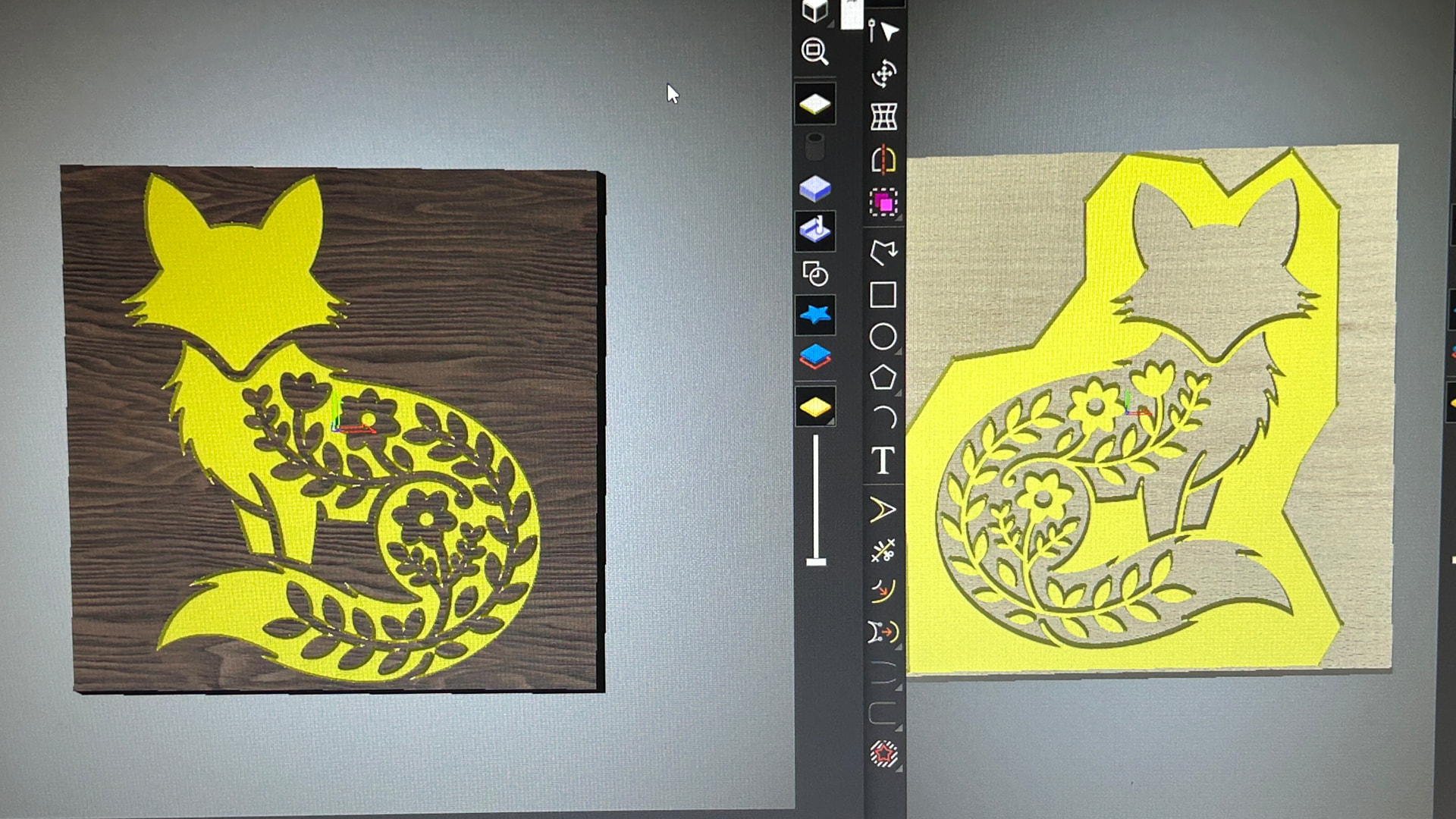

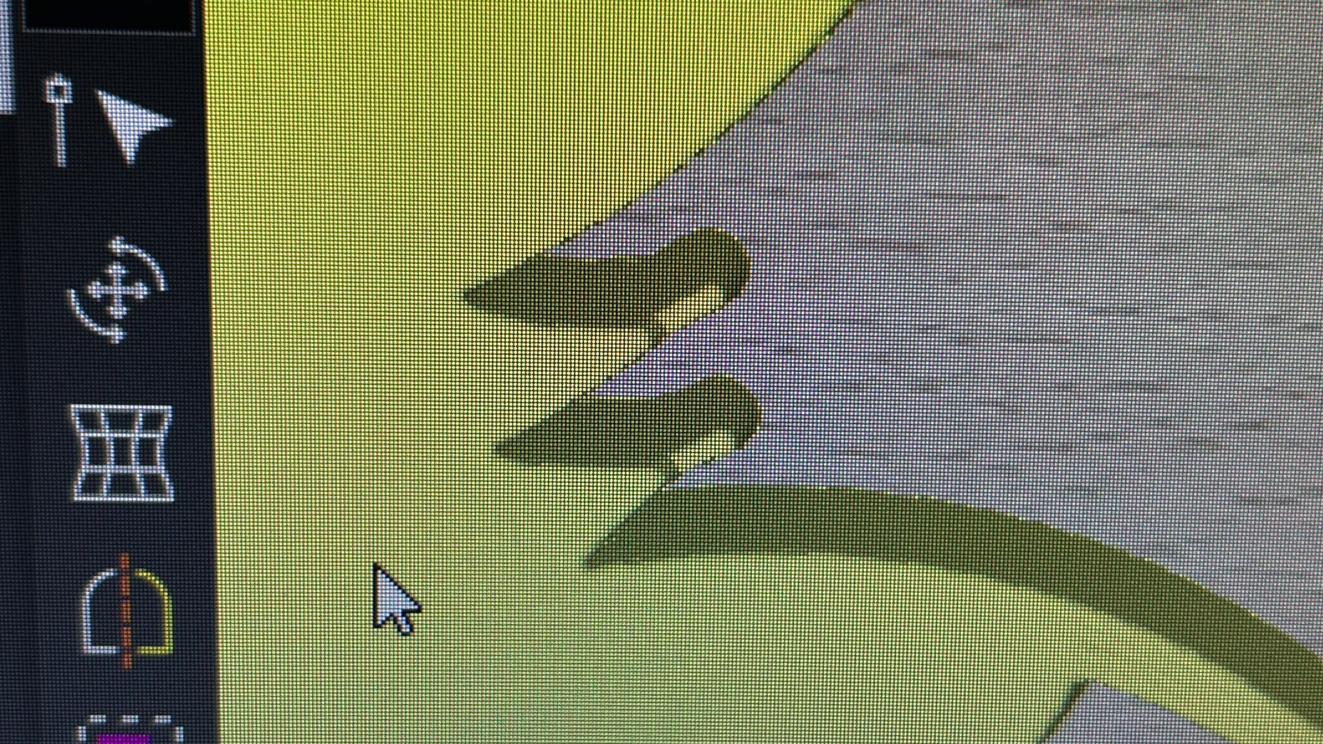

I’m doing some pathways in carveco, and getting these little steps. Seen this before?
Don’t know that software, but can it work with the endmills? :slight_smile:
