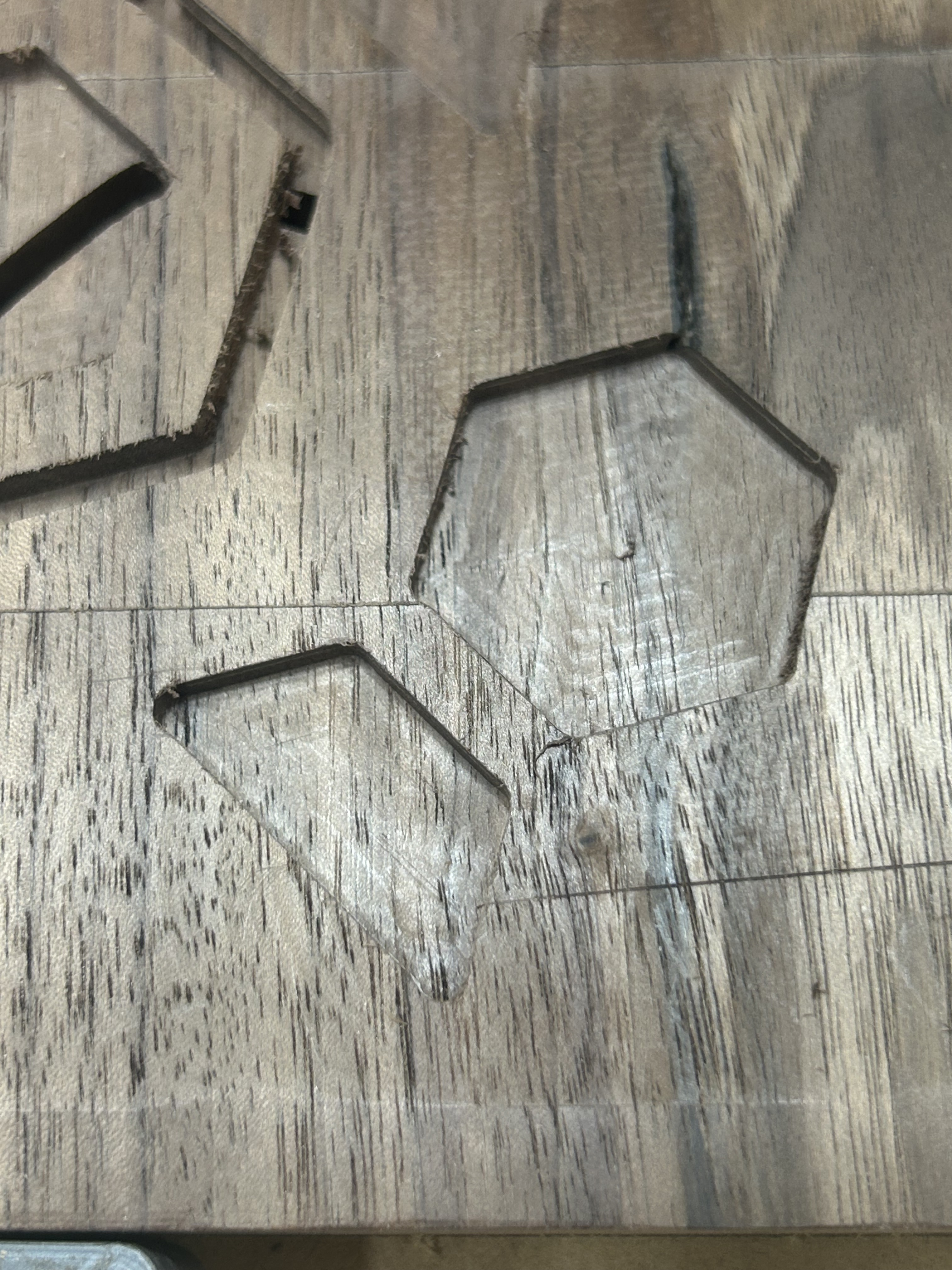

1/8” compression bit from spetool. 1” long.
Think I’m doing 25mm/s at 1/8” doc. All in, each board takes 11 minutes.
When I tried it with a 1/4” clearance toolpath, and profile, and doing a 1/8 cleanup for the inner corners- it was taking 23 minutes each with the tool changes.
Any guesses on how long an IDEX dual core LR4 setup would take (no tool change)?
:flushed::flushed::flushed:

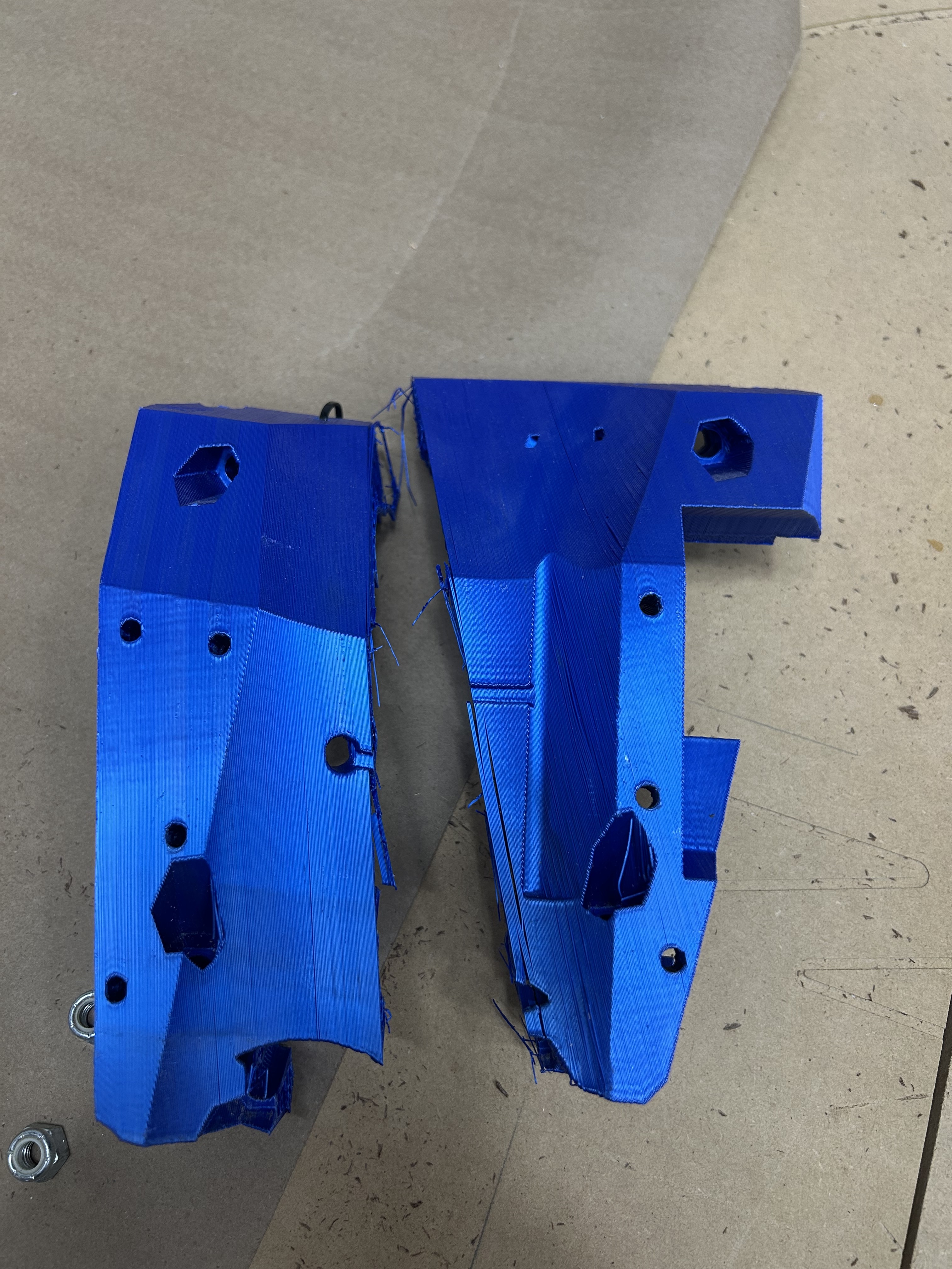

Yeah I would say that one is done :rofl:

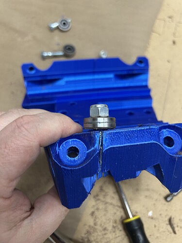

Sorry your Core split :poop:.

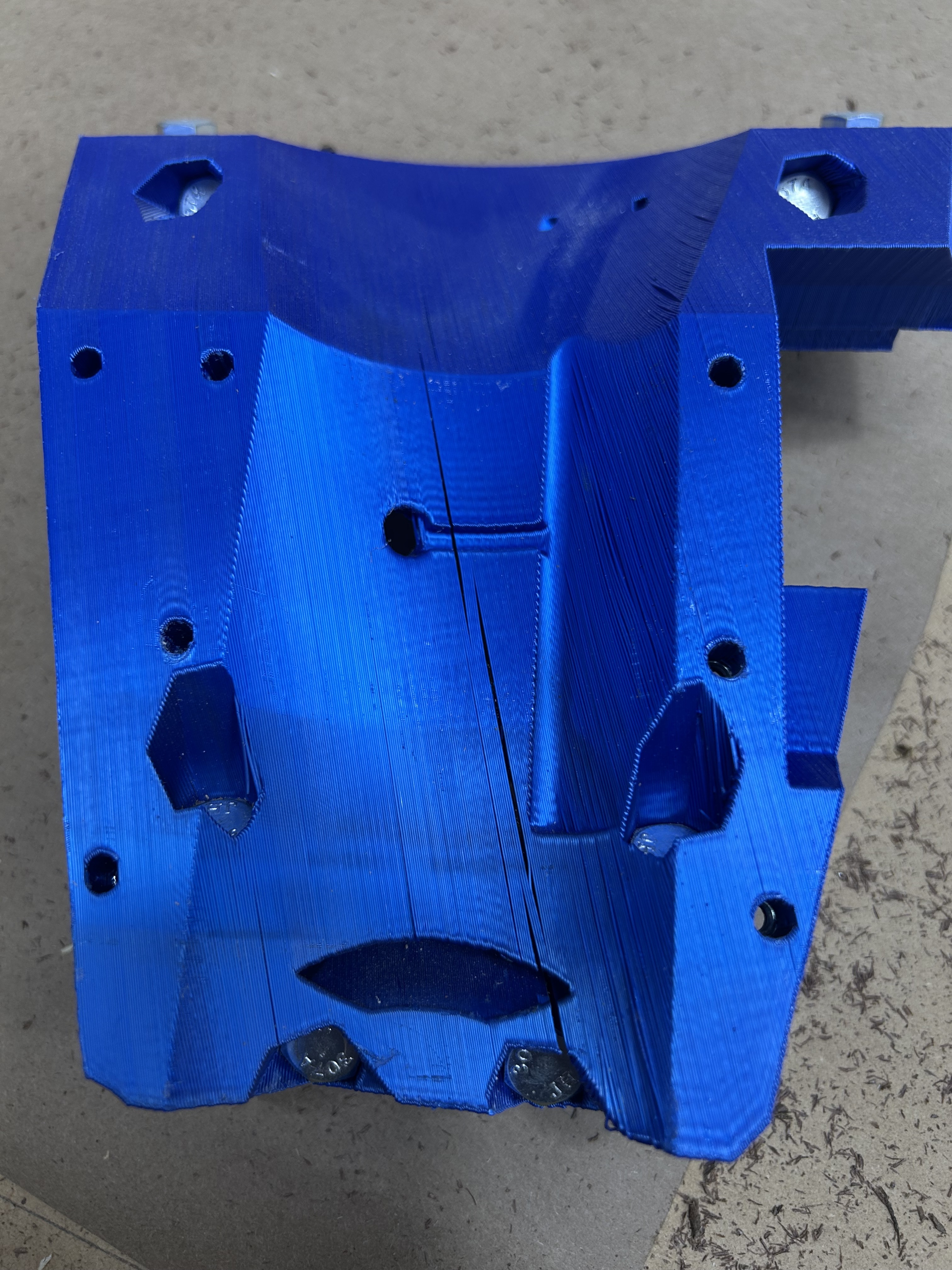

Personally appreciate being able to see where/how the Core splits. Used 0.6mm nozzle, 0.32mm layer height, 3 walls and 35%+ infill, regular PLA color (not Silky or Matte)?
It’s blue silk…
I made it way before I knew that silk is a little less ideal, and plan to use solid regular PLA for the LR4. The replacement core is in regular gray PLA

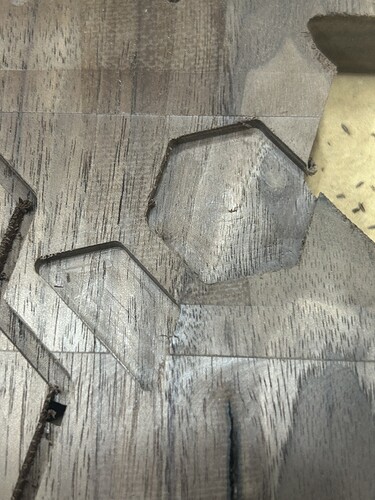

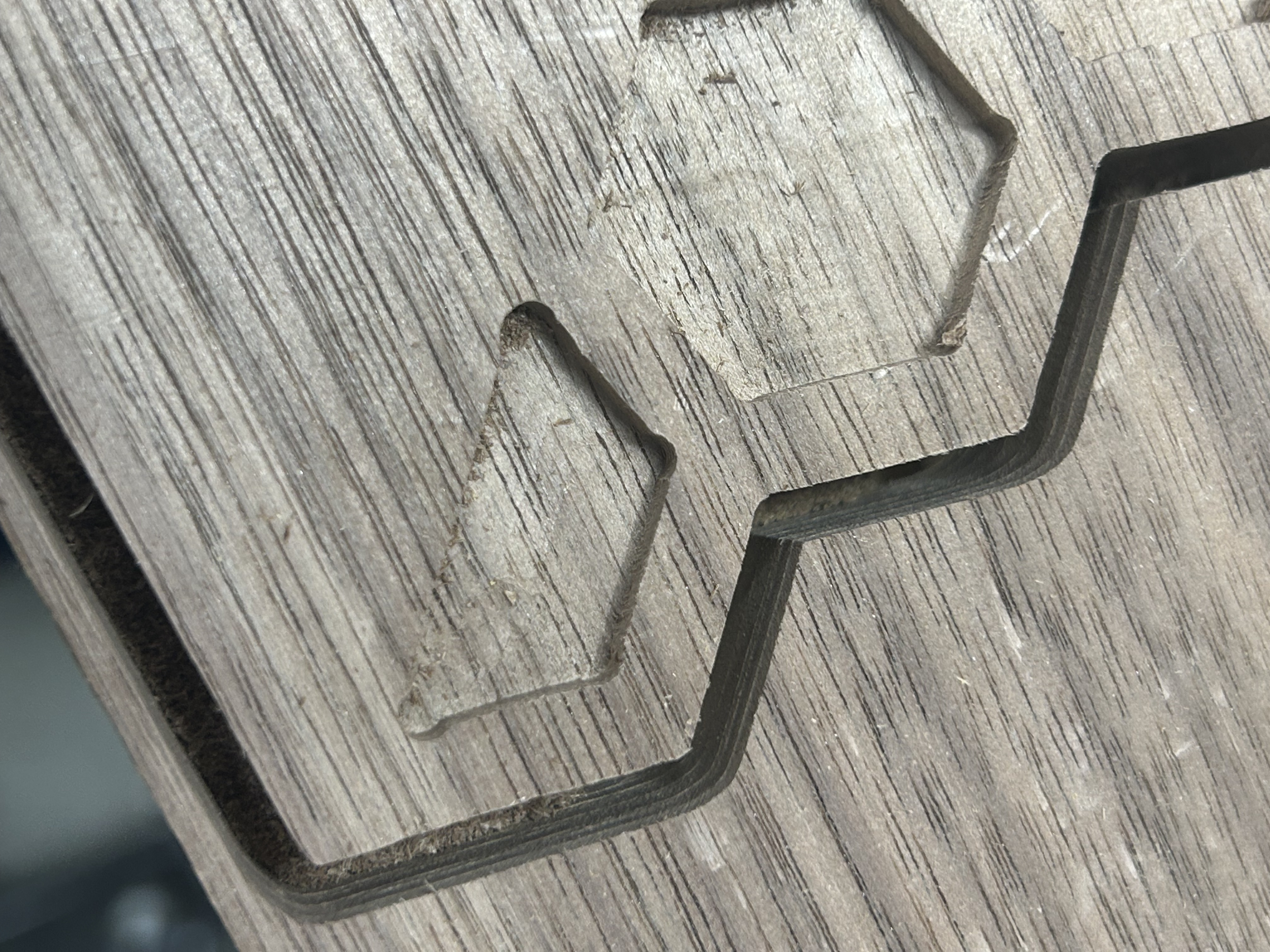

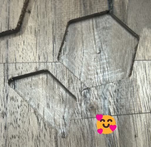

Core replacement went smoothly, other than I misplaced my soldering kit during the clean up so I had to wait for solder. It arrived this morning and I got it all sorted out.
Very much improved, able to add 30% on to the speed and got nice clean straight lines.
New core- note how straight the walls of the cells are
Old core- note the wobbles in the walls that required chisel clean up, adding hours per batch.

Looks like a major time save replacing that core!

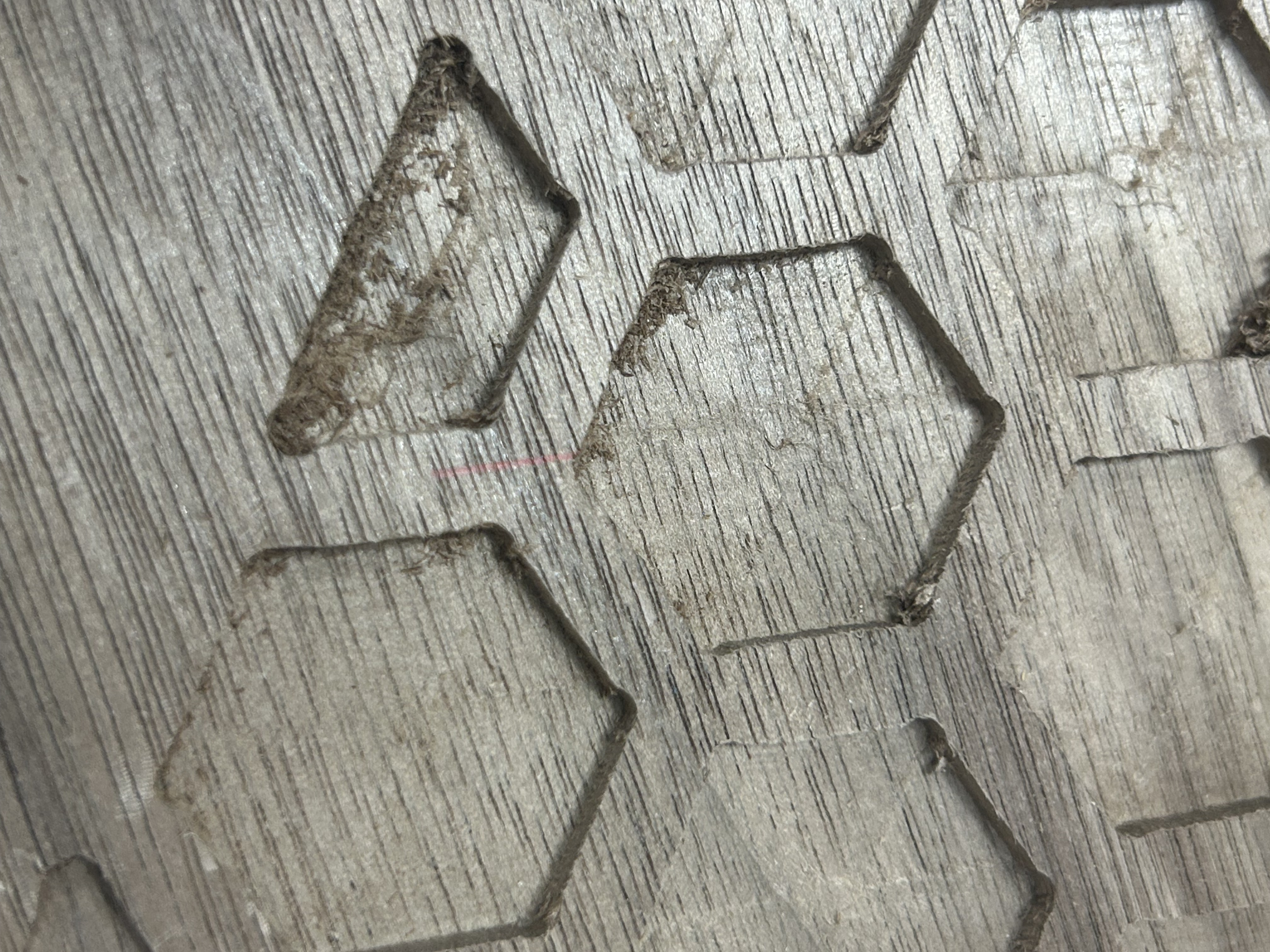

For older cuts with old Core…
Using 5% finish pass?
just saw this: no, but will add that going forward

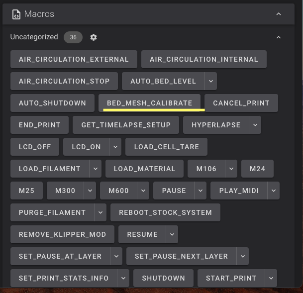

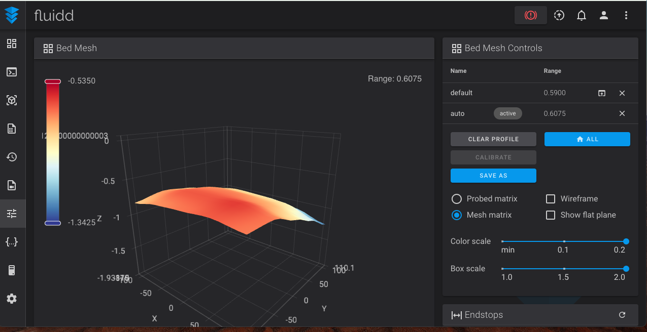

I also did the Mesh bed leveling in Klipper.
is that the regular bed levelling sequence to get the profile and then use that profile? it samples like 12 points on the bed, or is this more data points?
It’s one of the Macros:
Then go to Tuning and activate it.
