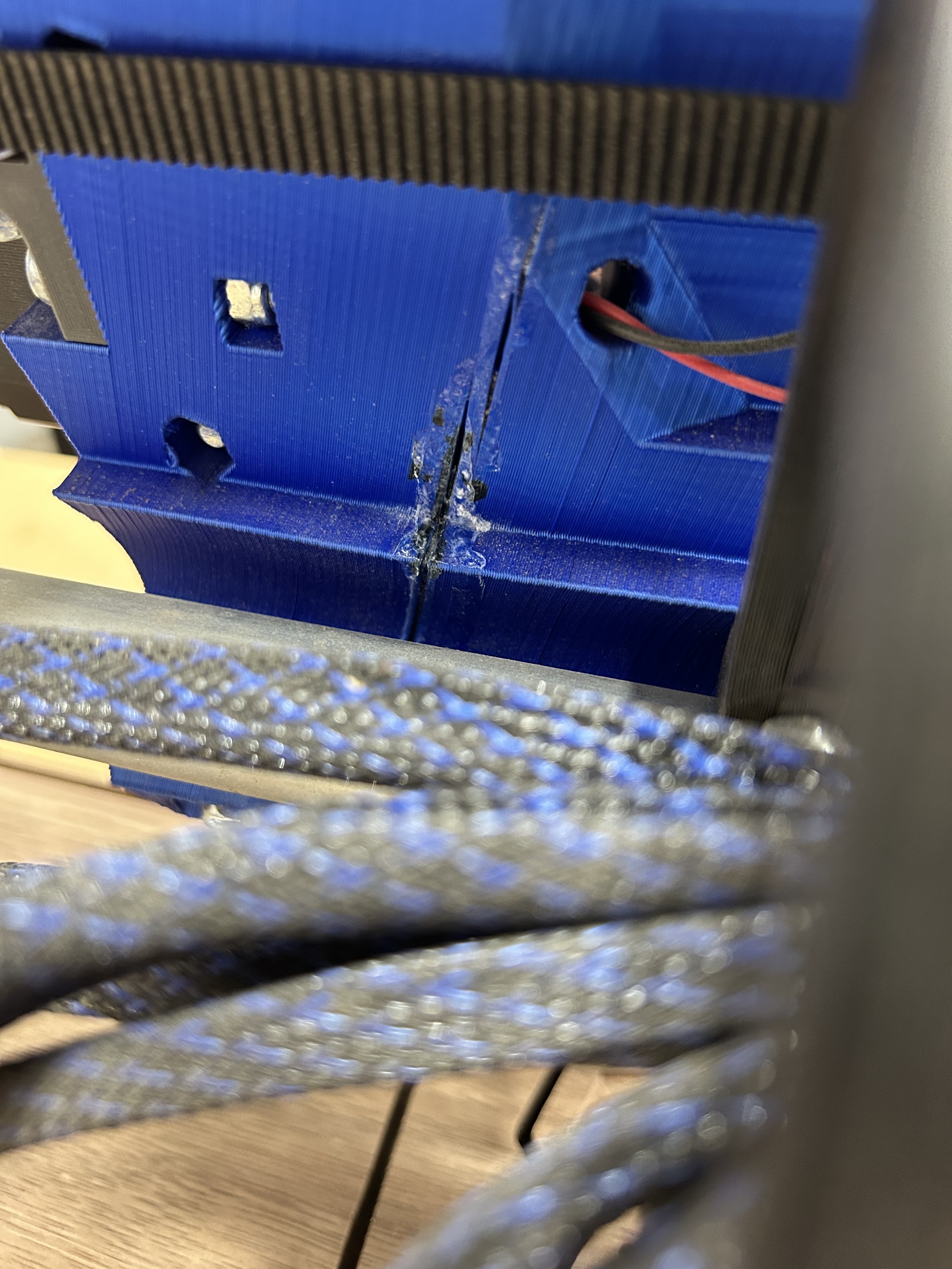

Getting some unacceptable wobble artifacts due to the crack on this latest batch, and Im wondering if i can do a quick replacement to get these finished this week. Otherwise Im waiting for a quiet day next week to do a bigger overhaul which pushes me too close to the deadline

Theres a 1/16’ wide, 3" crack in the back i filled with superglue a couple months back, intending to fix it. I printed the core, vener got round to installing it.
Im almost tempted to film the removal to see if it falls apart as I remove it, lol

I’ve cracked 2 LR3 cores like that and both stayed together even after removal and beating the bolts and such out of it lol. They just wont hold steady on the rails anymore after cracking. Both of mine we believe were due to over tightening the router mount.
FWIW I have purposely overtightened the router on my current LR4 just to see if it is susceptible to the same cracking. So far its holding great! BUT my core is printed from PET-CF so I cant say for sure if it would be the same for PLA

over-tightening the mount was definitely what did it. Early on I was experimenting with various laser mounts, and made a remix that ended up slightly off center on the holes and I accidentally cranked it down until I heard a crack .

Oh wow! I never heard the crack but for sure saw what it does lol. Every time I would adjust the core to tighten it back to the rails it would only stay for a little bit then right back loose again. Was extremely frustrating until I finally took it off and found the crack.

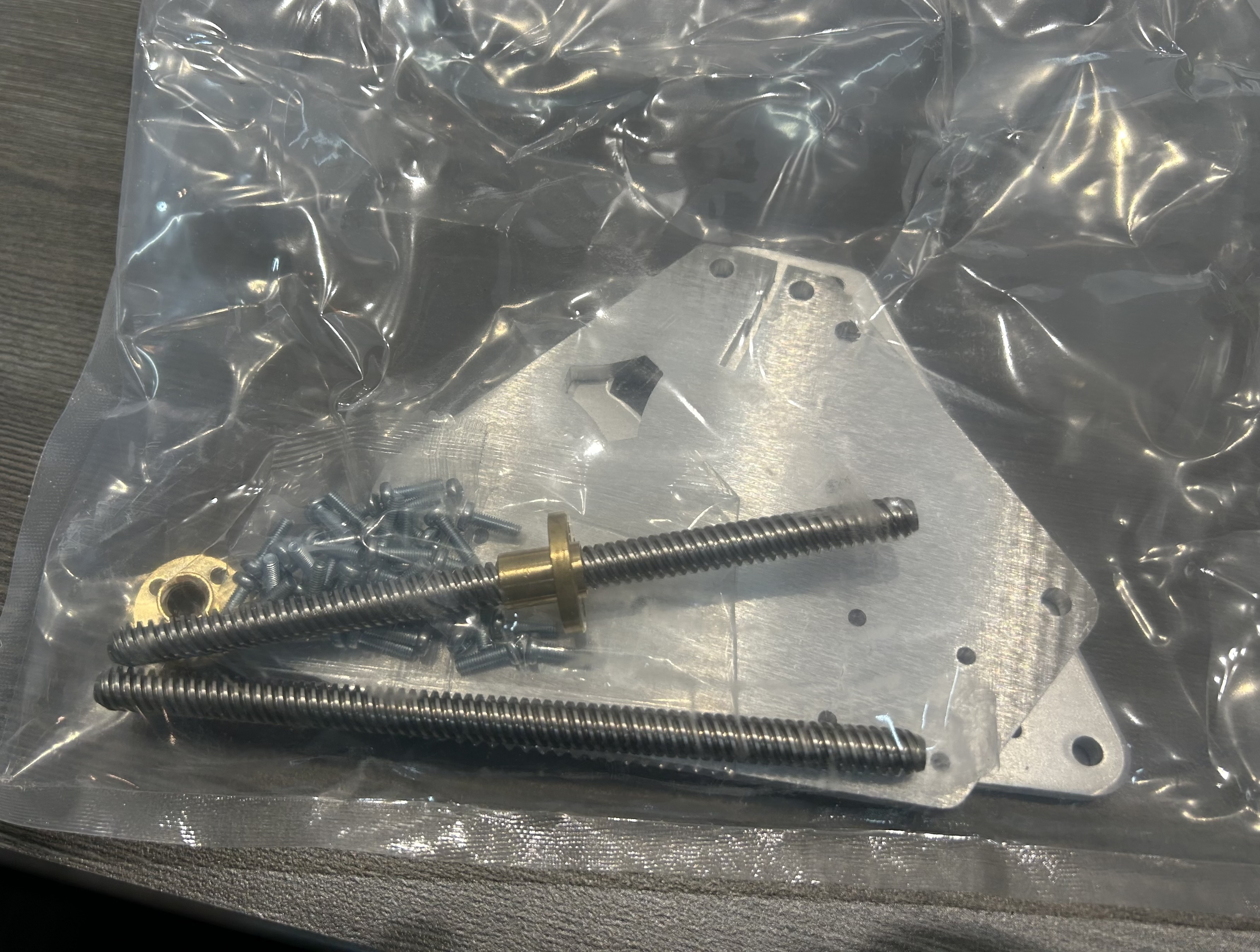

Screws/bolts/bearings/motors/endstops yes. Conduit no. The LR4 stepped up to 1" EMT which is a lot stiffer. Ryan has a cheap upgrade kit as well for the added M3 screws and Aluminum XZ plates.
Yeah, I got the upgrade kit as soon as I saw it, a couple months back
