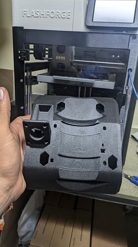

The 'Black and Blue' LR3 build
You will enjoy the AD5M I think!
More than he thinks! Im in love with mine
its 399 at the website though, and takes 3 weeks to arrive…
I bought mine at 298 with the enclosure bundle.
But my core took nearly 18hs. Im so happy with this (0.6 nozzle)
considering i had to baby my old one for every print, i already ran 3 prints off this with zero issues. the automatic bed levelling is awesome, and the first layers are super smooth. im loving it
planning to do the enclosure prints later today.

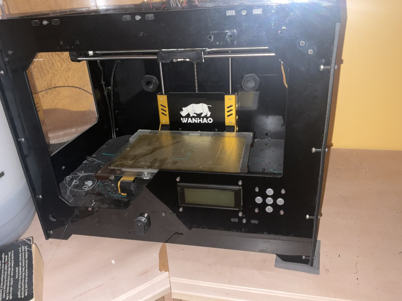

Ugh, that takes me back - the very first printer I ever bought that happened to me - I had a problem and the seller said it’s a manufat]cutters warranty speak to them, went to the manufacturer and they asked for invoice number and of course I didn’t have one as it wasn’t a direct sale.
Still have the printer, hasn’t been used in oh must be almost a decade now :grin:
thats beautiful.

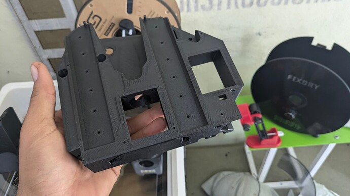

did you use the OrcaSlicer? Could you share settings so i can plug them in? Appreciate it! Thanks
I just used the bambulabs x1 profile sirayatech published for the filament, ran a test, used the max temp the printer can print with and it was perfect. (Its not pla, thats Pet-cf)
For pla&petg i used the flashforge standard profiles and they workes right out of the box!

You should do at least 1 calilantern test for every type of material you print and save the skew profils with the distintion. That said you need the klipper mod. The stock firmware is a locked klipper firmware/proprietary
I did some prints before and some after. Many were before. When I ran the CaliLantern test on the two I had at the time, one scored stellar before any adjustments and the other one scored decently. I did make the corrections, but I was getting good prints even before that.
what about infill density and type? I seem to remember the LR3 parts had a pretty nice table of suggested printing requirements, havent actually spent time looking at the LR4 files.
Thanks
I used the recomended infills#s for each part.
Most seem to choose ā€œCubicā€ infill. The LR4 docs should show a chart for infill percent per part, and for number of perimeters, I think 3 is a common choice.
