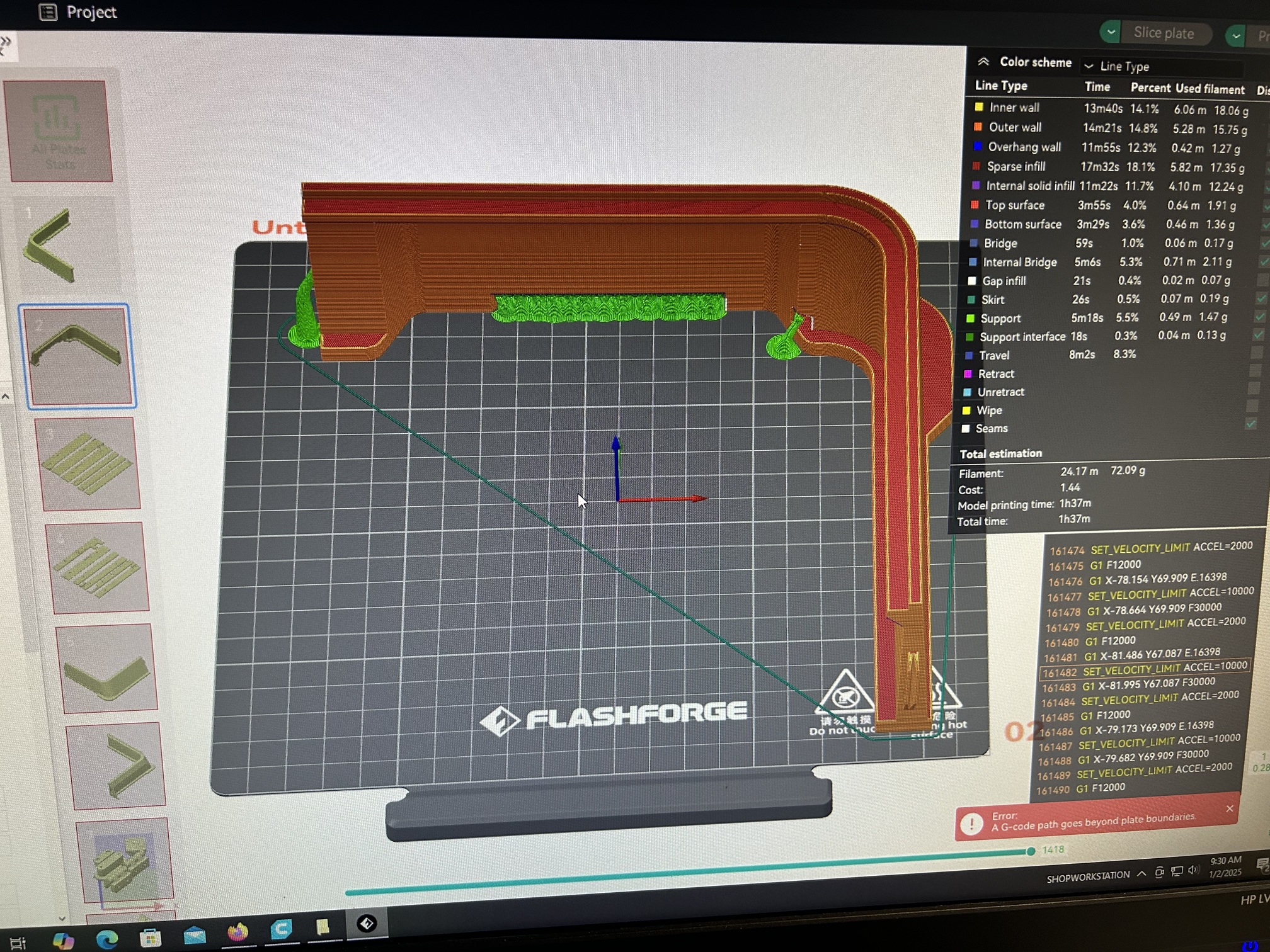

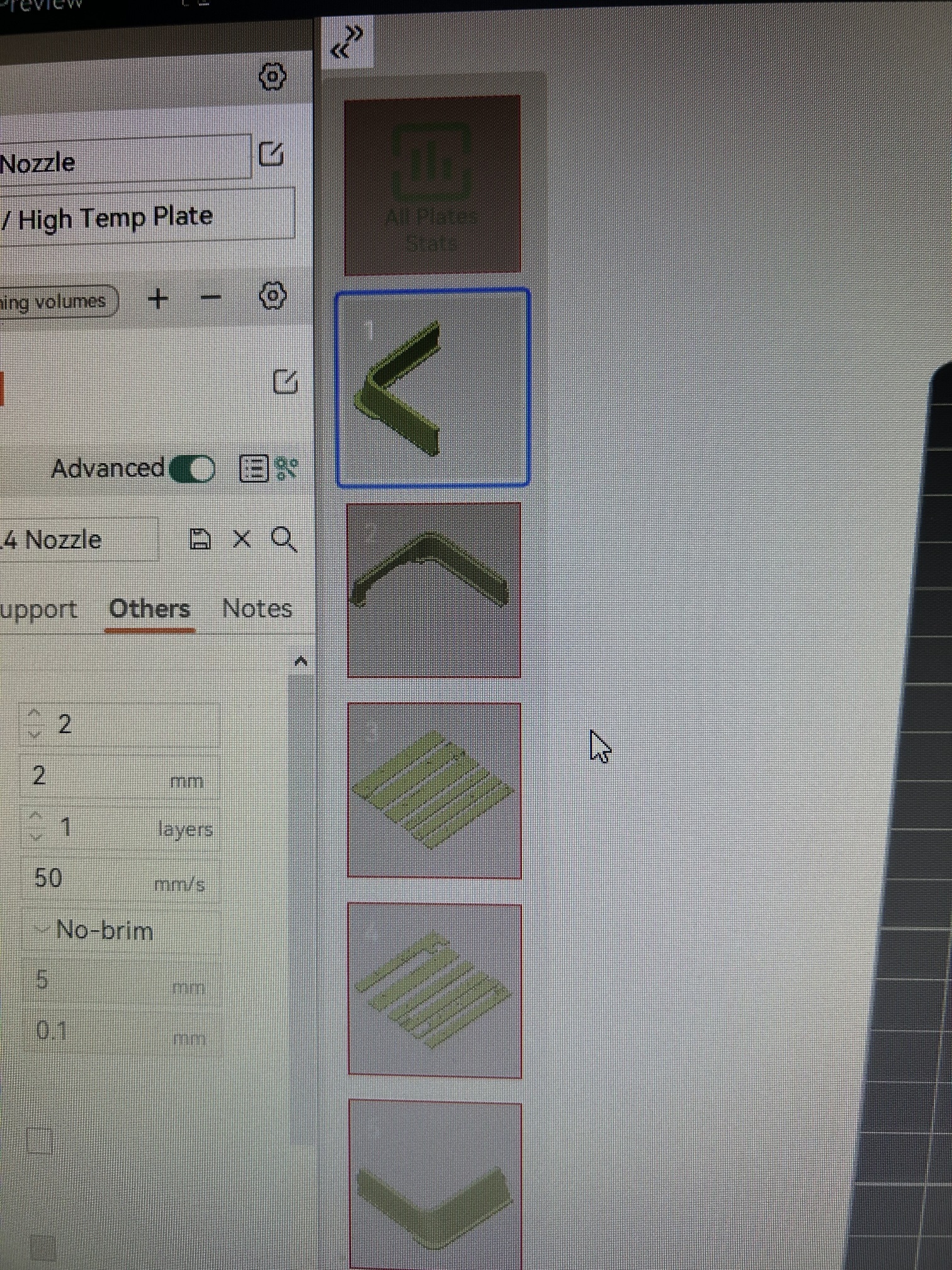

Tried the 3mf file for the enclosure, but it’s throwing a boundary issue at me for all plates except the first one. Probably user error, but when I download the single file for the hexagon spool holder, it does the same (but gives an additional “support required” warning. Thoughts?
Maybe you can disable that line it draws around it?
Thats the one that works. But I tried disabling the brim, to no effect. The parts aren’t crossing the plate boundary though, so I dont know whats really going on with it
If i use a 0.2mm layer height, with my own profile (not the 0.28mm included as a preset inside the project) it works just fine. All plates can slice. weird glitch i guess.
I had this problem using FlashForge OrcaSlicer, I am presently re-laying out the plates manually to match Doug’s versions. FF Orca complained about the source 3mf being from a newer version of orca- not surprising to have some errors.
