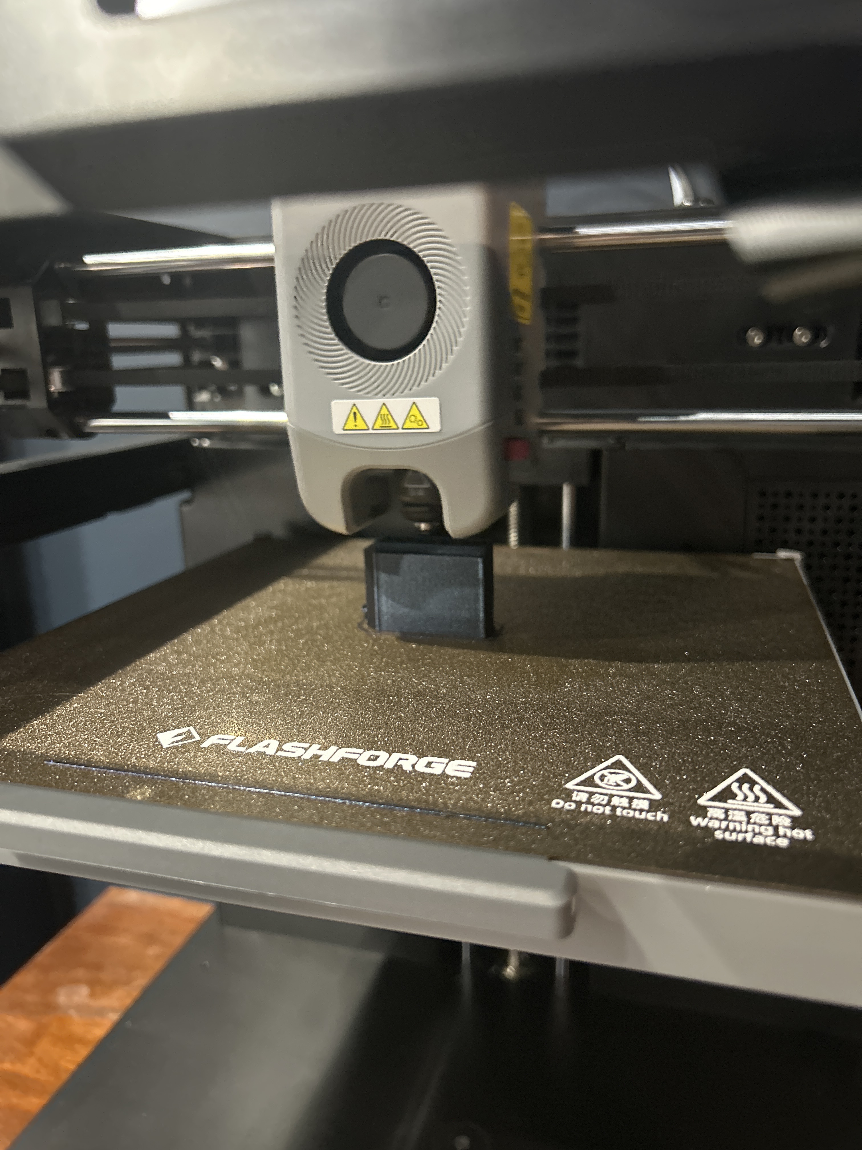

While i was lasering those, i pulled my 6 year old adimlab gantry 3d printer out of the backroom, since i need a new core. set it up in the wood storage area, flipped the switch- nada. zilch. nothing. Thing doesnt switch on. I throw a quick email to the facebook support group- which bounces, because the group no longer exists. Uh oh. Im SOL. Old printer, no support…
I go to my Amazon and pull the trigger on the Flashforge Adventure 5 thats been in my cart for 3 months. I put it in there after seeing @DougJoseph posting about this printer and its suitability for making th LR4 parts, after seeing that my slicer of choice (Cura) was maybe going to give me issues. I went down his rabbit hole and put it in the cart for when the time came to make my LR4 parts.
Ordered on the 26th, delivered on the 28th, unboxed on the 29th, and doing my first test prints this morning.
I will say, if the claims of hgh speed hold up, im going from 30mm/s on my old printer to around 250mm/s on this one, so my prints should be appreciably faster. I put the LR3 core into the Orcaslicer, and it spat out 5h 22 minutes, compared to the core in the Cura, at 29hours, 48 minutes. Thing is- thats at a 0.32 layer height, which the Orca cant do. It was run at 0.2mm. So i get almost twice the quality, with a 1/6th build time.

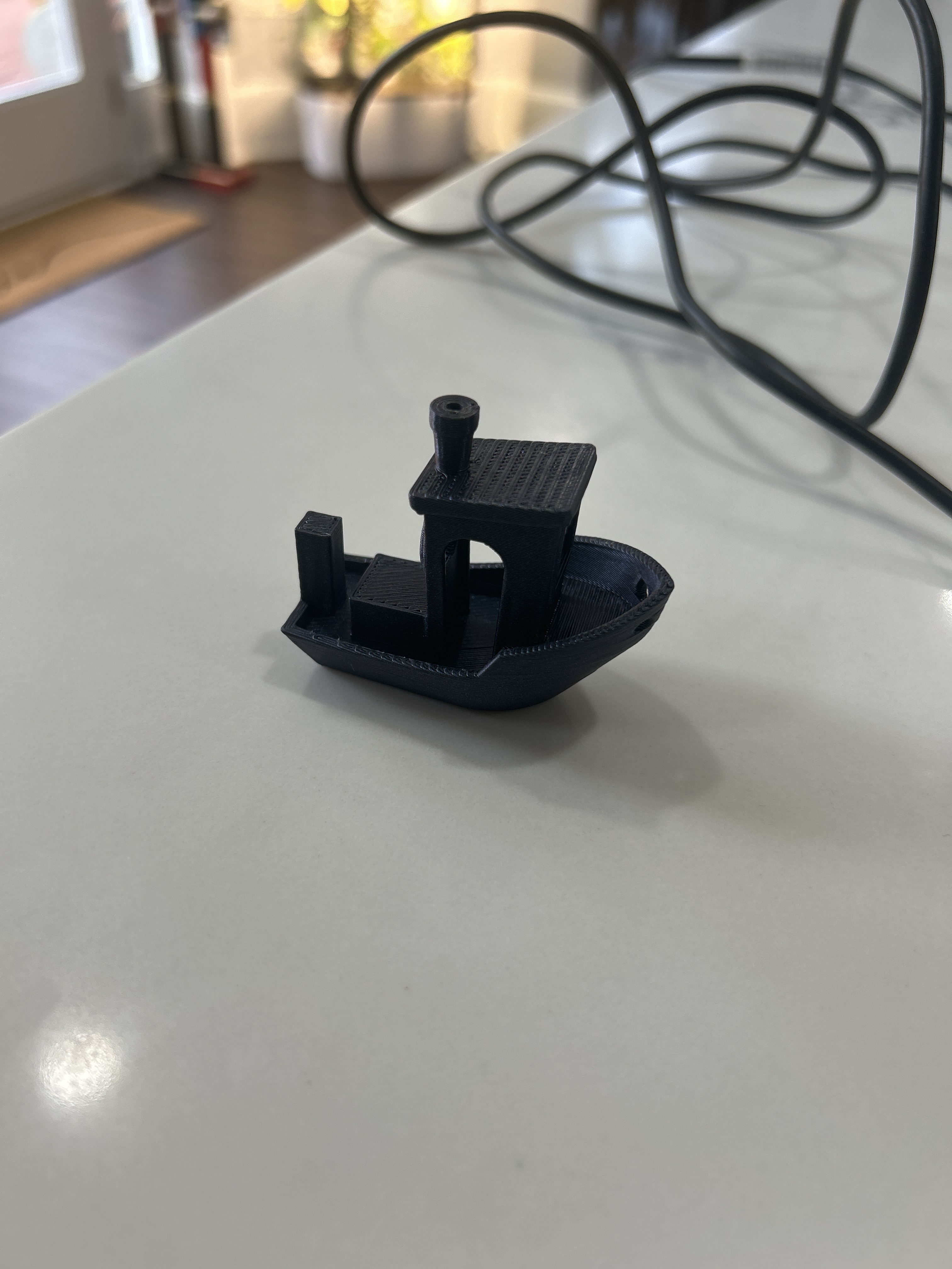

In the time it took me to write this post, the FlashForge built this cute little burnt titanium Benchy, in 13 minutes and 9 seconds. My old printer took 1 hour 40 minutes to make the same benchy, 6 years ago, on christmas day, on the dining table, annoying the wife.

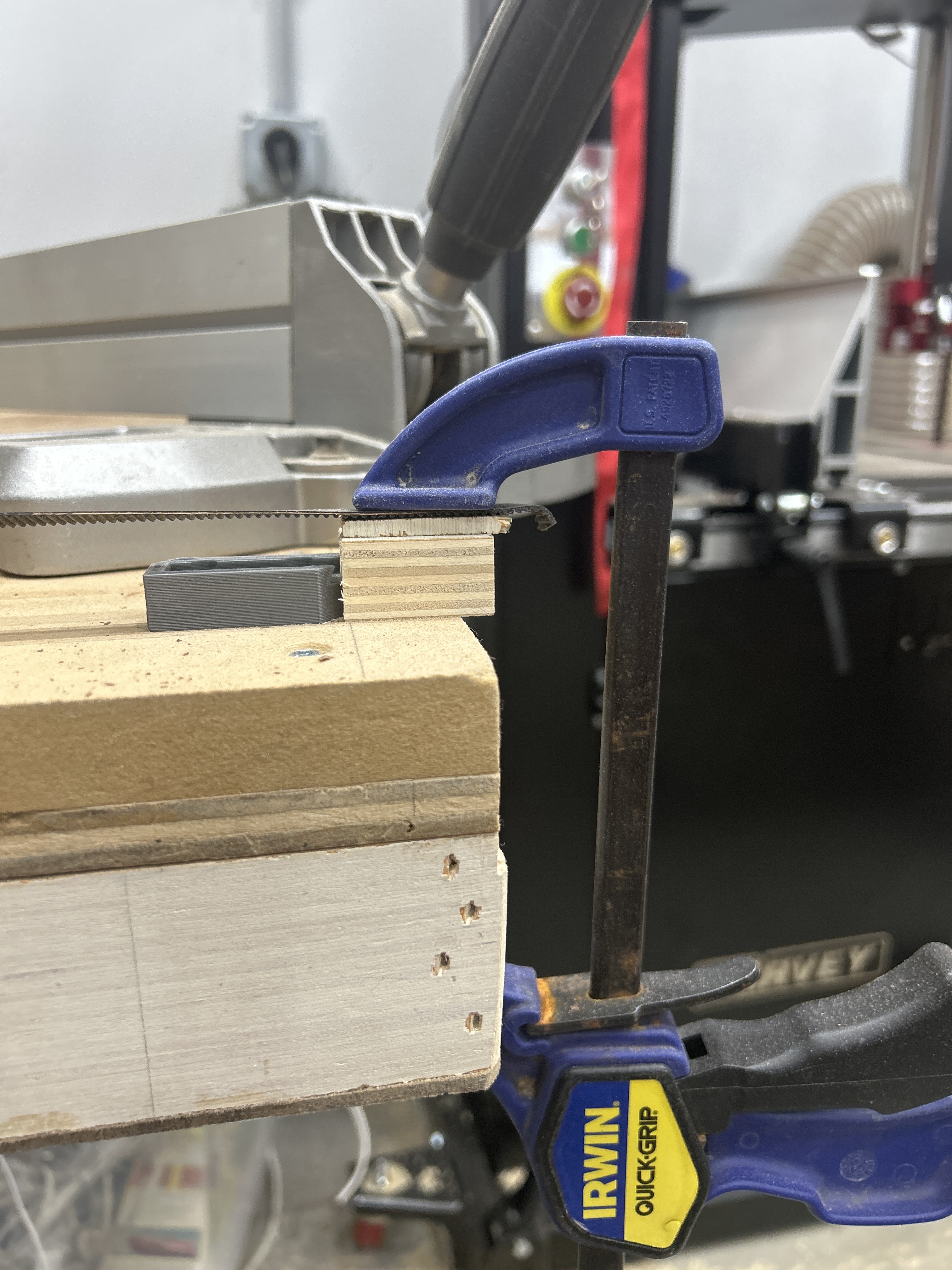

Oh, yeah, just remembered it also bust the y belt holder at the same time.
This is my fix-
